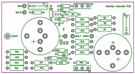

For everyone, here is my board layout. I was hoping someone would be able to check over it quickly to make sure it's laid out properly before I switch the amp on. It looks right to me, but I'm fairly new to this and doing the layout has been a headache.. plus it cost me $45 to ship the parts to austraila! I don't wanna fry it this quickly and have to order more!
If it's right, some newbies may find it helpful in their builds. It's just designed to use stripboard/matrixboard
Thanks in advance for anyone who is able to help out.
I found a mistake on my own board :/ here is the updated one
Looks fine to me if node just below the emitter of the transistor is connected to the supply.
