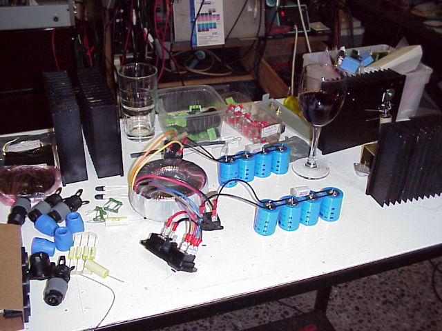

Here is some work in progress.
Toroid is a 250VA 18+18V. Military grade of course. 😉
I would have preferred a bigger one but could not get my hands on it.
Fins are recycled from an old Kustom amp, 16.5 x 12.3 cm.
Wine is a cheap Cabernet, better pictures to follow.

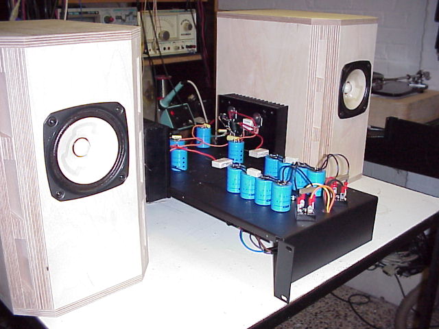

Hugo,
got a picture of your Fostex for Peeping Tom ?
My pleasure. 🙂
http://www.diyaudio.com/forums/showthread.php?s=&threadid=88557&highlight=
I'm determined to make them sound nice and hopefully an F2 will help me.
/Hugo

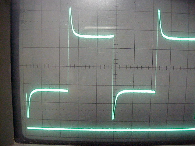

Obviously, I must have done something wrong.
This is the square wave at +/-1Khz, speakers attached, low output power.

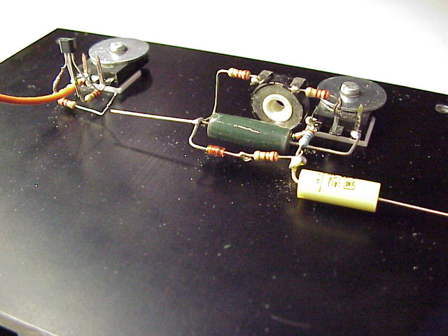

I would be thankful if someone could tell me how to set P1. On a certain point, bias is set at +/- 2.7A. I can still increase P1 but bias stays put.

Hugo, you want to adjust P1 to get a reading of one half, of the DC-supply voltage just in front of the outputcap! Connect your DVM to GND and in front of the outputcap and adjust P1 to get the correct reading.

Thanks Steen. Done. 🙂
I used very common components, no 1% resistors except R3 which is 47 ohm instead of 47.5.
At the source of Q1 I attached a 7W 0.68ohm and the resistors R23..R26 are replaced by 3 X 0.22ohm.
I can't imagine that this would affect the square wave that much. Or is my imagination off track? 🙂

Looking at your picture, those Mosfet's are too close to the top of the heatsinks. I dont mean to be rude or something, but my best guess is, that they will run too hot in that position! My rule of thump is, one third up from the bottom!! BTW turn them upside down.
Steen🙂
Steen🙂
Rude? I wouldn't even think you could be rude.🙂
I could turn the whole construction upside down -I mean the heat sinks- without changing anything. Then, the center of the mosfets would be at 1/4 of the bottom and the pins would point upwards. But why would you turn the mosfets upside down?
/Hugo
/Hugo
You dont want to turn the mosfet upside/down. What you want is to place the heatsource 1/3 up from the bottom😉 I had a hard time to get convinced about that fact, but finally I did get convinced😀 I guess the hot air rising is the cause🙂But why would you turn the mosfets upside down?
Hugo, dont hesitate to ask further.
Steen😎
So am I right now!! Getting my Aleph-J in the air was really great😀But first I'll enjoy a few nice songs.

As I did everything PtP, it's a constant improvising how to place each part. I like this approach for simple designs because it's much more fun than plugging parts into PCB holes. Sure it takes more time. I guess it took about a whole day spread over a week to assemble.
