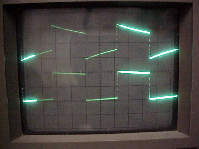

I found out that the F2 is very accurate in producing a square wave without load. I presume that this is the way Nelson did the 10Khz test. Looking at a 400Hz and lower square wave, the distortion rises (see picture of 100Hz 300mV input, upper wave is output).
Ones speakers are connected, one needs to trim the wave with capacitors and resistors as outlined in the paper http://www.firstwatt.com/downloads/cs-amps-speakers.pdf
This seems fairly tricky to me as the ideal combination for say 1Khz is not necessarily optimum for 10Khz. I found it to be a very nice exercise to perform together with extensive listening tests.
/Hugo
/Hugo
So, the square wave should be nice all along the audio band?
Hmm...wonder what could cause this. I'm pretty sure I did wire everything correctly. I admit I need some kind of buffer as the amp plays tricks on my el-cheapo audio generator. At 10Khz it looks more like a sawtooth.
/Hugo
/Hugo

Lack of time prevents me from doing more tests but yesterday evening I found a few minutes to play with the generator. Long story short, I found out its broken somewhere but managed to tweak a bit here and there and finaly it was up and running more or less as it should.
All in all, with no speaker connected, the F2 is doing fine all along the audio band.
Figures are now much better, square wave remains a square wave.
With speakers attached, I see a bit of overshoot at the top that needs further investigation.
Playing with the R's is next on the list.

good to hear, it is alright again with your squares
they are indeed a good tool them square waves
for analysing effects of the final setup trimming of amp
... that bit that is perhaps the most tricky one ...
to try some compromises to get nice and stable output into real loadings
