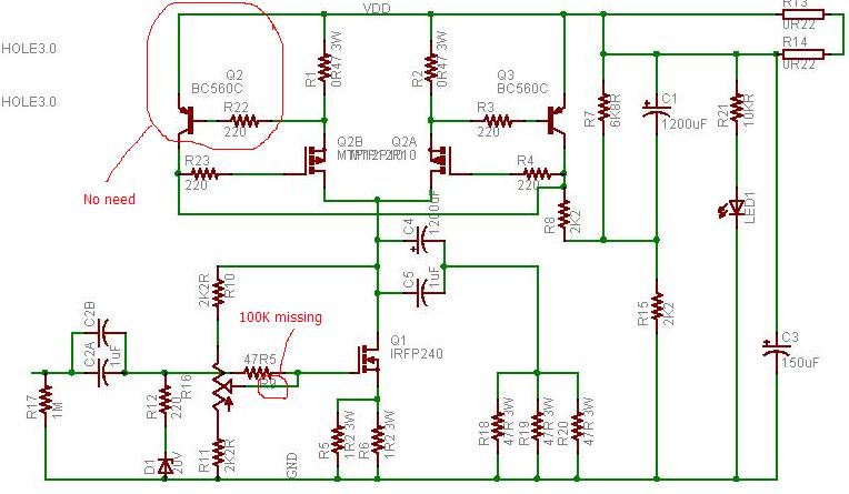

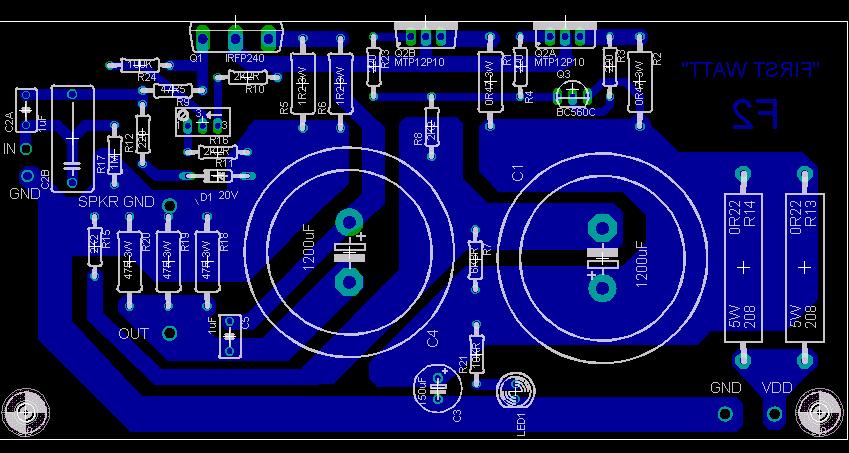

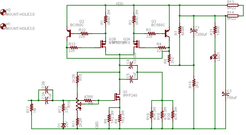

Guys,
I try to build F2 with whatever I have in my parts bin. Here's the results of some modification in the current source by using two T0220 MTP12P10 instead of one IRFP9240. For the source resistor, I'm using two 1R2 3W resistors instead of six 1R 3W resistors. Do you think that this modified F2 will work at all?
Ipanema said:I try to build F2 with whatever I have in my parts bin. Here's the results of some modification in the current source by using two T0220 MTP12P10 instead of one IRFP9240. For the source resistor, I'm using two 1R2 3W resistors instead of six 1R 3W resistors. Do you think that this modified F2 will work at all?
I would try as shown below.

Ipanema said:I've made the modification. Is everthing OK now?
I believe that every thing is arranged to work.
And, you could have fun further with minor variations after the first finish.
Enjoy 🙂

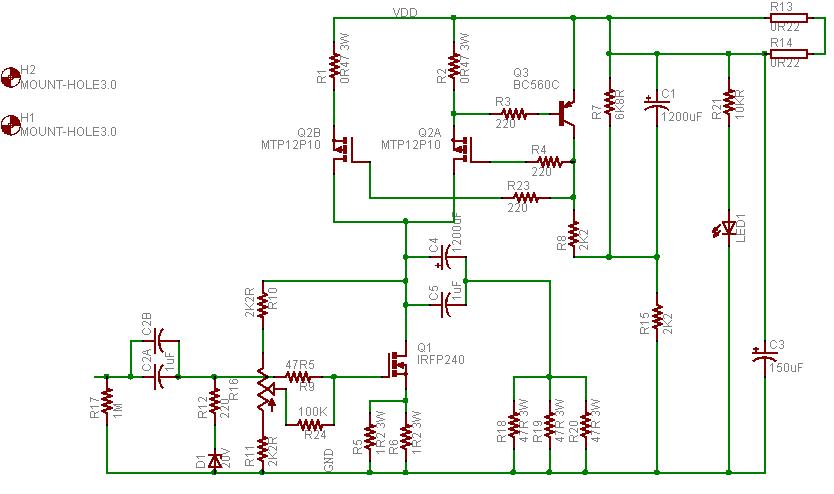

Ipanema said:Guys,
Hi Impanema,
Guess R5/6 will not have enough disipation if you bias the amp at 2 amps, you will need to burn around 8 Watts so a 12 W resistor or combination will be preffered.
apassgear said:Hi Impanema,
I agree with you, Tony.
I also like to recomment 5W rating
because the current per source R (R5 and 6) is 0.66/.47=1.4A
and dissipation per source R is 1.4x1.4x1.2=2.4W
Considered the 3W rating having only mere margin.

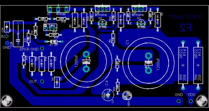

Hi Babowana and Apassgear,
Thanks for the warning on R5 and R6. In this case I need to increase it to four 2R4 3W resistors in parallel then, which will be 12W. Two will be solder on the bottom of the PCB. Hope this work without changing the layout.
Since I'm using BC550C instead of ZTX550, will it have any effect on the performance?
Thanks.
Thanks.
Ipanema said:Since I'm using BC550C instead of ZTX550, will it have any effect on the performance?
That PNP TR is used to set up the constant bias current of the gain MOSFET, using its B-E on voltage. The design allows any PNP TR having the B-E-on voltage of about -0.66V. In this respect, BC550C is useful because its typical B-E-on voltage is about -0.62.
Another thing we should consider is the C-E voltage rating with respect to the actual C-E voltage. As far as I understand, BC550C satisfies this requirement too.
Probably, the TR having higher current gain might be better in regulating the constant bias . . .
