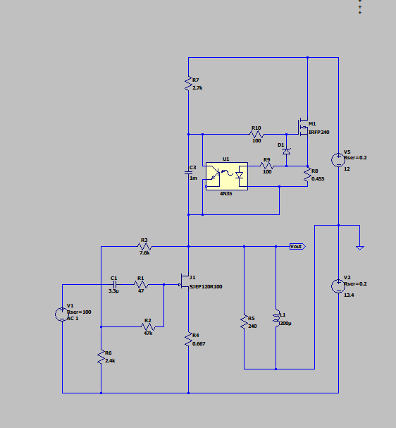

Dual rail, no output caps, no PSU resistor bank ... are you going to build it? I'm very curious how it will sound. What is D1 for? Is it holding the gate voltage high enough to open M1?
At least in the simulations, it behaves the same way. I'm not sure yet whether to go with dual rails like in the F5, or use a capacitance multiplier with regulation. D1 is just there to protect the MOSFET. I'm a bit concerned about thermal drift in the SemiSouth JFETs, but I believe it should be minimal. I’ll test it first using a lab PSU and observe the behaviour.

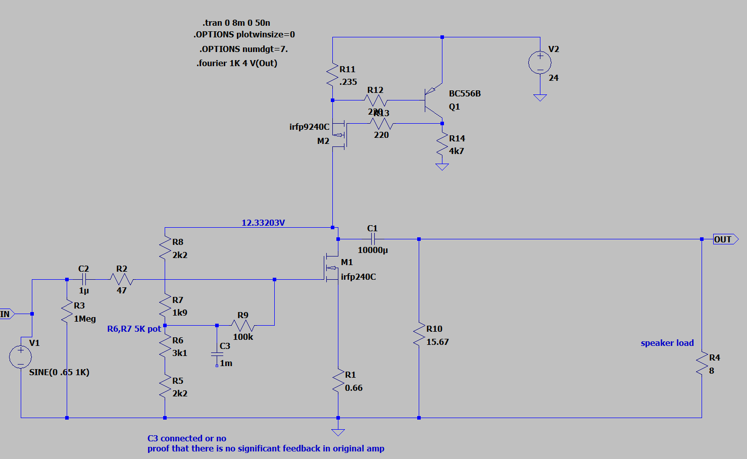

easy to sim and hear the difference; just put 100uF from pot wiper to gnd, then remove it
brain on reserve, done some paperwork for tomorrow and, instead of being useful - solving some correspondence duties, I'm clicking in LTS, just to check my 3 gray cells
and yes, what I remember from time when I had something to remember - there is no significant feedback loop in original F2, even if sorta looking opposite
that 100K from mosfet gate to voltage divider is significant in value, so negating whatever voltage swing left in divider
as I said = easy to check, connect or disconnect C3 to GND
in short - no feedback, some additional loading at output just to tame things a little ( make everything more controlled and predictive), that's your CS amp
introduce regular feedback, nature of the beast, no more CS amp

So the higher the value of R6, the higher the amplifier's output impedance, and the more it has a current source character, correct?
In the F2J, R6 was reduced to 8.2k to deal with possible gate leakage from the non-insulated gate of the SemiSouth device. But if the voltage drop across R6 stays below, let's say 0.4V (no signal and once the amp is fully warmed up), would it be safe to increase R6 value, even up to 100k?
Is my understanding correct?
PS. In your circuit R6 is R9.

if you want CS amp, yes, one of the ways is as shown with F2 - no overall feedback, so OLG as high as possible
Pa's resistive loading of output is made to tame things a little, to diminish possible xconductance variation/difference between mosfets etc.
so, yes, "R6" as high as possible, while still maintaining DC parameters stability
if you choose to include input buffer ( as drawn on my napkin back, few posts back) said resistor is not critical at all (being now at JFet gate), buffer taking care of possible gate leakage of output part

Wait a minute, interesting part is here:
It seems like in your CCS you're sneaking in a few electrons together with the photons. Could you explain this hybrid quantum situation, sir?
What kind of wizardry is this?
optotransistor is DC coupled to maintain Iq
cap to gate is connected through Zen Amount Pot, so you can adjust modulation of Mu Follower, so changing THD Spectra (in some range) to your liking
ZAP all the way down, full Mu modulation, current contribution close to 50% of sum current, THD Spectra leaning more to PP nature of things and everything
ZAP all the way up, decrease of Mu modulation, current contribution decreased and THD Spectra leaning to more SE nature of things and everything

yeah that ..... but it can be fun to have it somewhat adjustable
take care that original F2 CCS is pure CCS, not Aleph (modulated) CCS
Mu Follower is (in most cases) effectively same as Aleph CCS, set to approx. 50% of current contribution, in other words - OS acting as PP
edit: unclear ....... yeah, ZM thinking about 3 things in same time, no wonder I'm mixing them
in very moment when I did mention F8, started writing BS for F2, thinking of F8
same applies for drawing above (ZAP), I was thinking of arrangement in Babelfish F8, forgetting major difference
all wrong that; as output is taken bellow source resistors of upper portion, that is no Mu Follower in F2
conclusion - ignore ZAP in context of F2

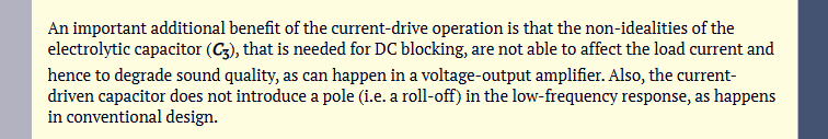

Regarding the dual rail approach to remove the capacitor, even though the SJEP120R100 is quite thermally stable, the real problem is here: even if the output were initially at 0 V, because of the presence of a CCS, the speaker becomes part of the DC path, which shifts the biasing point. Also, a current flowing through the voice coil causes it to heat up. This leads to an increase in the copper coil's resistance, which in turn shifts the operating point, and so on...
If Esa Merilainen is right about it...
https://www.current-drive.info/9
...then we do not need to worry about the DC blocking cap in F2.
PS. One day I tried to measure Thiele-Small parameters using F2. This process involves adding a resistor (10 Ohm) in series with a speaker, so the application can read the voltage drop across it. I spent some time trying to figure out why the impedance curve is flat. Then I realized why... 😀
This also proofs that F2 is a pure current source amp 🙂
