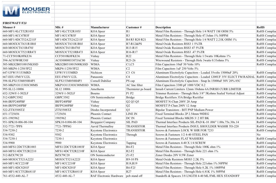

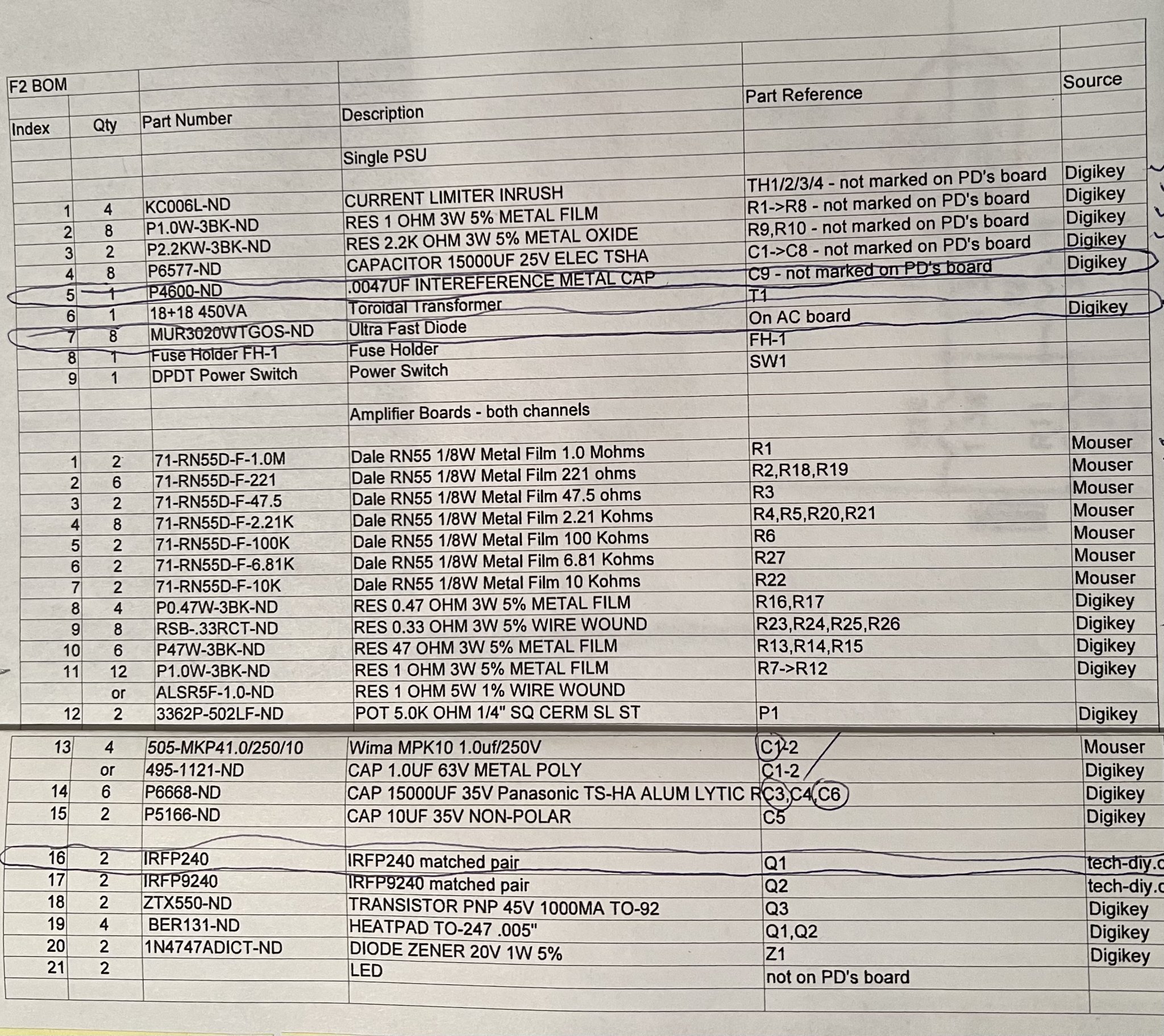

Hi all, I was lucky enough to come in to possession of a pair of Semisouths, and am thinking I’ll build an F2J with them. Does anyone know of a good source for the F2 boards? Also, if anyone has a BOM on hand that they wouldn’t mind sharing, I’d be most grateful. Thanks!
Scott
Scott
Send me you e-mail address on PM. Drop the @ and replace with (at). No bom but my mouser receipt for the J.
Ask Twitchie for boards, perhaps some are left. Next on list is Peppennino.

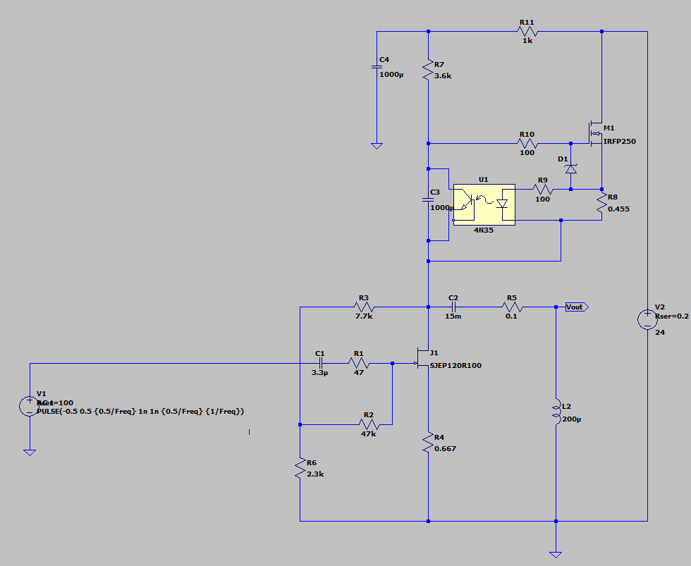

I’ve been enjoying my F2J with the SJEP120R100 and love what it does, especially with my sensitive full-range field coil speakers.
However, I’ve been thinking about the original CCS used in the F2. It’s elegant and minimal, which is great and simple to build for DIYers, but when I tried using this CCS in another circuit, a fellow engineer pointed out that it might be prone to high-frequency instability due to phase shift and lack of frequency compensation 😳
Now, I know that in some of his later designs, Mr. Pass used optocoupler-based CCS for biasing and current regulation. From what I understand, these offer better thermal tracking and potentially smoother high-frequency behaviour, thanks to the isolation and slower response. Right?
So I’m wondering:
I’ve already done some LTSpice simulations of a modified optocoupler-based CCS, and the results look clean - but I’d love to hear from people with real-world experience or similar experiments.
So I’m wondering:
- Has anyone tried replacing the F2’s original CCS with an optocoupler-based one, similar (or identical) to those later designs
- Could this improve high-frequency stability or sonics with complex speaker loads? (In my case, the field coil itself is also powered by a CCS - so I may have two CCS circuits “fighting” each other)
Also, the optocoupler CCS seems to solve the soft start issue as well, so there’s no need for the 15mF large cap.
If you want to play/run it in LTSpice, I’ve attached the ASC file.
PS. I intentionally added a reactive load, as that’s the real challenge. Ignore the Vout, it’s ugly. Check the current through R5 (L2) instead 😍
I have NO circuit design ability to understand or analyze what you propose.
I’m just a fan of the F2J and it has been my favorite amp since I built it.
I have used my F2J monoblocks with Sonido field coil widebands (driven by a CCS power supply)and it has been the best sounding combination I have tried in probably a decade. They are the most balanced and resolving combination of a fullrange/wideband system I have personally experienced.
So I have to ask. What is it that you hear that makes you feel it needs fixing or improvement?
Perhaps it is just the challenge/exercise of “what if it could be better?” that you enjoy?
