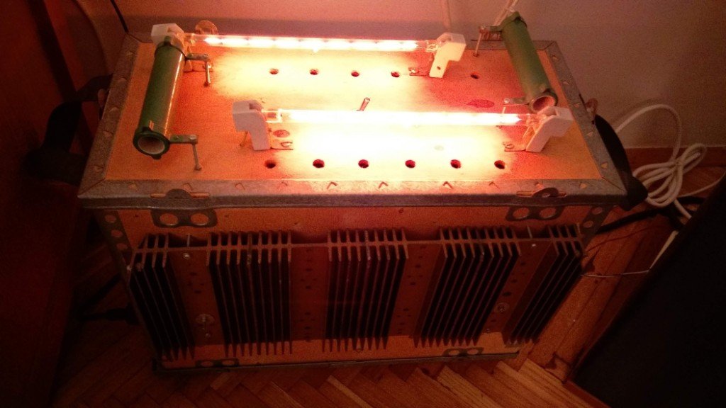

Speaking of an F2 and CCS.. I had gone the other way, I just put the lamps (1500 W, 220v halogen sticks, back then when I could still find them in a shop). Higher PSU voltage of course. Worked wonderfully with my Visaton B200 s on Open Baffle.
And that was a mosfet one, as I never got to upgrade it to F2J...

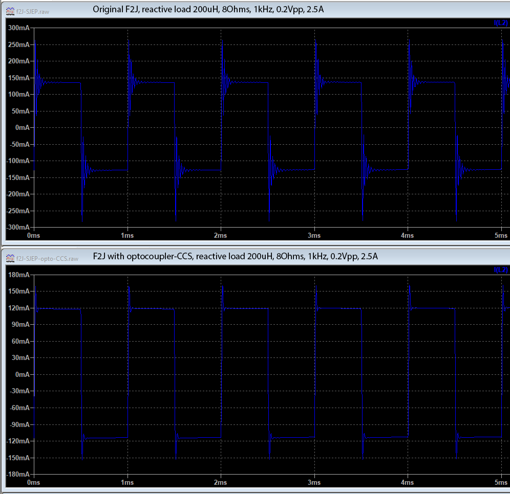

I wanted to share some results from my LTSpice simulation. I ran a square wave test under identical conditions for both CCS implementations. The bias current is set to 2.5A, and the voltage between the VAS and CCS is right in the middle at 12V. Both circuits are driven by a 1kHz square wave at 0.2Vpp, and the load is a reactive 200uH / 8Ohms coil, intended to represent a more realistic speaker load (it's not, but it's not as easy to drive as just 8 Ohms resistor).
From the simulation, you can see that the original CCS shows signs of high frequency oscillation under these conditions, while the opto-coupler CCS shows just a single overshoot that quickly settles (like a damped pendulum).
The signal source has a 100 Ohms output impedance.
Of course, this is just simulation data, and it might not reflect real-world behaviour or implementation.

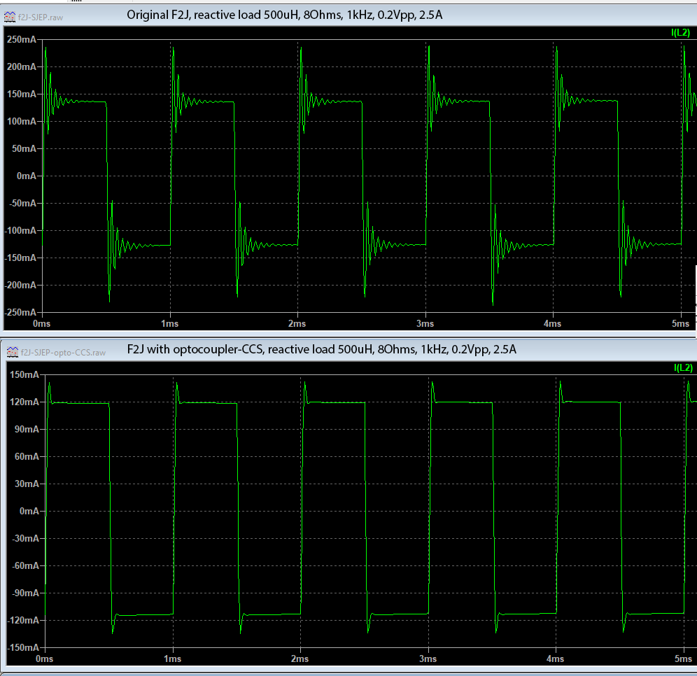

And here’s another example using a load with higher inductance: 500 uH and 8 Ohms. To clarify: this shows the current flowing through the speaker's coil.
Oki doki then! I managed to eliminate the oscillations by adding an extra resistor in parallel with the coil (reducing the output impedance). For the Opto-CCS, 240 Ohm was enough, but for the original one, I had to go down to 51 Ohm
Could this improve high-frequency stability or sonics with complex speaker loads? (In my case, the field coil itself is also powered by a CCS - so I may have two CCS circuits “fighting” each other)

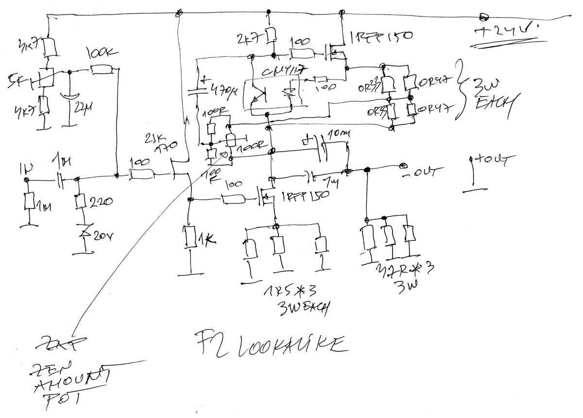

will sketch later what I'm sorta thinking right now
but, don't expect CCS with opto being better CCS, startup behavior probably being better but sonics, when CCS is good enough, it is good enough, no matter how it's made

awesome, can't wait to see that!optocoupler, yeah, handy
hmmm ok ok 🙂but, don't expect CCS with opto being better CCS, startup behavior probably being better but sonics, when CCS is good enough, it is good enough, no matter how it's made

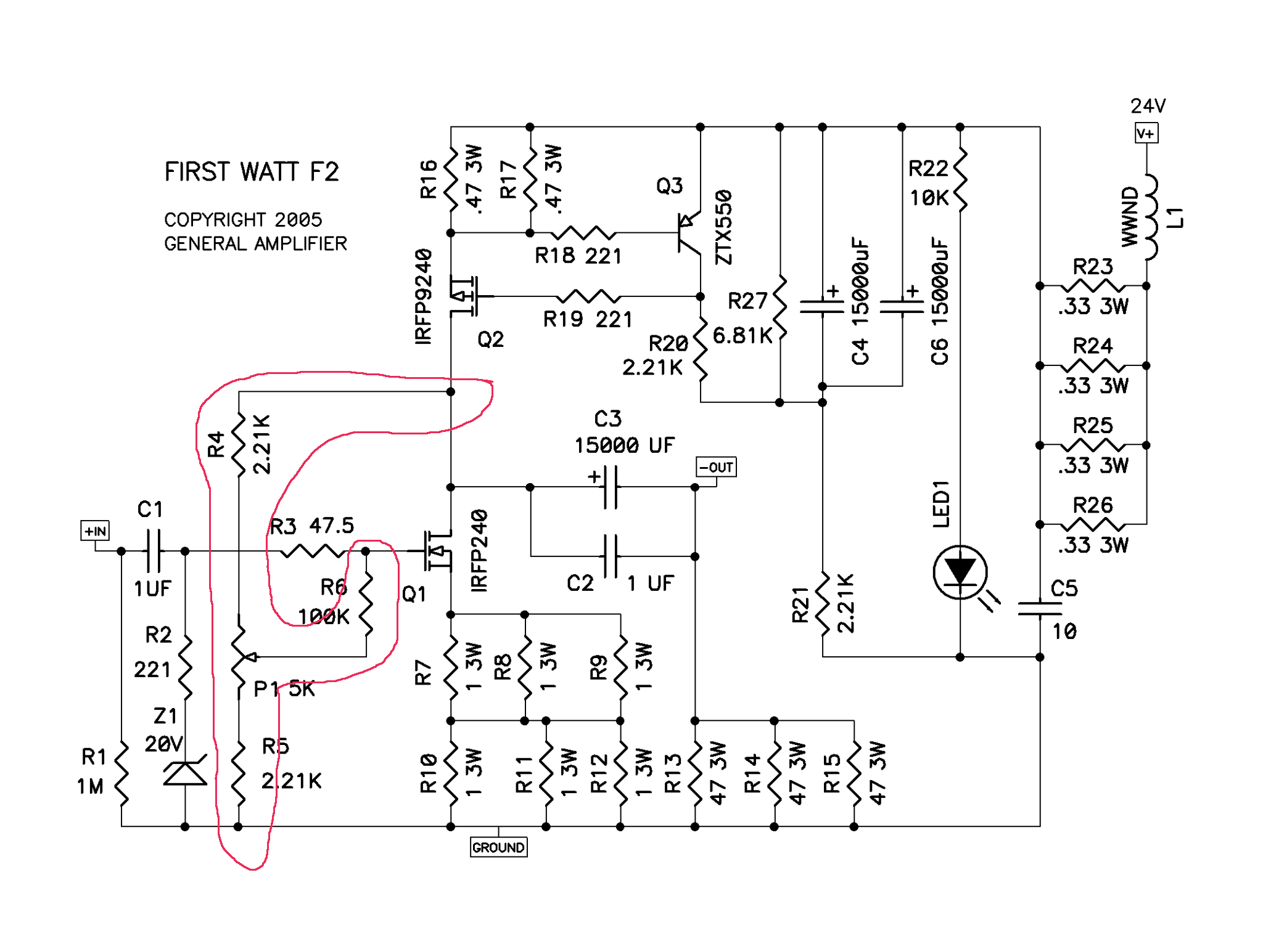

however... I’m not sure this still is a true current source amplifier. In the original F2, the current source behaviour was achieved through DC operating point feedback, but it looks like that feedback mechanism is missing here? I could be wrong, of course 🙂
I can't see that in files I have
