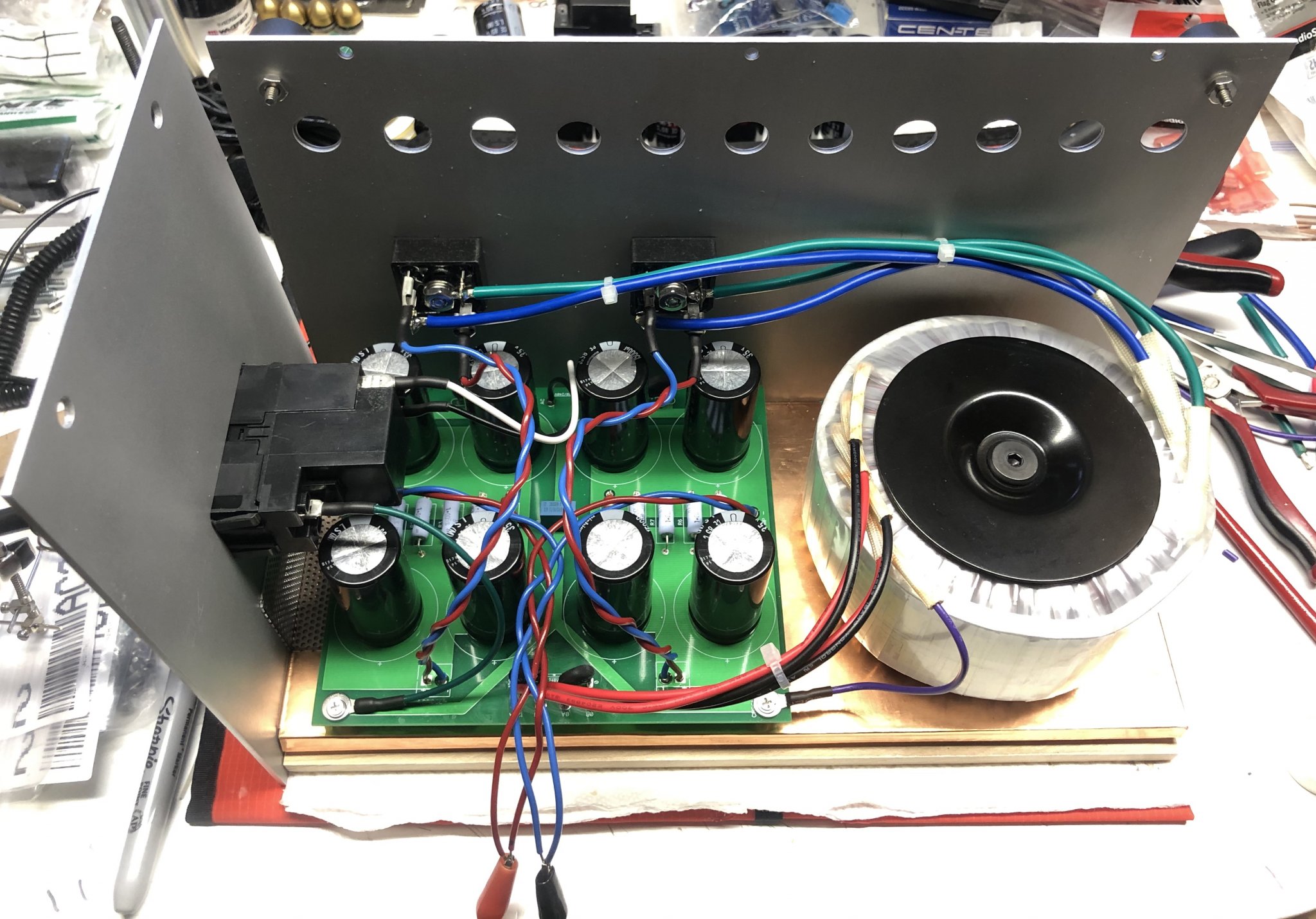

I built my F2J monoblocks with one Antek 4218 per monoblock.
I wired each Antek’s pair of secondaries with their own bridge rectifier which feeds a stereo single rail CRC board. I paralleled the outputs of the CRC board to my amp board.

Good point re possible future use, although having heard just an F2 I doubt I’ll ever dismantle the F2J. My understanding is that with dual secondaries you can just combine the 2 pairs to effectively make one pair for a single rail supply.What Dennis said^^^
