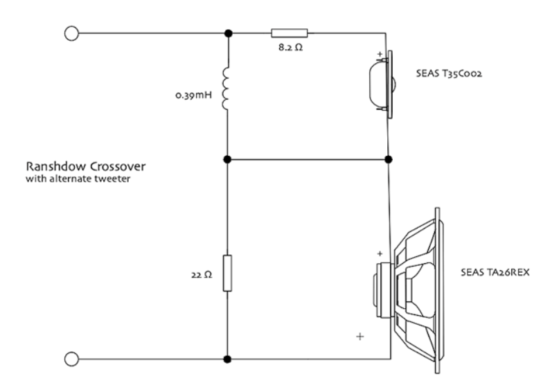

I thought for a series crossover that the filter elements were in parallel with their respective drivers. Instead of a series cap as a high pass for a tweeter, wouldn't you use a coil in parallel? With the full range in series with the tweeter/coil network?
Here's a series crossover calculator. I used it and my ears to design the crossover shown below.

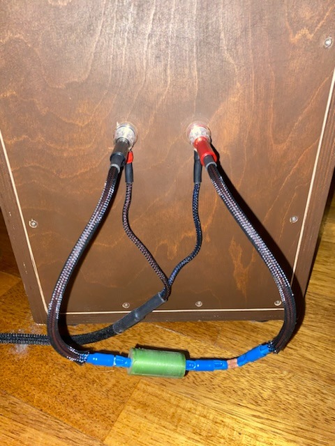

Now this pic ain’t much, and also it shows them crapass boxes. But adding an improvised test-network with some parts I had laying around, meaning non-optimized at all, really made a difference, friends!
Values concocted from Papa’s article from drivers with similar impedance curves. I set the 3db @ 1900-ish hz with the parts I had, hoping for primarily two things: reduced midrange level, less treble peaking and in turn: more bass for the buck. Allready added 3x47R across the terminals on my Alpairs iot tighten up the bass (increasing damping factor). Now there is just more of that ****.
And waddaya now, I can play extremely loud and it is just really all relaxed and detailed at the same time.
Need to make this **** serious, and buy a mike. But for now, I’ll enjoy it as is
For those wondering: RC consists of 8R/10uF. A bit high for both, but it’s a start. In time, finding ideal values, I’ll prolly make a box or something for the network.
