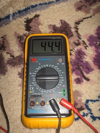

It has around 45V after filtering….so…not exactly there, but close enough. I just need to find some free time….

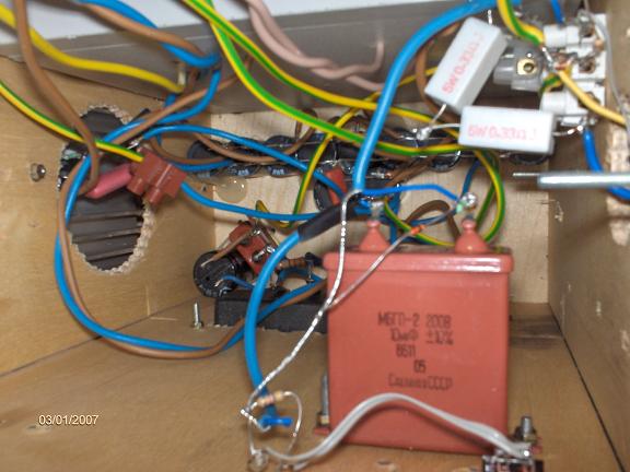

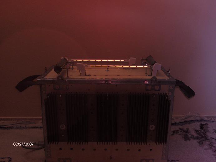

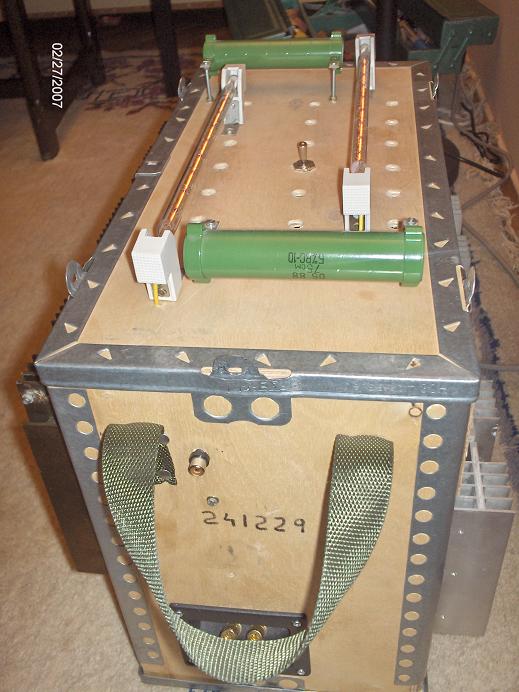

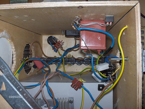

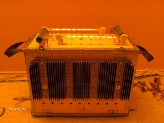

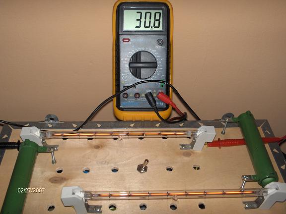

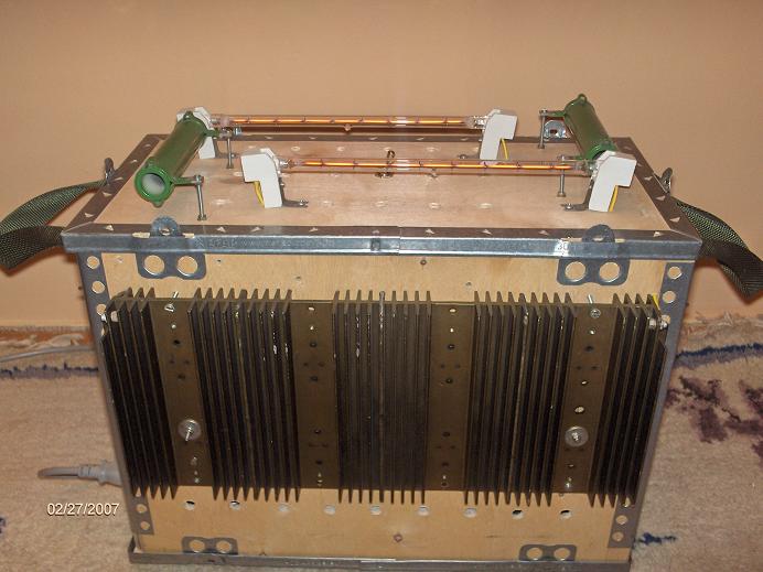

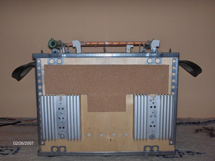

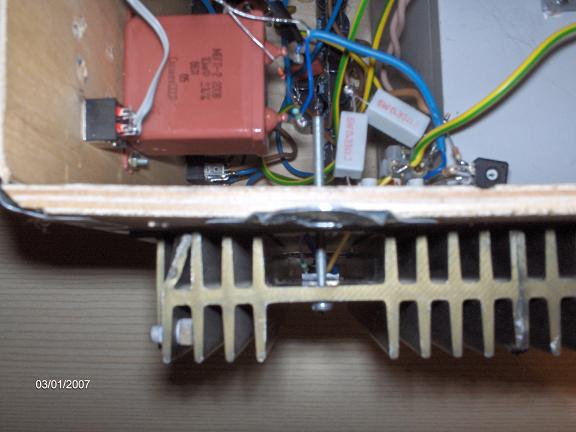

I guess that most of you wanted to see the interior of an F2, so I have made some pics. Nothing fancy, a lot of mess. I used various pieces of wire, not minding the color, as long as I was careful while making connections. Round holes seen on the inside are the result of my previous attempt to use 12v ceiling halogen lamps in series as a current source. While they looked nice from the outside, they released too much heat on the inside of the enclosure..so..I abandoned that approach, removed the reflectors, and put halogen sticks on top. To get a little bit more current, I added 75 Ohm resistors in parallel. The switch on the top serves to connect/disconnect these resistors (although it stays connected most of the time). I've decided to connect 220 ohm bleeder resistor at the output. With 1500w 220v lamps and 75 ohm resistors, F2 lite may have around 12 to 13 ohm output impedance.
Input capacitor is a 10 uF one, just because it was already there from a previous project, and I was too lazy to replace it...

That should be easily understood😉 Nice job and the glow is really cool, Vix😎 Those inputcaps looks like russian Paper-in-oil caps. Another advantage of your amp is: easily moveable😉Mmmm….I don’t want to press the Stop button on my CD player….
Steen🙂
steenoe said:.............. Those inputcaps looks like russian Paper-in-oil caps. ...........................
Steen🙂
probably from butchered russian spks 😉
steenoe said:That should be easily understood😉 Nice job and the glow is really cool, Vix😎 Those inputcaps looks like russian Paper-in-oil caps. Another advantage of your amp is: easily moveable😉
Steen🙂
Thanks.Yes, these are russian caps. 🙂
I bought them at a speaker shop in Bulgaria two years ago. 😀 They still seem to have these caps in stock.

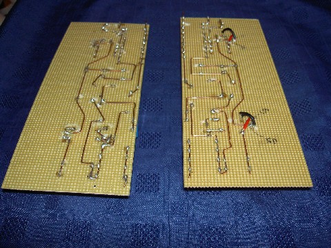

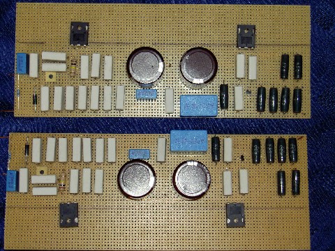

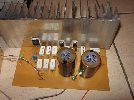

Pic of my F2
I've just completed building F2 to drive my old Flat8A. With typical voltage amp e.g. GC, JLH, Hiraga, blamless etc., it sound fat and muddle. But with F2 without the output resistors, it opens up the top end, pushes the music resolution to a higher degree and make the vocals sweet and nice. Is this the sound of second harmonic? Not according to what I've read so far. Why other single ended class A like JLH does not sounds like that? Can anyone describe the sound of second harmonic to me?
Will add the ouput resistors later on to see how it will change the sound.
Thanks Mr. pass for his generosity to share the design and Babowana for your comments.
Here's the pic of my F2 😀
