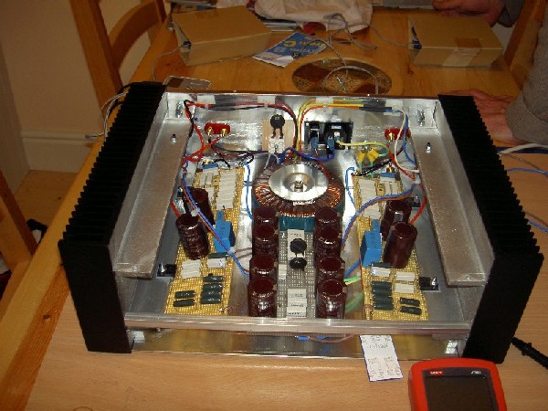

and here it is, worked straight away(phew)....
took it to a local meet yesterday which was a bit of a risk because I hadn't even listened at that point...it held its own in some very esteemed company and got some v.good comments from the valve(I hate ss) guys.
I will post my thoughts after listening over the next few days..
at the moment 3 of the 4 transistors run at 63 degs after 1 hour and 1 of them seems to like it at 72 degs...I'm thinking I might tighten the bolt on that 1 as a first step...the sink runs at a constant 38 degs. With nothing connected at input its inky black into my vofos(see my web site)
Its slightly more sensitive than my EL34 SE but I think already outshines it for exposing detail....early days!!

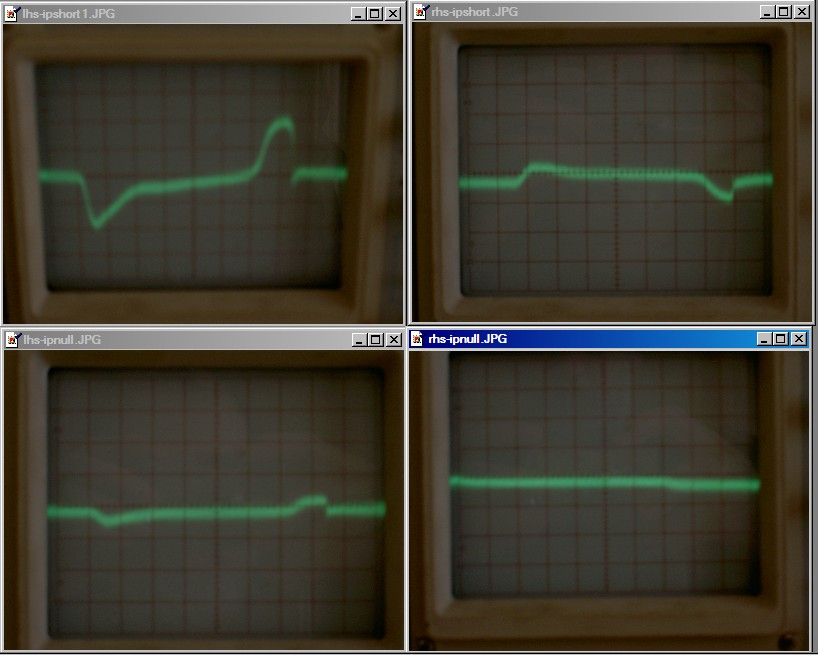

I've got a bit of a buzz on one channel which is driving me nuts and I wonder if anyone might have a guess at what might be amiss.
It won't measure on the DMM (< 1mv)and it probably wouldnt be visible with less efficient speakers. Its quiet with nothing in the phono, loud when shorted and in the middle when it has a source connected.
I think I'm looking at PS ripple here but would like some confirmation and any guesses as to why one channel should be louder than the other......the scope is set 1mv at 1ms..measuring output.

yippee
some degree of success getting rid of the buz...with the scope attached I tried various combinations of steel plate between the trannie and the lhs circuit board. Finally got rid of the noise with 3 sheets of 1/16 steel. Will now bolt this in as a permanent fixture as it saves building a wider chassis.
Still find it a bit strange that 1 channel is completely silent...

Hi Nelson
referring back to my post #168, the top traces are left and right inputs shorted. These clearly show the difference between left and right circuits. I'm sorry the text bars weren't a bit clearer.
I niavely thought that by shorting the input it gives a true picture of the power supply on the signal circuit, but its likely I need to be corrected here....a little bit of knowledge is a dangerous thing etc etc.....
If there is no difference between the gains of the individual circuits then it clearly shows that my particular torroid is as wayward as can be with its spurious emissions. I ended up twisting it nearly 45 degrees without the slightest change.
Regards
Ed
