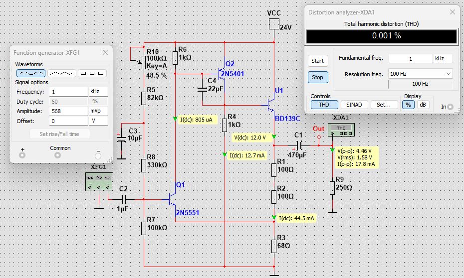

Here is my 3 transistor headphone design in Class A.
This version will suit both 250R and 600R headphones.

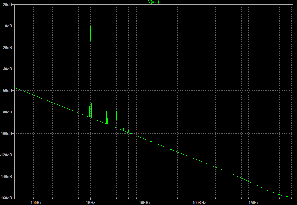

The picture shows 10mW (+20dB) into 250 Ohm.
The distortion is only THD 0.00054%
My 3 transistor project has been built by several members with good result.

R8 (with R5 and R10 pot) along with R7 set the bias voltage applied to the base of Q1.
Q1 has to be bias accurately to place the emitter of the BD139 close to half Vcc to maximise the headroom from the HPA.
Actually you could bias the voltage at the emitter of BD139 about four volts higher than half Vcc, ie 16V as you have lots of supply voltage..
With 44.5mA running through R3, the voltage at this point is 3.026V, and at the base of Q1 it would be 3.646V.
this is quite a good circuit from Lineout, but you could improve the linearity by replacing the R4 1k by a 12mA constant current source. He added a nice 22pF on Q2, but I would also suggest a 47R base stopper on the BD139.
The bias point should be set higher than half Vcc because the compound 3 transistor amp runs out of puff on the negative rather than the positive half cycle.
You also find that the harmonic profile varies slightly depending on the bias point, as you'd expect.
Hugh

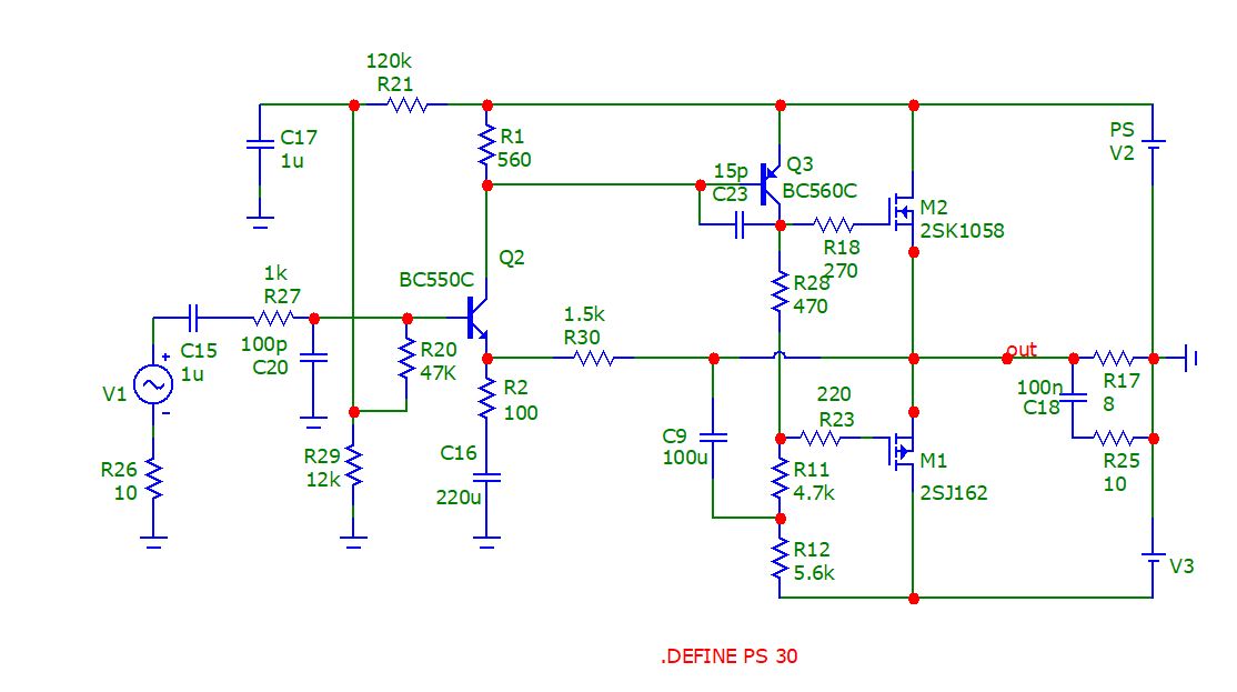

Hugh, was not asking about Lineup circuit but the one in #66. That's why i quoted it in my question.
I assumed that was to isolate the circuit from the source on 'gnd level'. If they both use the same signal ground R8 has no effect but if they don't, it may have.
@Nico or @Hugh: am I right or does the resistor of 10 ohm have an other purpose?

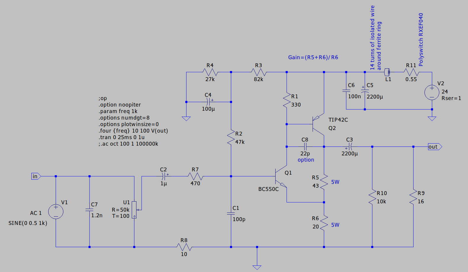

@abstract DT880 what impedance?

Because of C2 cap, R8 does nothing for bias of Q1. That i understand. I was just asking for its function, as i normally would omit it.
How big heatsink on Q2?

Ah, my mistake......
It is a ground lifting resistor, intended to cover any earth loops which might drive current into the ground of the input circuit.

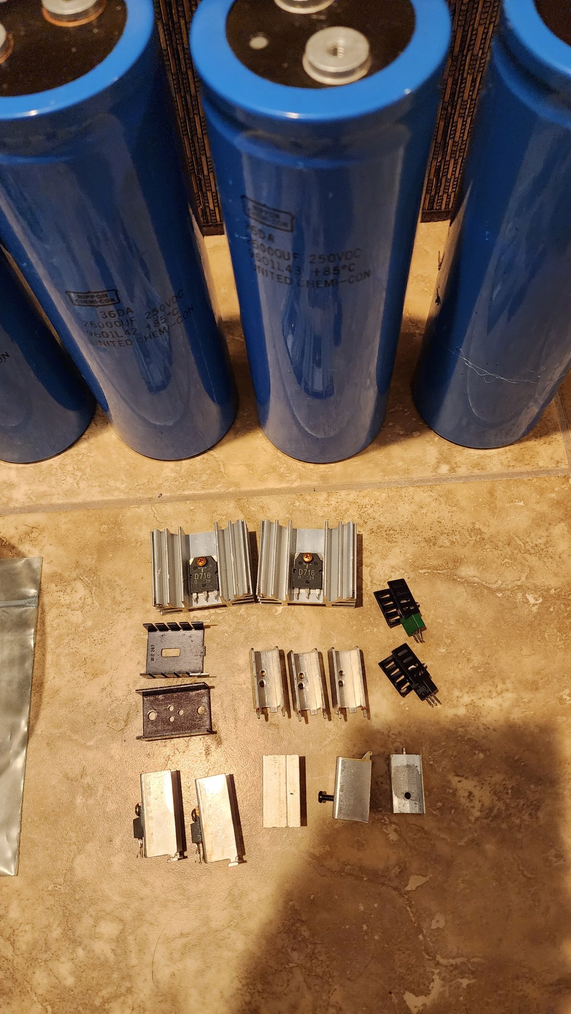

As configured, it would run almost 315mA through Q2, and I consider this absurd for a >32R can. Given the efficiciency of cans, say around 93dB at the ear from 1mW, 32R cans would use about 4Vpp, needing a max current of only 62mA for ear splitting Spl. I would set it no higher than 53mA, so use resistors of 120R (for 20R) and 270R (for 43R). No change to the biasing resistors, and I have allowed about one volt drop across the bias resistor, R2 of 47k. At this output current, Q2 will be dissipating 725mW so it needs a flag heatsink. You might also experiment with R4; I'd reckon reducing it to about 22k to bring down the collector of Q3 to around 14.5V, best for headroom but slightly less current to 37mA.
HD

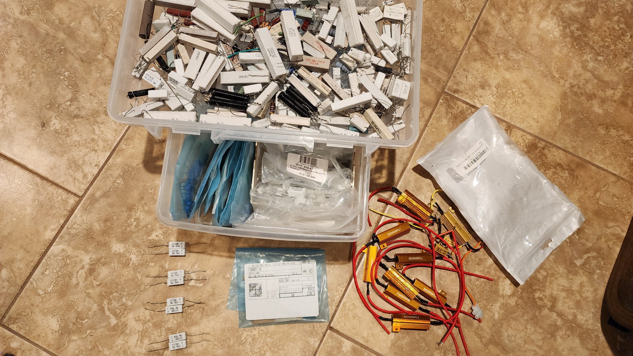

I will be using some of these scrap heatsinks for Q2. If i decide to go with high power version (20R + 43R) i will use those on top, or if lower power (120R + 270R) or between, than something smaller will suffice.
This will be based on all leftover parts, just like was my hamptone project. Still can yield interesting stuff. Nothing goes to waste.
But i have some fm active antena on the 'bench' first. I do not have bench, haha.
Ps: do not worry about those transistors on heatsinks, those are some leftovers from salvage, i will use new transistors, i have plenty.

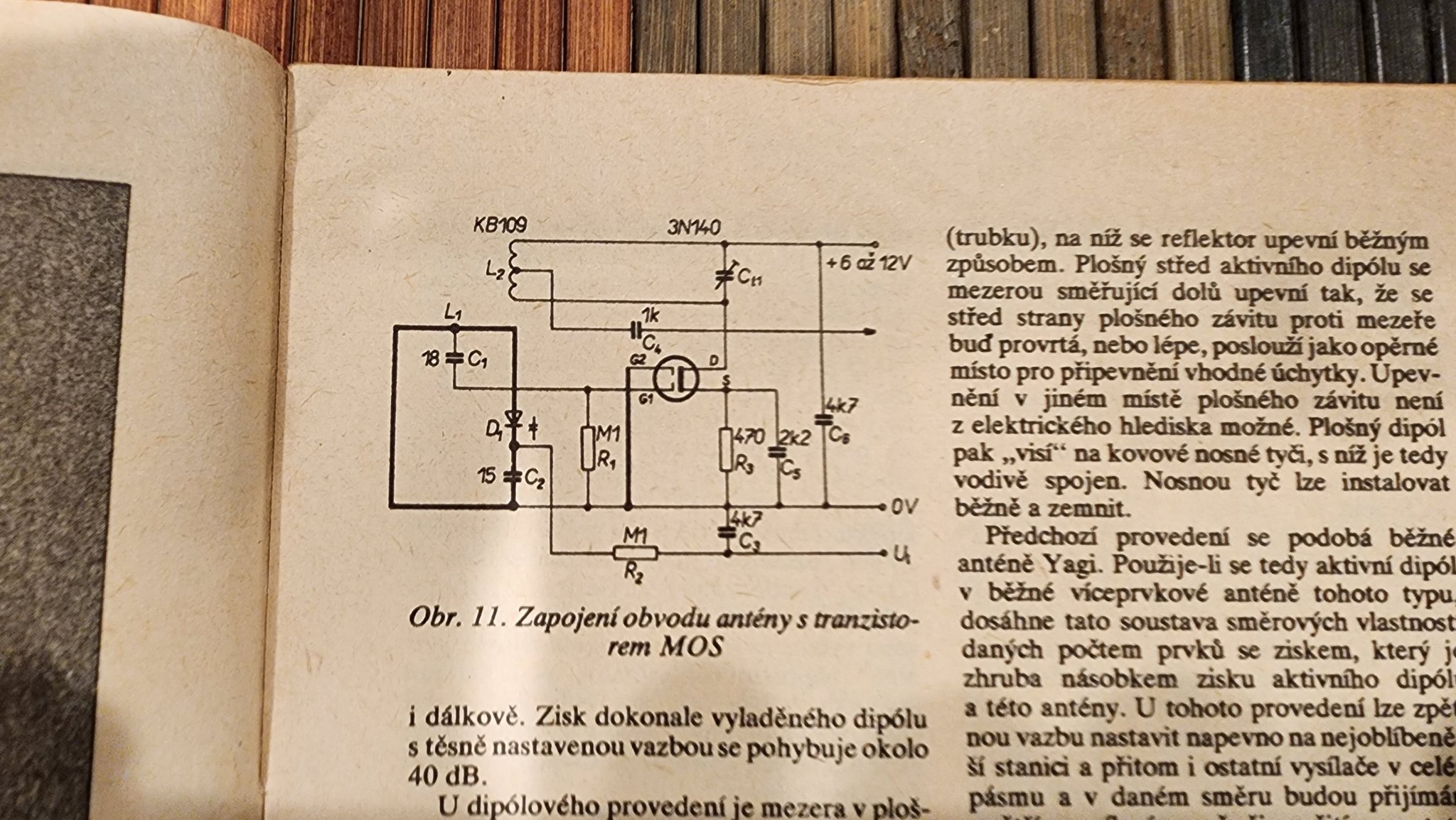

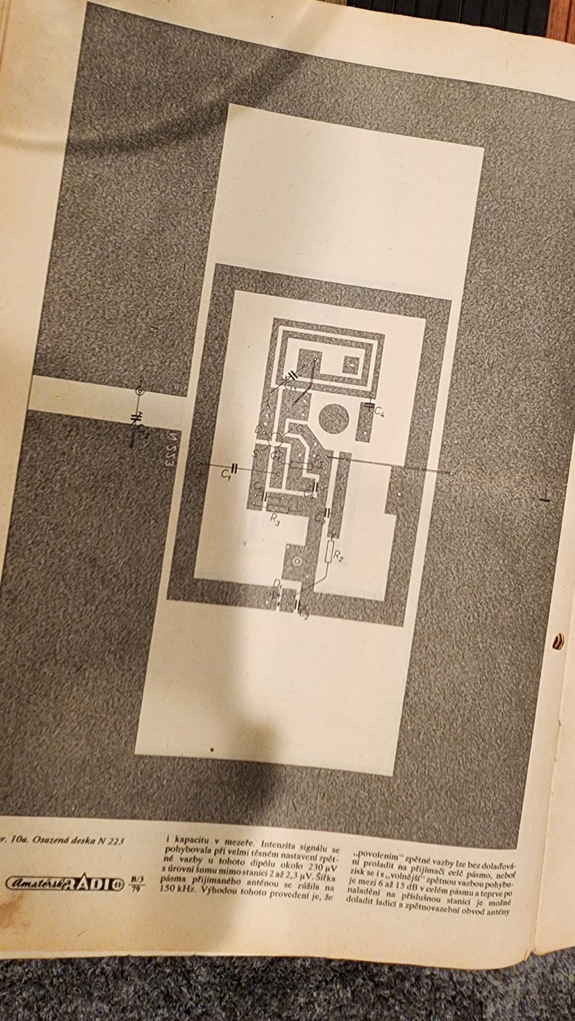

Sure, but its out of the scope of this thread. Its indoors or outdoors. Highly tunable, not only frequency to amplify, but gain as well. Its tree LC circuits with feedback. Pretty tricky to set properly, but once working, you get high gain with high selectivity. You can place the dipole into directional antena and gain multilies. Crazy. I used it in europe in old commies czechoslovakia to listen western fm stations in perfect stereo from hundreds of miles away. Just a teazer.
