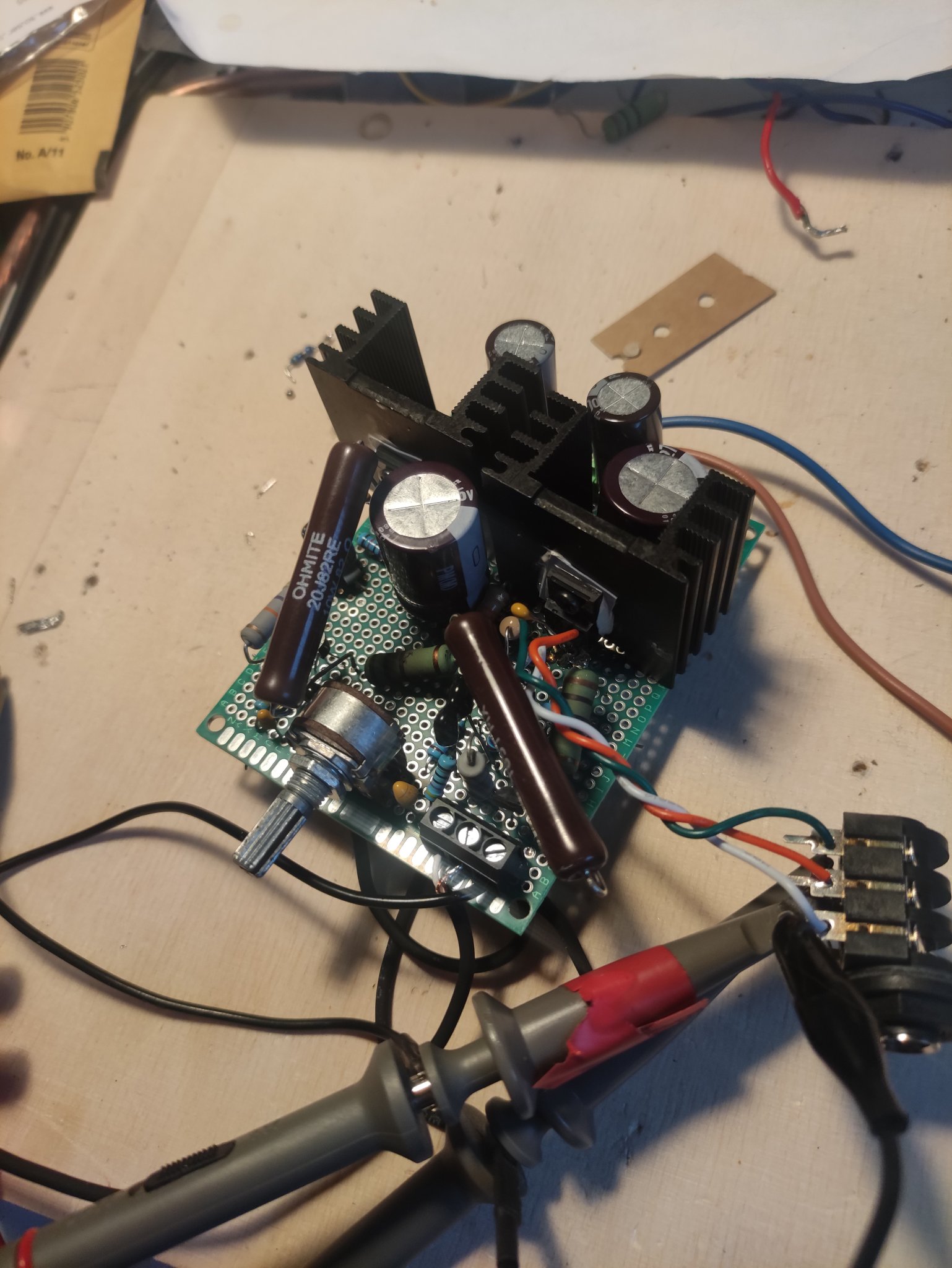

So Friends, finally had the time to rig that thing. Have you seen an ugliest protoboard?

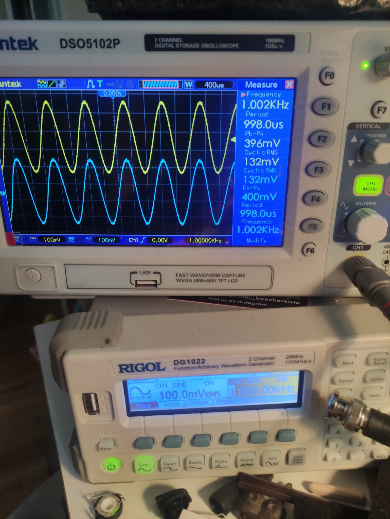

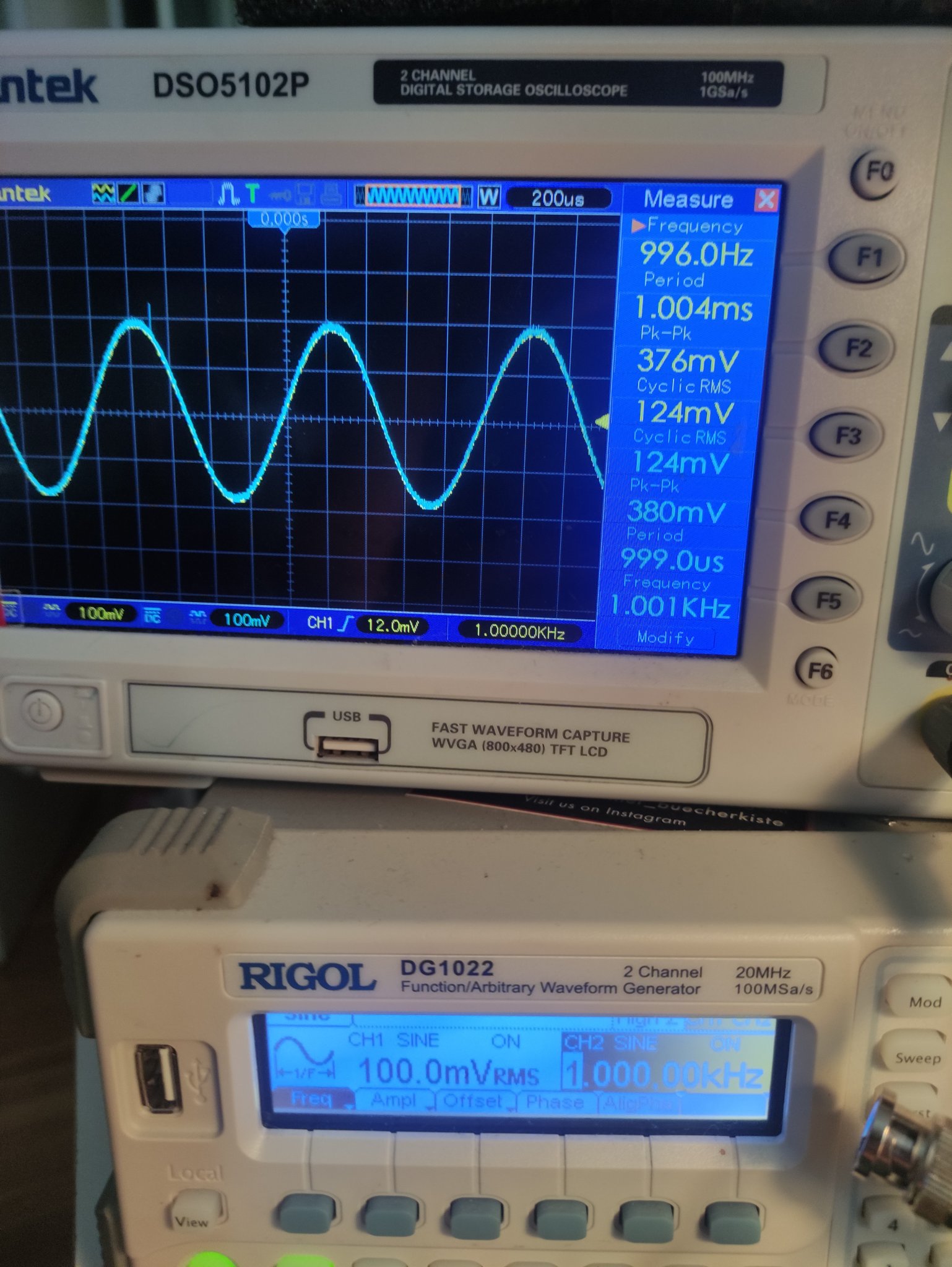

However... This amplifier doesn't amplify. For the output, I used 82ohm and 220ohm, what I had in my stash.
The two pictures show measurement at full volume with resistive loads, 16ohm the first, 56ohm the second.
There is barely an amplification.
Voltages seems right though.
Need other output R values?

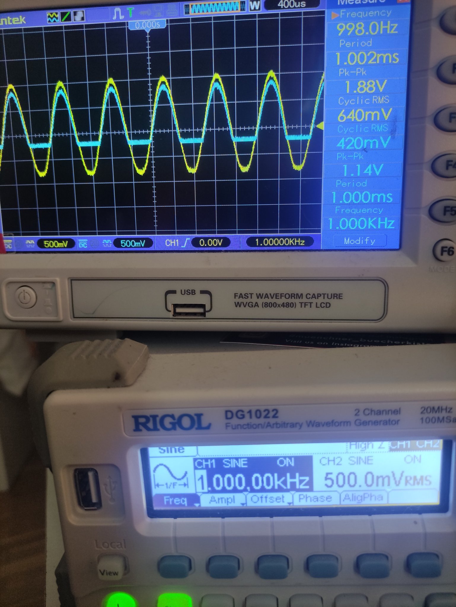

Edit:
I had current limiter on, yet it didn't get better: last pic shows output R of 16(clipping) and 56ohm, with input V of 0.5Vrms, how can be clean output V of only 0.64Vrms?
Re-edit, using a crap 24V/1A switching transformer... Need more juice...
