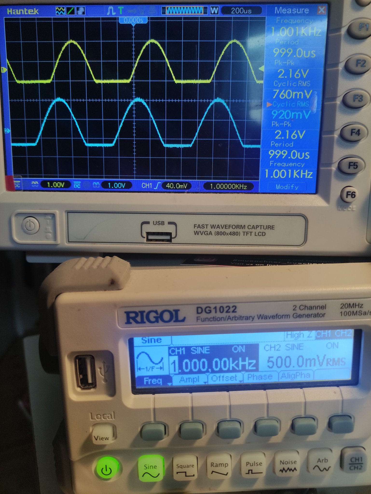

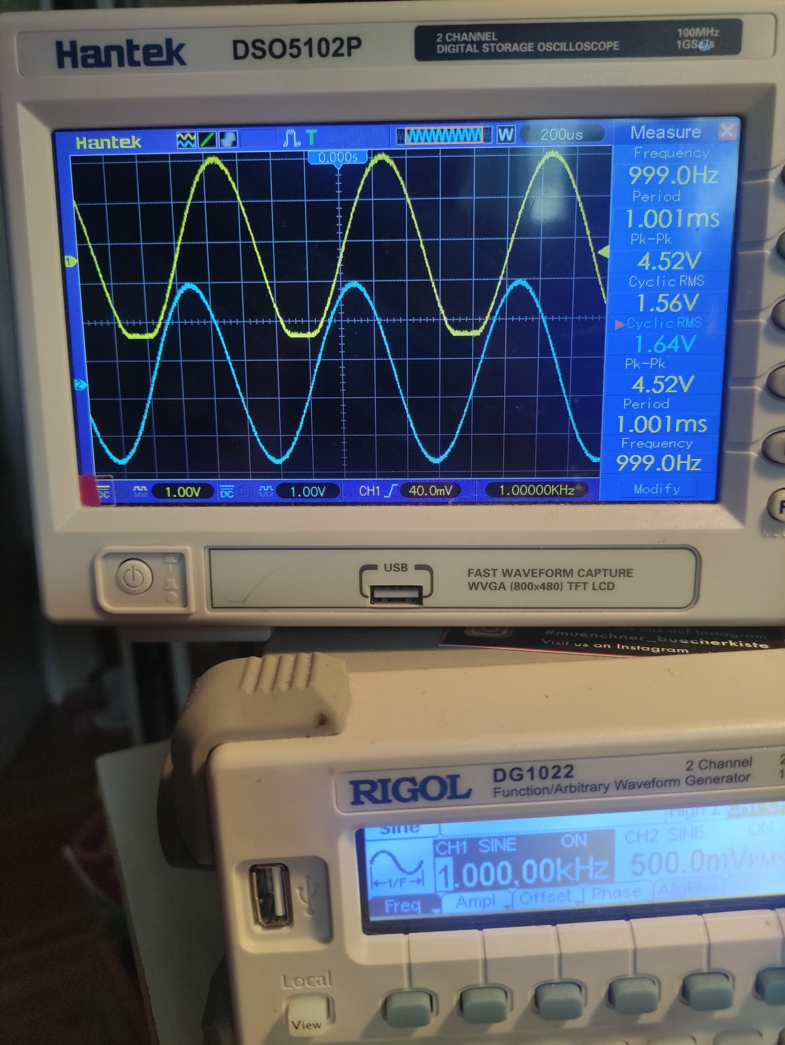

@AKSA thanks, this was a quick fix.
So for the 16ohm output impedance it clips (as expected) on the negative side, before amplification has effect. (First pic)
For a 56ohm load, clipping is delayed (second pic).
Guess have to lower R1 from 330 to 220ohm?
Second, it is REALLY loud. Have to have a look at R5 and r6 values.
Third, there's a slight channel imbalance, need to understand whether is the volume pot or the master transistors' matching.
Simulation confirms that.

When you drive a 16R load you need to set a very high quiescent. Let us select a 4Vpp output, which undistorted gives you 125mW into 16R cans, more than enough.
4Vpp gives 2V peak, so peak current will be 2/16 = 125mA.
This means you should set a quiescent of 150mA.
Now if your supply is 24V, set the output DC point at half 24V plus 2 and we get 14V.
Assume gain of 3, and 5mA flowing through the master transistor, we will pass 155mA through the lower resistor but we need to set about 3 times less voltage at the master emitter less O.6V. This gives you 4V at the master emitter so knowing it will pass 155mA this is 25.8R, npv would be 27R.
Last we choose the upper resistor, and we know (27+X)/27 = 3, so X is 54R, npv 56R, gain will be 3.07.
There are a few issues here such as base currents but this will work well.

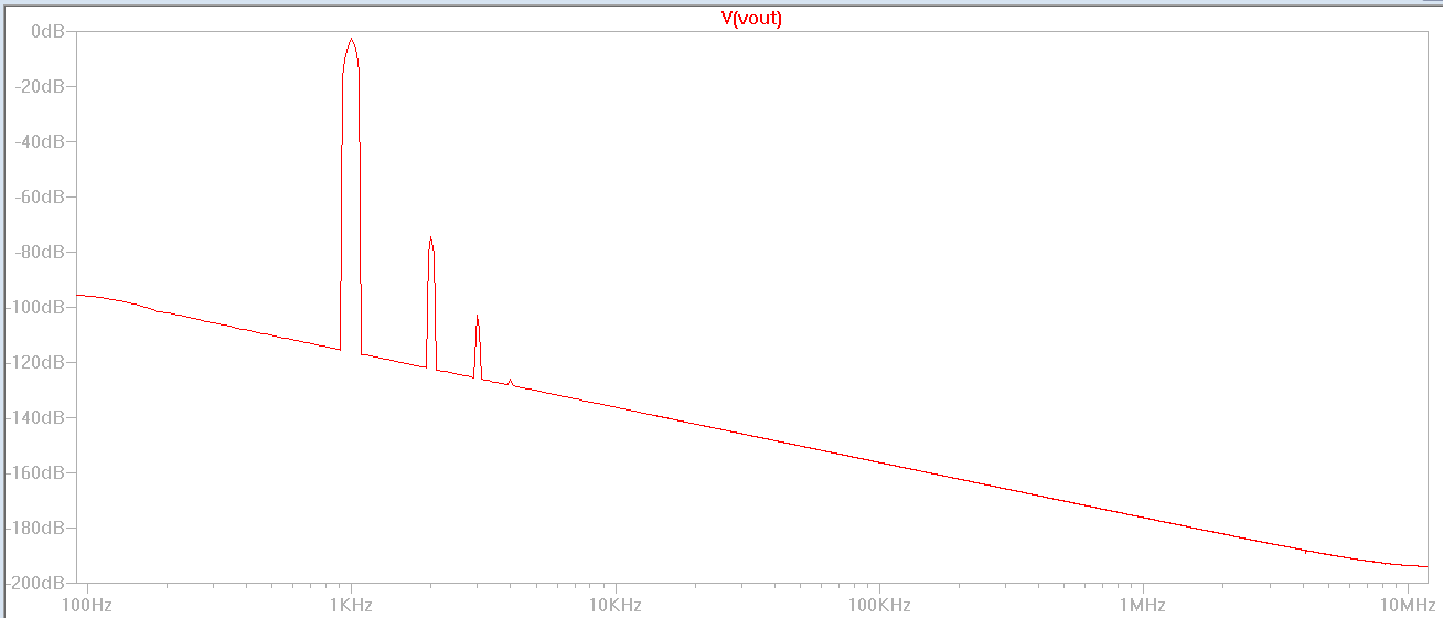

BTW, it is a VERY good preamp, improves any power amp and is almost warm, like a tube. Here is the harmonic profile at 2Vpp into 22k at 1KHz:
THD is 0.025%, highish, but H2 is dominant at -72dB and H3 at -101dB. H5, the nasty one, is at -150dB. Zout is only 15R, great for crappy cables. A CFP is a very good building block, very powerful and linear, but only in Class A. Some care is needed to ensure stability, however.

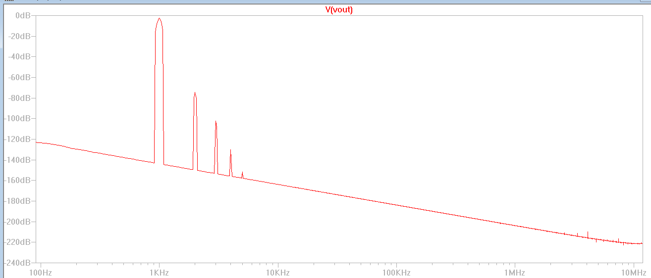

I have a theory about the frequency rolloff which may be nonsense but here goes:
Could it be the simulation program (in my case LTSpice) does not take into account the harmonics when calculating the frequency sweep? If so that explains rolloff at 80kHz in simulation and 16kHz rolloff in practice.
Then eliminating the rolloff also eliminates the harmonics. In any case I leave it as it is. The characteristics of the amplifier are probably for a great part determined by the 'harmonics profile'.
I can't see why LTSpice is making this mistake. My output drops from 1Vpk to 800mVpk from 10Hz to 10 megahertz, and no drop at 1MHz at all.
It doesn't make sense to me that dropping the harmonic calculations would interfere with the rolloff.
I do see a 1dB rolloff at 1MHz for 1Vpk output into 22k with a 100pF stability cap from base to collector of the slave, but absolutely nothing at 200KHz.
In all cases the harmonic profile is a typical h2 75dB H3 102dB H4 130dB H5 156dB, little change across the entire audio range but I admit this is a simulations, not measurement. I don't disagree with your measurement issues; reality is reality. The secret is to find WHY this is happening..
I would be looking to replace the slave to a fast transistor, say a 2SA1381 and a fast master say 2N5551.
