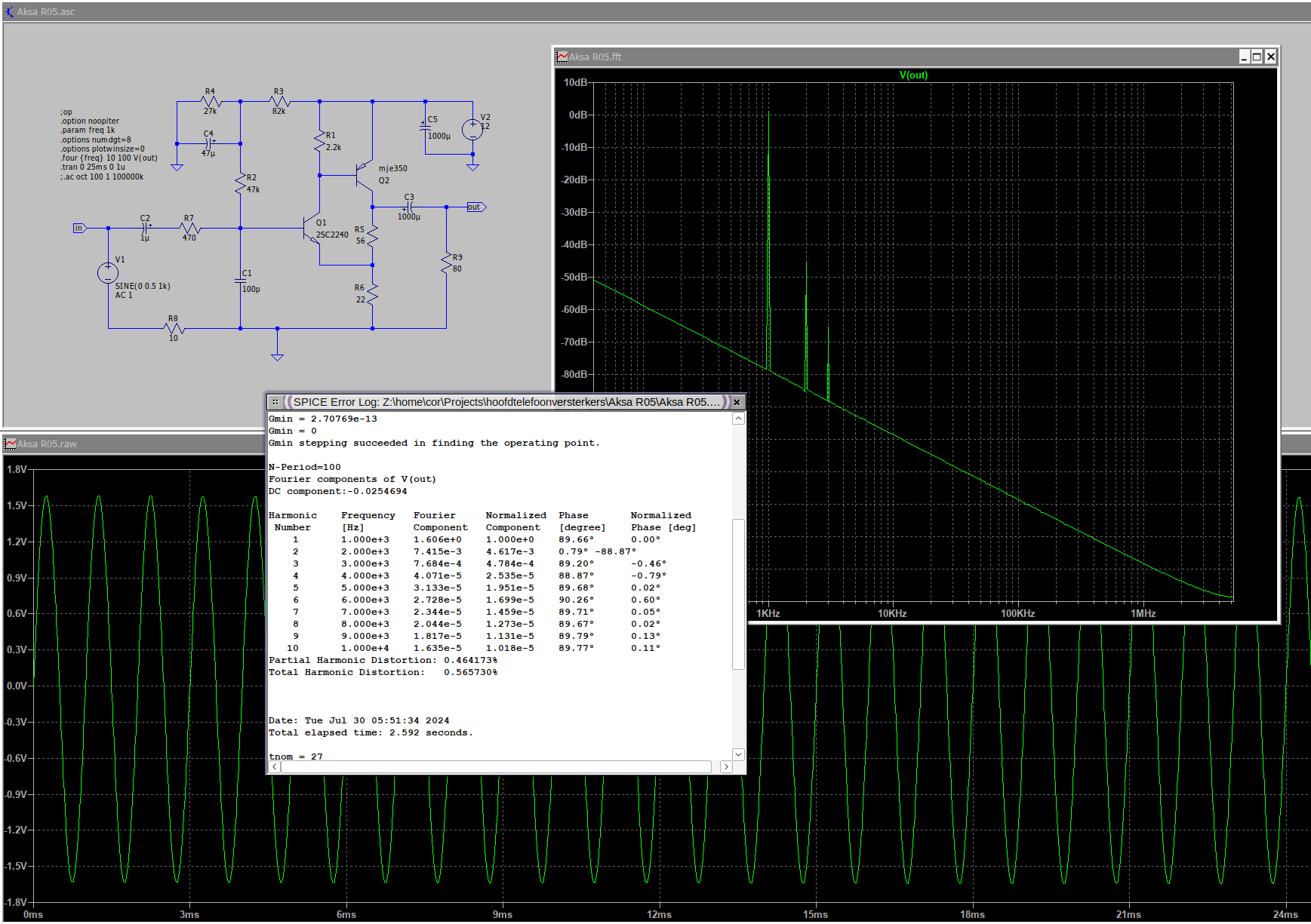

Studying and simulating this schematic it occurred to me that this design of AKSA and Nico Ras is --deceptively-- simple. Although it consists of only two BJT transistors and some other components, the value and probably also the quality of all components determine the outcome. So that is the case with the U2/R12 combination, the choice of transistors, the use of R13/C1 and R7, R5/R6, filtering the supply voltage and probably much more that I am not aware of.
I made the harmonics profile changeable by using a multi-turn pot (U2). The combination U2/R12 set to 27k results in nice harmonics and sound using my 80ohm headphones at 12V supply voltage. If you use headphones with a different impendance you may want to change the value of U2 to your liking. Or, if you want the least distortion possible you can set that as well. Increasing the supply voltage also changes the harmonics profile. So there are a few different, simple ways to modify the workings of the circuit, making this a flexible design.
Originally I removed R13 and C1 to save some space on the small 4x6cm prototyping board. I should not have done that. Testing it I noticed signs of oscillation so I had to add R13 and C1 again, and I also added R7 just to be sure. That helped to get rid of any possible oscillation.

Well spotted Michelag! When I was testing it the circuit was motorboating like crazy and some components became hot. Should not happen, I thought, because I remembered AKSA saying to you 'typically you would use at least 10uF per ma in the supply'.
LTSpice says one circuit draws 93mA at a supply voltage of 12V.
So that needs one capacitor of 2 x 93mA x 10uF = 1860uF. 2200uF should be more than enough using it at 12V supply voltage.
And that was true: after I connected signal ground to the correct, 'clean', side of the inductor, motorboating stopped and everything became normal.
The circuit drew m u c h more current than usual when motorboating. Even 4400uF was not enough.

Thank you for your answer Hugh. I want to experiment using a D45H11 BJT for Q2 which has a bandwidth of 40 Mhz. Simulation shows a nice second harmonic and hardly anything else (I changed the circuit somewhat to achieve that).
As I understand it, using a faster BJT like a D45H11 increases the chance of oscillation. I will probably use a ferrite bead in series with a 47 ohm carbon resistor at the base of both Q1 and Q2 and see what happens.
