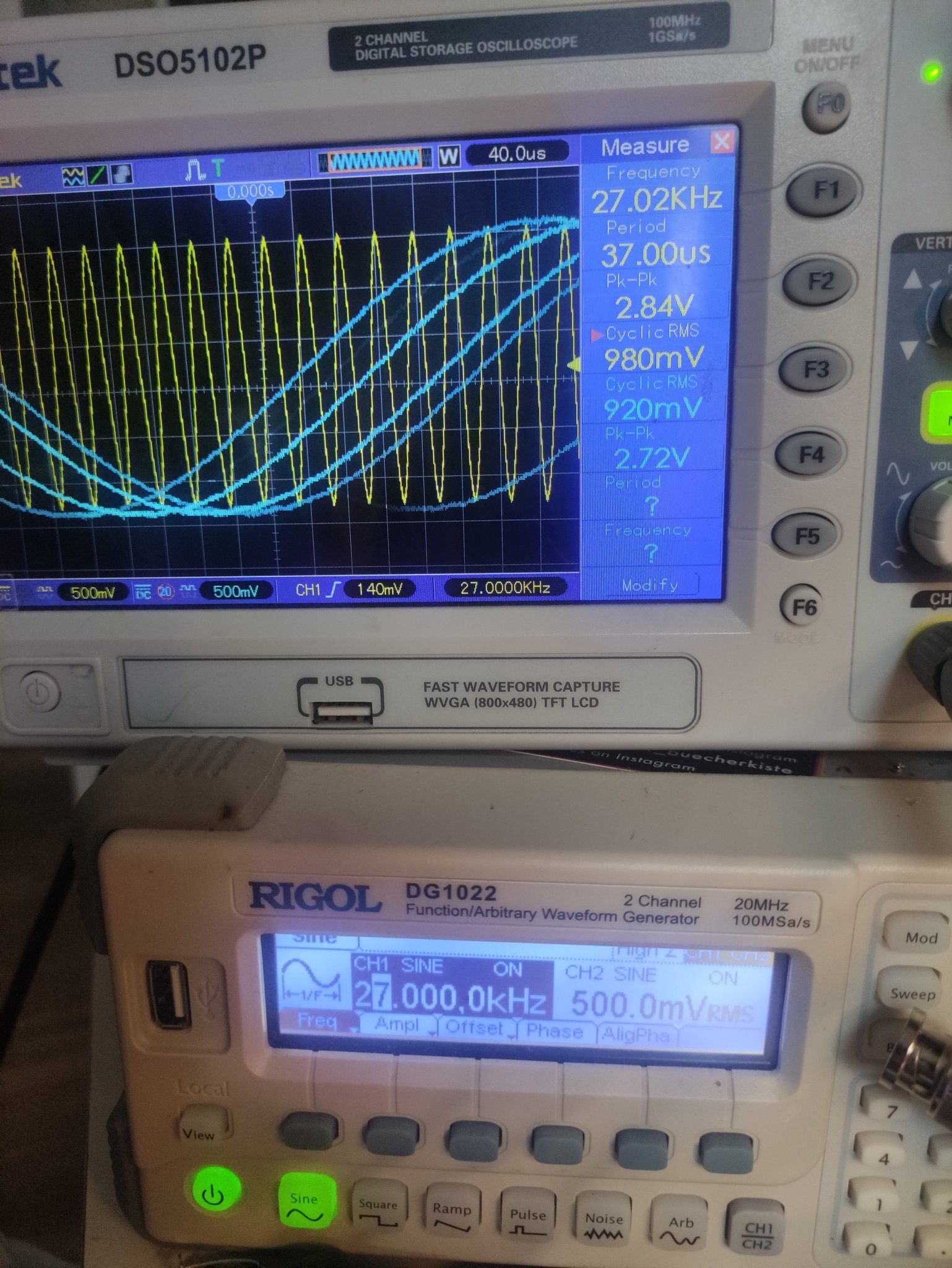

Ok friends, again there.

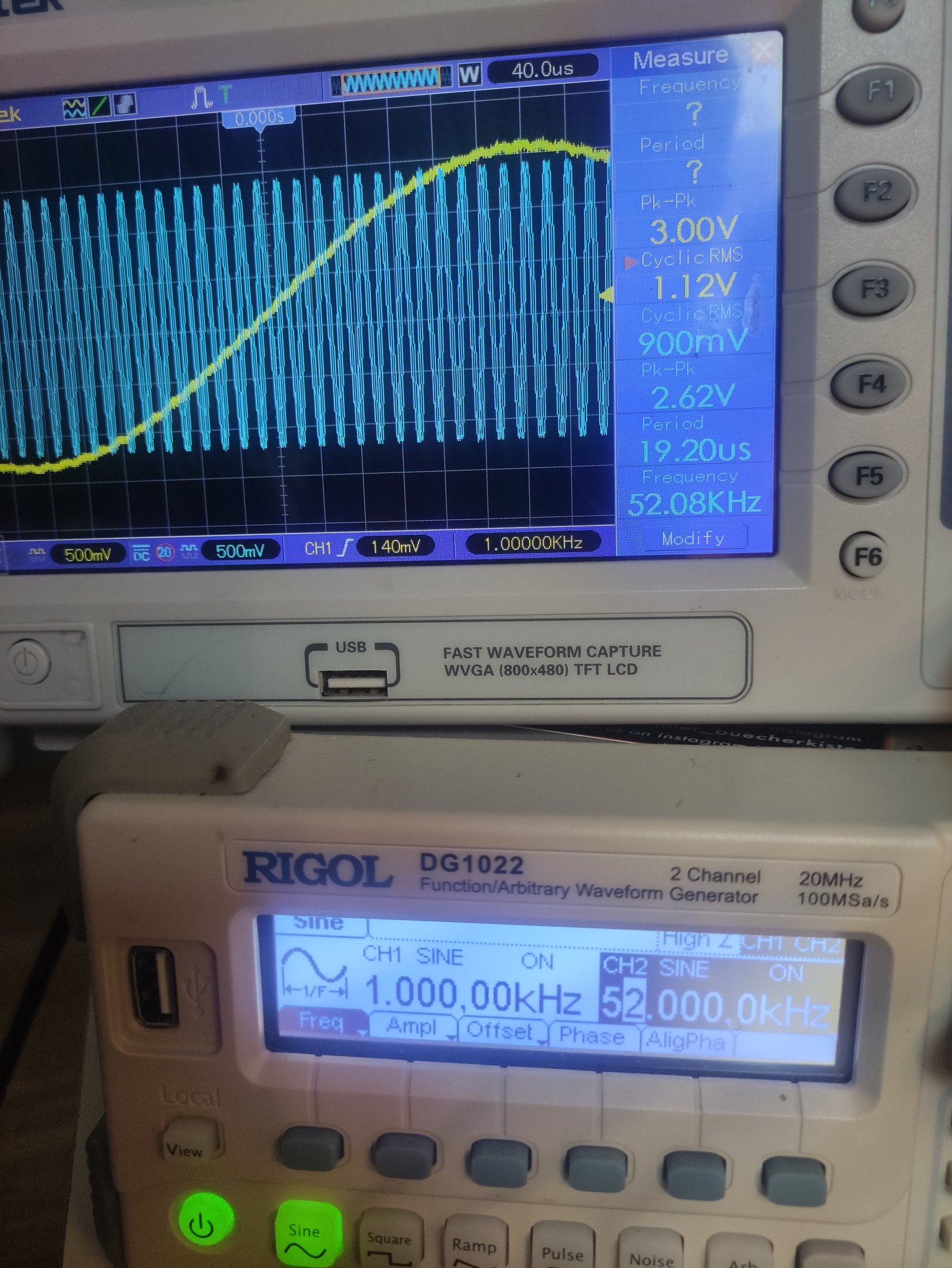

Treble rolloff doesn't appear on the left channel.
Last time I measured only right channel.
On the right channel -3dB point shifted to 22kHz.
I have an idea on what's happening... Let me make some order here and I guess it'll be fine.
Now it's a mess!

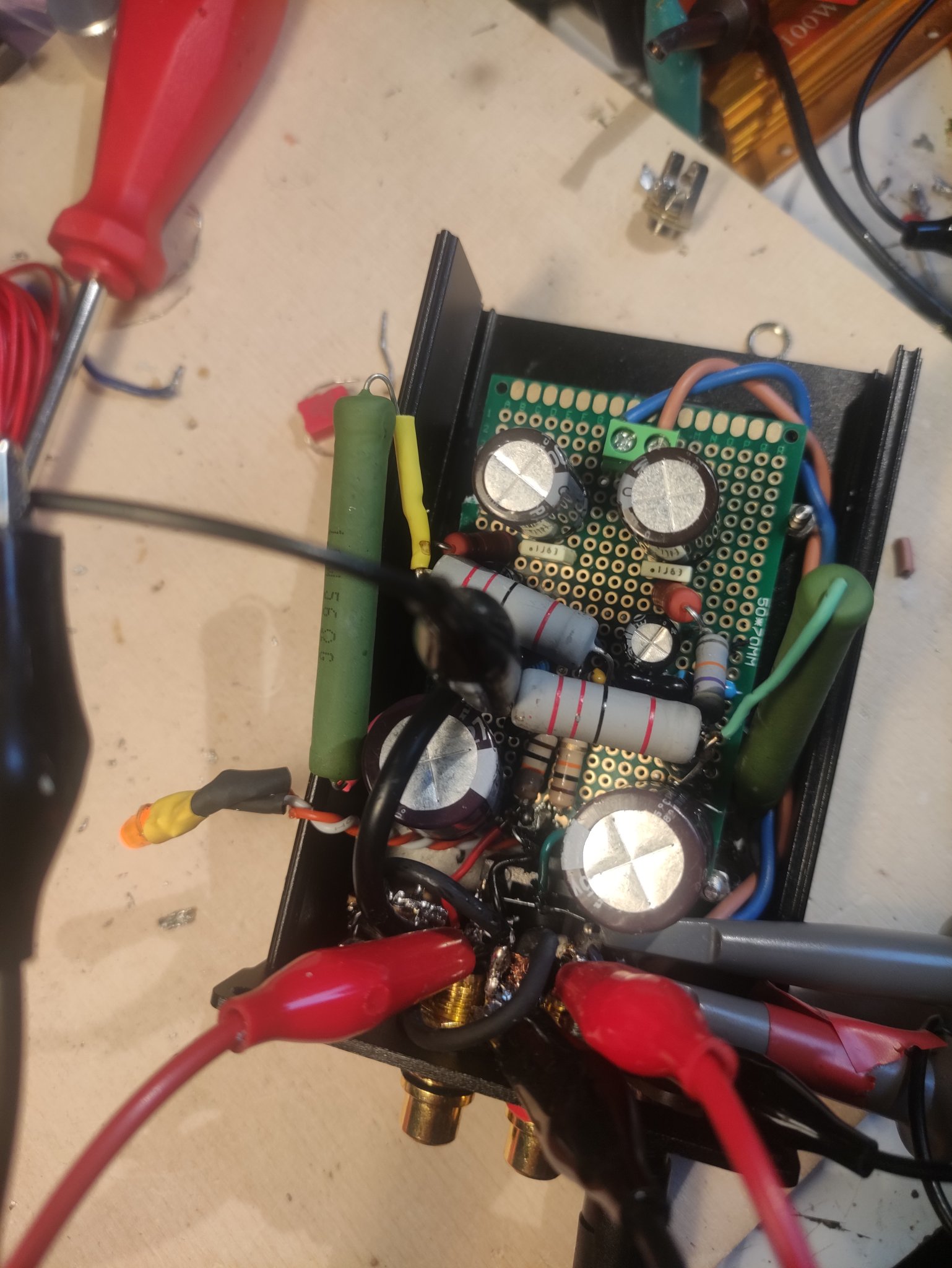

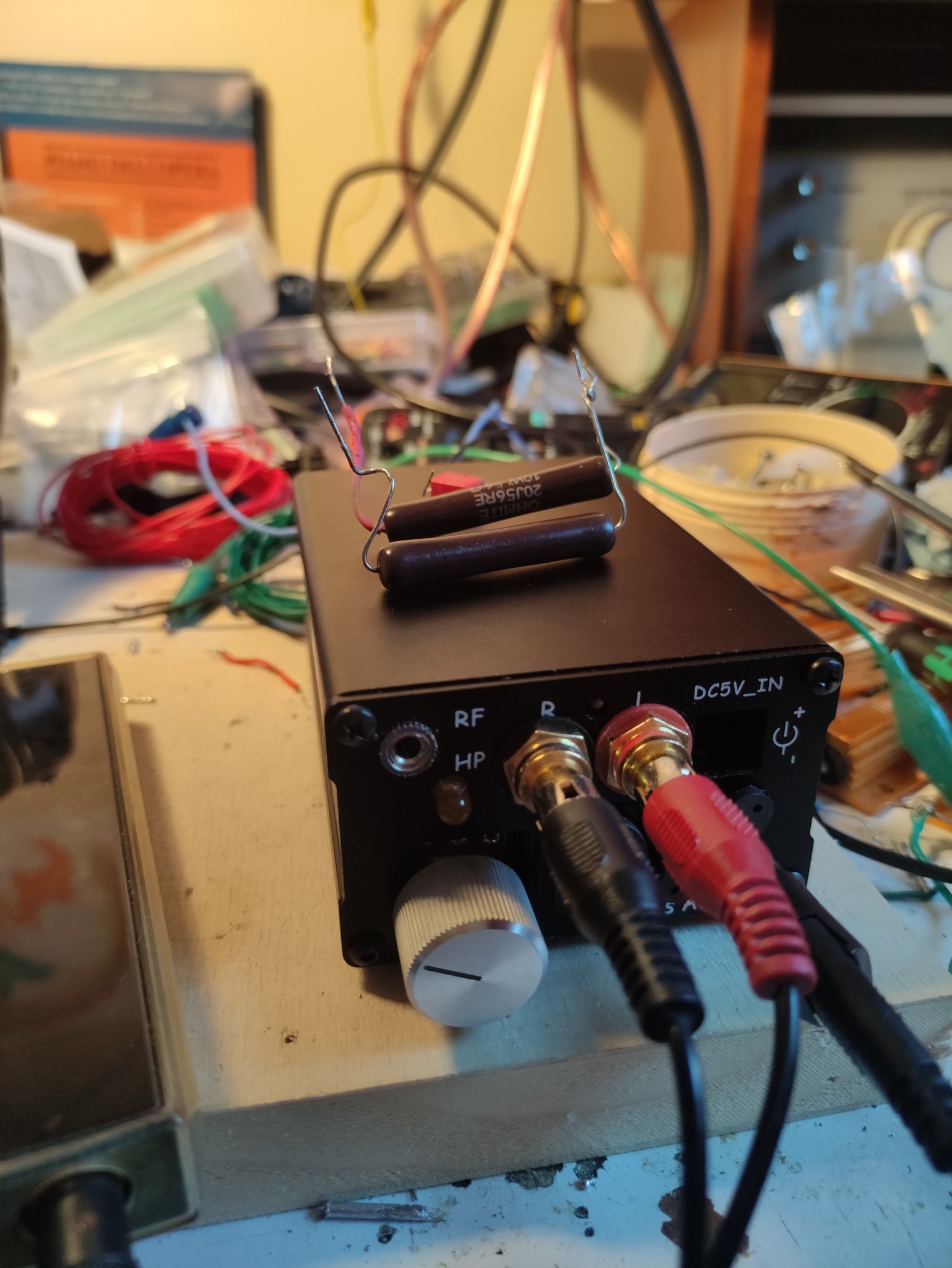

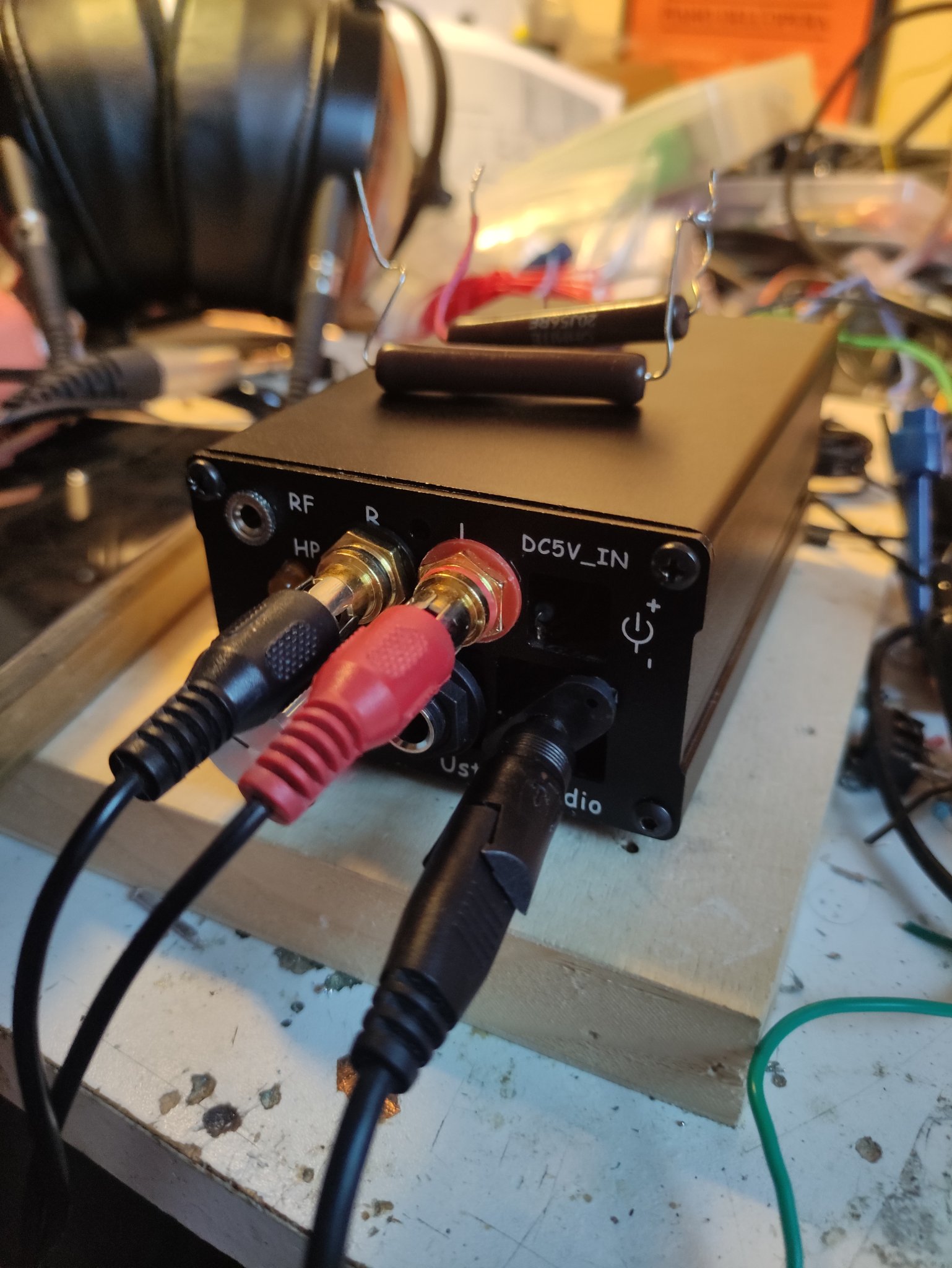

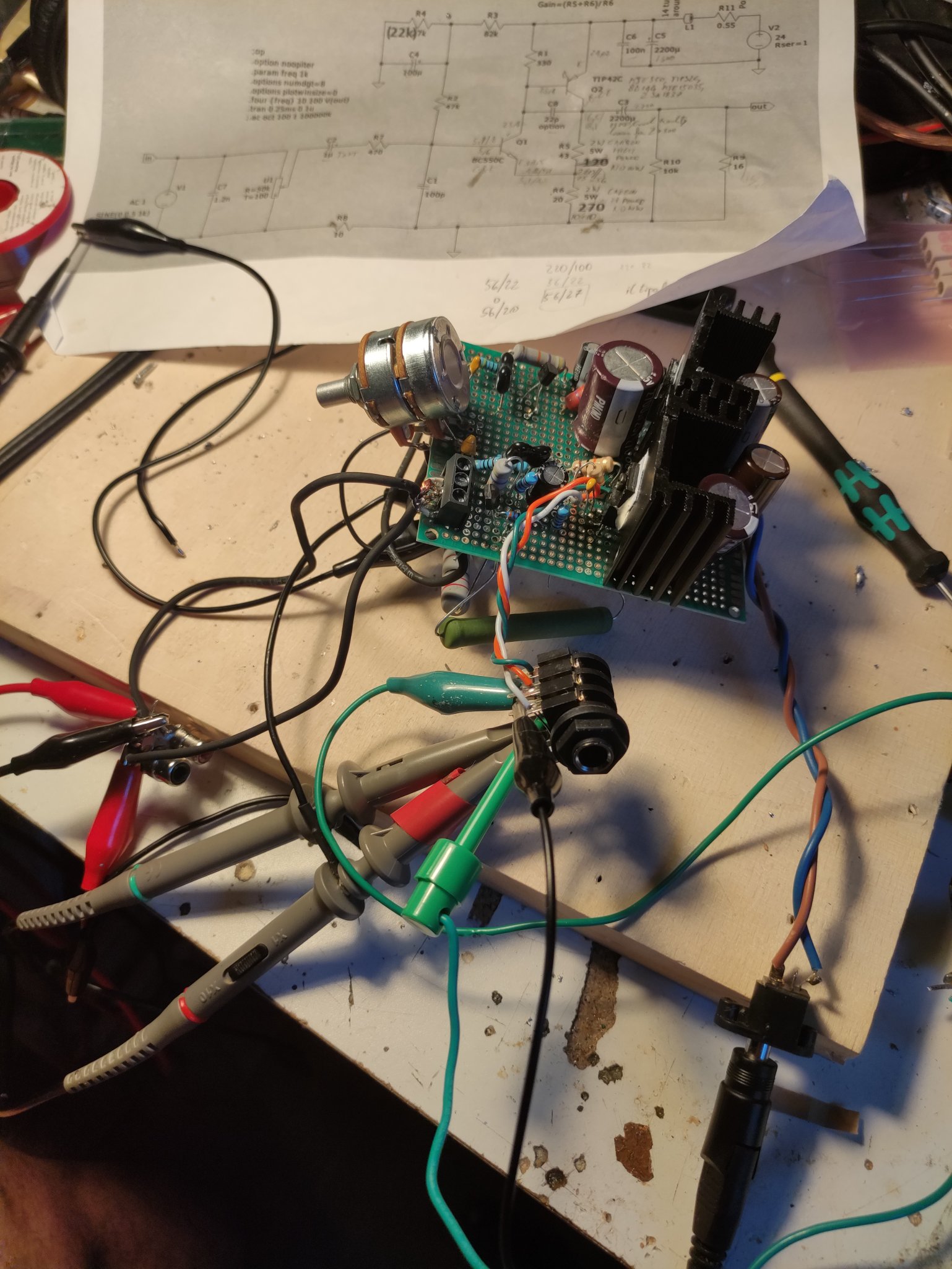

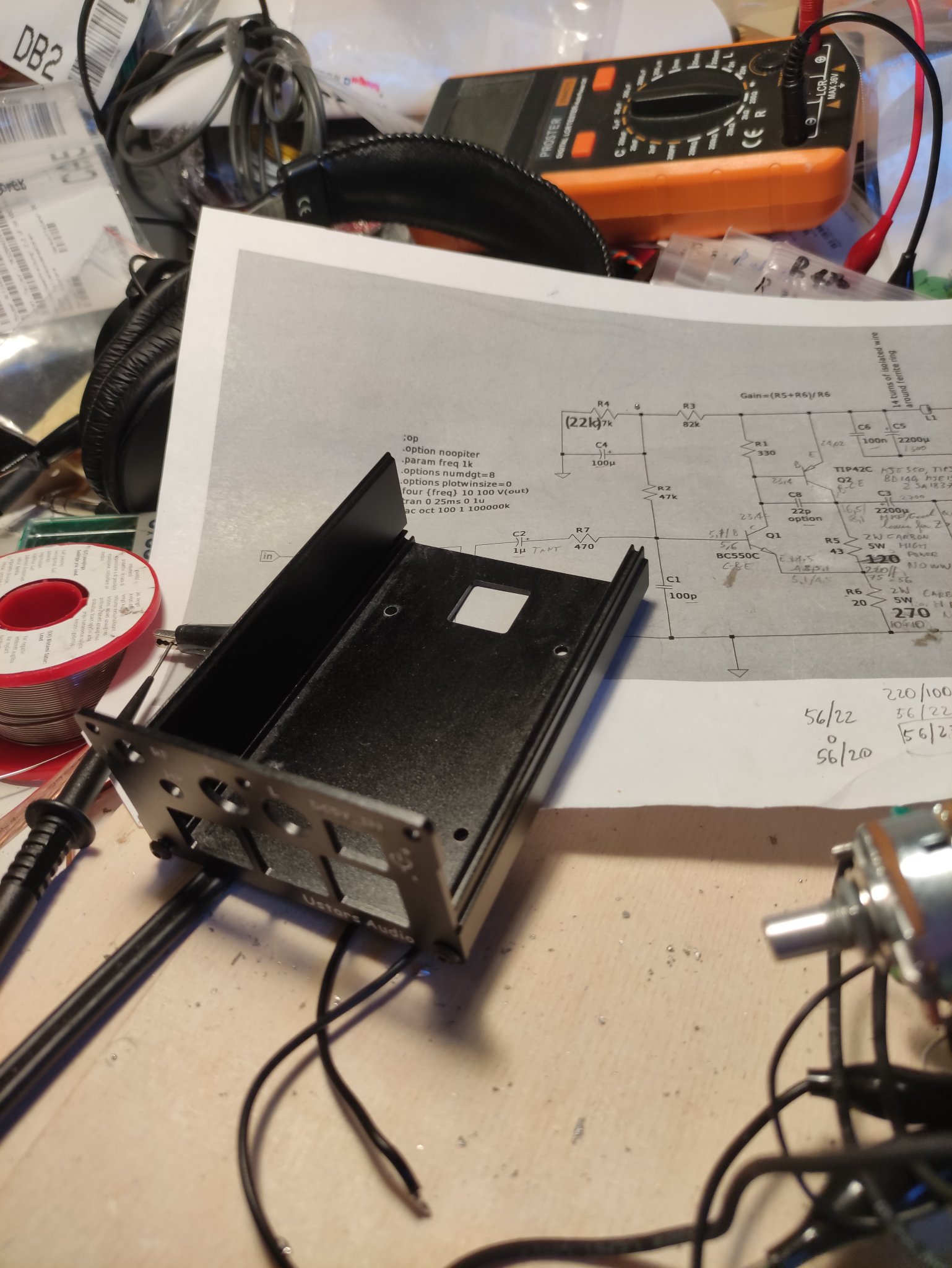

Friends, in the end i would call this little amp "the wire". It is a really really nice small amp, with tons of power. Incredible. My 20ohm planars are now singing.🤩
Target was using everything I had stocked (apart 2sa1387 or was it 1384?), and so be.
I used a case from a Chinese raspberry+DAC which lied abandoned, and very few components.

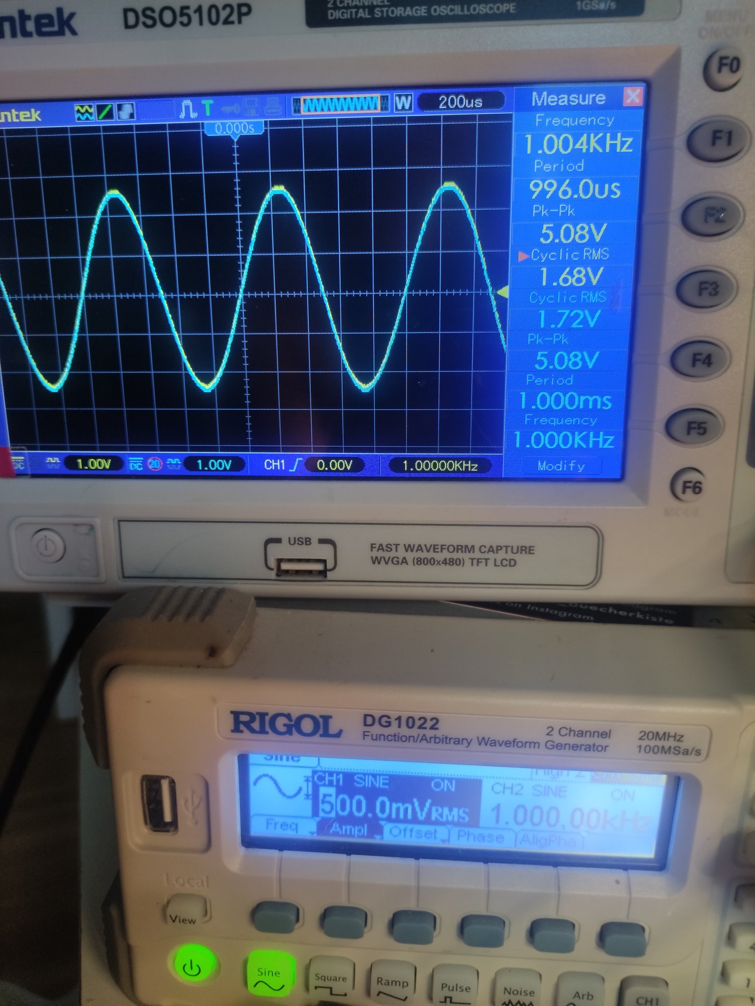

Apart from the usual pictures, let's have a look at the scope:
IMG_20240817_195427.jpgIMG_20240820_174353.jpgIMG_20240820_185847.jpgIMG_20240820_192726.jpgIMG_20240820_192730.jpg

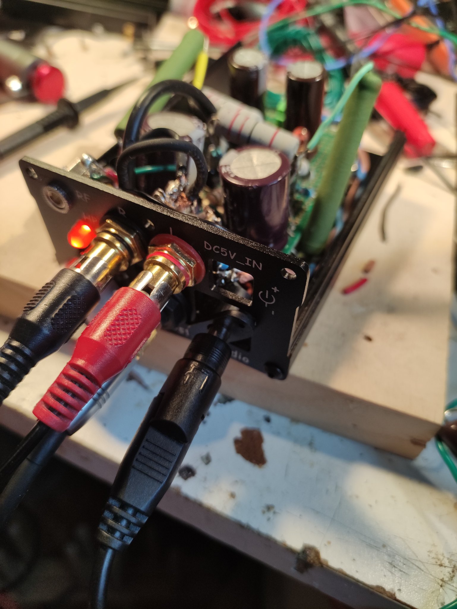

This is the beginning to the end result
Rolloff is gone. Perhaps it was the capacitance of all these cables in the wild configuration, I don't know. Something around 57khz has a small dip, but who cares?

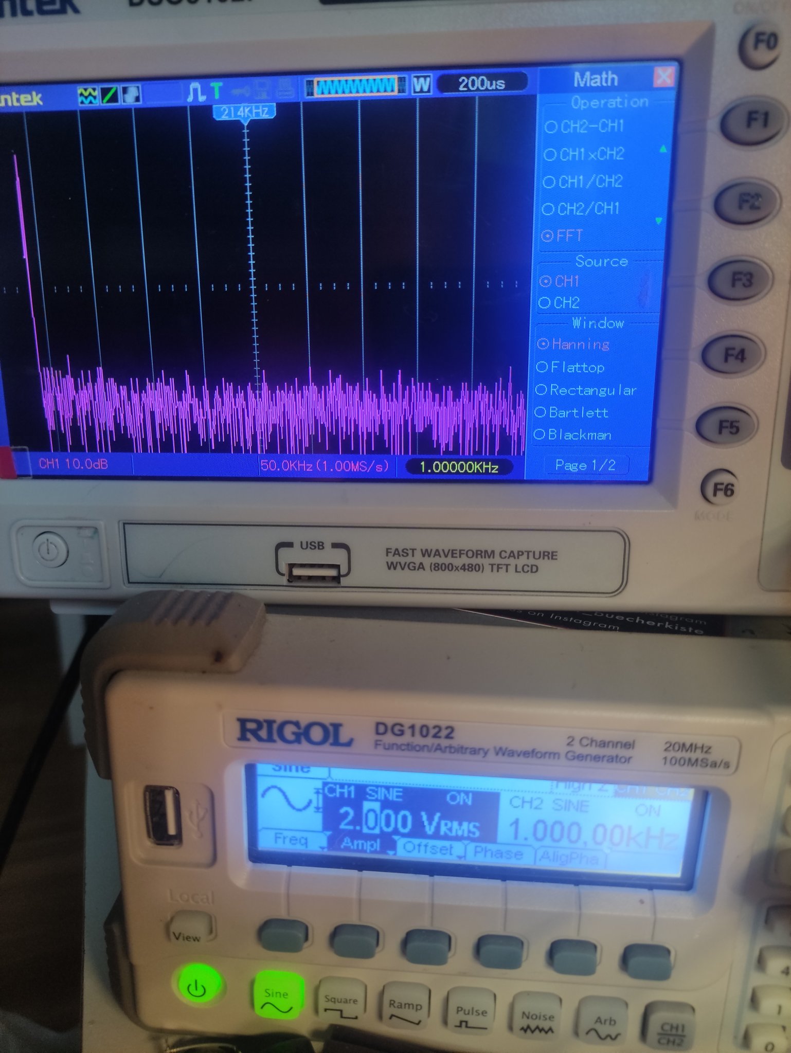

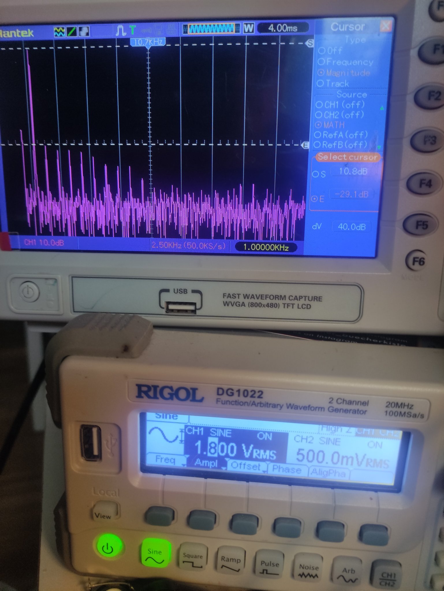

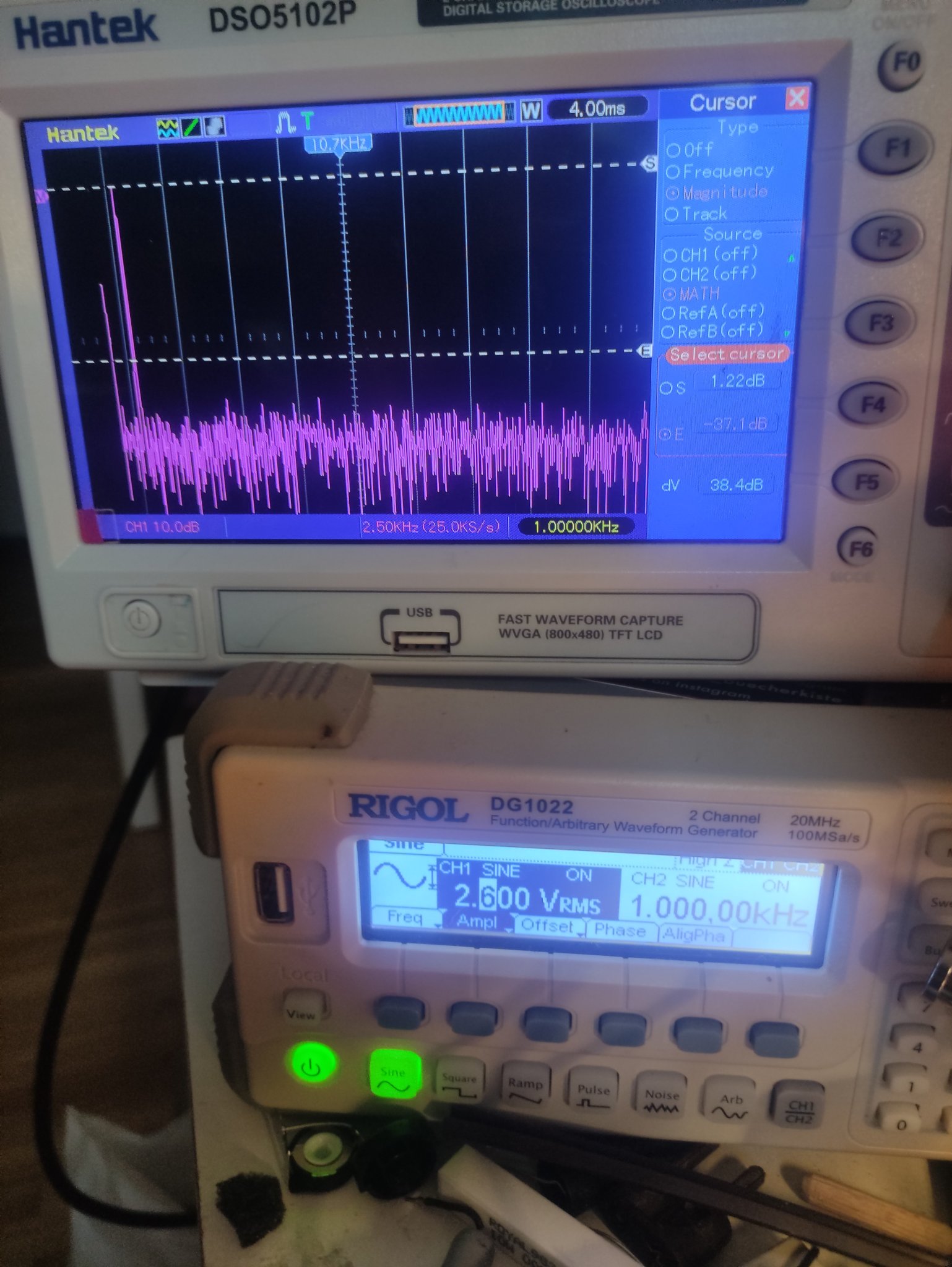

Now, I'm no good at using fft in the scope, to get the second picture I had to give a 2Vrms signal in and pump at full volume. Now, I can't discern how it is, but at low volume setting (which is LOUD, believe me) harmonics disappear. I can't just use it. These two are with R load 56ohm

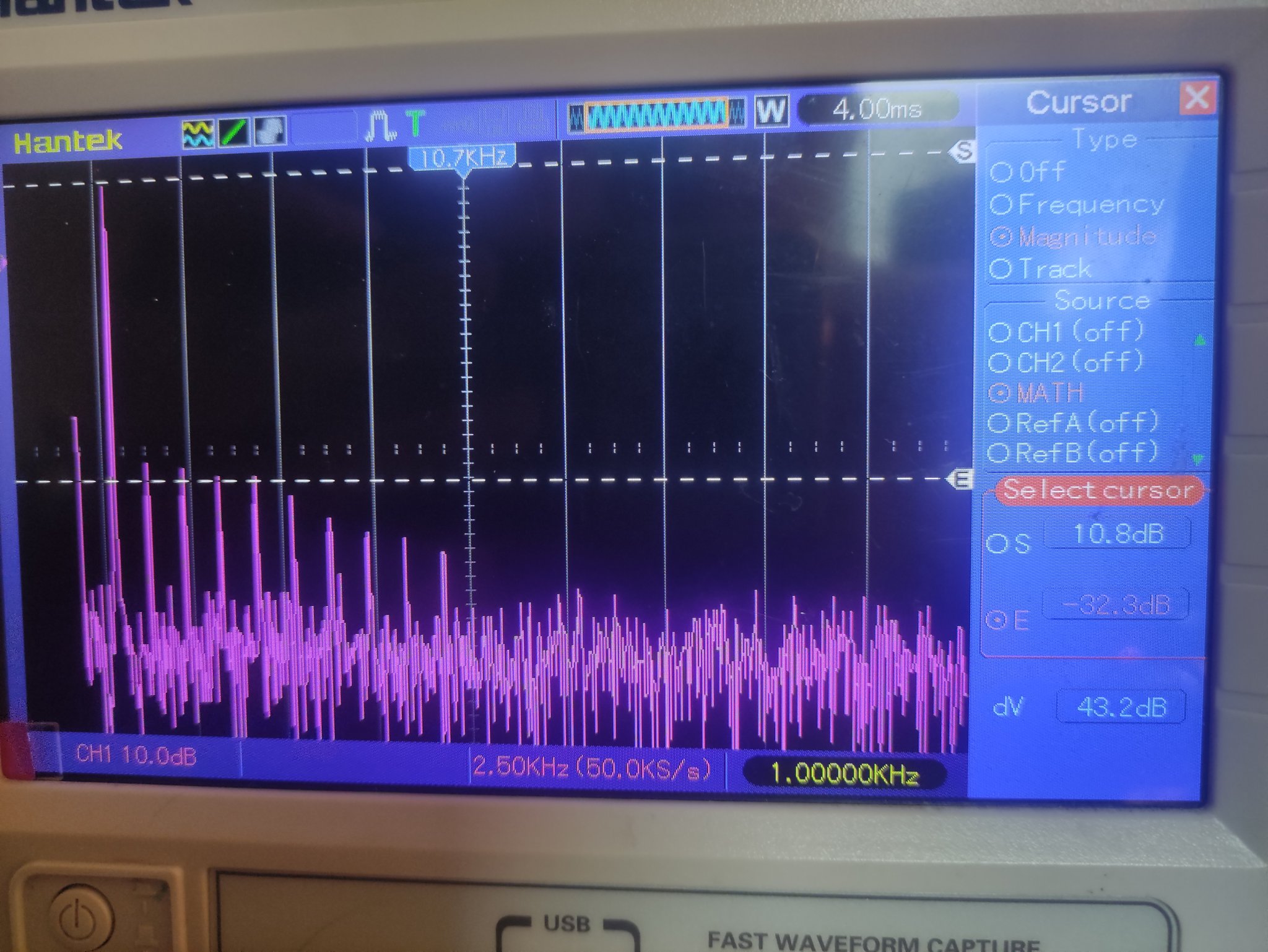

These three are for R16ohm load.
As said, big signal, big volume, no harmonics? What did I do wrong?
However, now my 20ohm planars sing, find them no more shy.

Power resistors are 56 10W non inductive and 22 (or 20, don't remember) 5W non inductive.
Keep cabling short, and that's it! 😁

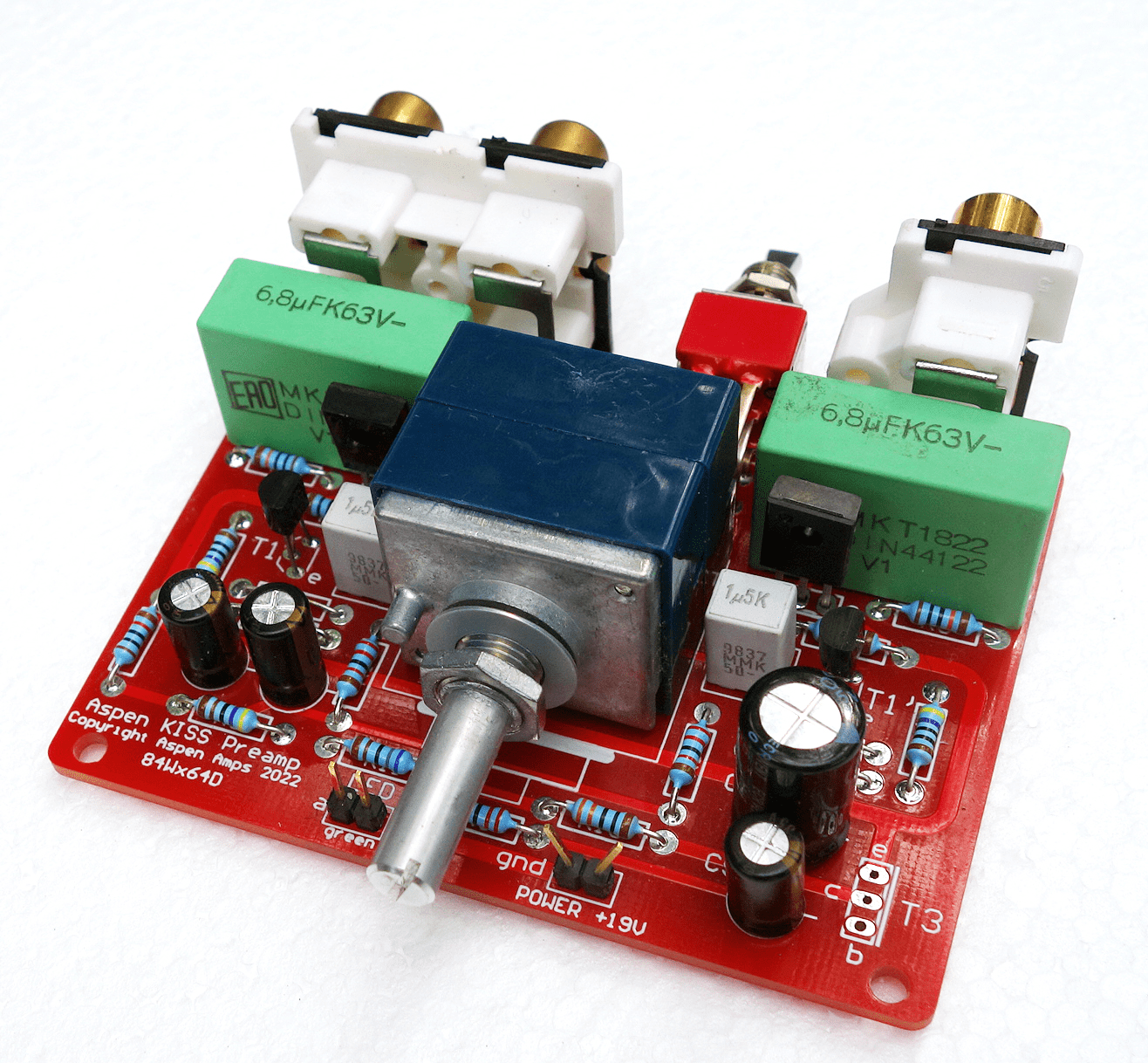

Here's a picture of my preamp using the same topology and presently under listening tests. I use a high beta series pass regulator to remove the grass from the laptop, and delivers about 16.75V to the circuit. Can do up to 10Vpp into 250R, so can actually drive a Beyerdynamic DT880-250 with ease. The pot is a RK27 ALPS of 20k log curve.
HD
Small thing, when it gets hot, it plays normally with high impedance cans, then I plug the 20ohm planars, it starts motorboating. Guess have to solder the 22pF cap between B and C. After my holidays
