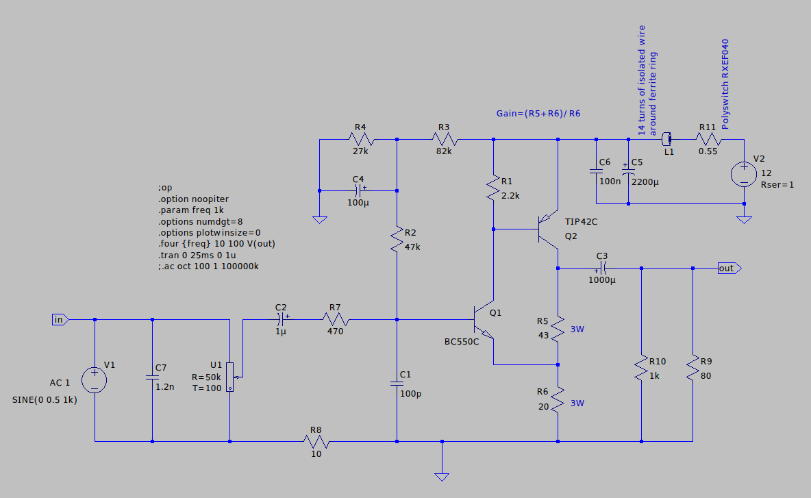

But I use the components I already have. They are BC550C and a TIP42C for Q1 and Q2, 43 ohm 5W and 20 ohm 5W for R5 and R6.
Using these the THD drops a bit.

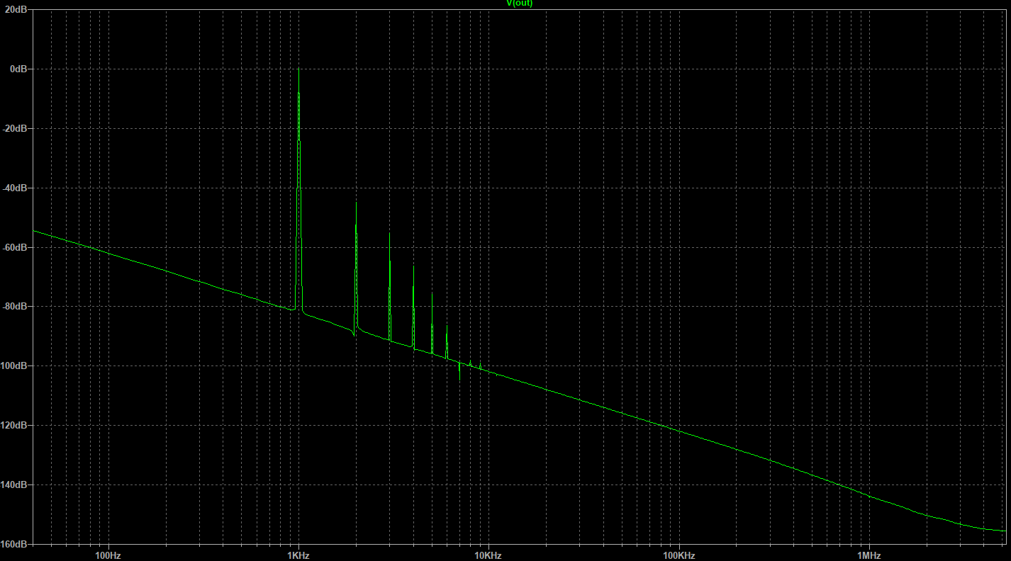

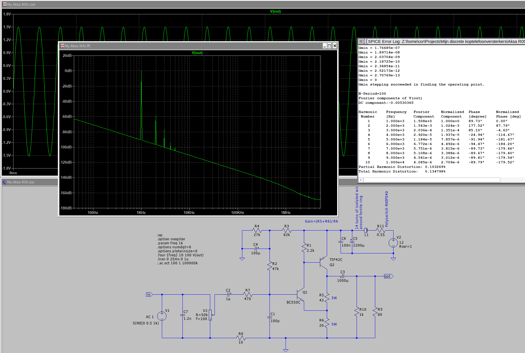

According to LTSpice you can use 16 ohm headphones if you increase the voltage to 18 V. However the temperature of the components also increase because of:
Q2: 830 mW vs 546 mW
R5: 844 mW vs 477 mW
R6: 402 mW vs 227 mW
The harmonics 'profile' also changes, but keeps interesting imo:
Thinking about it it is tempting to use a laptop power supply of 19 Volts...

How did you get to the 16ohm with a supply increase to 18V ?

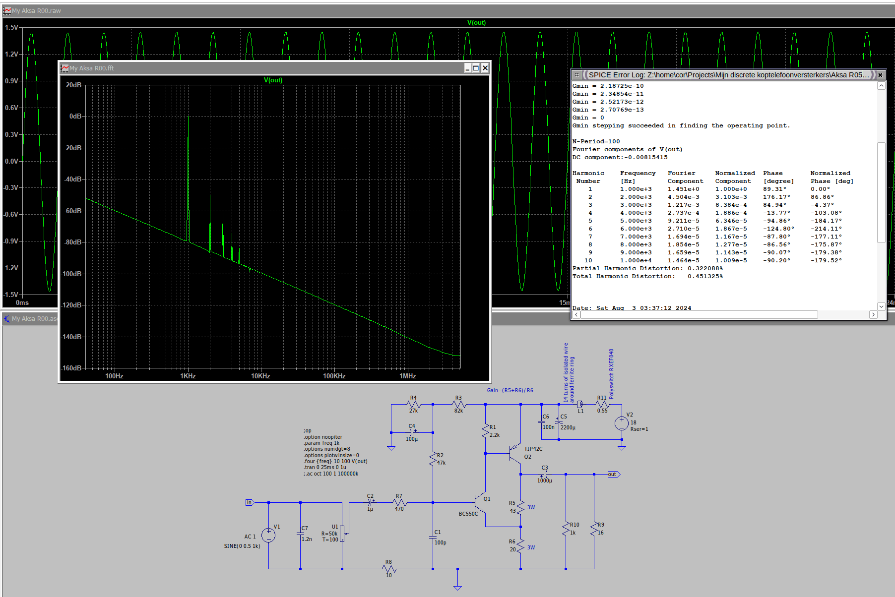

1. This is how I will build it:
2. These are the results I hope for:
3. Distortion using 16 ohm headphones:
4. Distortion using 16 ohm headphones solved by increasing the voltage to 18 Volts:

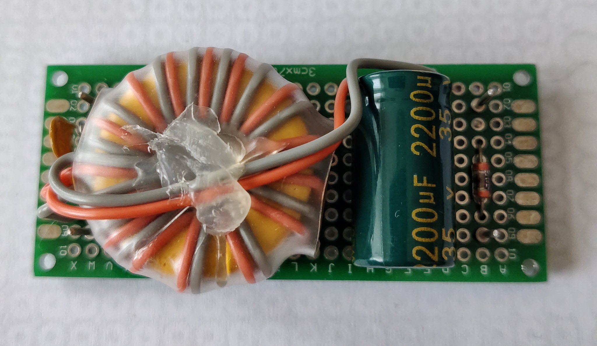

The resistor represents an automatic fuse, a so called polyswitch.On the top right, what for is the thermistor? And the inductor, are you winding it yourself
The yellow ferrite ring for the inductor I got from an old power supply and I wound the gnd and + wire together, 14 turns.
That is a bit of an experiment, but I think it will not hurt:

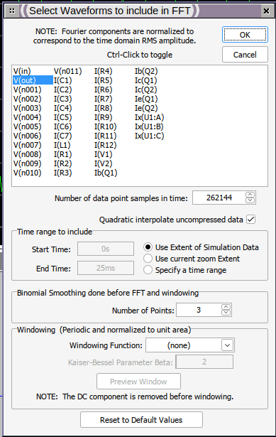

In LTSpice once you got the graph window with the SIN wave (.tran 0 25ms 0 1u), you right-click that window.Ps. Didn't know LTSpice can perform thd analysis, how does this work?
Choose 'View - FFT'. I have these parameters set:
Click 'OK'.
Press 'CTRL-L' and it shows the error log where you see the THD.
