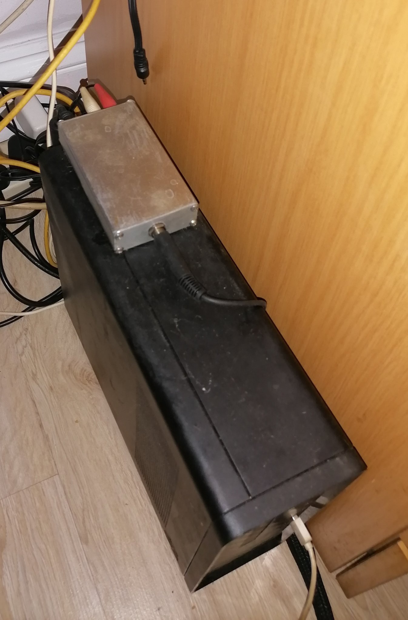

I use an old HP laptop brick @27V and 3 amp for longer than I can remember, it is a very quiet and big brick. The heatsink is not large at all and it is running a little warm forever. There is no on off switch so it ran for 24/7 for years. The amp is the size of cigarette
pack. No frills Aluminium extruded box from eBay was $1.36

So nice, you said you're using hd800', would you suggest them(with or without 5kHz peak correction?)I use an old HP laptop brick @27V and 3 amp for longer than I can remember, it is a very quiet and big brick. The heatsink is not large at all and it is running a little warm forever. There is no on off switch so it ran for 24/7 for years. The amp is the size of cigarrette pack. No frillsView attachment 1341077
As I said, I tend to listen to the good things and not mess with unnecessary things, if you want to start with DSP you ruin the deign and you forever fiddle with it for years, use it like intended, If you want to tune it fir more enjoyment, then yes change the peak until you find your nirvana
