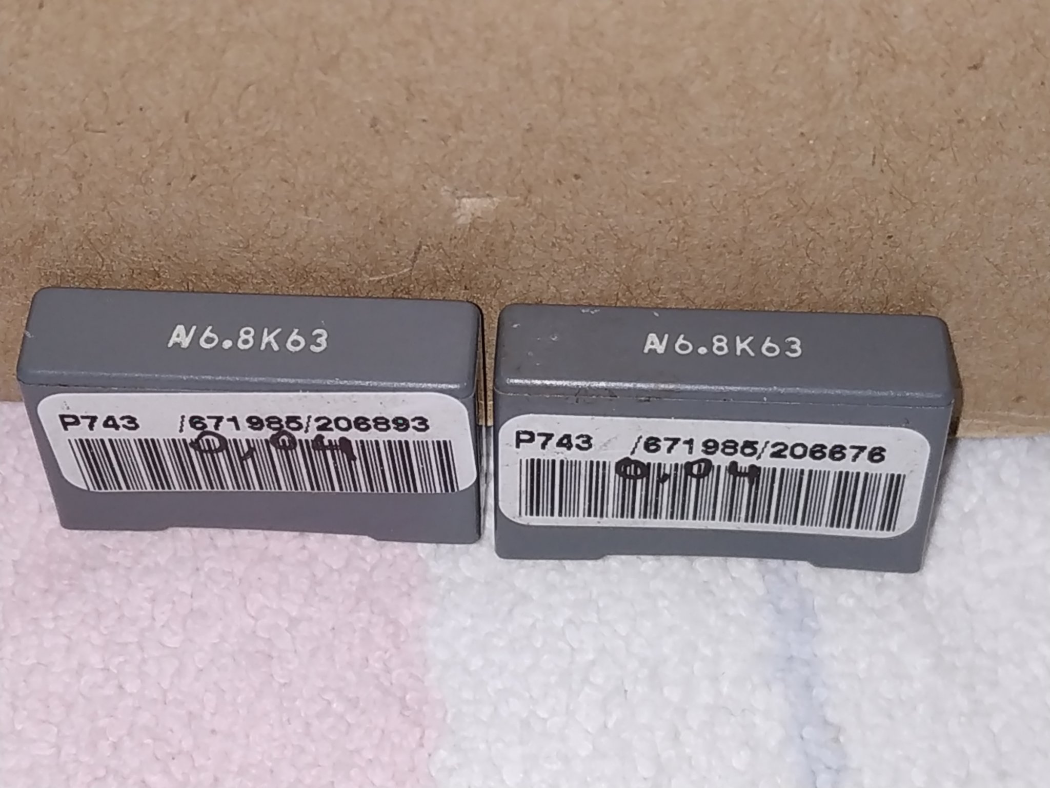

To ease the pain; there is some useful information in that Catalogue. Might find more information on the wima.de site, in German and English language.
Digikey has lots of big polypropylene film caps. I accidentally ordered some huge 30x30x20 mm bricks recently for an amp project, thinking they would be half the size.

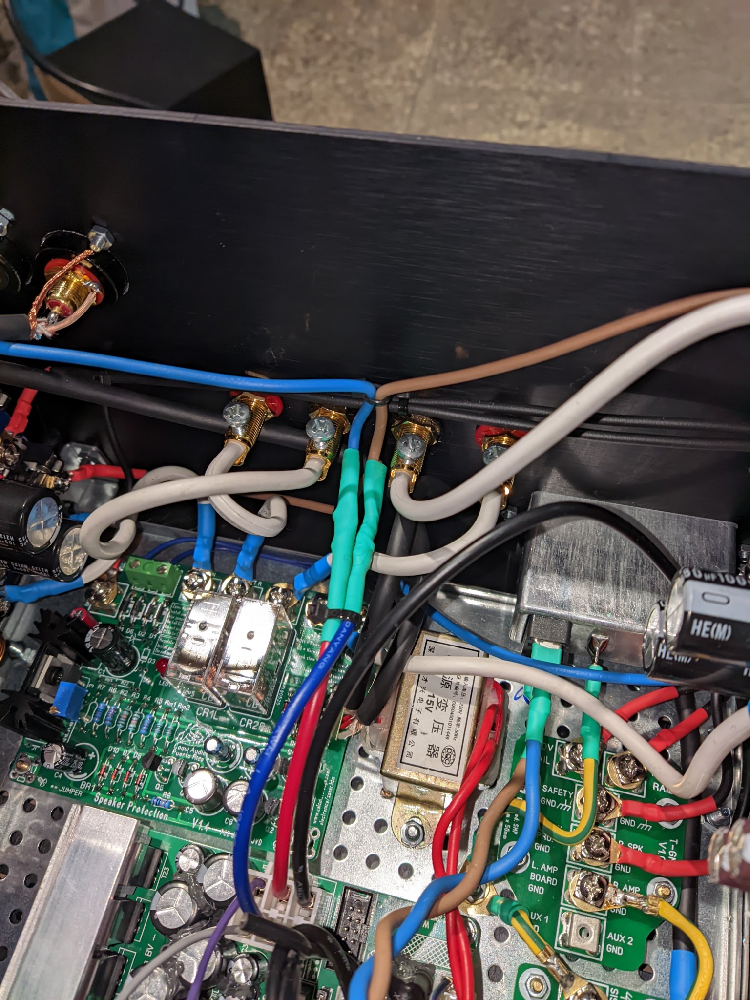

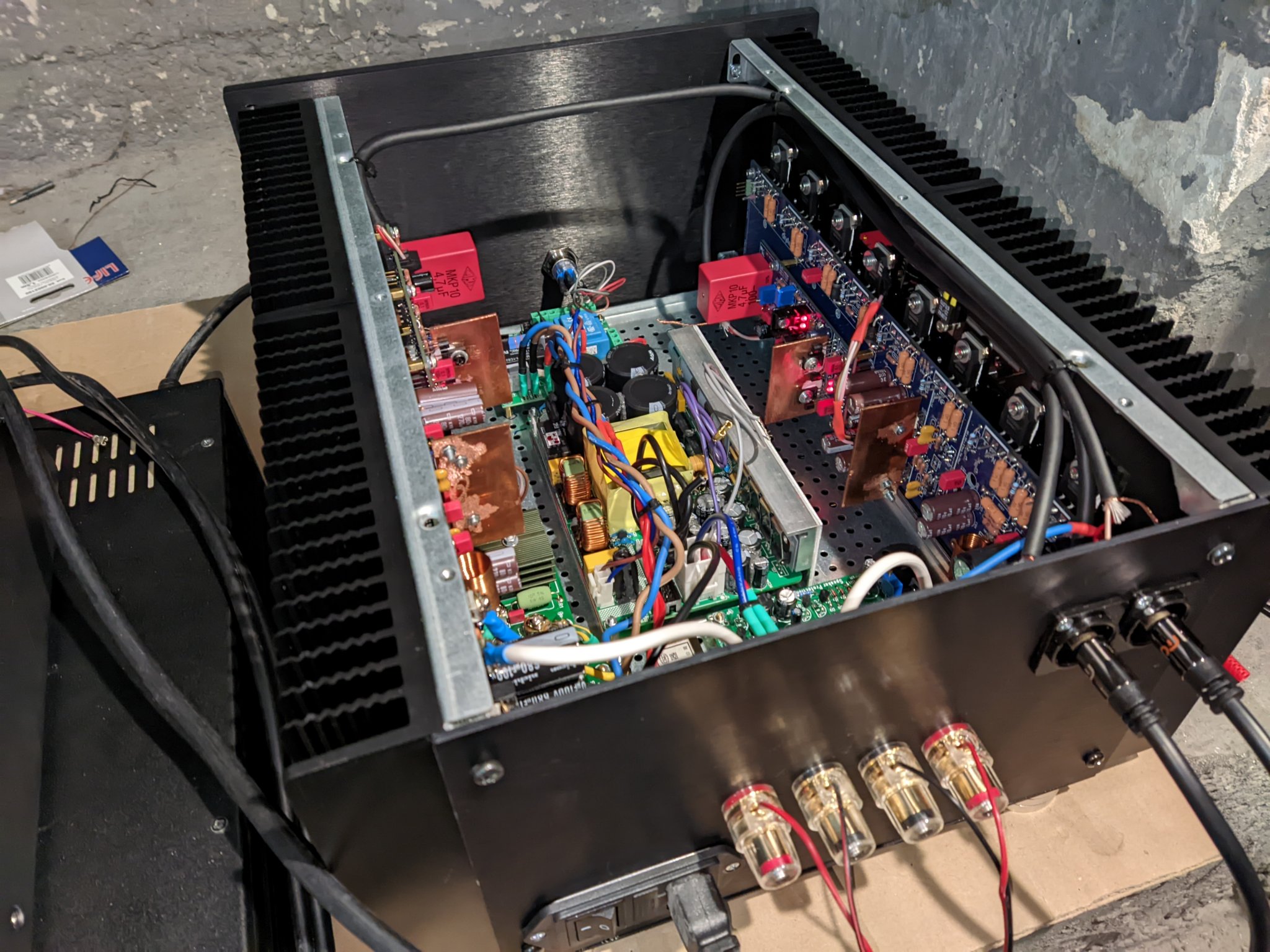

Hi Klaus, I live in Bari, the town of Santa Klaus, nice to meet you!!
Unluckily my pics are not that good. What I did was to split of course V+ and V- and to connect the SMPS ground to a T shaped PCB which acts as a star ground. As regards the standby button, I opted for the Hypex softstart which can be used to switch on and off the amp both by a latching and a momentary pushbutton.
