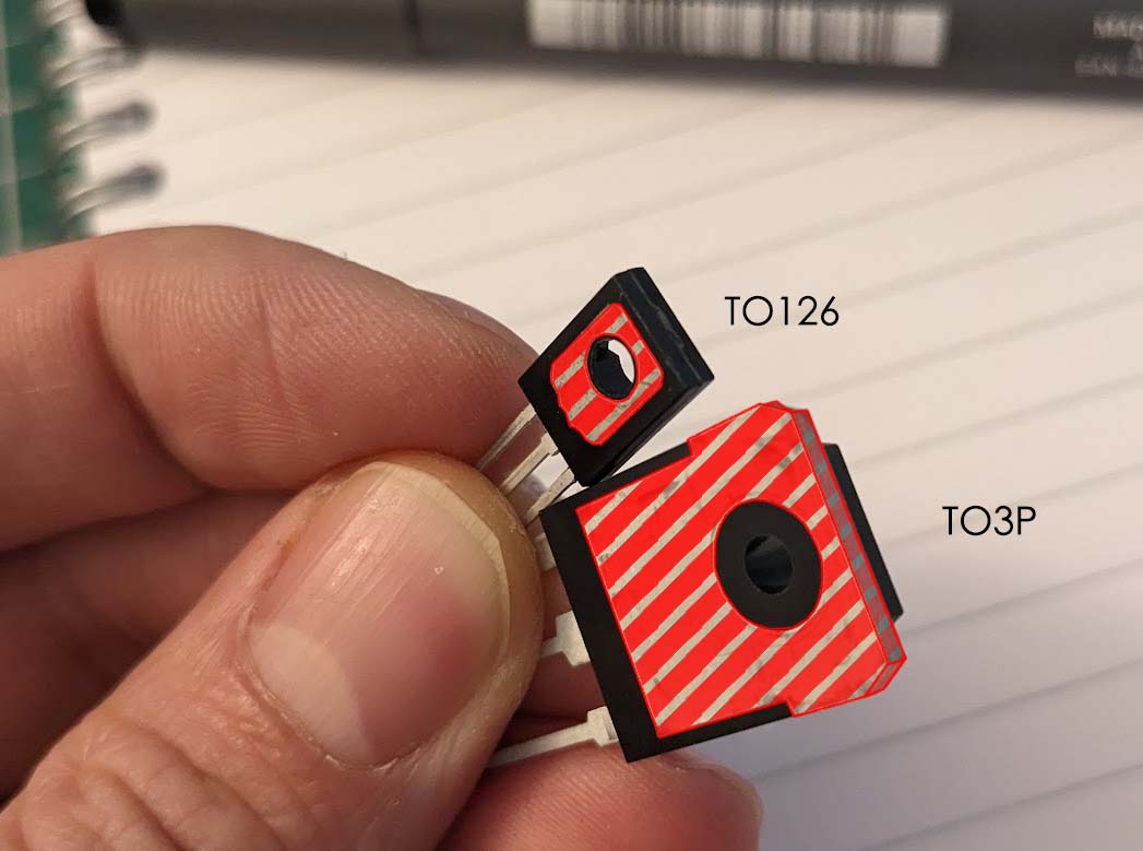

Isolation of transistors. Exposed areas hatched red.
If a fully plastic encapsulated transistor is- no isolation is needed. A small amount of grease and that's all.
Transistor of To3 type with the exposed surface but sufficiently isolated screw area. Just a tape/ pad + a small amount of grease, depending on the insulation used.
If the transistor to TO-126 depicted is used- tape and shoulder washer + grease are needed, due to the small isolation area around the screw.
Correct?

Fully encapsulated - Grease*
TO-126 Metal Back - Isolation Pad and Grease*, No shoulder washer required, I only use those on metal tab TO-220
All Output Packages - Isolation Pad and Grease*
*This would depend on the type of Isolation used. Kapton tape, or mica I would put a little bit on spread evenly, but keratherm or the likes does not.
For TO-126 I used these https://www.mouser.ca/ProductDetail/Wakefield-Vette/173-7-220P?qs=VVKQmw408U%2BV03GlhN45fQ== and then cut to the correct size.

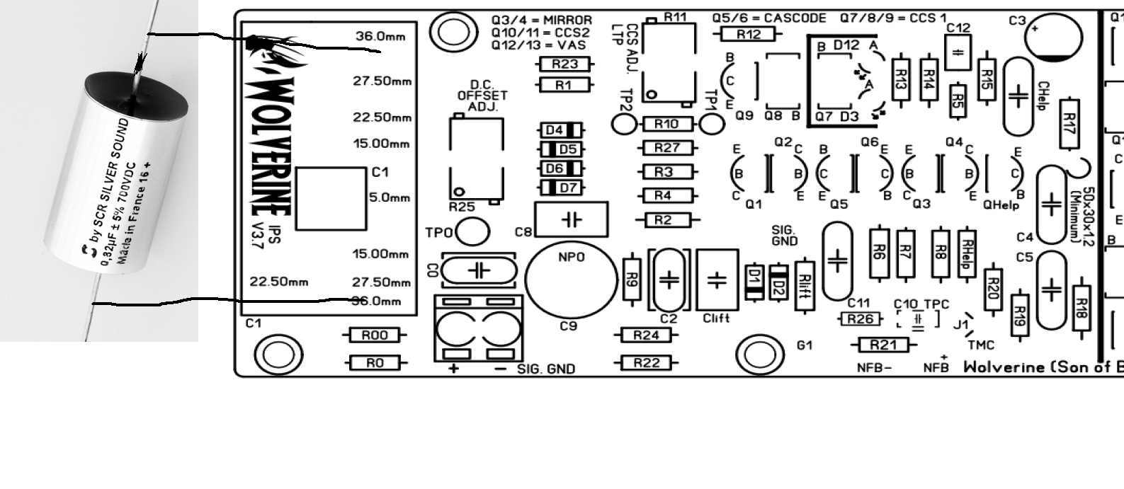

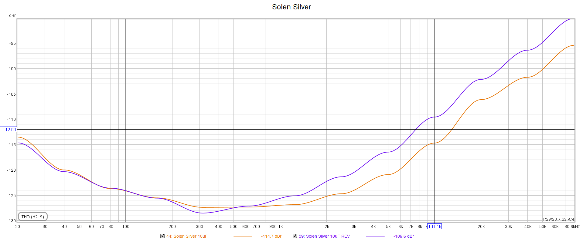

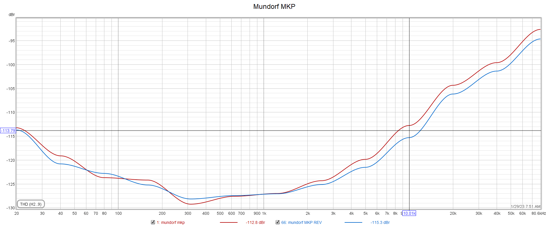

Here are 2 comparisons Mundorf and Solen Silver Sound. All I did was flip the cap with either label pointing into the IPS or label pointing out from the IPS.
I bought the Silver sound to see if a $50 cap would be any better then the $15-20 ones I tried before, but when I received it, I noticed 1 leg was marked with black sharpie, and thats what led me down this path of testing.
As you can see there is a large difference depending on how the cap is installed, but still in neither of these cases do the caps reduce distortion lower then the BOM cap.

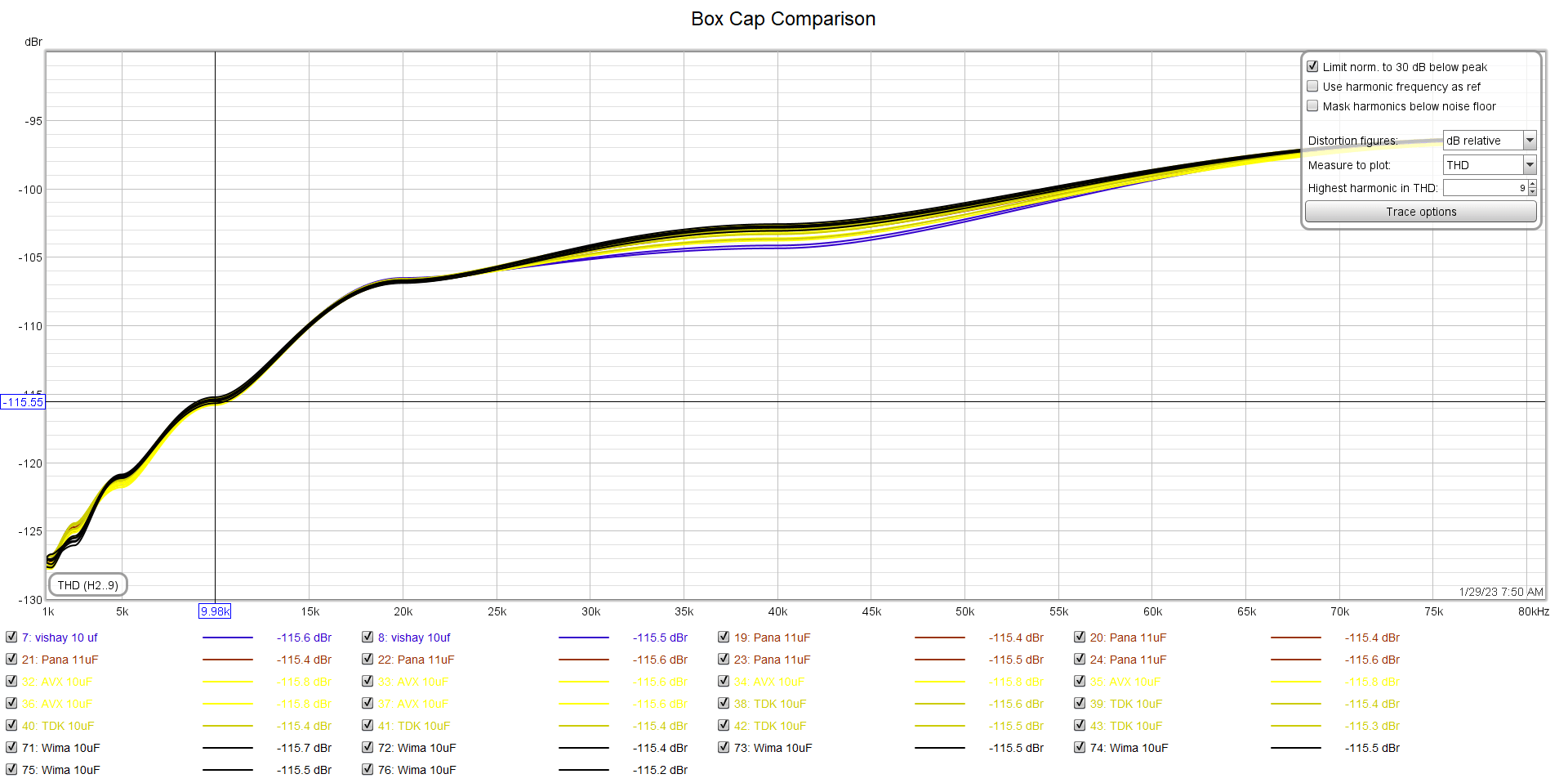

Here are the Box type caps that I tested, and orientation does not matter with these, I tested and there was no change.
And overlayed results, highly magnified with linear scale to be able to start to separate them. Basically all fall within measurement error.
Long story short, If you do use an audiophile cap, then please make sure it is oriented correctly for best performance! Or save 50 bucks and just buy the Vishay 😁

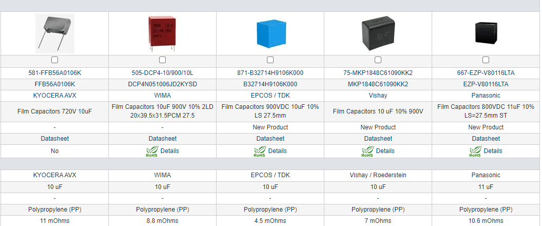

Technically speaking you want the outer foil to always go to the lower impedance part of the circuit. Here's a good video on the subject. It's a little wordy but also gives a quick method to find it and little circuit you can build to find the outer foil.
Only the solen was marked for the outer foil and this gave the lowest distortion measurement installed this way. But it seems like that is opposite of what is recommended. I need to measure the other caps to see which lead is on the outer foil to confirm, and check this one incase it was marked incorrectly.
The snake oil capacitors have a certain entertainment value. Those who want to be scammed must be given the opportunity. Ter leering ende vermaeck (For learning and entertainment).
However, I be interested in a comparison between various types of capacitors from a single respectable manufacturer.
