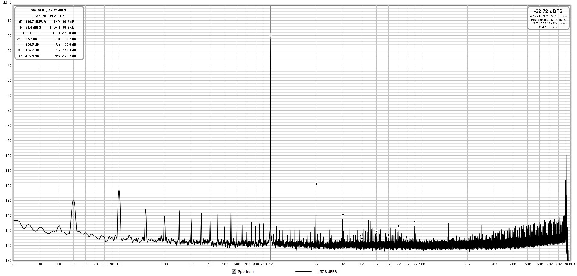

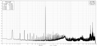

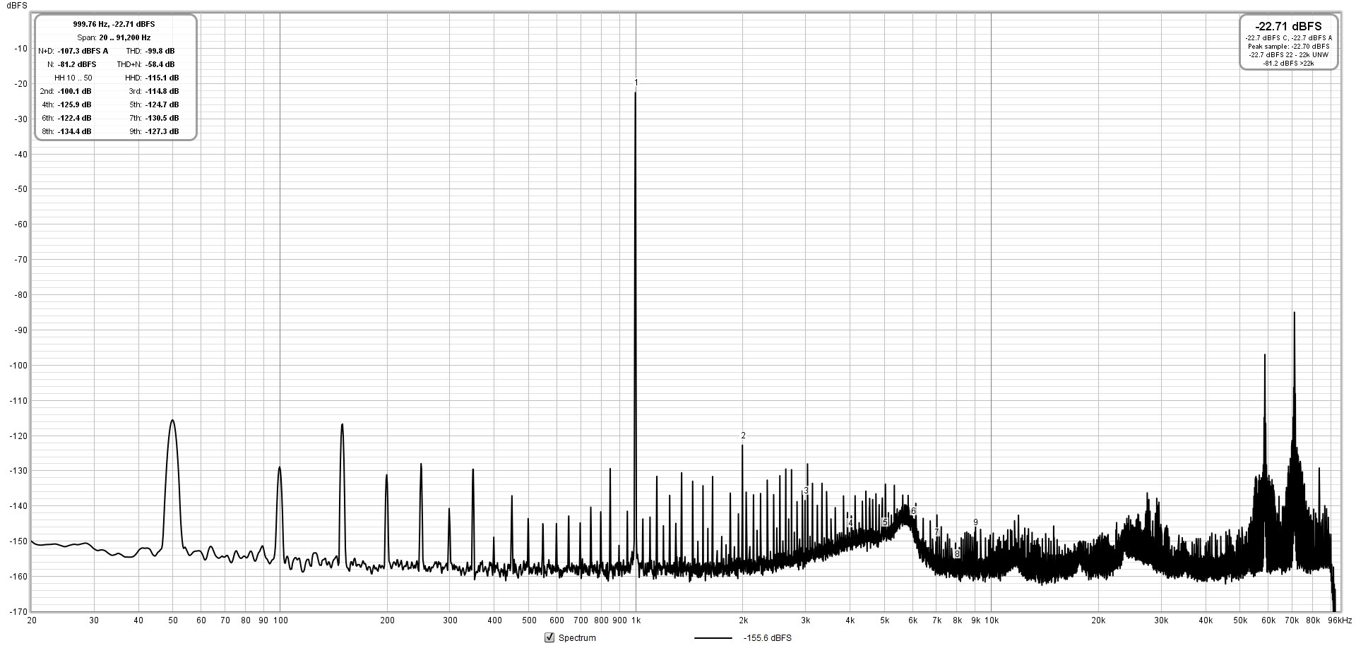

I compared a Cobra s2 to a SMPS1200 on an existing class AB amplifier I ripped the (noisy AF) linear supply out of. The Hypex was slightly quieter, 0 to 96khz. Both were very quiet and leagues ahead of the linear supply that was in there. The Cobra has more (and easier) convenience options however.Thanks for the feedback 🙂
I guess ill go with the SMPS1200A400 then.

Rail voltages for this amp were +-82V though so YMMV. Both 5W 1 channel connected to 8R load.
Cobra (click to enlarge)
Hypex (click to enlarge)

The cobra needs it's 0v tied to ground or ground lift to fix thatI compared a Cobra s2 to a SMPS1200 on an existing class AB amplifier I ripped the (noisy AF) linear supply out of. The Hypex was slightly quieter, 0 to 96khz. Both were very quiet and leagues ahead of the linear supply that was in there. The Cobra has more (and easier) convenience options however.
