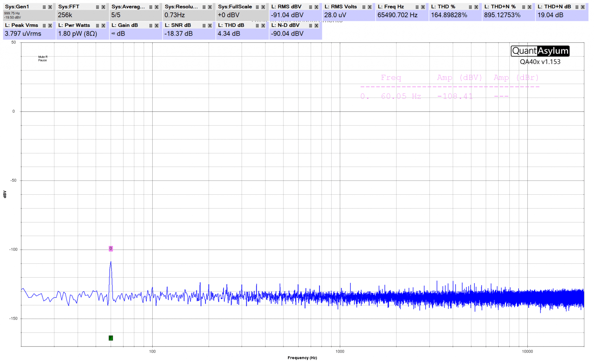

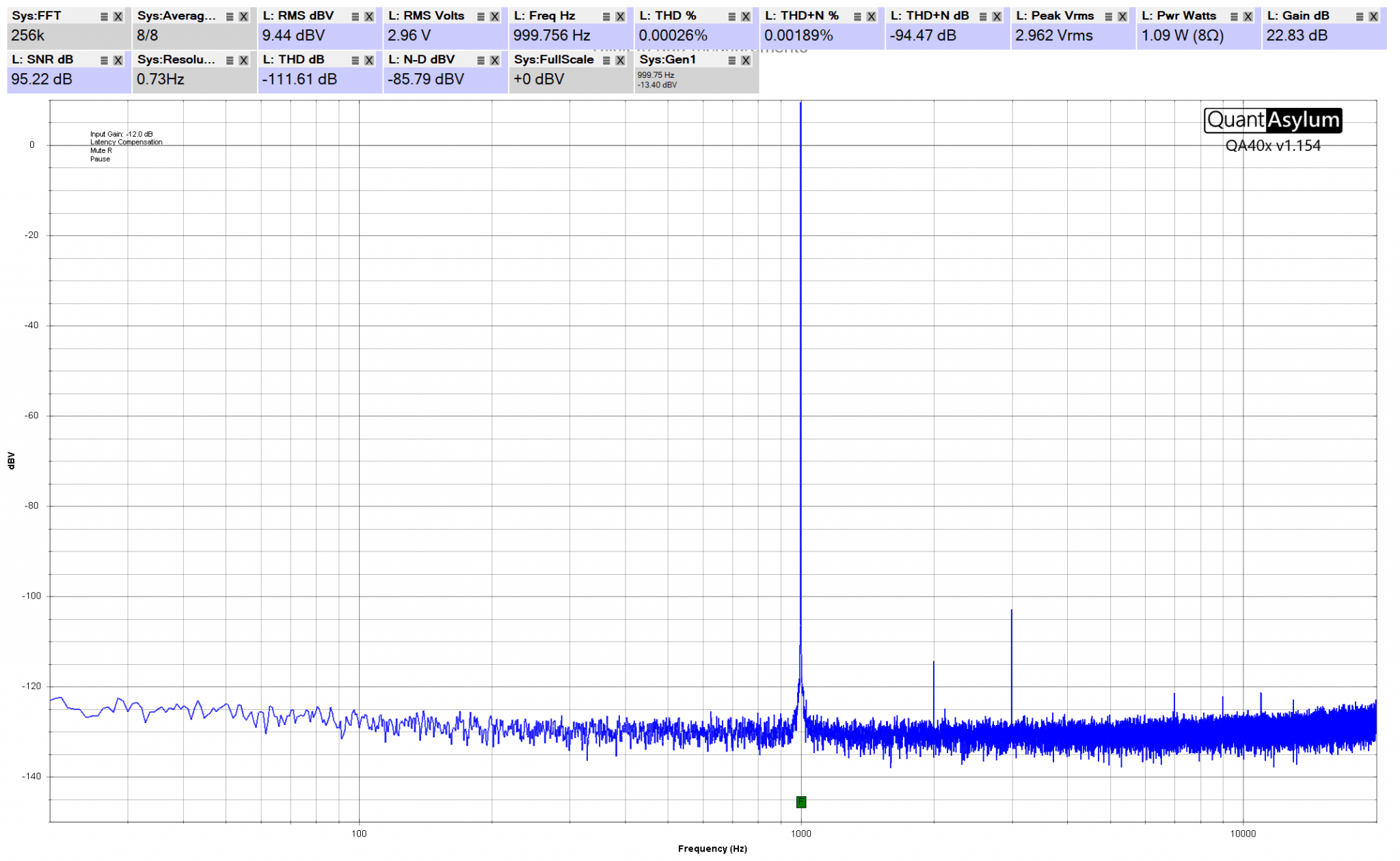

I compared a Cobra s2 to a SMPS1200 on an existing class AB amplifier I ripped the (noisy AF) linear supply out of. The Hypex was slightly quieter, 0 to 96khz. Both were very quiet and leagues ahead of the linear supply that was in there. The Cobra has more (and easier) convenience options however.
Rail voltages for this amp were +-82V though so YMMV. Both 5W 1 channel connected to 8R load.
Cobra (click to enlarge)
Hypex (click to enlarge)

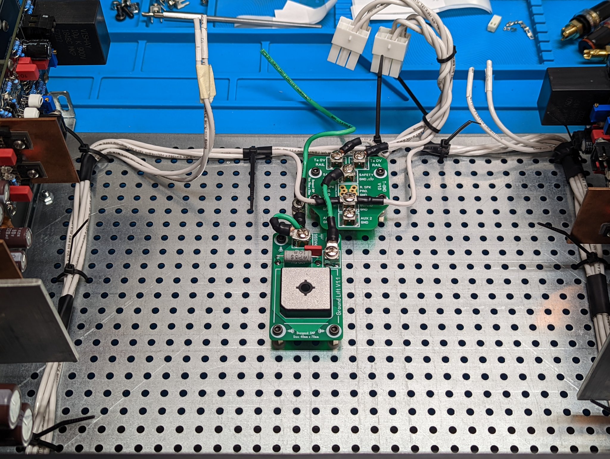

This measurement is in Chassis with a Cobra S2 +-63v. This is with th 0v tied to the T-Ground PCB.

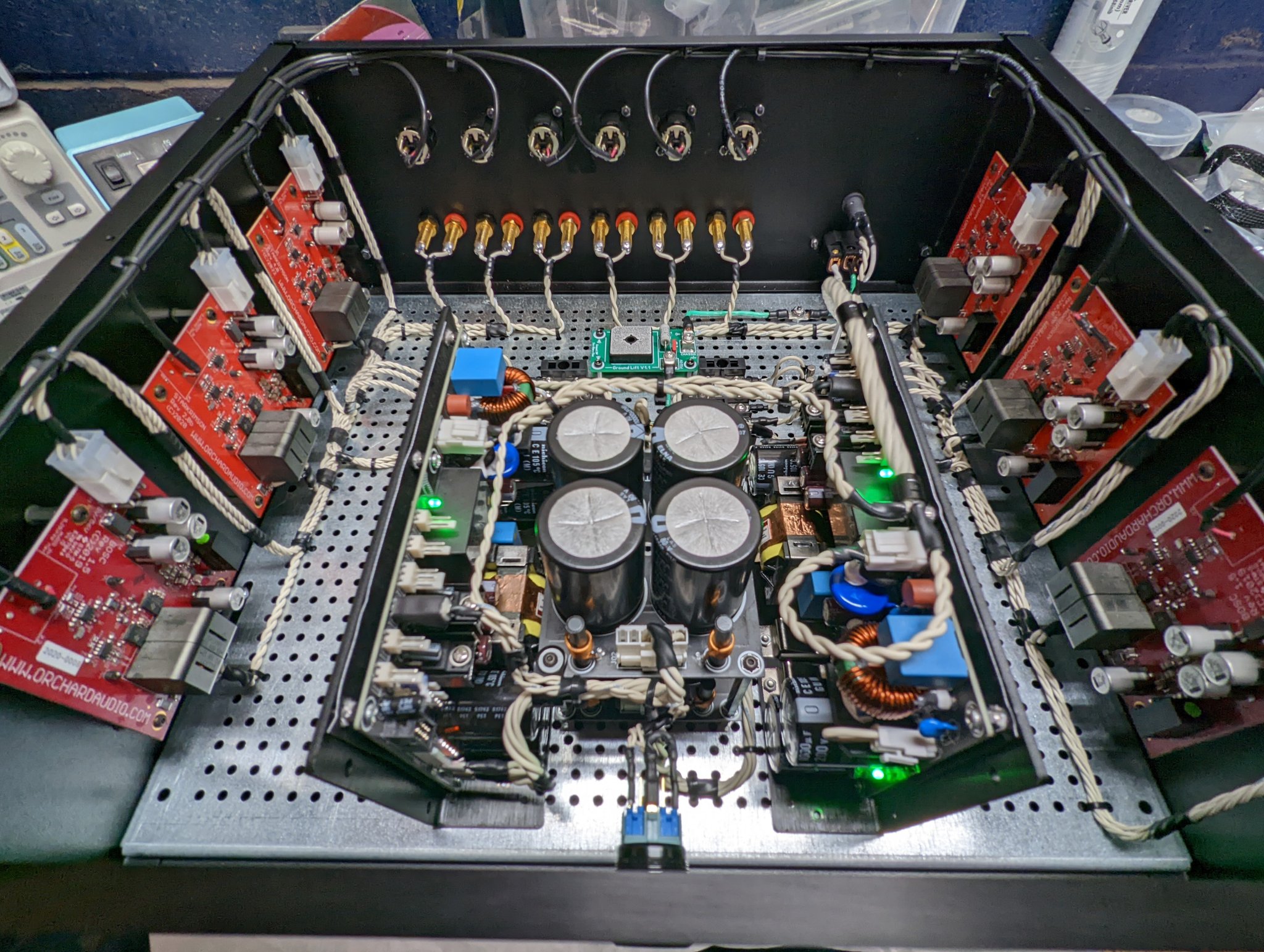

@fireanimal I thought the point of UMS was that if you have a UMS drilled enclosure, then you dont have to drill or tap anything if you build another (UMS compatible) amp in that enclosure. It makes all the sense in the world for someone like me who does not have ANY metal tools, skills or workshop.
Correct if you are using TO3P outputs they bolt right on no issues with ef3-3 boards. Ef3-4 have a couple mounting holes that need drilled and the option of drilling to mount the drivers there as well. It's all in the build guide and the ums mounting near the end of the guide. TO264 are a larger package that's why they need to be located further from the board and require drilling.
