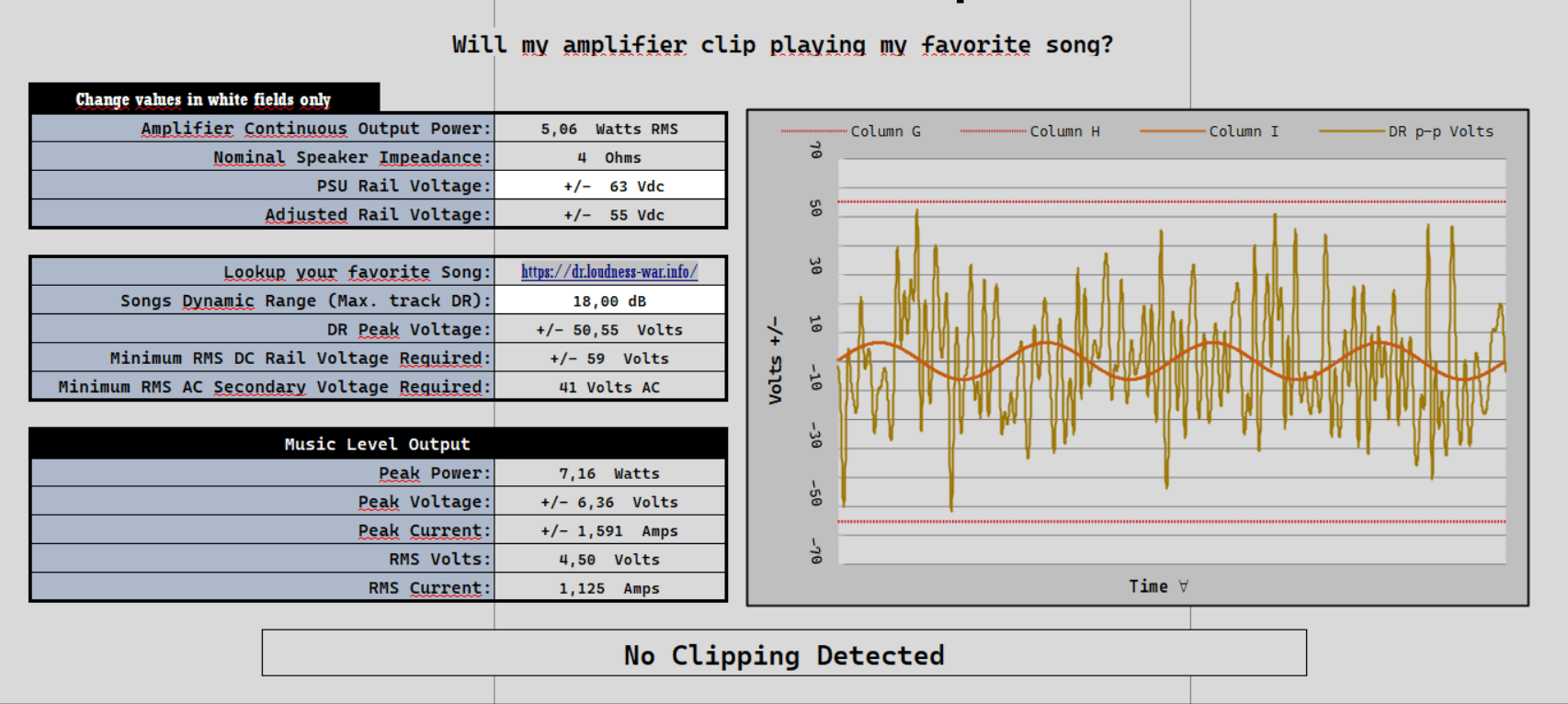

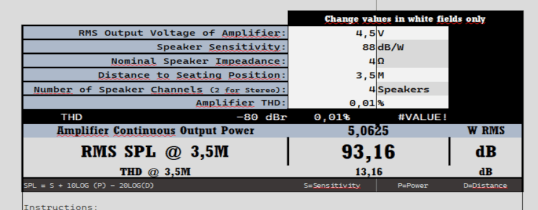

Giving the PSU calculator of @fireanimal one more swing, now putting in some values applicable to my own situation.
Each channel has 2 Seas Exel drivers, sensitivity 88 dB, nominal 8 ohm. 8/2=4
Playing an 40 year fav song of my, Dire Straits - Private Investigations, with according dr.loudness-war.info a dynamic range of 18
Listening at a distance of 3.5 meter. (the room is 7 meters)
At 93 dB SPL its close to clipping according the calculator, now that's not frightening me, but I'm glad I choose a 2 X 45 volts toroidal and nothing less.

I find though a lot of high dynamic range songs are played at a lower RMS level to begin with so that will give extra headroom there. There is a lot of orchestra that can reach upwards of 30 dB or more but you won't be listening to that at 90 to 93 dB RMS more likely in the mid to high 70s. Through on a song grab your SPL meter and measure to know for sure, but please don't use the phone apps unless they have been calibrated or they won't give accurate results.

I use sox to find the peak-to-average ratio. 20dB is great for a rock recording. Classical will have a few dB more.
But... my listening levels are low. A scope on the output shows 0.4v peak. 🙂
(Different amplifier, inefficient 4 ohm speakers).

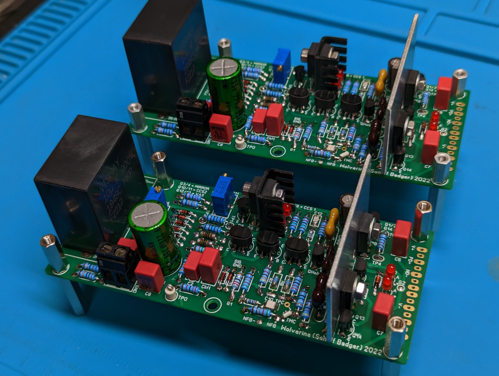

Hi can you give me the Mouser code of the green NP cap 220uf/35V? MUSE?Back on Topic then 😀 Pair of IPS's I just finished today for an EF3-4 build. Nothing fancy but they turned out good, and will look great on the finished EF3-4.

Sure. 647-UES1V221MHMHi can you give me the Mouser code of the green NP cap 220uf/35V? MUSE?
