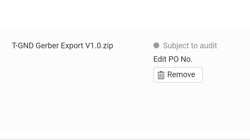

Although I am able to order (ie "add to cart") the Ground Lift PCB, for some reason when I try to add the T-GND pcb to the cart it doesn't show up, there is an error. Can you double check with pcbway and see what is going on?
Thanks,
Anand.
You may just have to wait a hour or so until they complete there audits.
Then you should be able to check out.

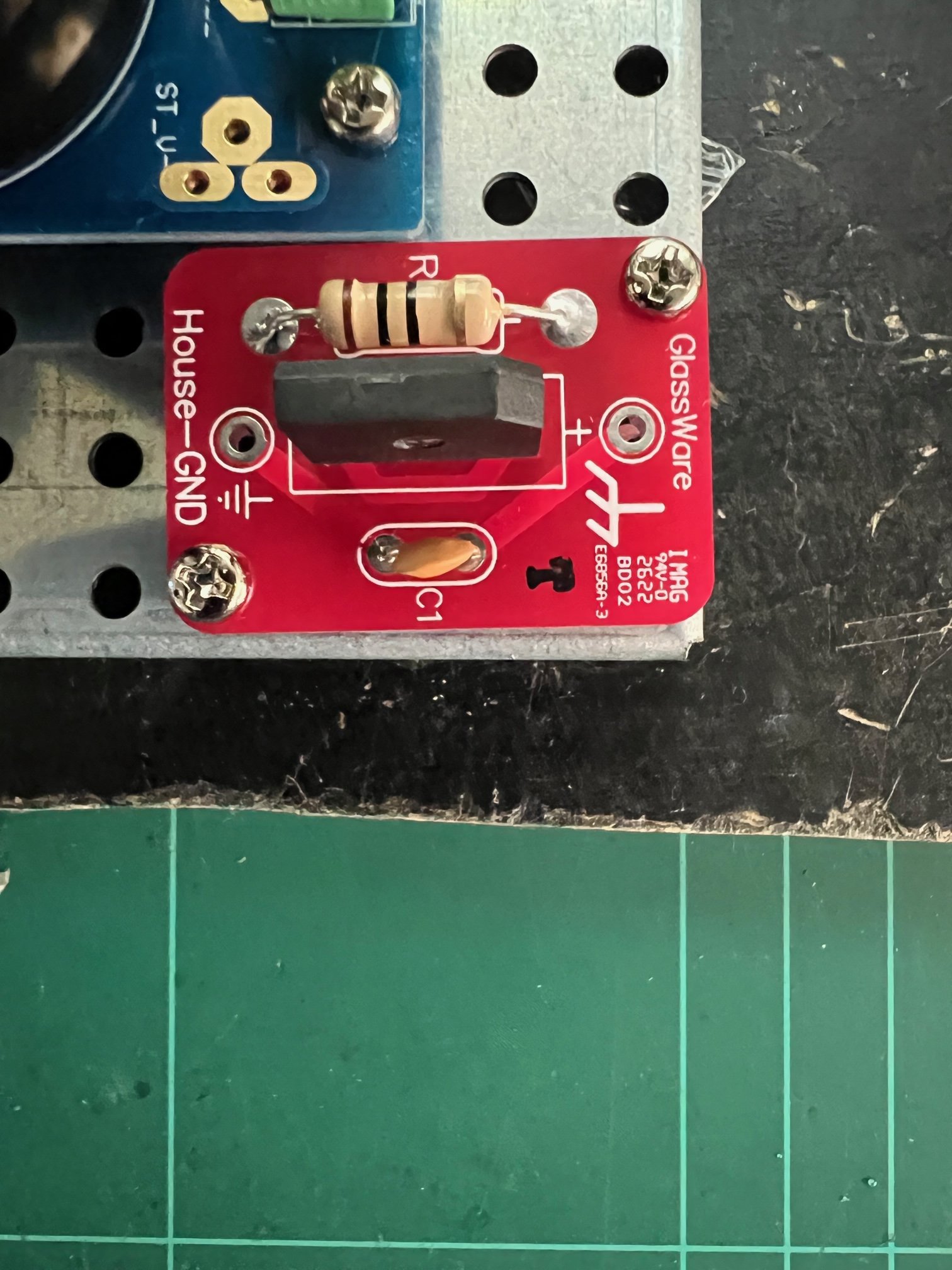

@stuartmp
Want to publicly thank you for the Ground Lift and T-GND pcb designs. As simple as they are, they are a necessity. They ease the burden of implementing star ground and ground fault schemes into my existing designs.
I ordered 10 boards each, in blue, since that’s my favorite color! I’ll likely use all of them…eventually 😉.
