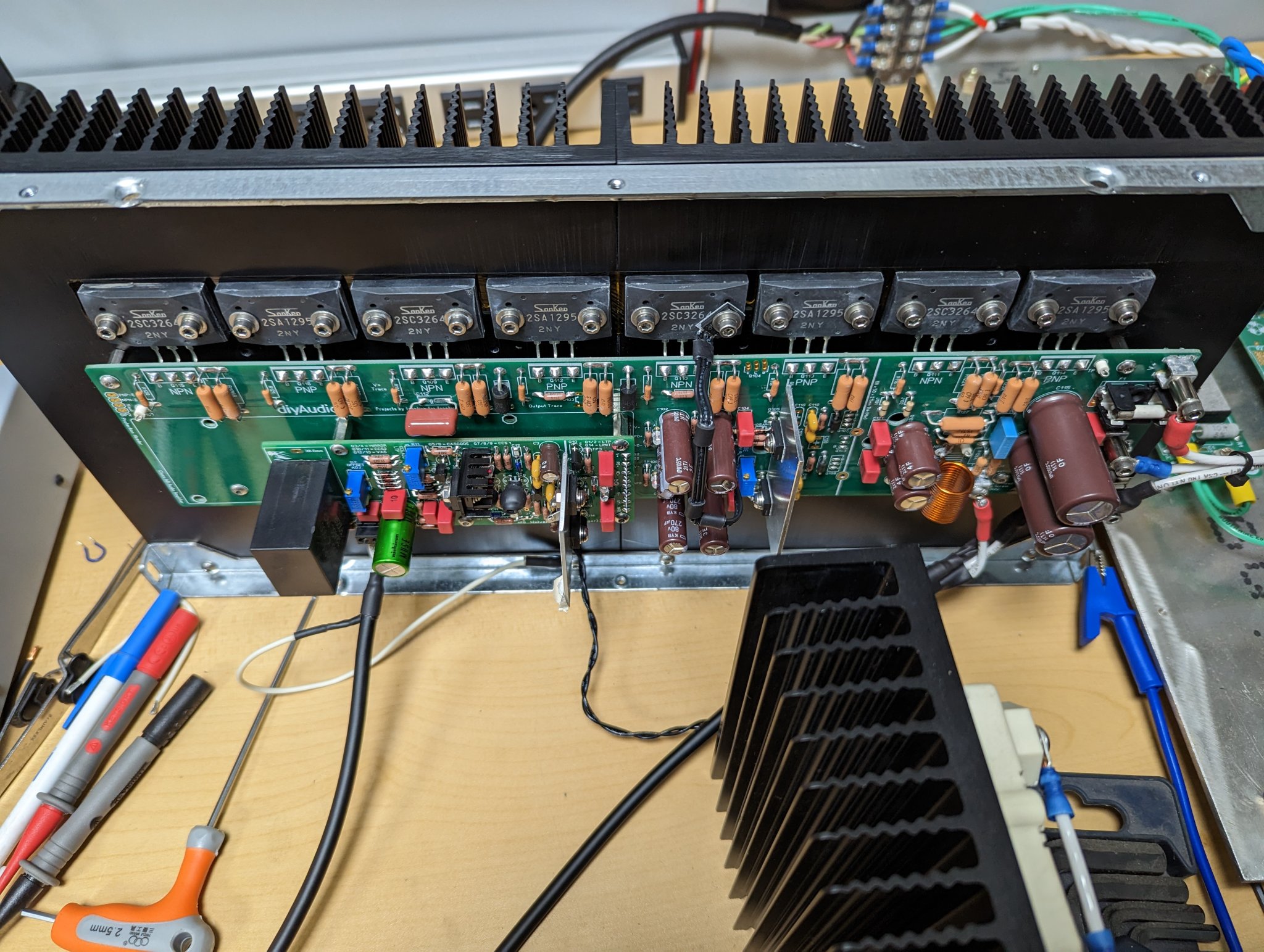

Hi @ostripper , thanks for taking the time to study the wolverine project a little deeper. I see you have posed some questions. We'll take a look and get back to you. I just wanted to say this has been a massive team effort by all members of the wolverine team. When have spent I would estimate well over 2500 man hours on this. All the members are noted on the PCB's including yourself.Been a while ....
I do see this amp performs as planned - actually better.
- I'm just curious how the pre-drivers are now heatsinked. It does not hurt ??
- The wolverine CCS has become an "overkill" TO-126 "beast". I guess this wont hurt , lower pF with those to-126's.
- strange addition of diodes in the cap multiplier/regulator section.
- and , the option of having the vbe closer to the outputs.
I suppose these are minor esoteric design choices ... as the resulting performance beats just about anything on the planet. Most 20K$ audiophile amps are 20-30ppm. I could beat this with a class A output stage instead of a an EF3. In fact , my next project is a Badger class A headphone amp with Jung

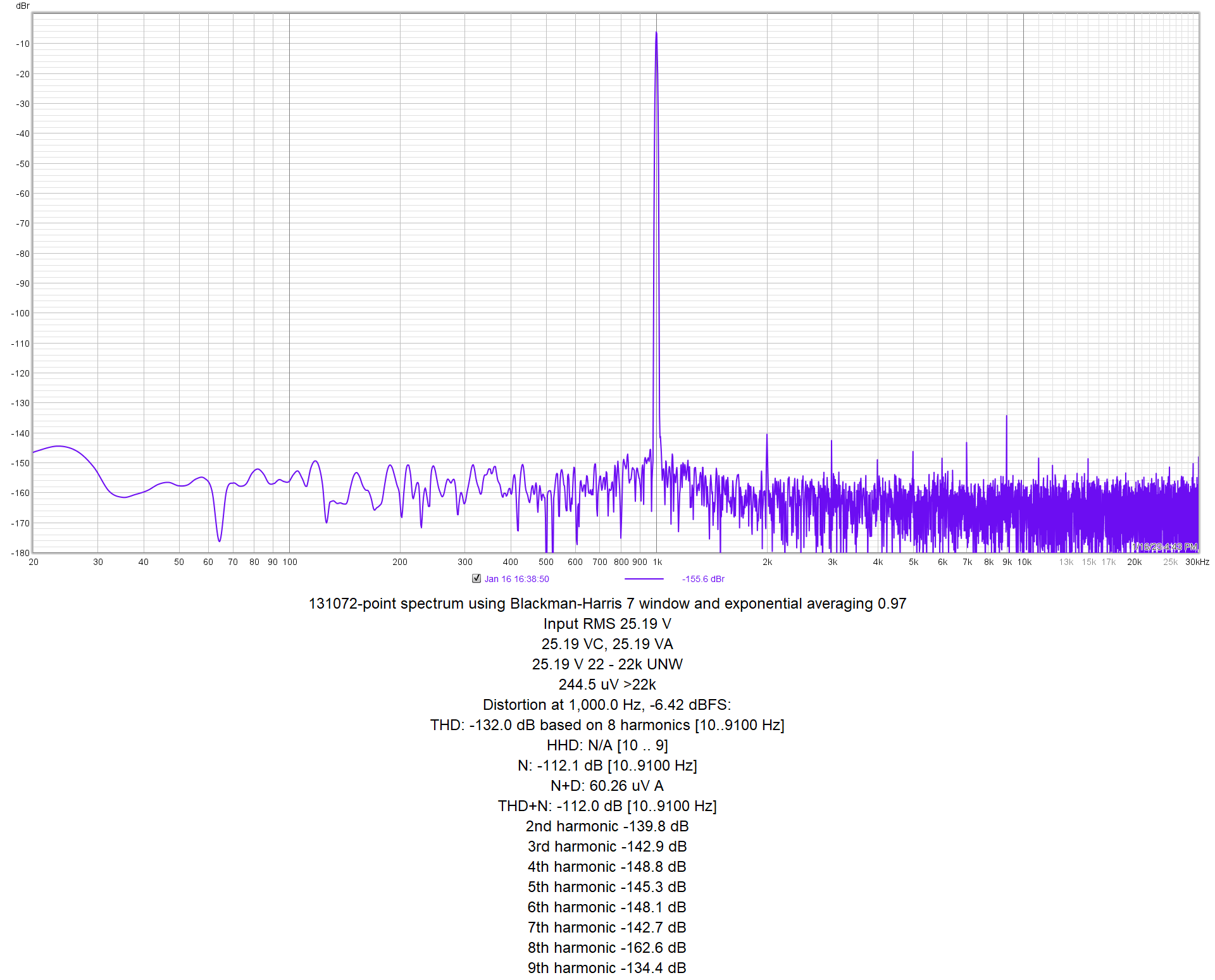

Are those tests right .... sub PPM - yikes ??
Yep, those low distortion measurements are correct. Boards were tested in Australia, Canada, Greece and the USA.

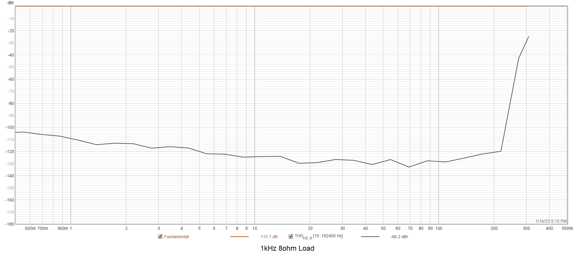

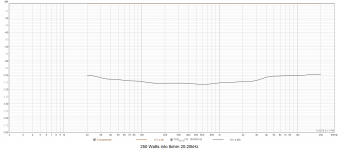

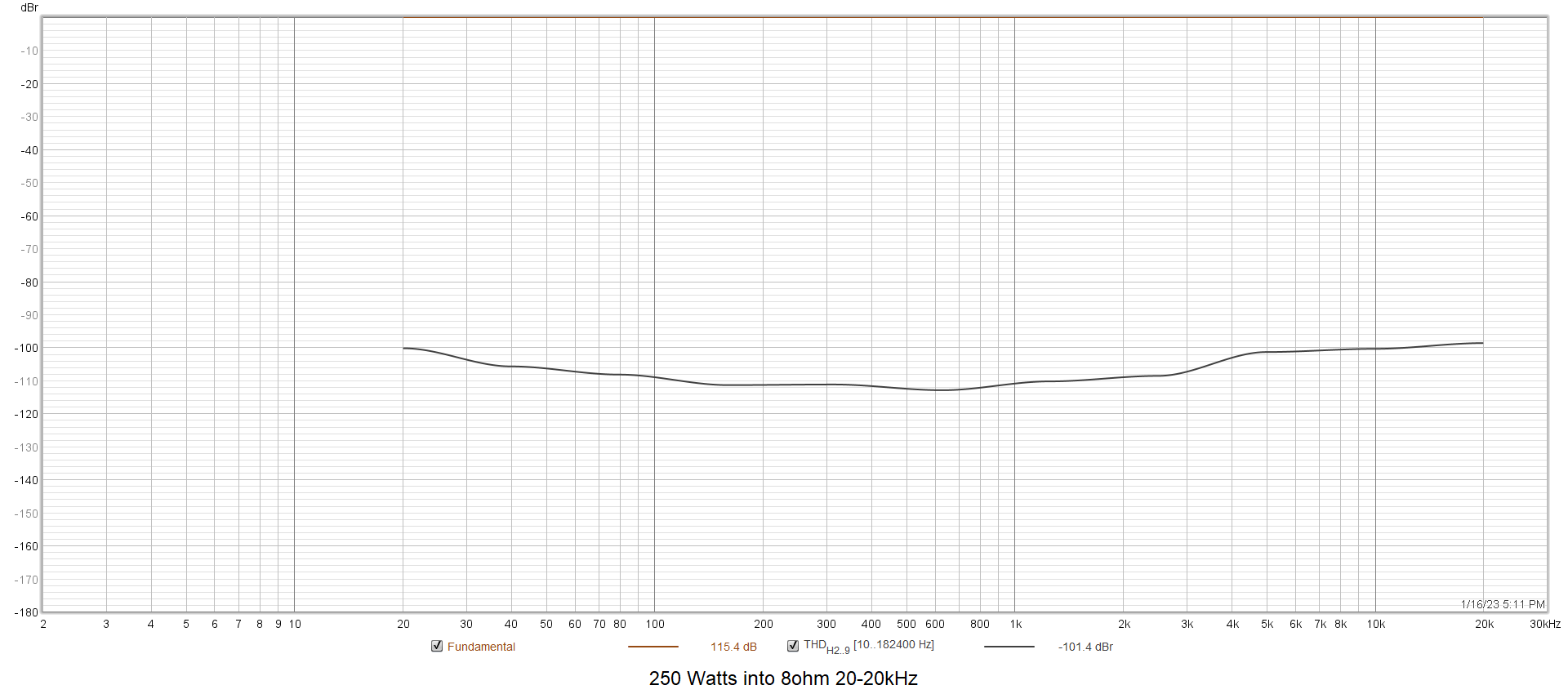

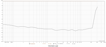

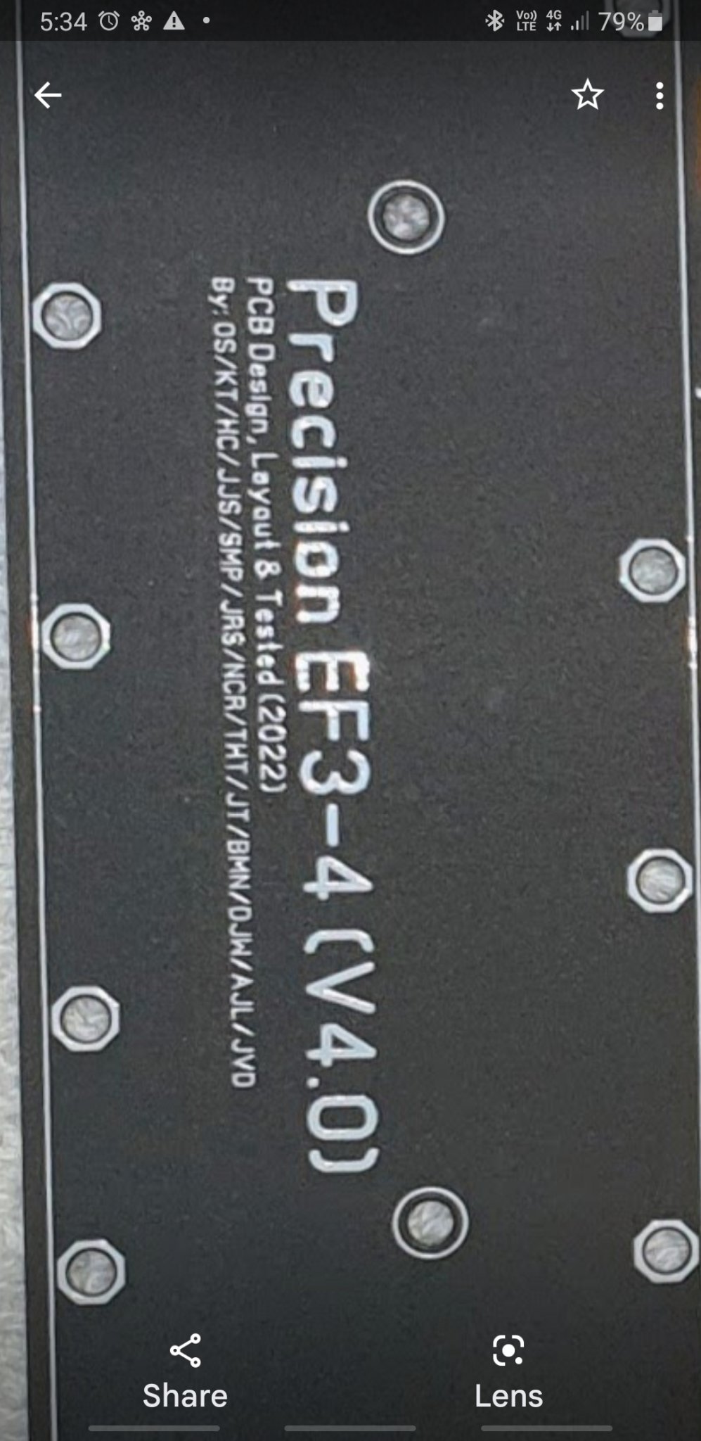

We are pretty close to those numbers, here is an EF3-4 with Sanken outputs that I am working on. Note the distortion vs. frequency taken at 250 watts 8 ohmWith these specs , someone with a wolverine should put it up against a 3K$ Parasound A21+ The parasound has more current and faster slew , but the wolverine has it "whupped" in PPM. Nice dominant 2nd harmonic , as well. World class !
Slew rate 129V/us 😎

It's also possible to have a slightly longer one for the EF3-4 boards.
I'll upload that tomorrow sometime.
Beaten ! Just think someone was "dissing" sanken devices on the build thread. I like those MT-200's , my favorite output pair is 2sa1295 /2sc3264.We are pretty close to those numbers, here is an EF3-4 with Sanken outputs that I am working on. Note the distortion vs. frequency taken at 250 watts 8 ohm
Slew rate 129V/us 😎
The small sanken's are "fast" high gain/Ft. I remember shorting amps out just to see if I could blow those devices.
Oh wow , 4 pair of my favorite's .... that is one powerful amp. PPM at 250W - wow !!
