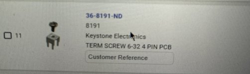

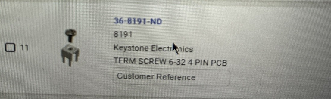

Just a hint to those who order at Mouser or Digikey or similar: It will save a lot of time if you use the "customer reference" field for the names given in the BOM, e.g. R17, when ordering.The only regret is not building with vishay as it is much easier to read numbers than stripes.

@voxxonline I don't know. The older I get, the happier I am for the pretty colored stripes.🙂 It saves me from having to sort everything under the microscope.The only regret is not building with vishay as it is much easier to read numbers than stripes.

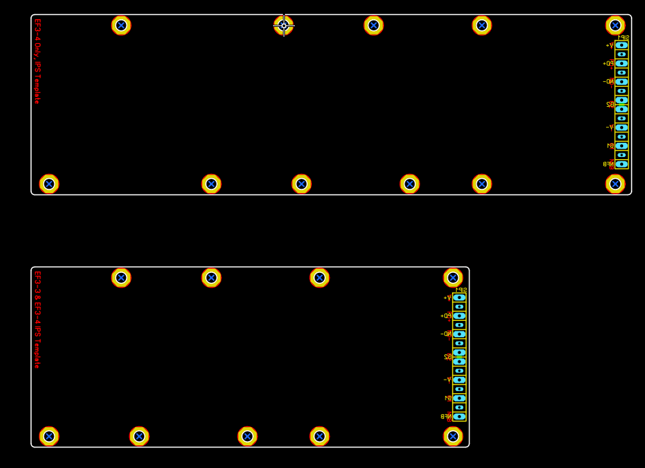

Hi Guy's
For those who would like to design there own IPS addition to the Wolverine family.
I have added the Sprint Layout IPS templates file to the 1st post of this thread.
One template will suit both the EF3-3 & EF3-4 precision output boards and one template will only suit the EF3-4 precision output board.
The mounting holes shown are all the possible holes that will line up with the EF3-3 & EF3-4 precision output board below.
Feel free to delete any of the mounting holes to achieve your desired IPS layout, but please ensure you leave enough to support you new IPS board.
Good luck.

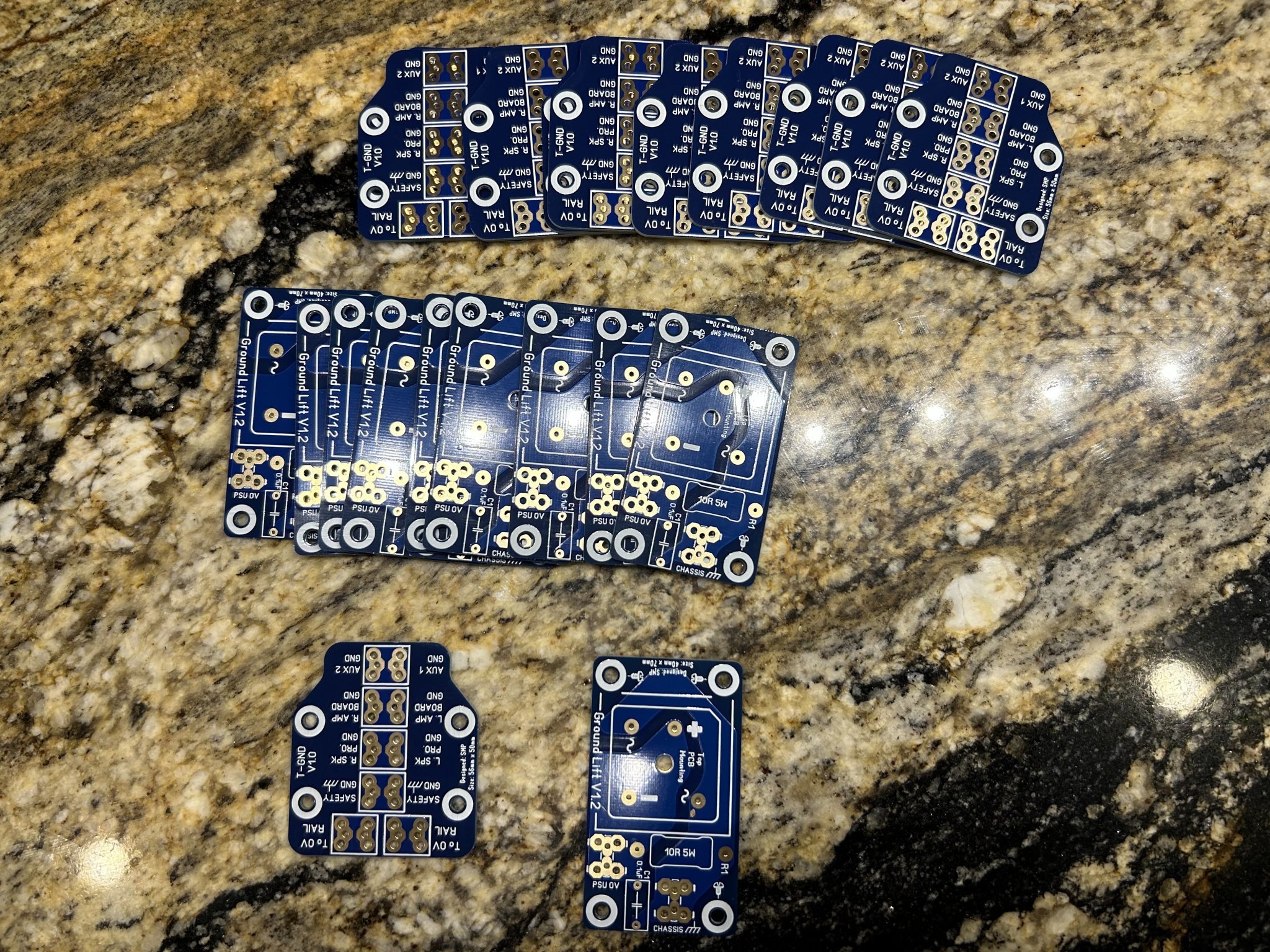

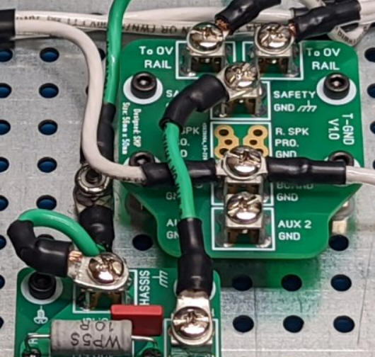

I notice that the traces on the ground lift boards above are large, in case of a mains fault. Unfortunately other boards I have seen, use very thin traces.
@Harry3
Excellent point. In fact, in all my builds, I use the thickest wire (i.e. lowest gauge) going from my chassis ground to the IEC ground, precisely for this reason.
Chassis ground is fundamentally the most important safety measure (other than the mains fuse) and there should be little to no impediment in case of fault.
