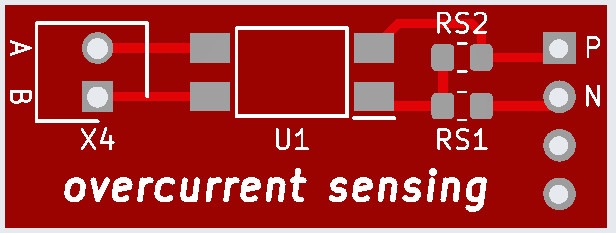

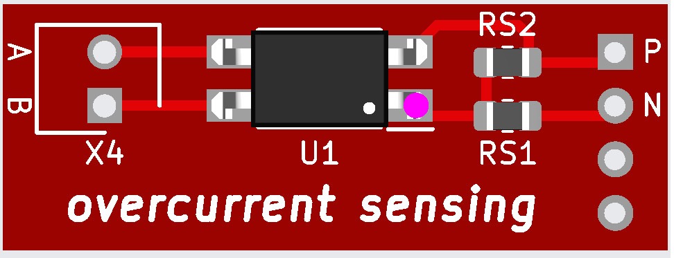

Just in case someone wants to use the ssr based protection boards designed by @LKA and just didn't dare to design his own pcbs to enable the overcurrent protection, I made these tiny overcurrent sensing boards for my Wolverine:
For Gerbers (and also the files you'd need for the assembly by Jlcpcb) just send me a PM.

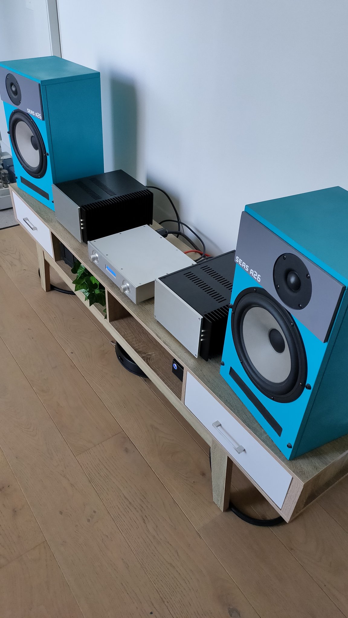

Just use a DAC straight in...plenty of gain I control volume through a raspberry pie with squeeze box serverNice setup, is that a diy preamp? Speakers are nice too.
