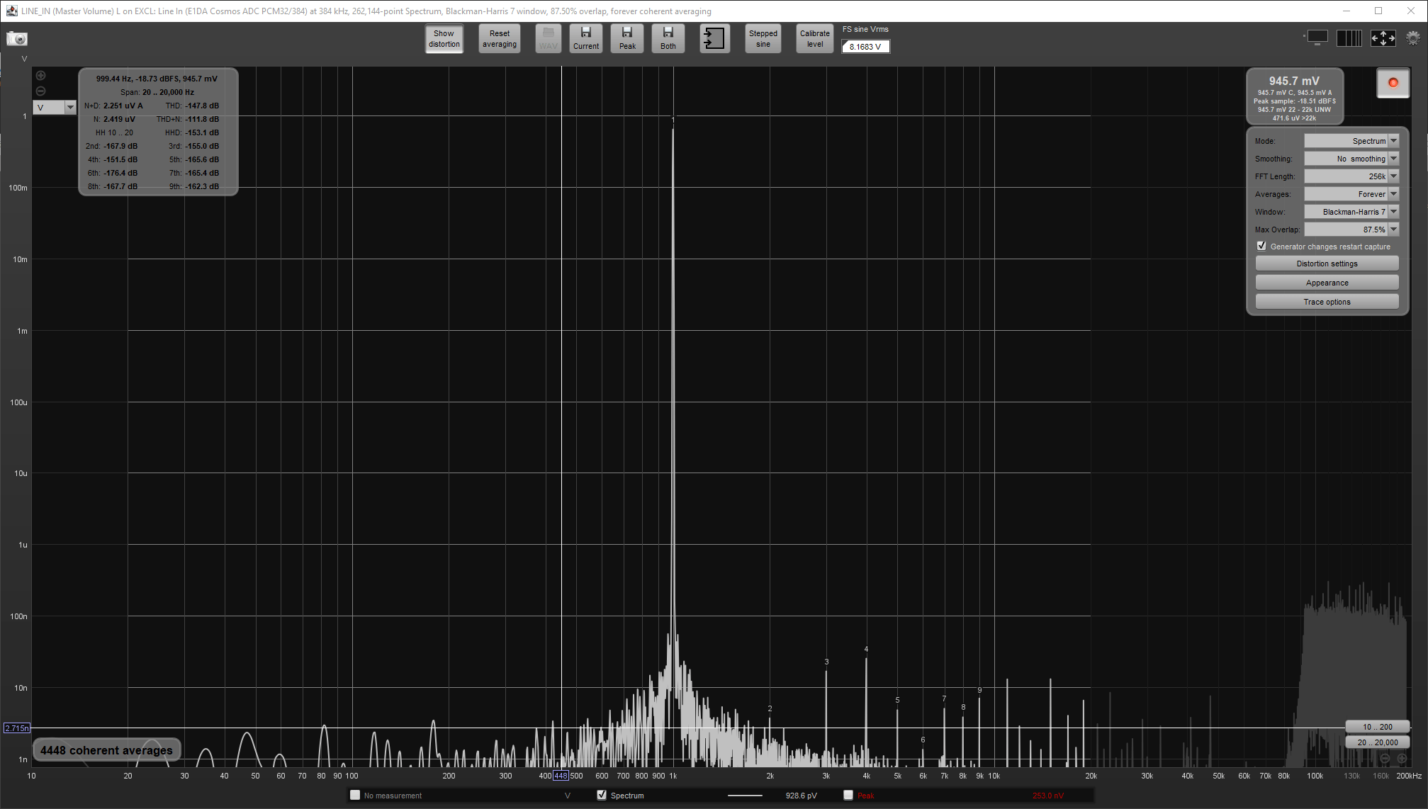

I use a the following;fireanimal:
Can you show me your measuring device?
Is the measurement of the test oscillator available?
Room EQ Wizard
Multitone Analyzer
Topping D10s
Linear Audio Autoranger
Cosmos Grade 0 ADC
Cosmos APU Notch
Distortion Magnifier
Viktor Precision 1kHz Oscillator
Viktor Precision 20kHz Oscillator
What kind of measurement are you looking for?

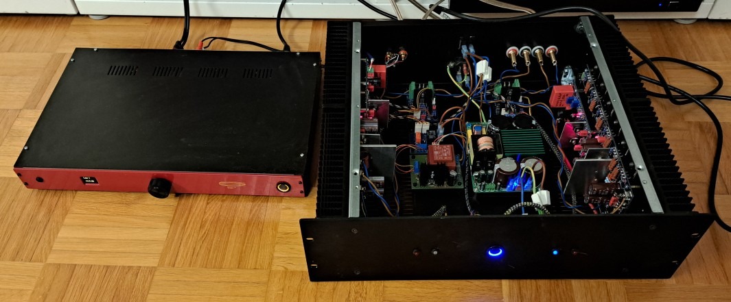

I feel somehow blessed listening to this peaceful coexistence of my new Wolverine prototype with my old (digitally modded) Doug Self preamp:
But the Wolverine definitely deserves a nicer front panel. Any suggestions? How did you guys design your front panels?

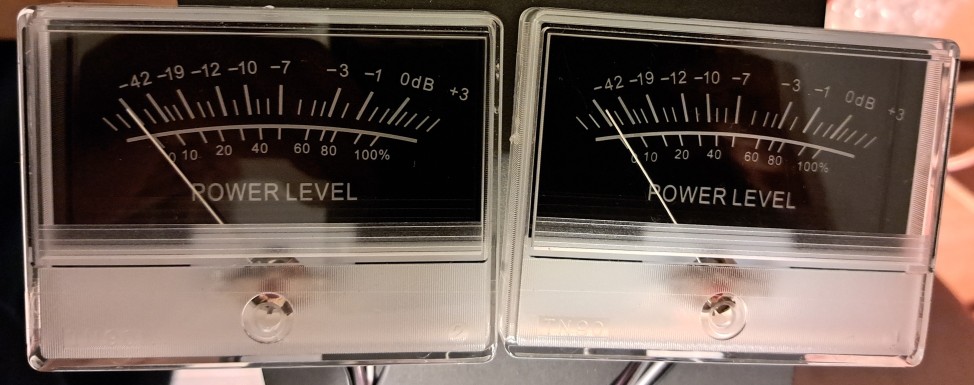

Maybe I'll give my old analog level meters a chance - they remind me a little bit of the old Onkyos:
Anyway: Thanks to the Wolverine team for this wonderful amp and the outstanding support. And thanks to LKA for his protection boards.

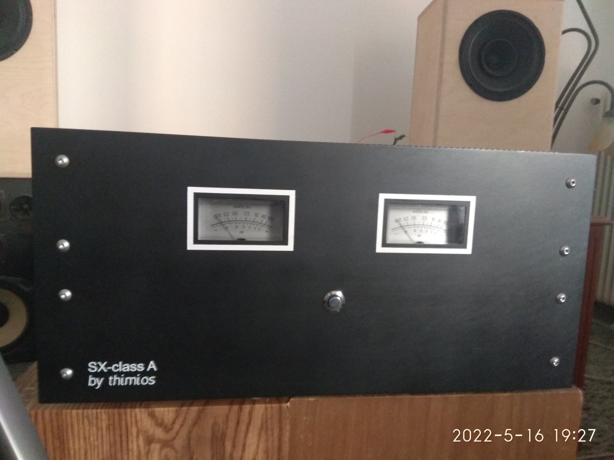

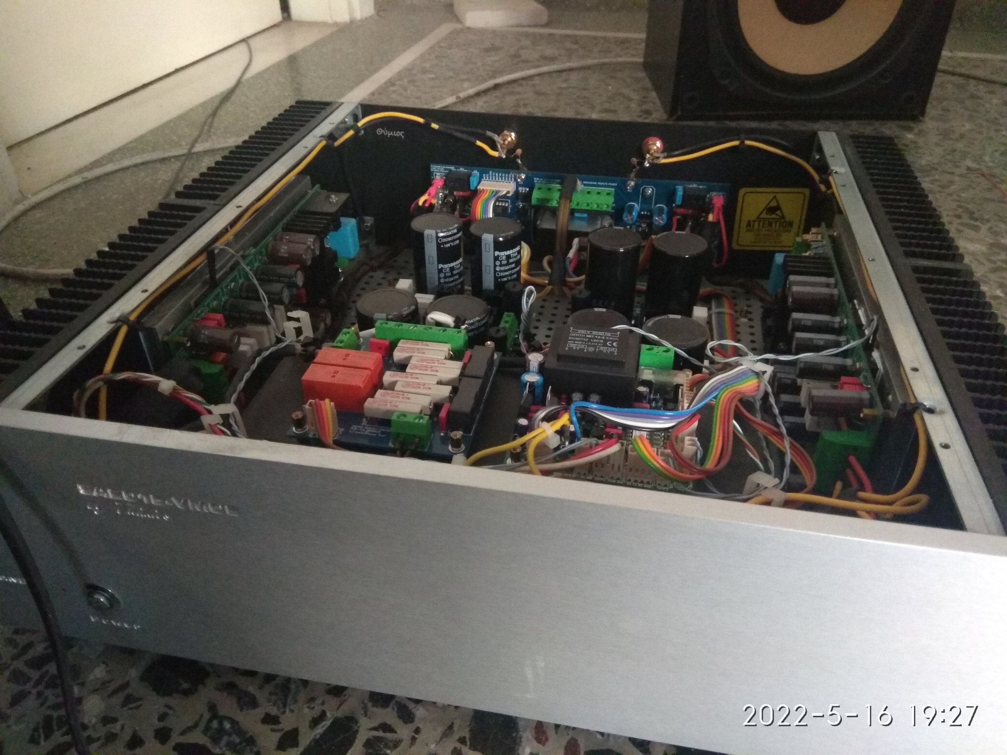

I used a Lazer engraved front panel.
Very nice results.
1st image Lazer engraved
2nd image CNC machined.
Very nice results.
Thank you @poseidonsvoice and @thimios for your suggestions. I will definitely go for Schaeffer, as I am not the most talented one in metal crafting...
Maybe I asked the wrong questions:
I need some pics for inspiration.

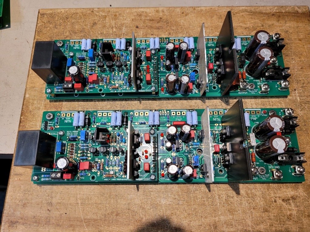

Looking really good 👍🏻Getting there... Testing next week
Just to comment that these boards are among the best I ever saw and worked with. The design and layout are a thing of beauty. We can really see that countless hours were spent to reach such great design. The boards are top quality, and the building guide is well done and really helpfull. Great work. Can’t wait to test it and then hear it! Thanks for sharing your desing.
SB
SB
