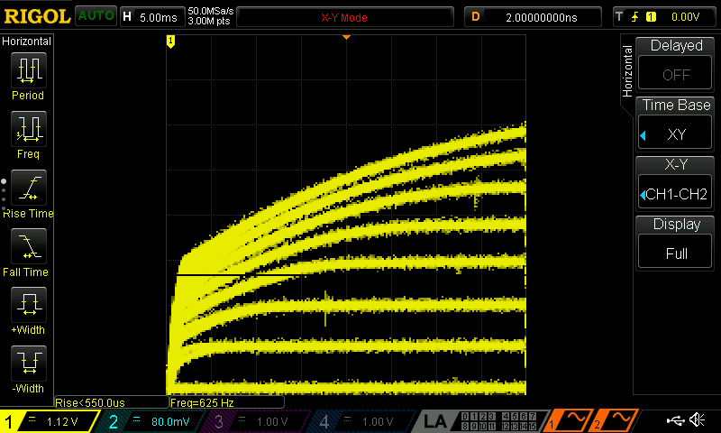

Hi asuslover,
These small and cheap "transistor testers" measure at low currents and usually do not provide acurate results, especially for larger power transistors. You simply get a single point result, far away from the actual operation point.
Better solution is to use curve tracer - I am using "CH-012 Transistor Curve Tracer Adapter for OSC" from thaikits.com. To use it you need a digital oscilloscope in X-Y mode.
A snapshot shown below illustrates what you get. The point is that you may measure closer to the real operating point and it provodes a graph of Collector current vs. Collector-emitter voltage. These graphs in data sheets are just for information. The real world values may be different.
"Complementary tranistors" are often complementary in the name only.
