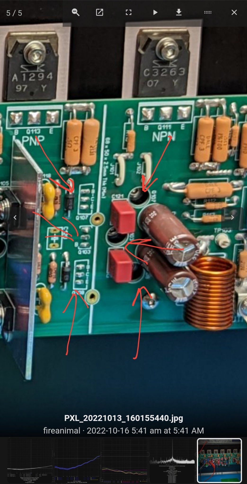

I just completed a EF3-4 using Sanken outputs and Toshiba drivers,
Your build looks great! Looking at the pictures of your board I am asking myself why you used the two small heatsinks but omitted the third, biggest heatsink for the driver transistors (?).
With the EF3-4 the builder have the option to mount the driver transistors on the main heatsink.Your build looks great! Looking at the pictures of your board I am asking myself why you used the two small heatsinks but omitted the third, biggest heatsink for the driver transistors (?).
Thanks Stuart, but what about the EF3-3 version? Looks like I have to unwrap the boards and take a look..With the EF3-4 the builder have the option to mount the driver transistors on the main heatsink.

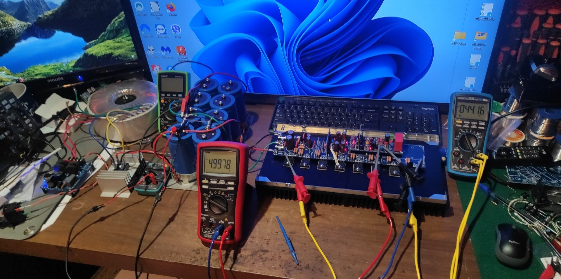

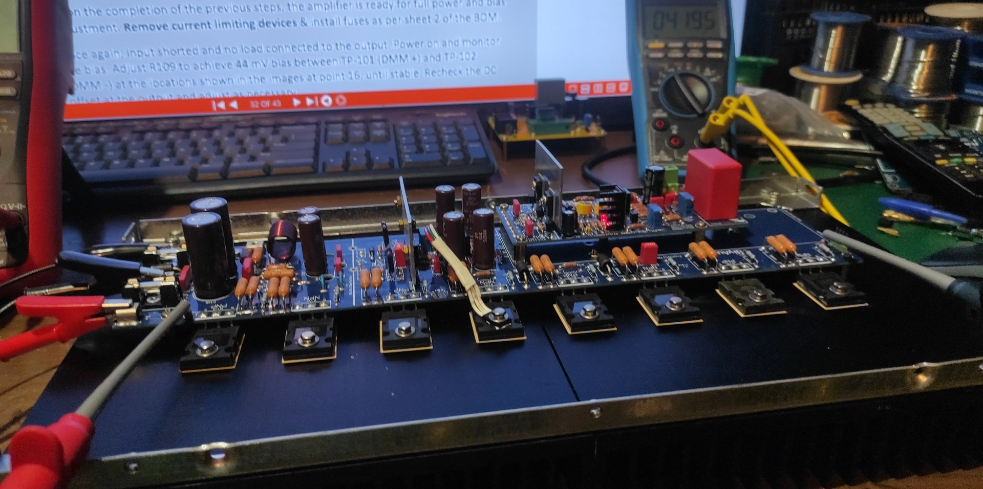

Both boards working perfectly power up and bias wise on 71Vdc railsView attachment 1100268View attachment 1100269

EF3-3 drivers are heatsink mounted only, there is no provision to mount on the main heat sink under the board.Thanks Stuart, but what about the EF3-3 version? Looks like I have to unwrap the boards and take a look..

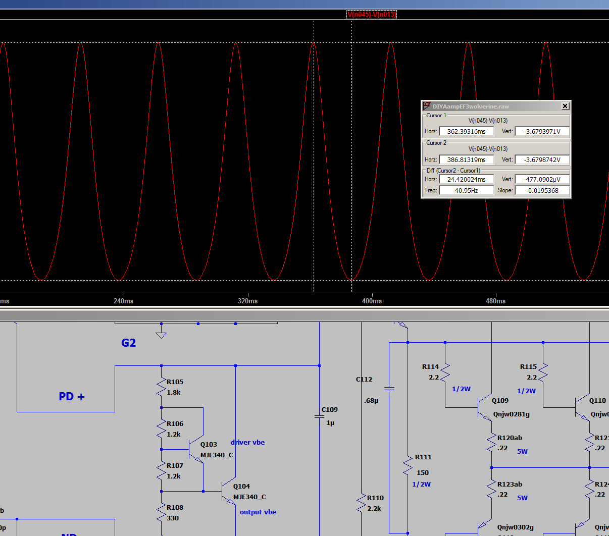

Very high VBE ripple. Please see screenshot.This is false too. I do not understand why you keep hammering this thread with lies. The AP uses notch filters which is the same thing I did. The measurements I made are solid and repeatable.

What are you even measuring?Why should I measure when I can simulate? Too bad if the amp isn't further improved.
Your post is not clear.
Unless you have the Bom you don't know what the values of key components are.
We also have highly accurate simulation models for the transistors which you will not have.
Also your simulation file looks very basic. Our simulation file takes trace capacitance and inductance into account with values that we actually tirelessly measured on a real board.
