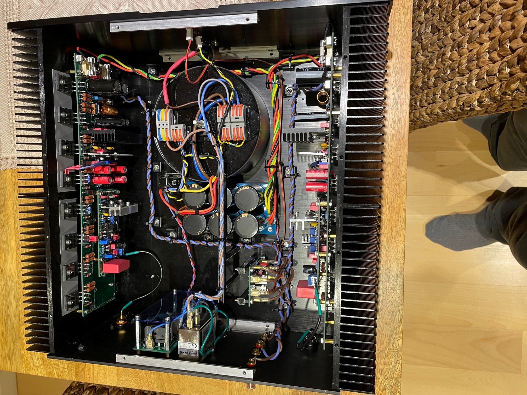

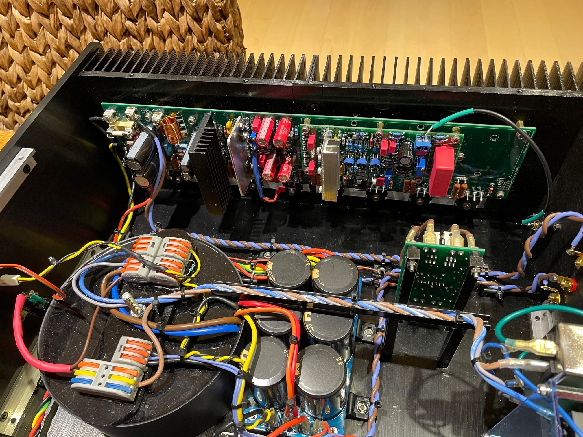

Great build, and yes you are right, it's the best I have ever heard too!Hi Stuart,
You asked for pics. It may not be the neatest build, but it is the best I have heard.
Once again my thanks to all the team.
Ashley

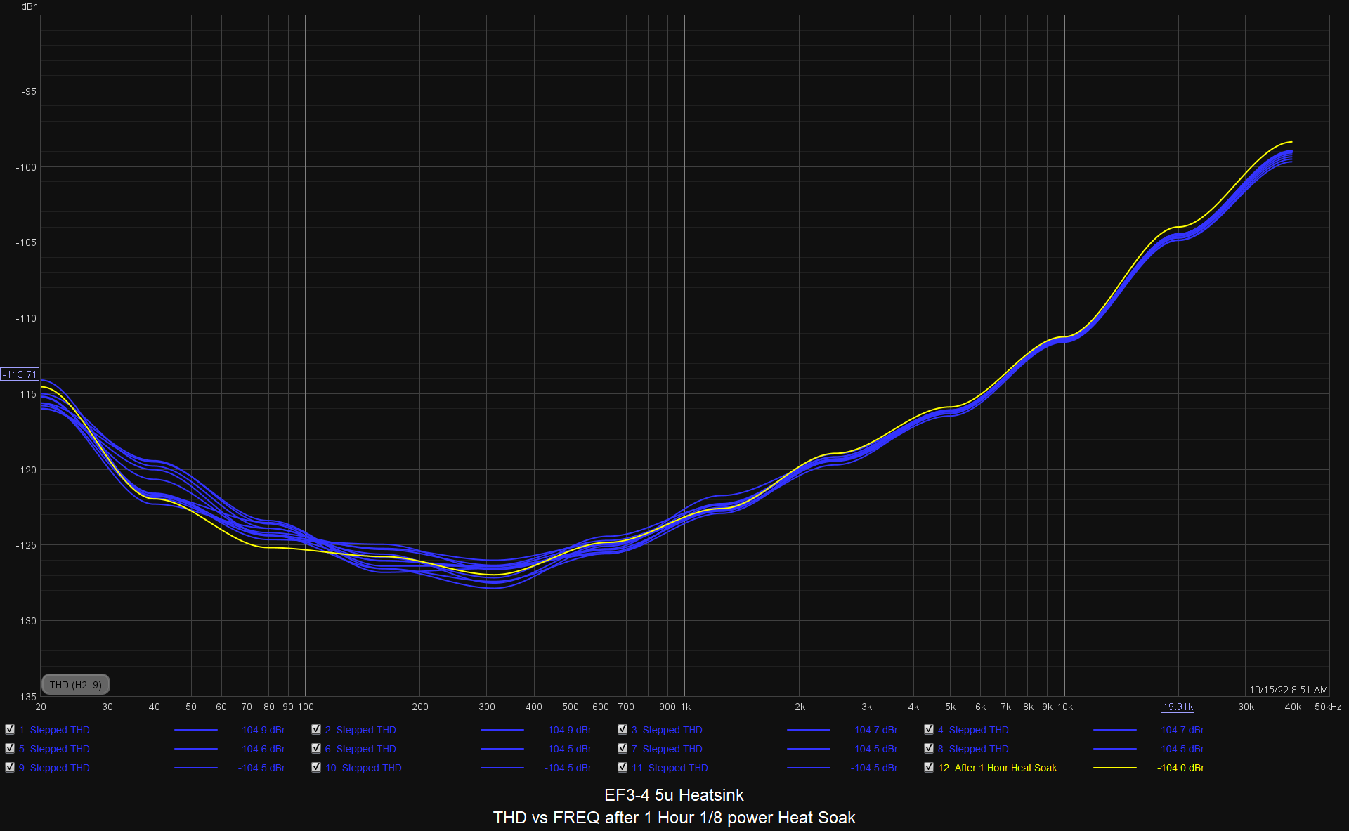

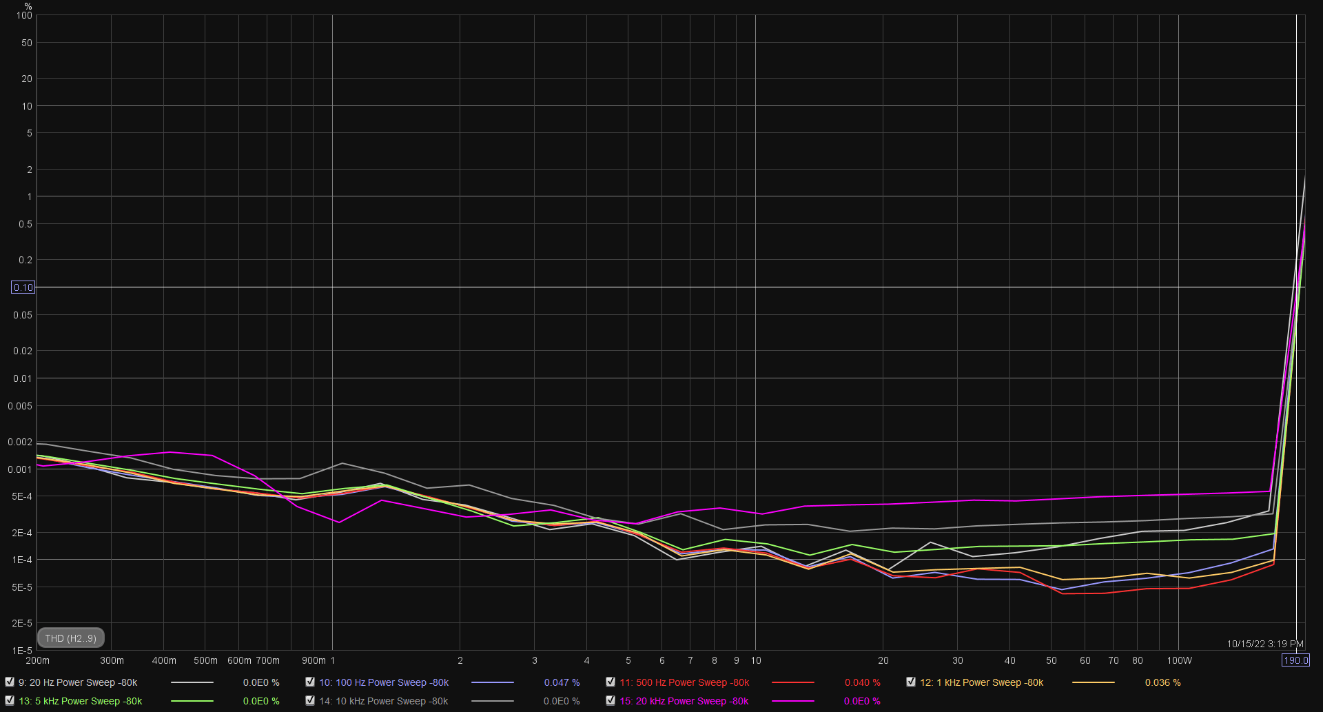

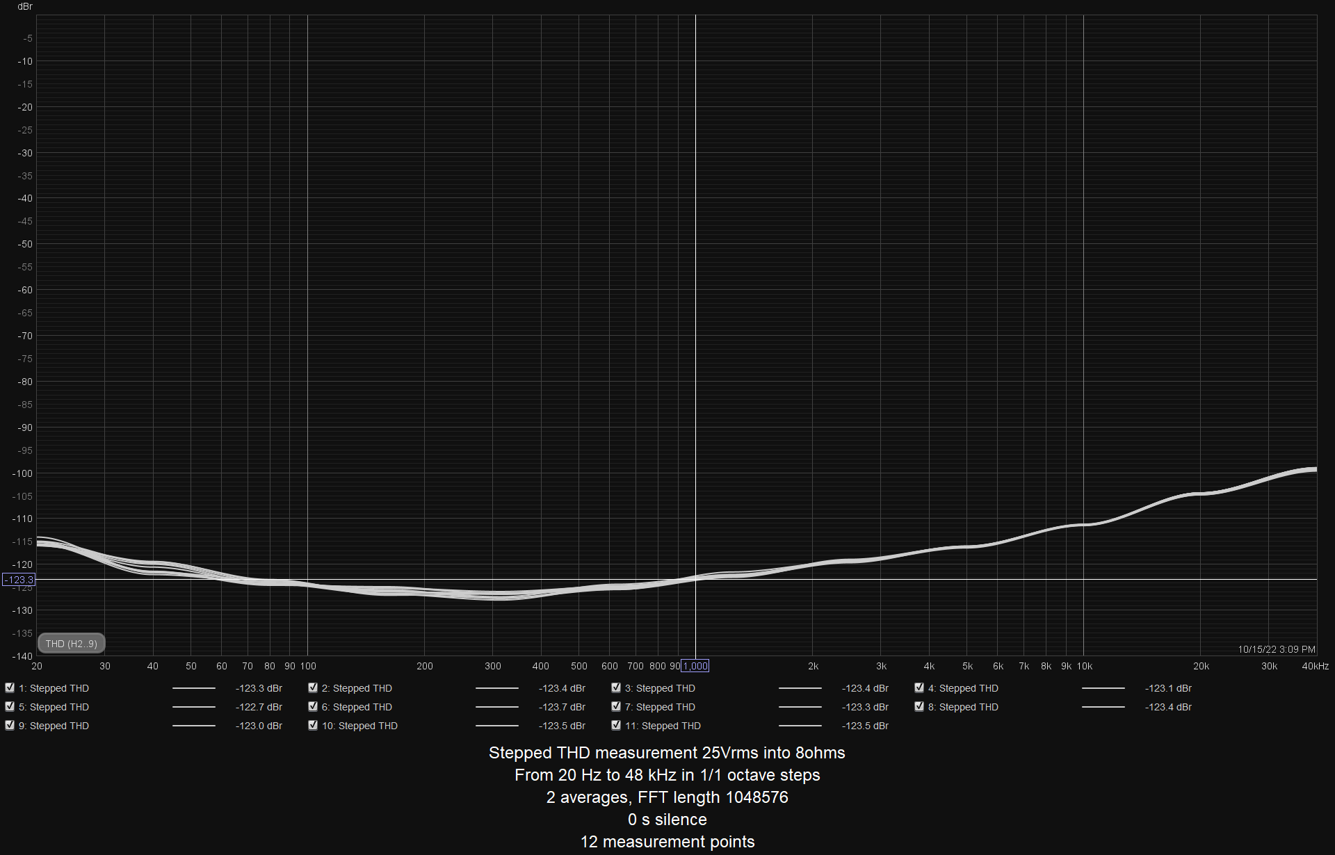

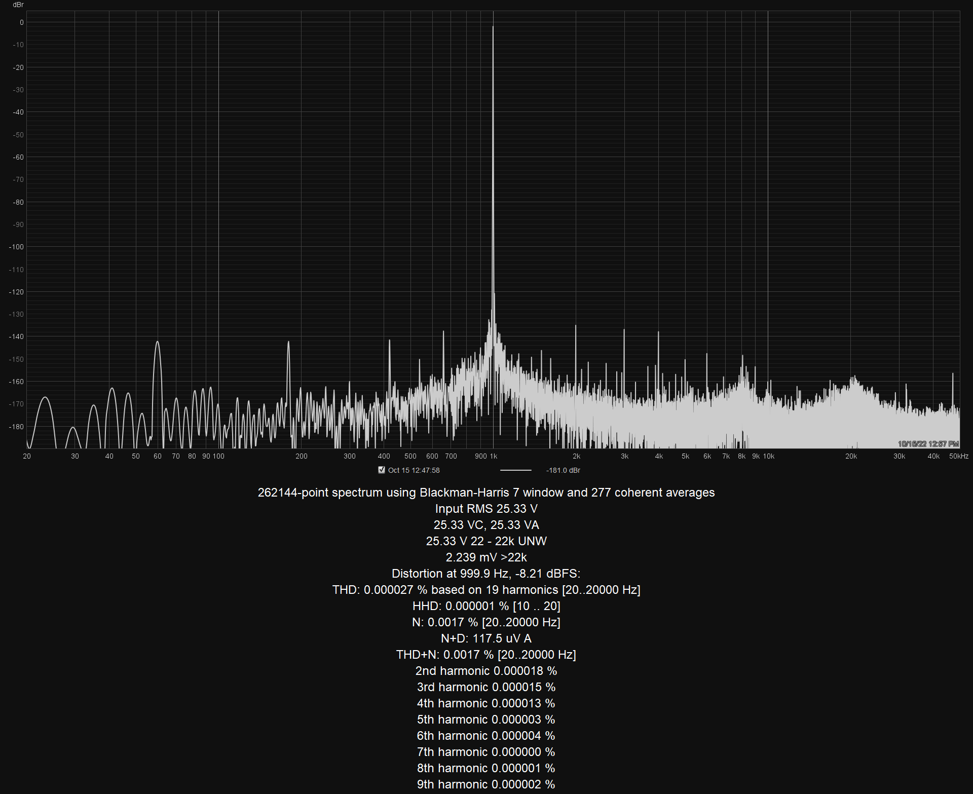

I just completed a EF3-4 using Sanken outputs and Toshiba drivers, and wanted to share the following measurements with you all.
First test - Frequency sweeps from 20Hz to 48kHz @ 25Vrms into a 8ohm load every 5 minutes for an hour from dead cold power on. I ran this test to check stability and distortion over the time it went from cold to hot, as you can see that amplifier is very stable and does not drift.
Second test - Heat soak running band limited pink noise 20-20k @ 1/8 power(25 watts) for 1 hour, then ran the same frequency sweep as before and compared it to the proceeding sweeps. Note the scaling is highly zoomed in, yet the amp held the low distortion as before.
Third test - Power sweeps to clipping at different frequencies, and to see how well the distortion holds up at higher power levels. The amp runs around 190 watts @ 0.1% with 60 VDC rails from 20-20kHz.
Fourth Test - 1 kHz FFT @ 25 Vrms into 8 ohm load. I am using a 1kHz notch filter in this test. ----0.000027% THD | -131.37 dBr----
Your build looks great, absolutely love those green boards. I'm so happy that you have completed your build and your happy with the performance. Thanks for posting and I hope you enjoy listening to your favourite music.Hi Stuart,

This is some great work Andy - Excellent results.I just completed a EF3-4 using Sanken outputs and Toshiba drivers, and wanted to share the following measurements with you all.

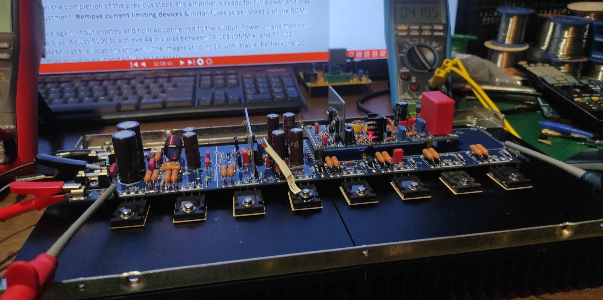

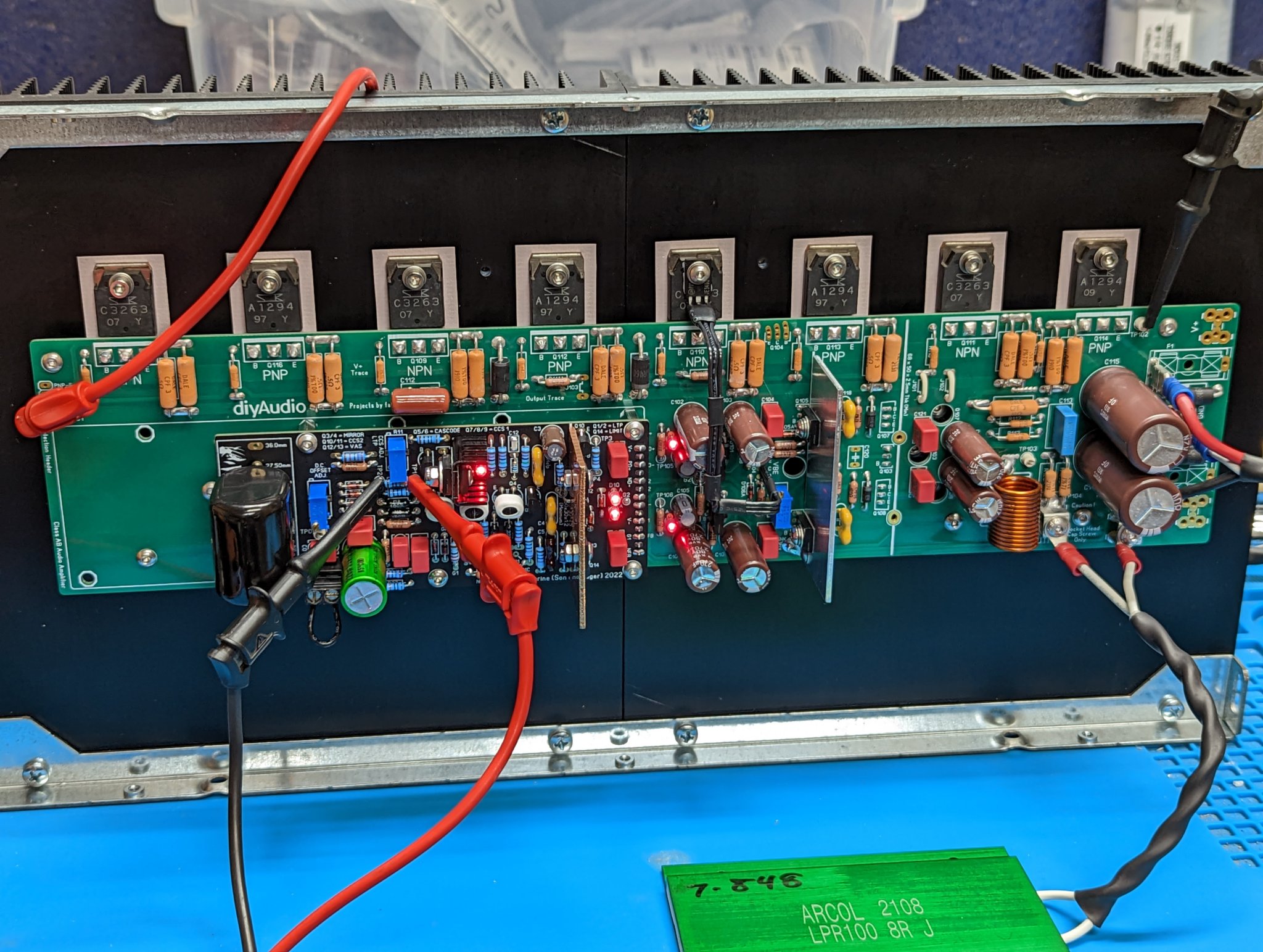

Making progress on my build.
Both boards working perfectly power up and bias wise on 71Vdc rails
Obviously, this amplifier has a great potential, but to attain such results there must be something more. Could you, please, tell us what are the most important practical details that lead to such an extraordinary result.Fourth Test - 1 kHz FFT @ 25 Vrms into 8 ohm load. I am using a 1kHz notch filter in this test. ----0.000027% THD | -131.37 dBr----
