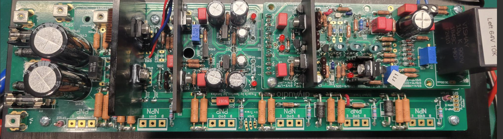

Yes, I started with older BOM. I have just compared resistor values I used with BOM May 2024 and it looks that my EF3-3 is OK (perpendicular to main heatsink pcb mounting), while in my EF3-4 I used resistor values for driver mounting on the main heatsink as BOM I used did not differentiate between main heatsink and perpendicular driver mounting on 3mm separate heatsinks. Theoretically I could mount my EF3-4 pcbs on the main heatsinks but I prefer perpendicular mounting so I have to change 3 or 4 resistor values. Hopefully I'll manage it without damaging pcbs. Alternatively I can solder additional resistors in parallel as resistors I used have higher resistances.
Yes, I have noticed that mounting of Q103 and Q104 has been changed.

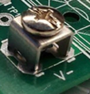

One more question: where could I get these terminals ideally in Perth or in Australia?

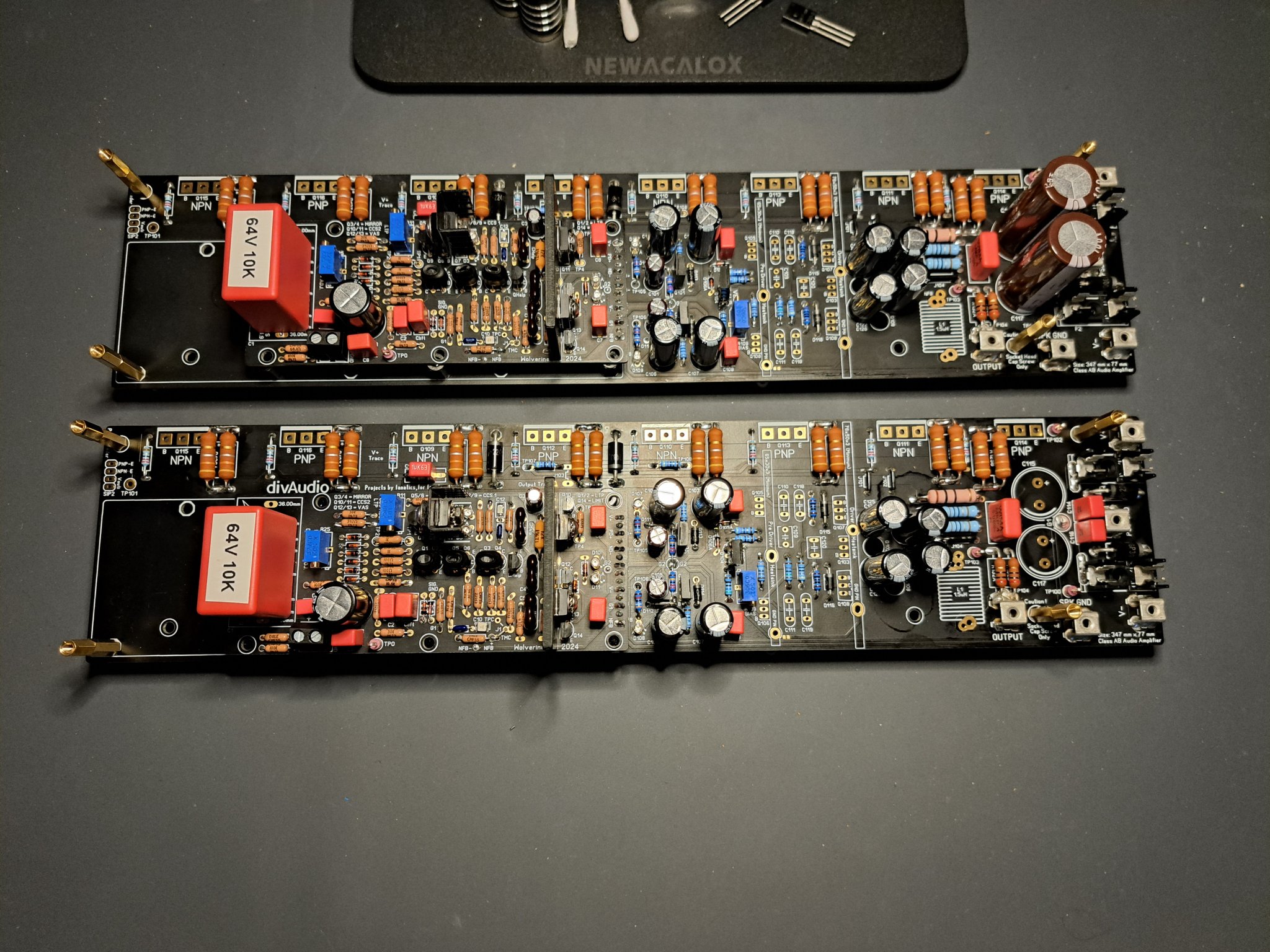

I made some progress during the holidays - IPS finished and tested, EF3-4 boards almost finished.

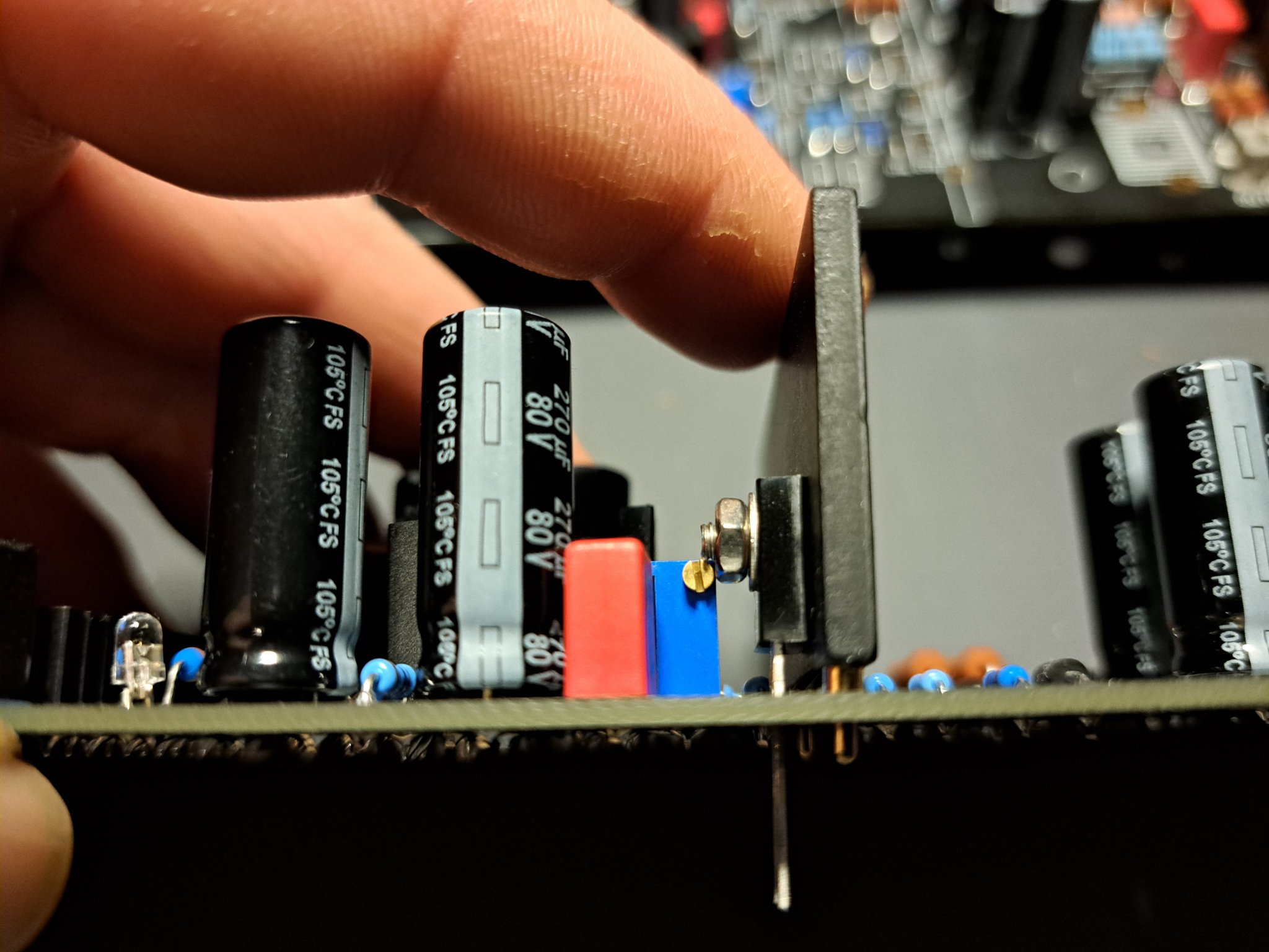

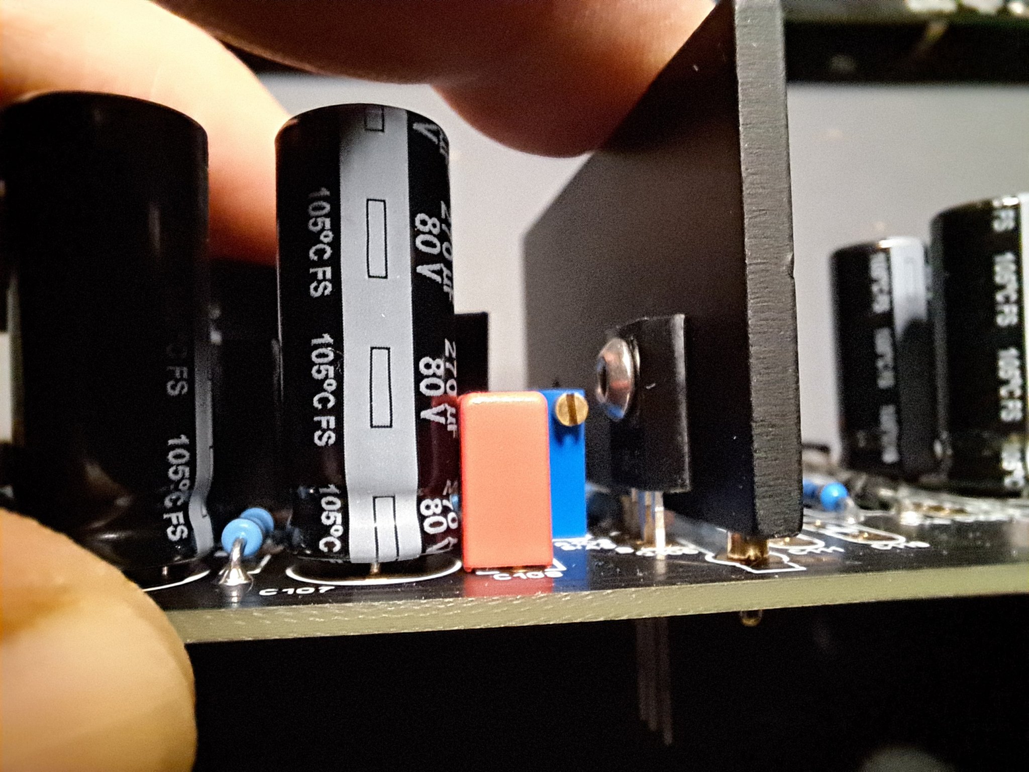

Still figuring out the best solution for mounting the pre drivers to the heatsink, the nut inferferes with the adjuster on the trimmpot. Buttonhead would work but then I won't be able to unscrew the transistor if I have to change it someday.
Power supply layout:
I like this project a lot 😁

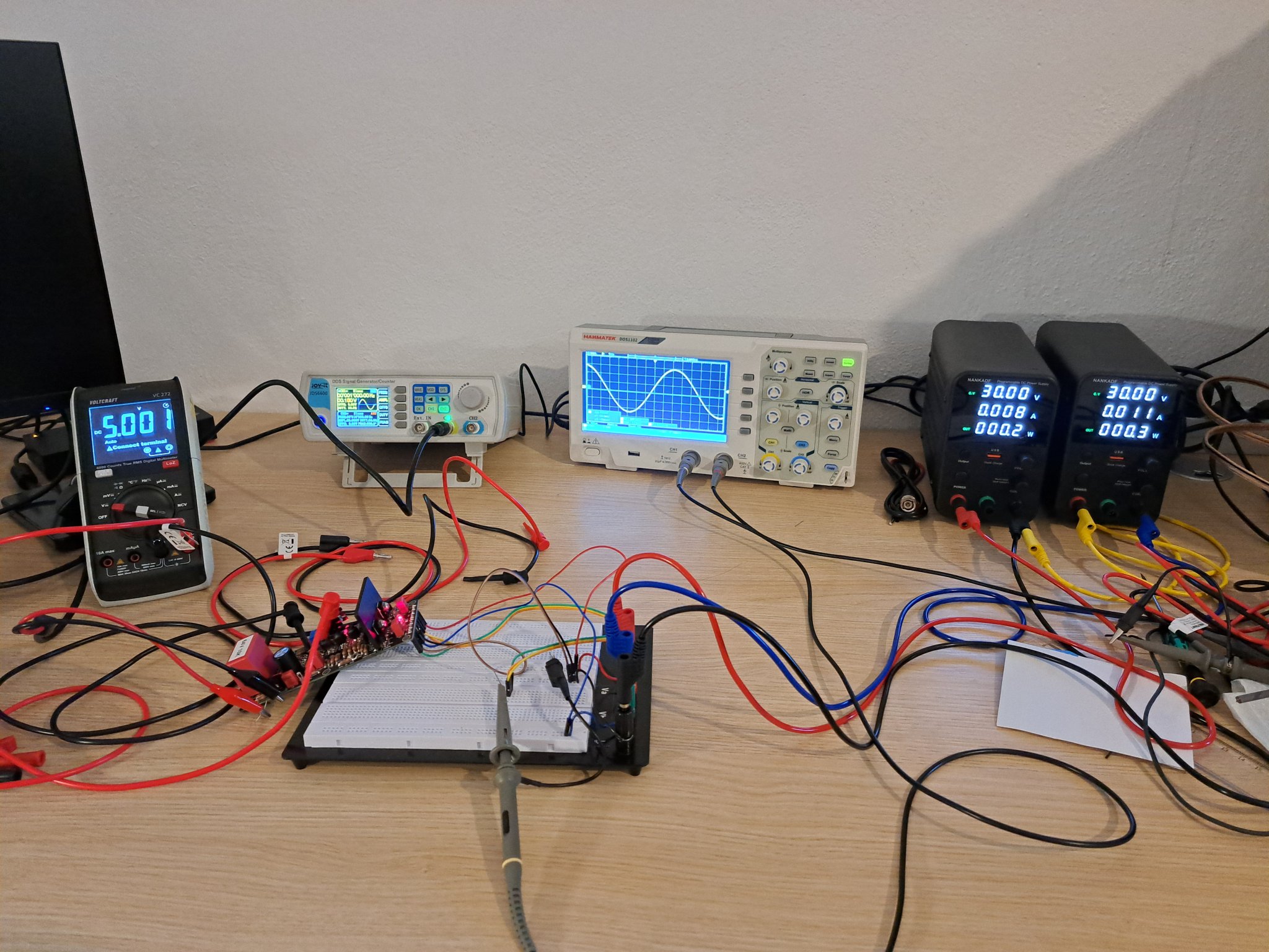

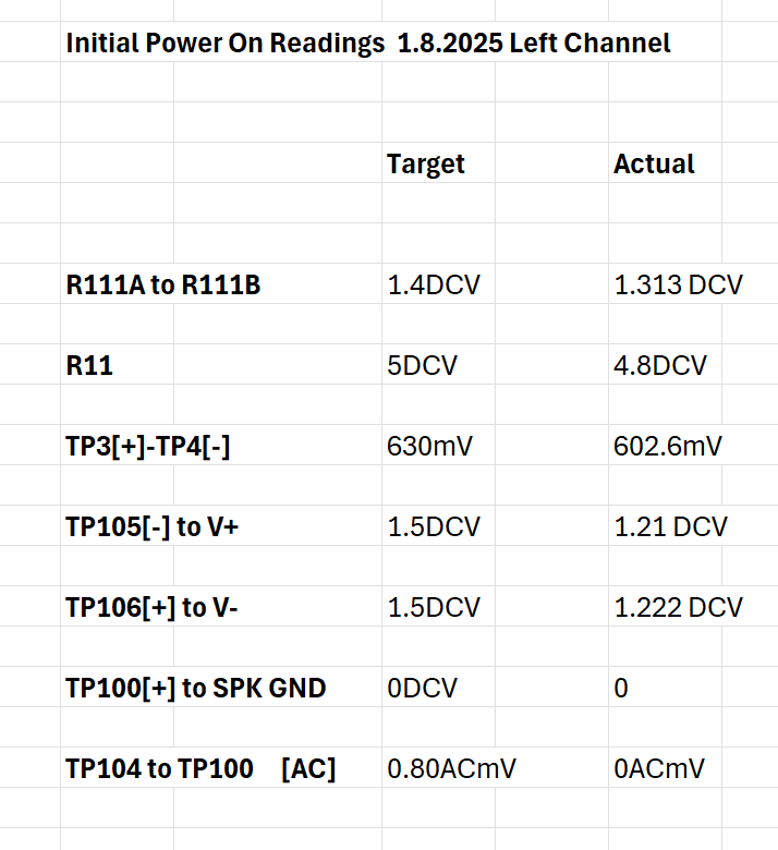

I have my initial readings from the left channel and some issues. I used 30DCV and 0.3 amps for power from the DCV regulated supply.
The two Leds on the IPS don't light up.
Otherwise, my readings are within target.
I checked the LED orientation.
Is the LED issue because I've restricted DCV to 30V?
