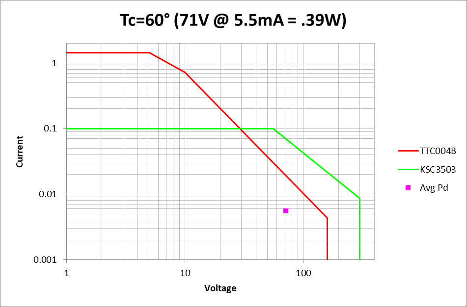

TTA/TTC have higher gain than the 3503/1381 - typically ~220 vs ~80-130 , so are preferred at Q101/102 as this is the capacitance multiplier. Higher gain = better rail smoothing, and rail voltage isn't so much of a concern in this part of the circuit compared with the predriver position.
The Predrivers Q105/106 are running class A. Here is the temperature derated SOA for KSC3503 vs TTC004B, well within the DC SOA using a heatsink.
Exactly. Actually a few other transistors could be used here such as ksa1220y/c2690y, 2sa1249t-s/c3117t-s, 2sa1930/c5171, 2sa1209t/c2911t as these have even higher Hfe than 3503D/1381E as F are no longer available. KSA1142y/C2682y could be used as well but are too precious for other applications such as predrivers Q105-106.

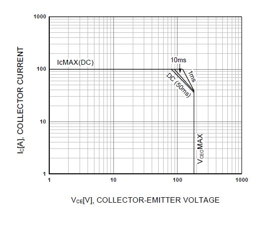

SOA of KSA1142/C2682. Vceo 180V, Cob 4.5pF, Ft 180MHz. Unfortunately now obsolete. Luckily still have a few. Managed to desolder TTA/TTC from EF3-3 pcbs (Q105-106). Not easy to do that on two-sided pcbs. Luckily did not damage them. Then replaced TTA/TTC with KSA1142/C2682 but made a mistake swapping their locations because on the schematic I wrote KSA1142 next to TTC and KSC2682 next to TTA as better options. Must be getting too old for building amps.

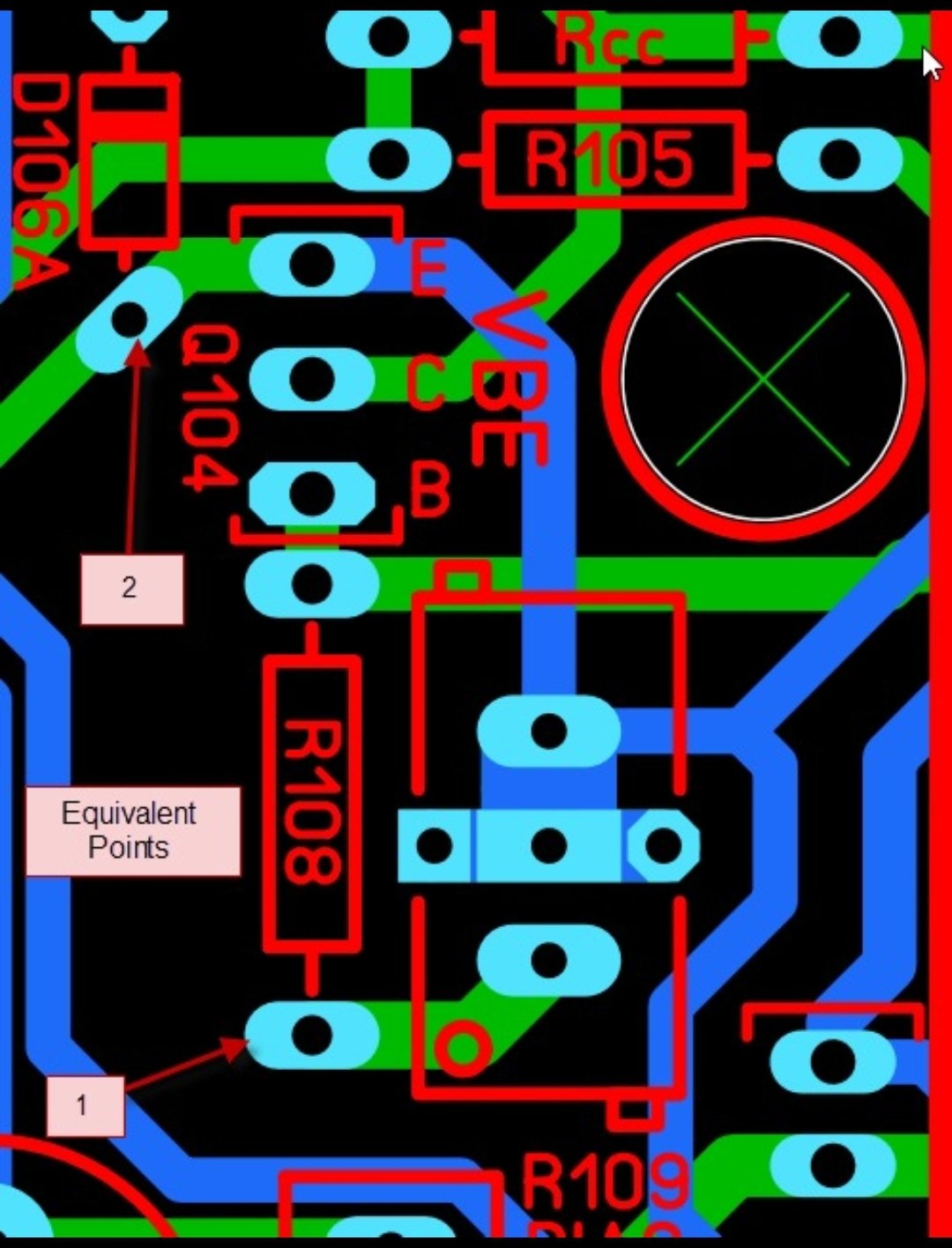

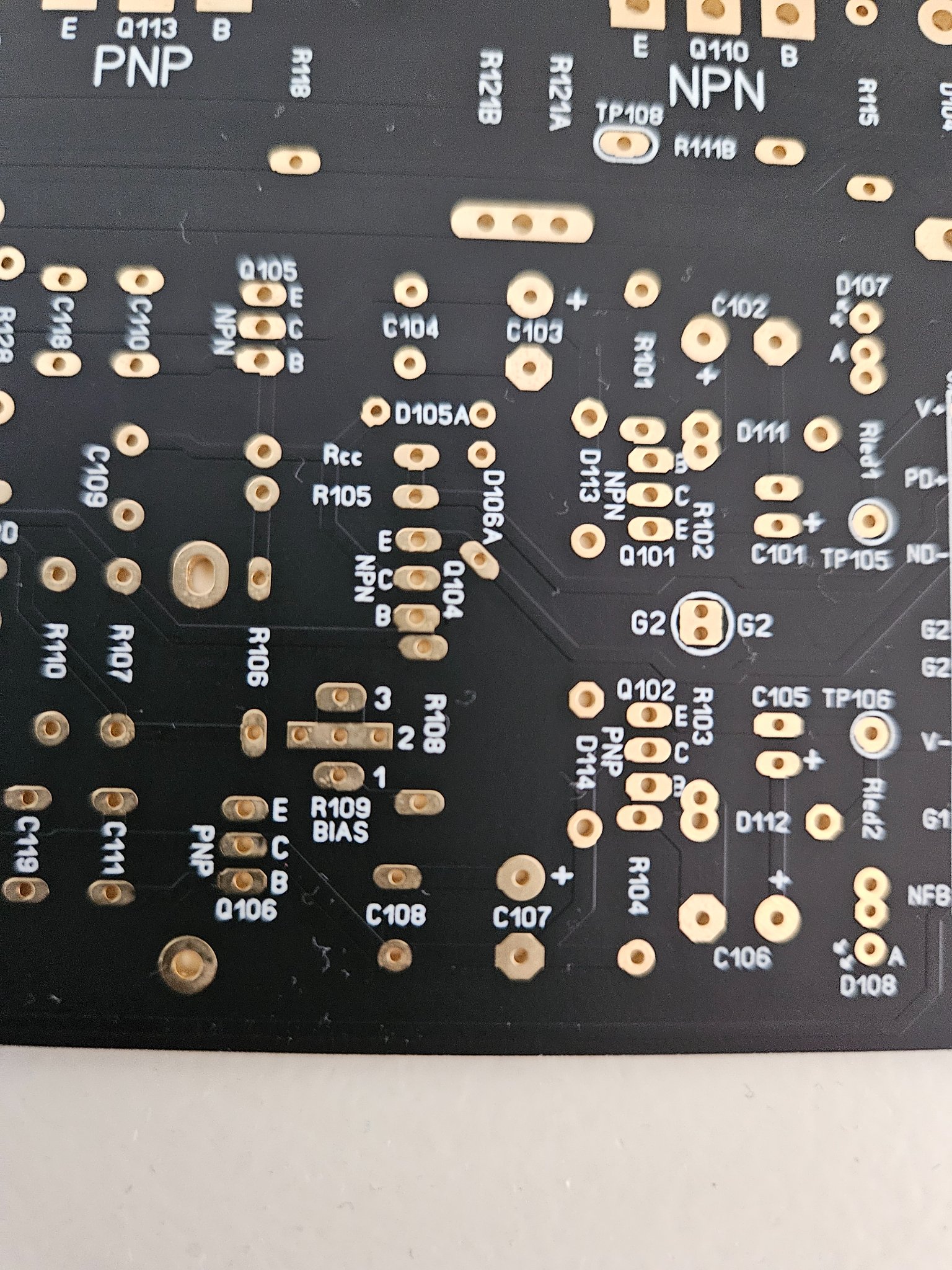

Getting ready to test my 2nd channel and want to make sure I set R109 correctly.
Have I mapped this out correctly?
Please read point 22.2.C of the build guide and refer to the markings on you pcb silkscreen to know which is pin 1 and 2 so you can measure the resistance in the correct location.
If you board is installed you can check here.
Just verify the resistance and the direction you need to turn the pot with your DMM prior to turn on.

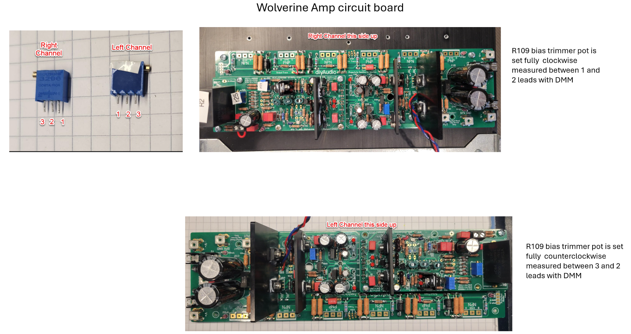

I'm thinking I'm dyslectic regarding this pot install. Just don't want to light up my new board. Already done that once. So, is this clear, and correct?
My new left board will be installed with the output transistors down vs. the right board's transistors will be on top. For the right board the R109 was installed with 123 on the pot aligned with 123 markings on board. I measured resistance with with + DMM lead on 1 and - lead on 2 which showed 450R. To bias in this position I turned the pot left.
For the left pot I inverted the pot so that 1,2,3 were reversed vs the board markings. I measured the pot with red DMM lead on 3 and - on 2. I measured 450R resistance. To bias this pot I will turn the dial right.
OK, slow down. On the left board you said you measured on the 3 and 2 pins. Is that the the 3 and 2 stamped on the board? If it is, then you are wrong. The circuit didn't change on the board because you flipped the pot. You still measure between 1 and 2, but it will adjust the opposite direction.
