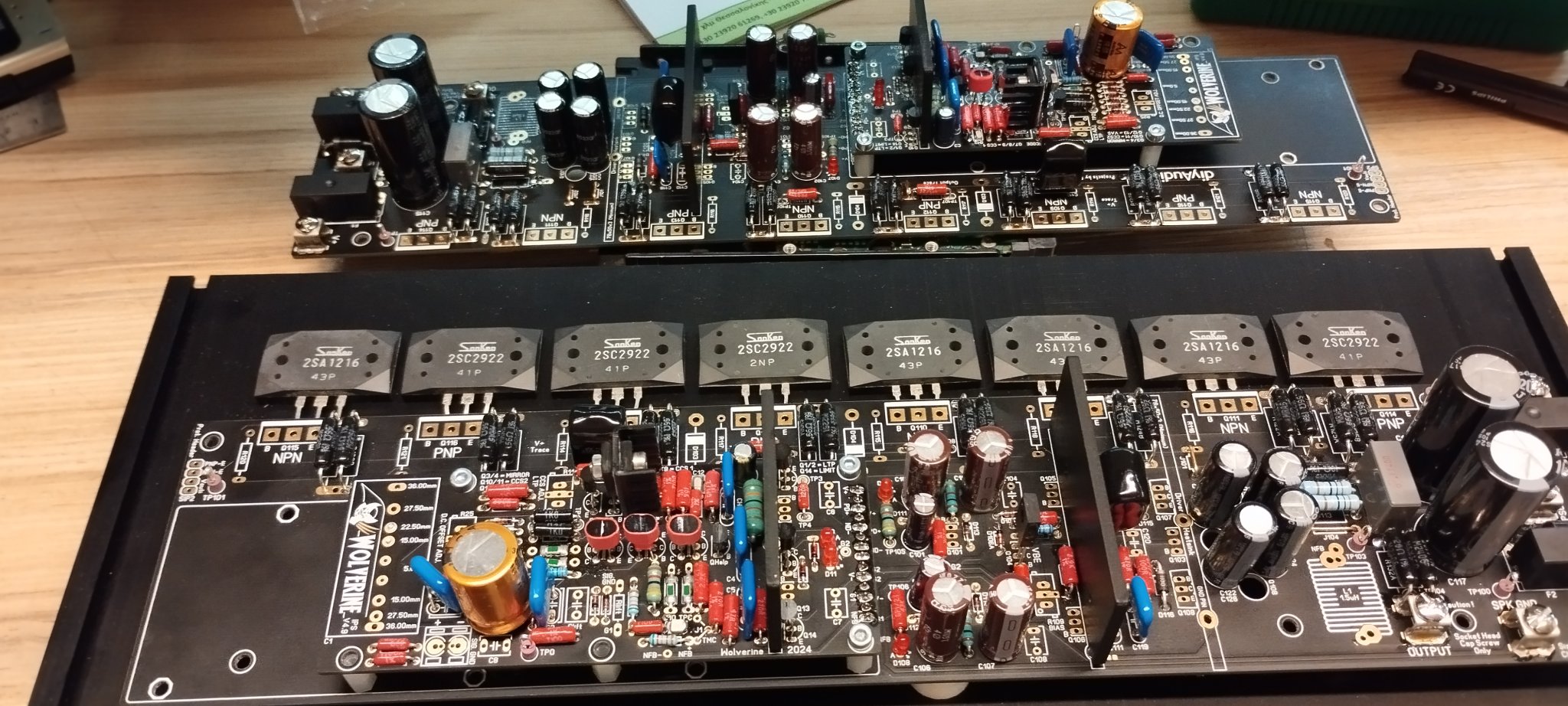

Hello all!
Finally got round to putting this together.

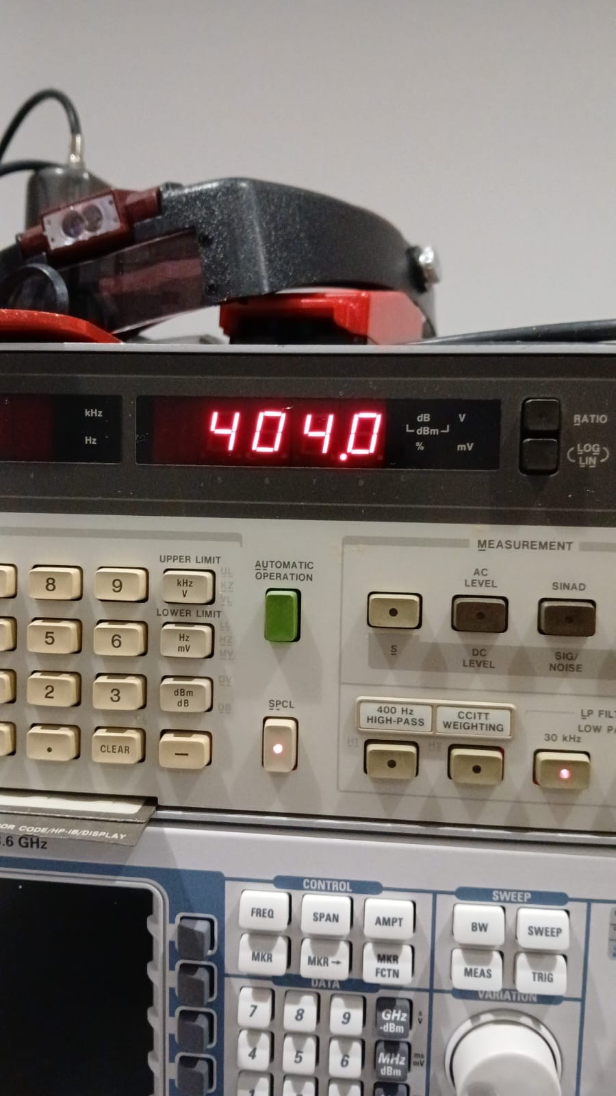

I’m getting 404 watts at 67 volts.
How much can I push it? I’ve got some very power hungry low sensitivity speakers I’m planning on driving.
Is 450 ish watts at 4 achievable?
can you elaborate on your build? 3-pr or 4-pr version, what choices did you make on outputs? What is this testing done with, assume 4-ohm, but at what frequency, 1kHz? Not a lot of information to provide you feedback on you 450 watt goal.
Additionally - you won't be able to tell a difference at 400 vs 450 with your ears. Yes, you can measure it and brag about it, but you won't be able to "hear" a 50 watt difference listenting to music.

@AvLee Oh, sorry, I misinterpreted your measurement setup. I don't know of anyone that's gone higher than 71V LPS (70V cobra SMPS would be the "stiffest" supply). I'd hazard a guess that a cobra SMPS at 70-71V would just hit 430W/4R at ~1-3% distortion.
What is the distortion setting you are getting your 404W at? is that 1%? But yeah, as others mention, at these power levels, you aren't going to notice the last 50W, clean or dirty.

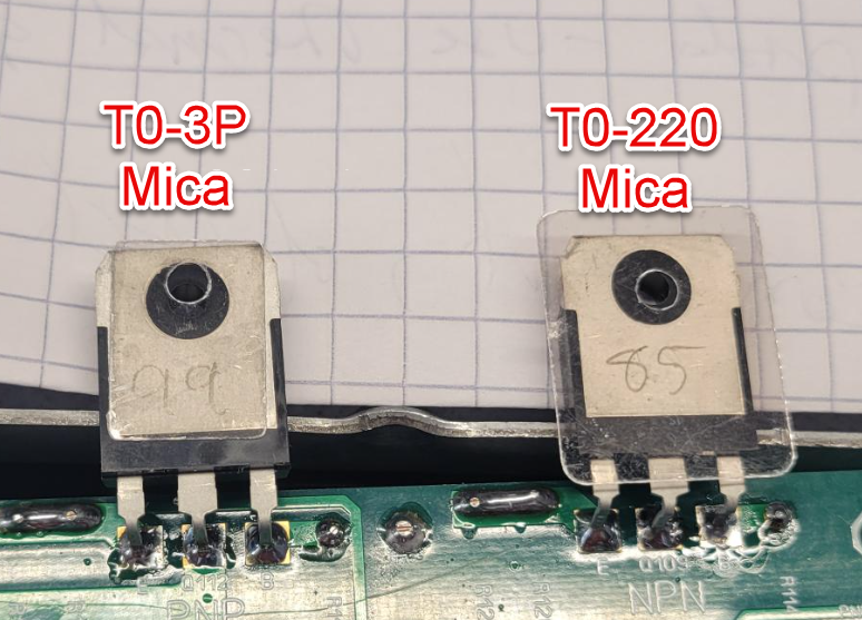

Getting ready to install output transistors on my EF-3 build.
Page 44 of the build guide lists TO-3P mica, but I also have TO-220 mica - see photo.
I want to confirm the right part here as my last go at this stage of a new board burned out some transistors, likely from a imperfect output transistor installation. I have watched Daniel's video on installing the output transistors and feel I have a better understanding of the care needed to get this right.
So just confirming I should use the TO-3P mica vs. the TO-220 [they give better coverage over the entire transistors.]
