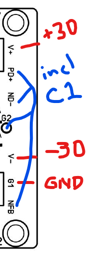

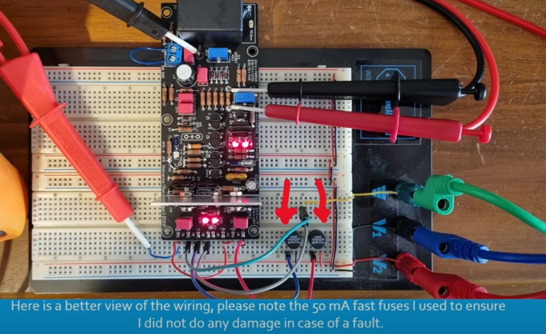

Not specifically, I tested my boards on my bench with an isolation mat underneath, to ensure no shorts from any stray metal on my bench..
What you need to pay attention to - Section 22 in build guide v41
--- V+ on IPS goes to +30Vdc on your bench power supply
--- V- on IPS goes to -30Vdc on your bench power supply
--- G1 on IPS goes to GND on your bench supply
--- Connect PD+/ND-/NFB all 3 connections to Ground (I used alligator clip wires, above pic shows using a bread board with jumper wires, either is fine)
- Section 22, specifically says to also connect C1 to G2
Then with current limited (I think 0.5a is enough for one IPS board), power it up and follow the Section 22 step-by-step to verify functionality and set CCS and check DC offset, etc.
Before powering anything - triple check your wiring with a DMM that all connections go to the right location. diode check to make sure PD+ / ND- / GND / NFB and C1 go to G2. You can confirm C1 goes to G2 with your DMM, I don't specifically remember using a wire to connect these, but did check to make sure there was connection to G2 at all these points.
Pic below is terrible - but hopefully you get the idea. I'm a visual person.

Normall you wouldn't ground the output. That way you could measure DC offset on the output.
@Moderator - please delete Post #4,781 - invalid pictorial
@jwilhelm you are absolutely correct - read my own build picture wrong. PD+/ ND- / NFB all go together, with V+ and V- getting +/-30Vdc
THEN make sure you have GND connected, I clipped G1 and G2 together to my bench power supply.

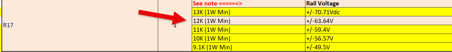

I have a question about R17. The guide says to use a 9.1K resistor in parallel with the one installed on the input board. I have installed a 12K 1W per requirement to match my Cobra's +/-63.64V output. If parallel means equal in this case, shouldn't I use a 12K on the back side of the board?

Feel free to PM if you need a hand with this Chiptech, I think there are some pictures of the build in the video series which could help here also early on in this thread or the build guide.

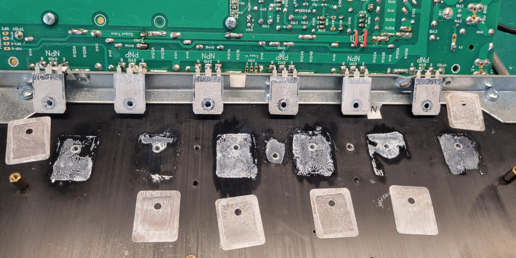

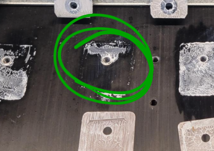

Almost all the transistors failed. One cause I suspect is that I didn't have effective grease cover. I'd appreciate any views on this from the photo.
Of course, the other reason was the failure to remove R17 and J103. Ouch. Won't make that mistake again.

Check the transistor mounting holes are deburred and flat with no swarf please.
