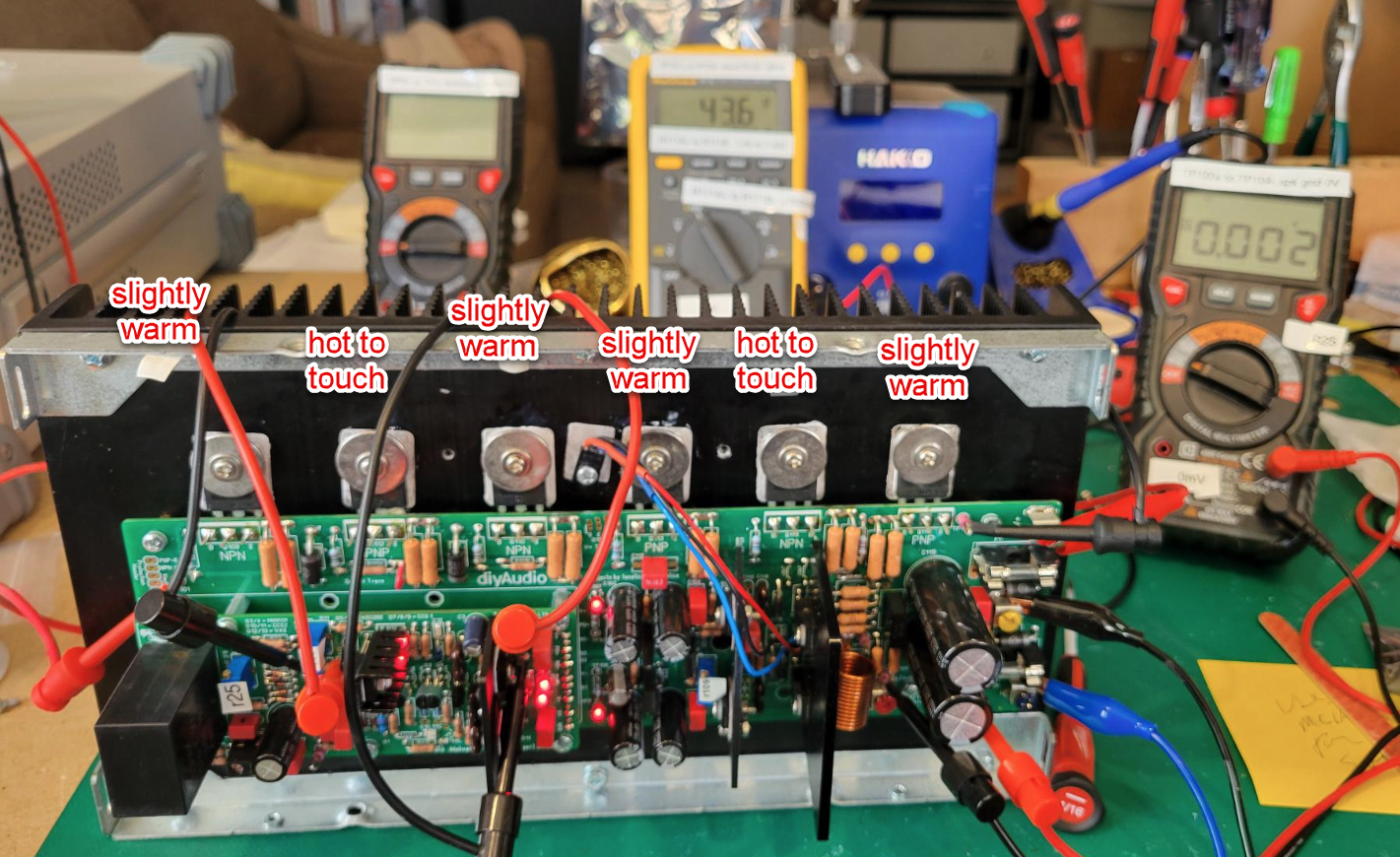

2nd round of testing/biasing:
I achieved initial power up. [DC power supply set at 30DCV 0.3A]
I installed output transistors [DC power supply set at 30DCV 3.0A]
After 45 minutes the bias is wavering between 43.0 and 44mV. Note I don't have the amp sink installed in case and covered.
I did notice that the six transistors varied in temperature. I assume [hope] that is because I'm only using 30DCV and 1A to power the board.
Assuming nothing is amiss tomorrow I will insert the board in the case and using full power hopefully achieve bias target of 40 to 45 DCV mV .

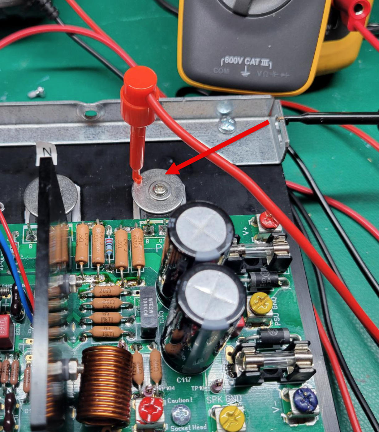

I hooked up the amp board to the DC power supply at 30DCV and 3A.
I removed R17 and J-103.
Nada. No LED lights.
I don't see any burnt parts.
When I check for shorts from the output transistors to the heat sink, from the flat washer to the black heat sink I get a reading of OL across all of them.
When testing from the transistor washer to the silver-colored mounting bracket on the heat sink I get a range of 1.4R to 1.6R. These results are confusing.
I retested 19. B. My readings don't look right for IV and V as all results need to exceed 10K ohms:
I. -66.4K
II. 61.3K
III. 70.1K
IV. 0.5R
V. 1.7R
Any thoughts on what my situation is at this point would be appreciated.

Time to start from scratch again. Remove the outputs. Start with testing the Input board seperatly, then move on to testing output board without the outputs, etc. Slow down and make a checklist and follow it.
IV and V - Still blown outputs and/or perhaps blown drivers. At this point you may need to enlist the help of a local diya member, as its difficult within the forum to diagnose and repair.
You have one good amp board or is this both?
This is the first board I've built. I can at least remove and test the outputs. I guess I could remove the drivers and test them too. Beyond that it probably makes more sense to build a fresh board and hope to learn from my past experience.
I agree with RickRay - my first step would be to start easy - which is test the input board - exactly how the build guide illustrates. Then you mark that off the list as good. Hopefully its a solder bridge or mismatched/blown resistor or diode. Unlikely, since you got all LEDs to light in previous testing.
Then test each output, driver, pre-driver, basically anything you can get to with a DMM (in circuit BCE - thankfully the Wolverine team marked legs on the top and bottom of the board) - this will tell you if you have any gross shorts on these transistors. If that does not provide any insight, the next step is to methodically remove and test out of circuit moving backwards to each amp section (outputs, drivers, pre-drivers, etc.) following the schematic and marking as good (green check mark), or bad (red X), until you test an entire section and have no faultily transistors.
Then the fun part - test resistors/diodes around any faulty transistors you find, but these can be done in circuit. Again, marking everything on your schematic for easy upload to this thread, or if you enlist the help of a member close by - you have somewhere to start the assisted diagnosis. You might get lucky and it's a low value resistor that has gone high value from your previous issue, but this sounds like another transistor blew from your previous issue, you just haven't found it yet.
Once you have "found" any bad parts and replaced them - do your methodical bench testing, going slow and marking off each step in the build guide along the way. Working your way back to a fully populated amp channel and testing with the DMM. If that checks out, then use a DBT, or Variac to bring it up slowly watching the current draw, so have a quick hand on the power switch at all times.
