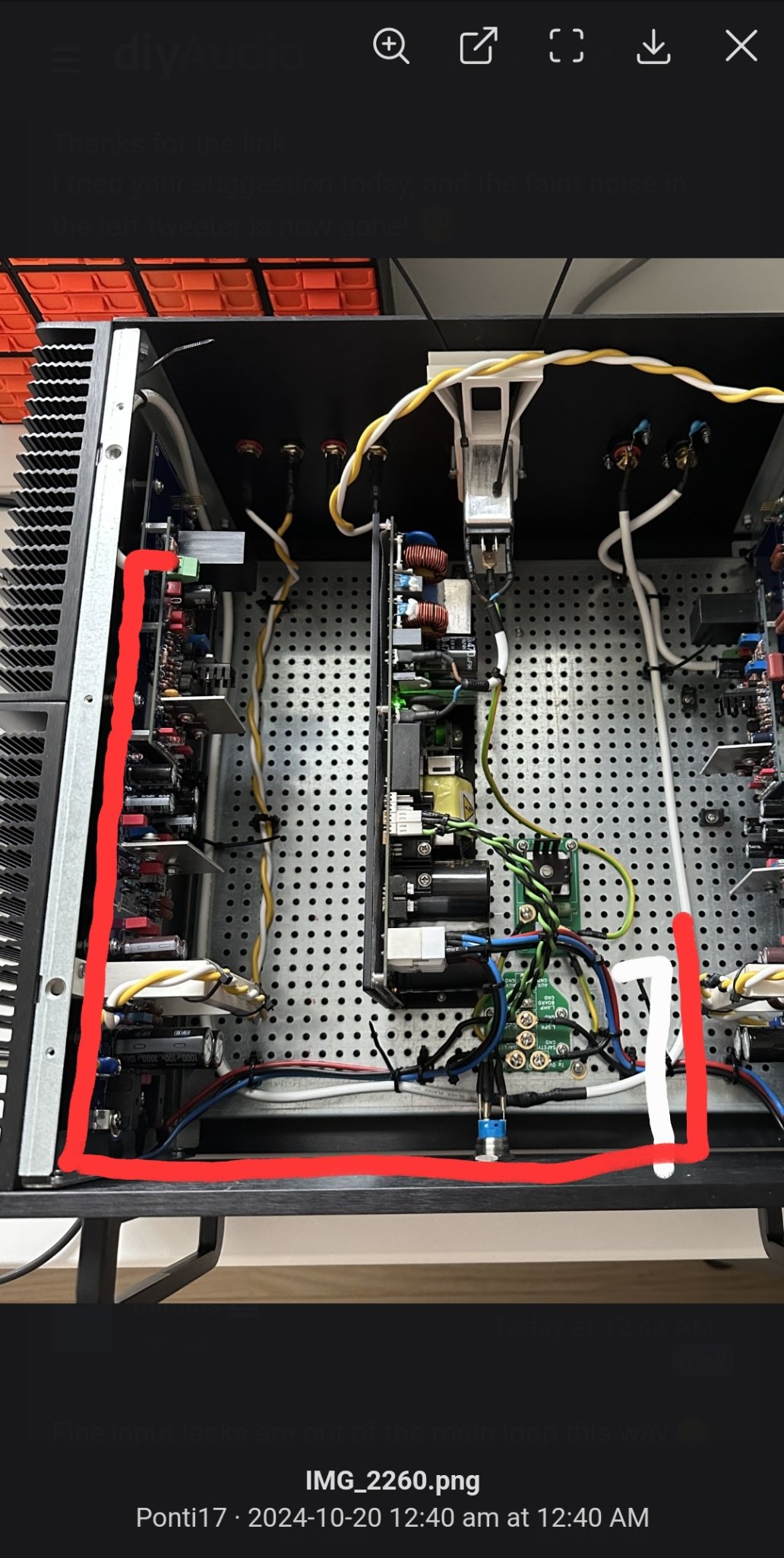

Personally I wouldn't run a input wire parallel with the output transistors.
I personally think that you would be better to running it as I have shown it the image below.
Use one of you bridge to get the input wire away from the DC power leads. Run the input wire high on the front panel and around the top of your amplifier board. This is the lowest noise side of the amplifier board.

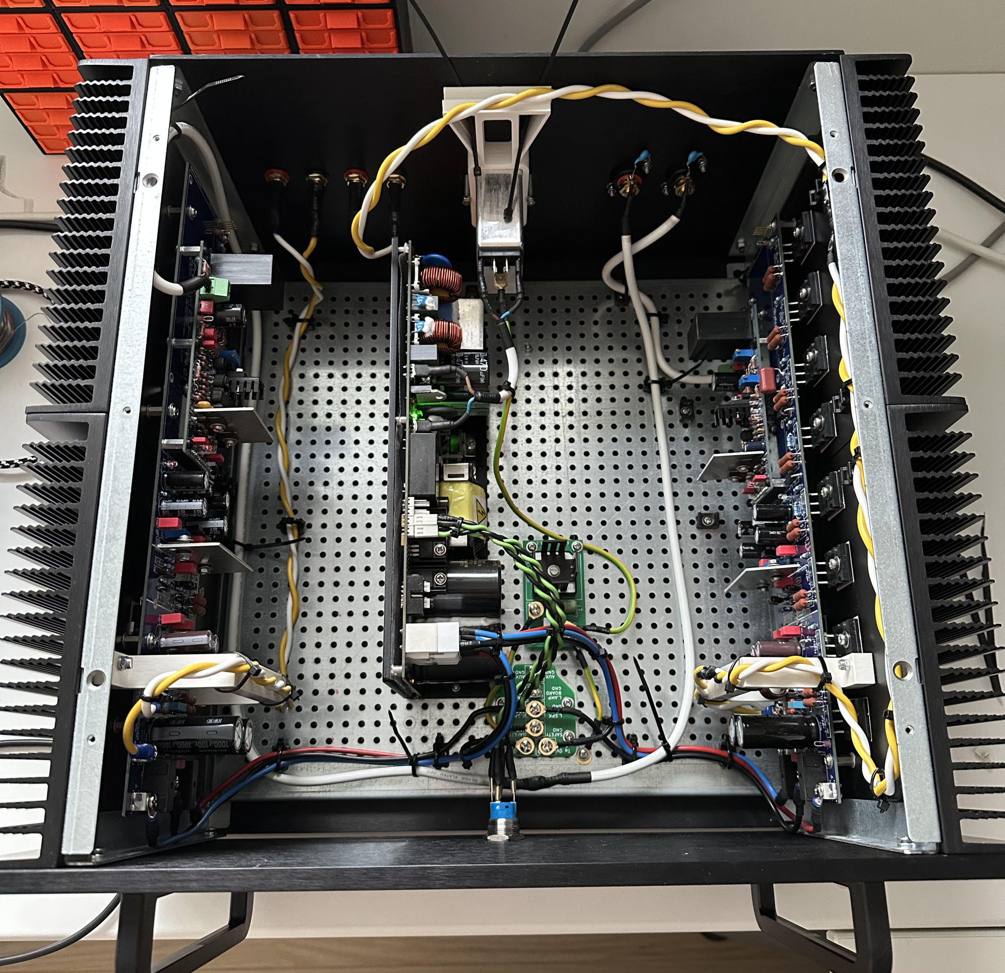

Wired my Wolverine today and gave it the first listen. And wow, not sure if it's because of all the work that have gone into it, but it sounds really good on my not so fancy speakers. The sound feels very controlled and yet with lots of power (and now i will use no more meaningless audiophile jargon 🙂 ).
It was difficult to finalize on a good wiring scheme, especially since i have no skills whatsoever in working with metal (nor any tools), making it difficult to create new mounting points for wires. I do however have a 3D printer, so i printed some plastic wire "bridges" in ASA plastic. The result might be kind of stupid, but it works pretty well.
My fairly sensitive speakers are nearly dead quiet when the amp is on, except for the faintest buzz when i have my ear pretty much touching the tweeter of the left speaker. I have a feeling it might be due to the sub-optimal placement of the left input wire right next to the output of the right channel. I will have to optimize the wiring a bit before finally putting the top lid on it, but it's difficult to stop the music and unplug it from the wall.
All in all, for those currently building one, you should be very excited to hear it when it's done 🙂

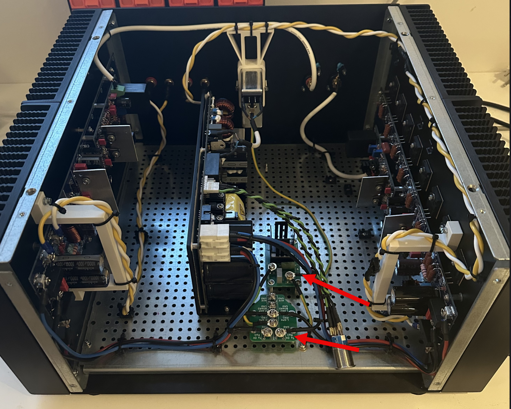

can I inquire as to the function of these two boards, see below. Thanks

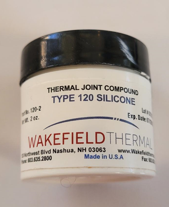

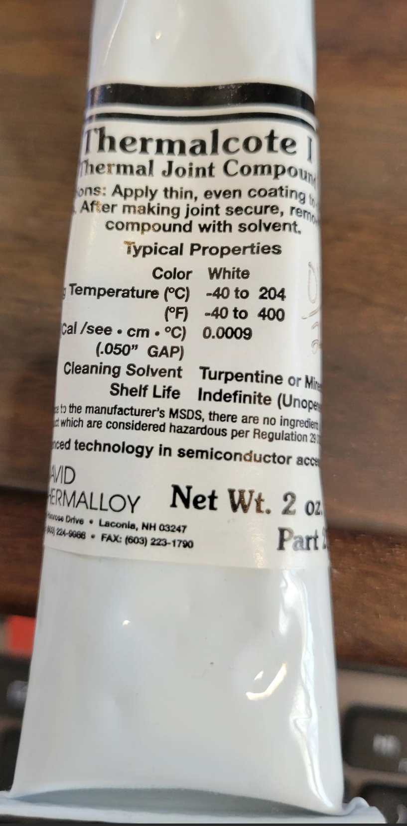

What's the part number of the thermal compund you used? Many compunds are electrically conductive and will eventually work their way to somewhere they shouldn't and blow the fuses.
I used the Thermalcote, which I had on hand. Not sure how old it is either.
I propose to use the Wakefield silicone type 120 as shown below. Can't find the product number for it. Please advise if there is a better product I should use. I only want to remove, test the outputs and replace once.
Thanks for the suggestion Stuart! I can see why this would be an even more optimized wiring scheme. Will have to dwell a bit on the best way to do it. I lack easy mounting points on the front panel, as well as on the other side of the amplifier board. Though i guess nothing is impossible when you're armed with zip ties and a 3D printer 😀
The board with the heatsink is a GND lift. It "separates" amplifier ground and chassis ground. It's my first time using something like this in a build, but i have previously been victim of nasty, hard-to-understand ground issues in my systems so i wanted to try and use one here.
The other board is kind of like a star ground, but as a "T" instead. Where high and low current return paths are placed in optimal order.
BTW these boards are not my designs, they are mentioned several times earlier in this thread. If i remember correct they are stuartmp's design, and they should be available on pcbway i think. 🙂
I would just print off some cable holders which you can apply some good quality 3M double sided tape to.
Or purchase something like this.
Cable holder
It may also be a good idea to run the DC power wires that run to the amplifier board under the mesh base plate as @thompsontechs suggested
I can't see the part number on the Thermalcote. I think 249 is non-conductive (electrically) but 250 is. The Wakefield 120 is definitly okay.
