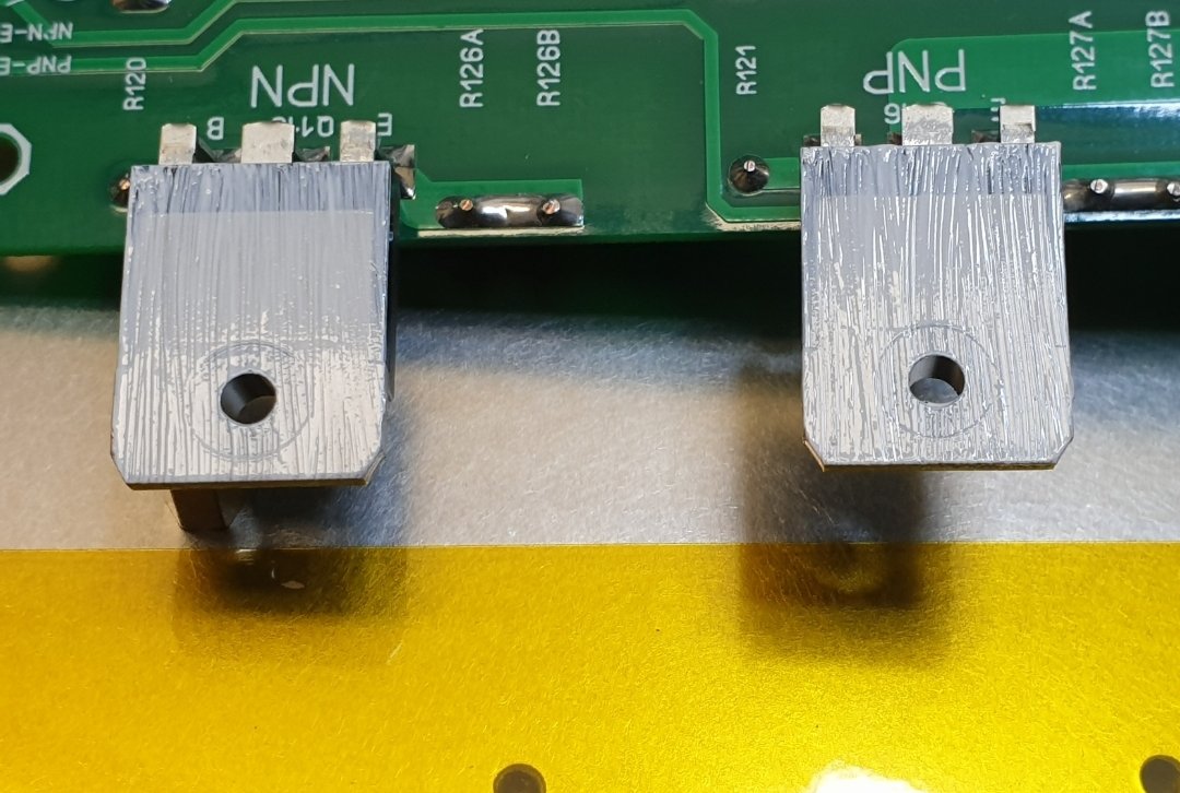

You don't need to lather on thermal pastes. Just enough to spread thinly and fill the microscopic imperfections between the two surfaces to which its being applied. Too much eventually becomes inefficient.
Less is more. Got it. Thanks.
Just dip a fine paintbrush into the thermal paste then spread it very thinly just enough to cover the surface (just) if it oozes out to much after you tighten the m3 screws you've used to much

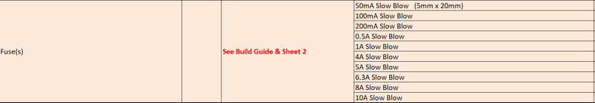

Just confirming I will use slow blow fuses as listed in the BOM. Thanks.If it were the fuses that were the issue, you wouldn't have lost 2x outputs, you'd have just lost a fuse. The fuse did its job, the Cobra (hopefully), with its fast protection, should have saved anything else.

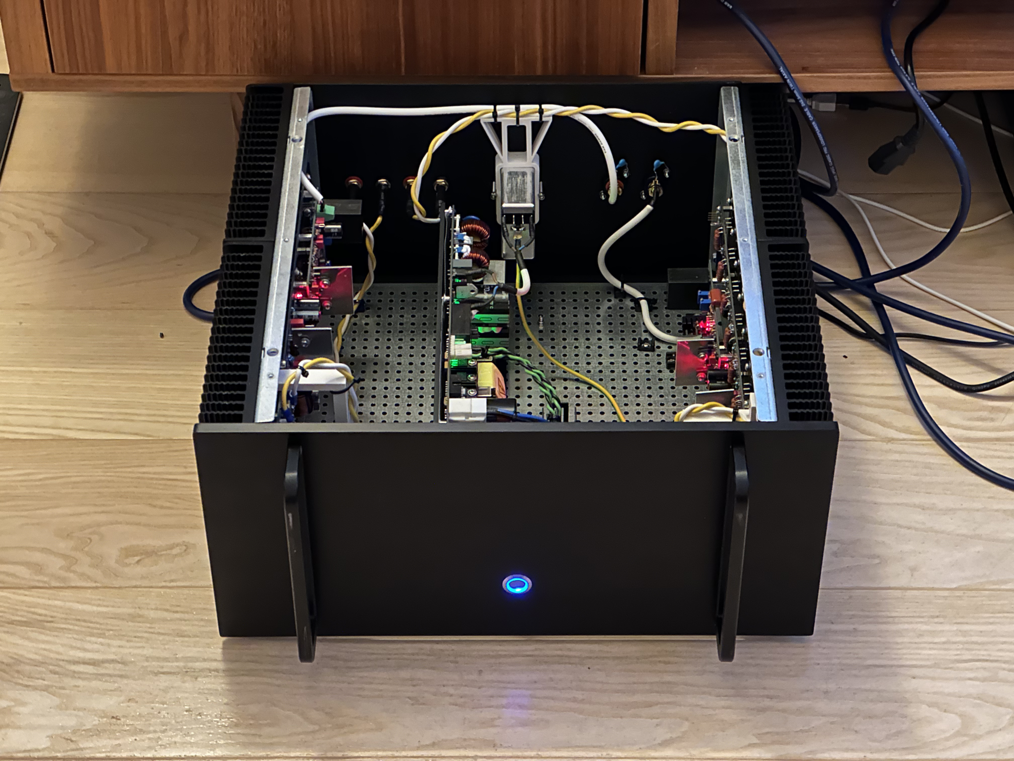

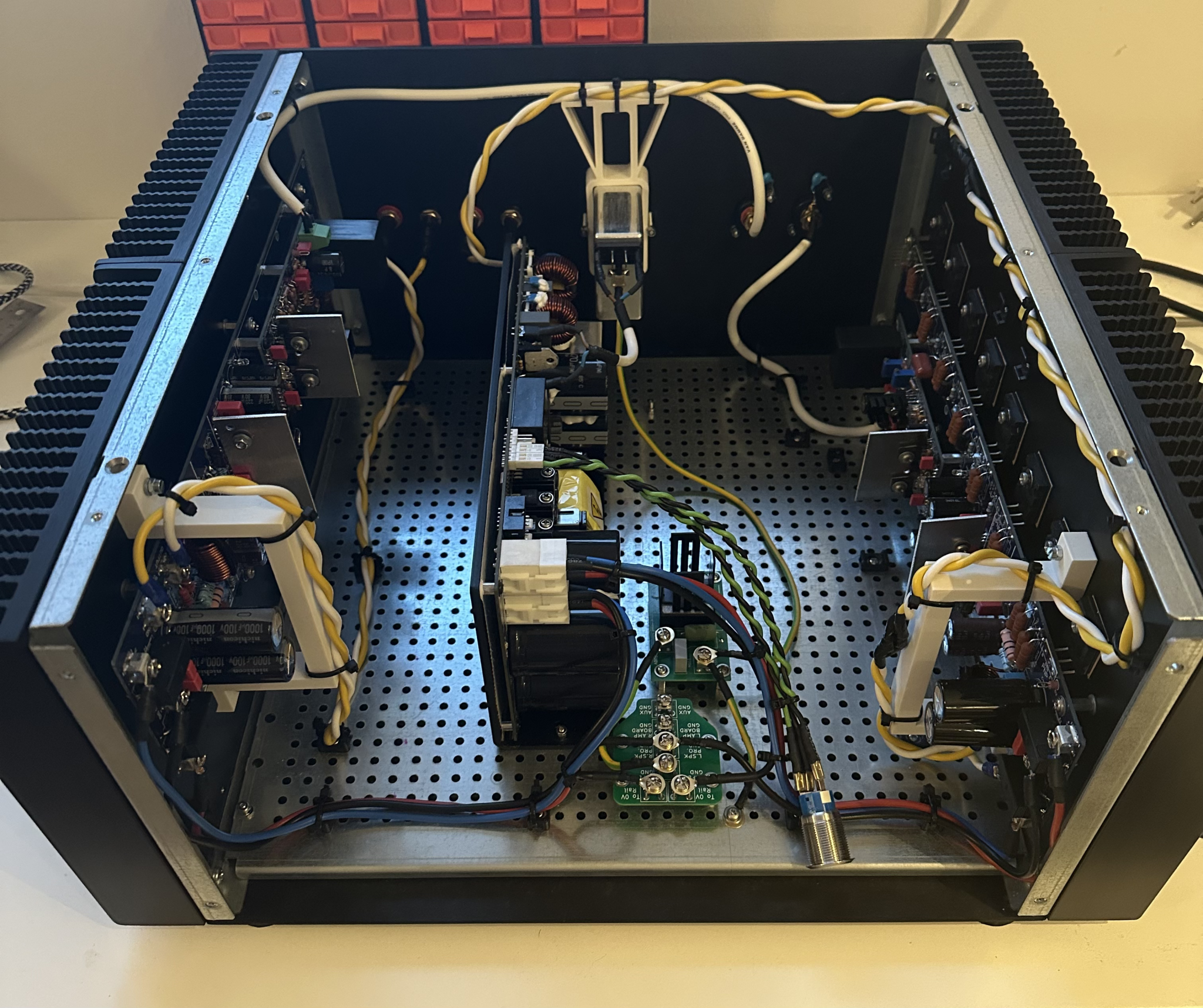

Beautiful work 👏 👌Wired my Wolverine today and gave it the first listen. And wow, not sure if it's because of all the work that have gone into it, but it sounds really good on my not so fancy speakers. The sound feels very controlled and yet with lots of power (and now i will use no more meaningless audiophile jargon 🙂 ).
It was difficult to finalize on a good wiring scheme, especially since i have no skills whatsoever in working with metal (nor any tools), making it difficult to create new mounting points for wires. I do however have a 3D printer, so i printed some plastic wire "bridges" in ASA plastic. The result might be kind of stupid, but it works pretty well.
My fairly sensitive speakers are nearly dead quiet when the amp is on, except for the faintest buzz when i have my ear pretty much touching the tweeter of the left speaker. I have a feeling it might be due to the sub-optimal placement of the left input wire right next to the output of the right channel. I will have to optimize the wiring a bit before finally putting the top lid on it, but it's difficult to stop the music and unplug it from the wall.
All in all, for those currently building one, you should be very excited to hear it when it's done 🙂
