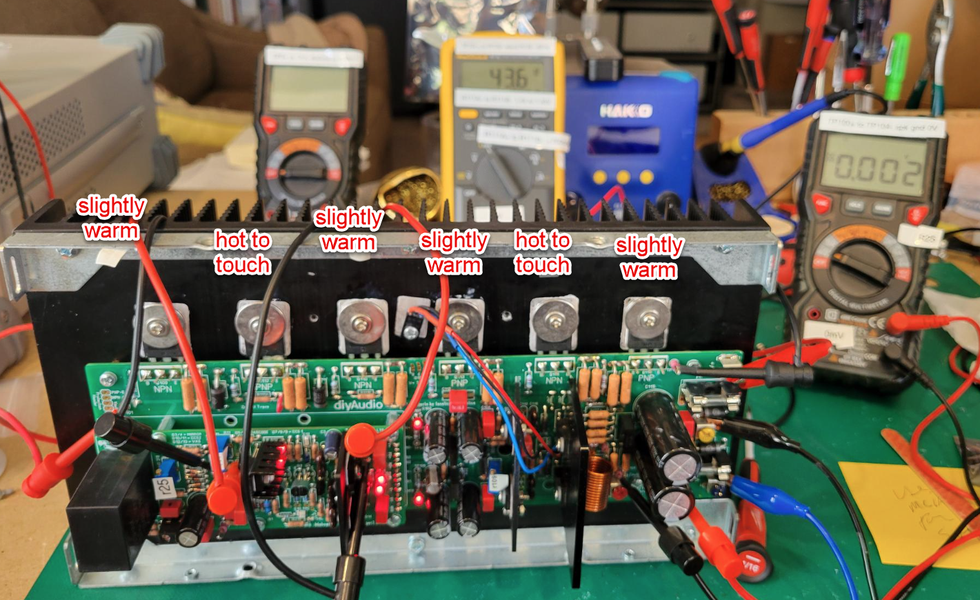

This is my postmortem so I can learn and not repeat what doesn't work.
I do have a diyaudio store 4U case and heat sinks. You will not find me drilling holes.
I did not take the job of placing the heat sinks seriously enough.
I did fit the transistors on the heat sink without the insulator pads because step 18. c said not to do that.

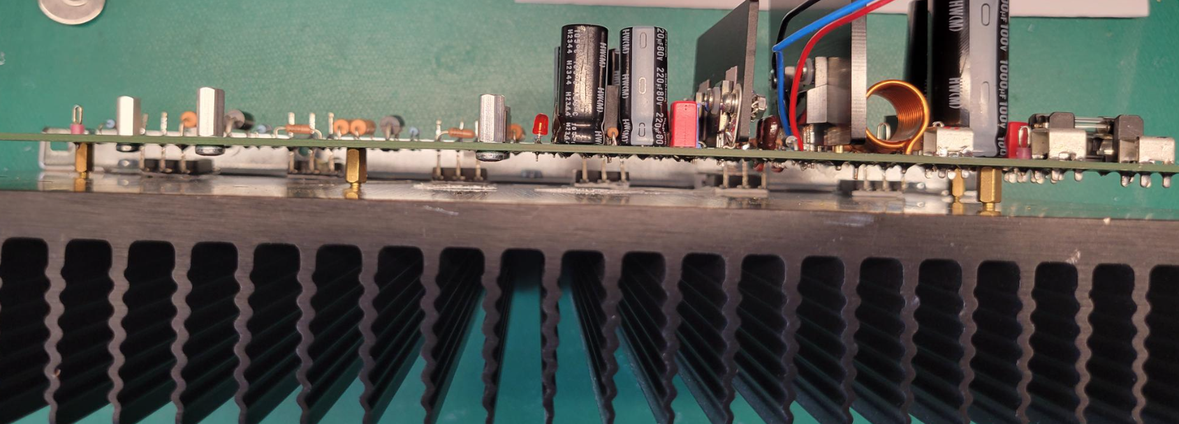

I didn't do a visual check, especially to look under the board [see photo]. When I did look afterwards, I could see several that were not placed solidly. I will add this step next time.
I did not make sure the board was 10mm above and level. Currently my board is ~8mm.

This right here ^ - this is going to cause problems! I can also see the gaps under the output transistors.
Chip - it doesn't NEED to be 10mm - it can be between 8-10mm according to the build guide. But it needs to be level all around. Those standoffs need their male threads trimmed so they wind all the way in, flush with the heatsink. Your standoffs may be too short if you are currently at 8mm.
What is the height of the standoffs you have there? (not including the male thread).
You will need to remove and reinstall the output transistors (or install fresh ones) once you have corrected the PCB standoffs, because leaving them as is will force the PCB to sit crooked once the standoffs Z height is changed, again they wont get flush.

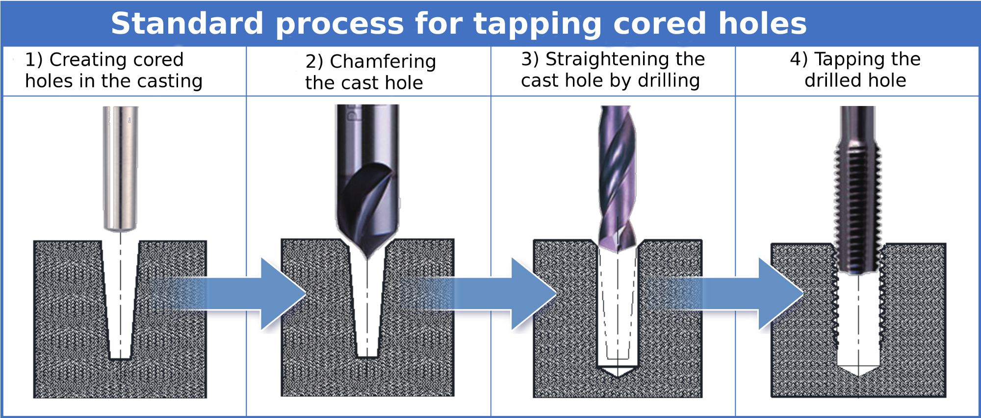

See slide 4 in this image - the usable tapped length of a blind hole does not go to the bottom of the hole. Your 6mm male thread on your standoff will probably only get 5mm max down into a 7mm deep hole.

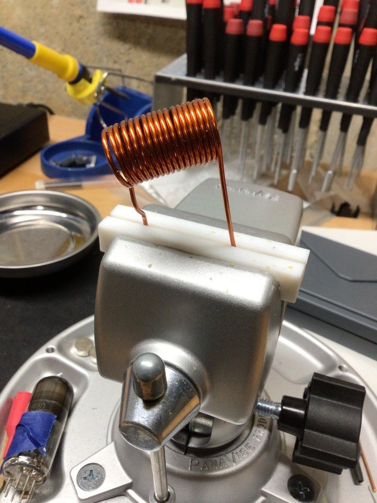

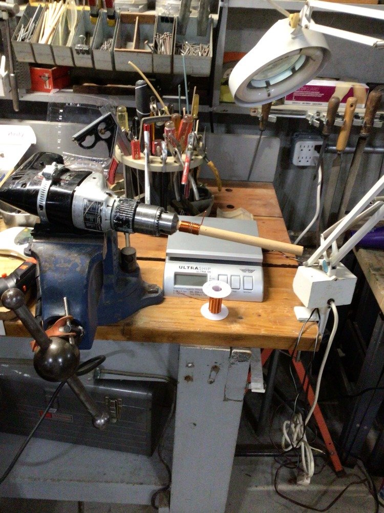

Ok folks, here is what I came up with for winding the inductors. Based on mainframe99's input I used a variable speed drill with a 0.5" dowel (12.7mm) and 16 AWG magnet wire. I drilled a hole using a #52 drill straight through the dowel close to where the dowel is being held by the drill chuck. Then I inserted the end of the magnet wire into the dowel, but not all the way through it. By putting tension on the other end of the magnet wire and running the drill at it's slowest speed I was able to wind the wire. I need to measure the inductance using my Peak Atlas LCR meter and cut it to the proper length. It's not perfect, but it looks a heck of a lot better than my first attempt.
I'm hoping this helps someone who may be struggling with forming the inductors....
