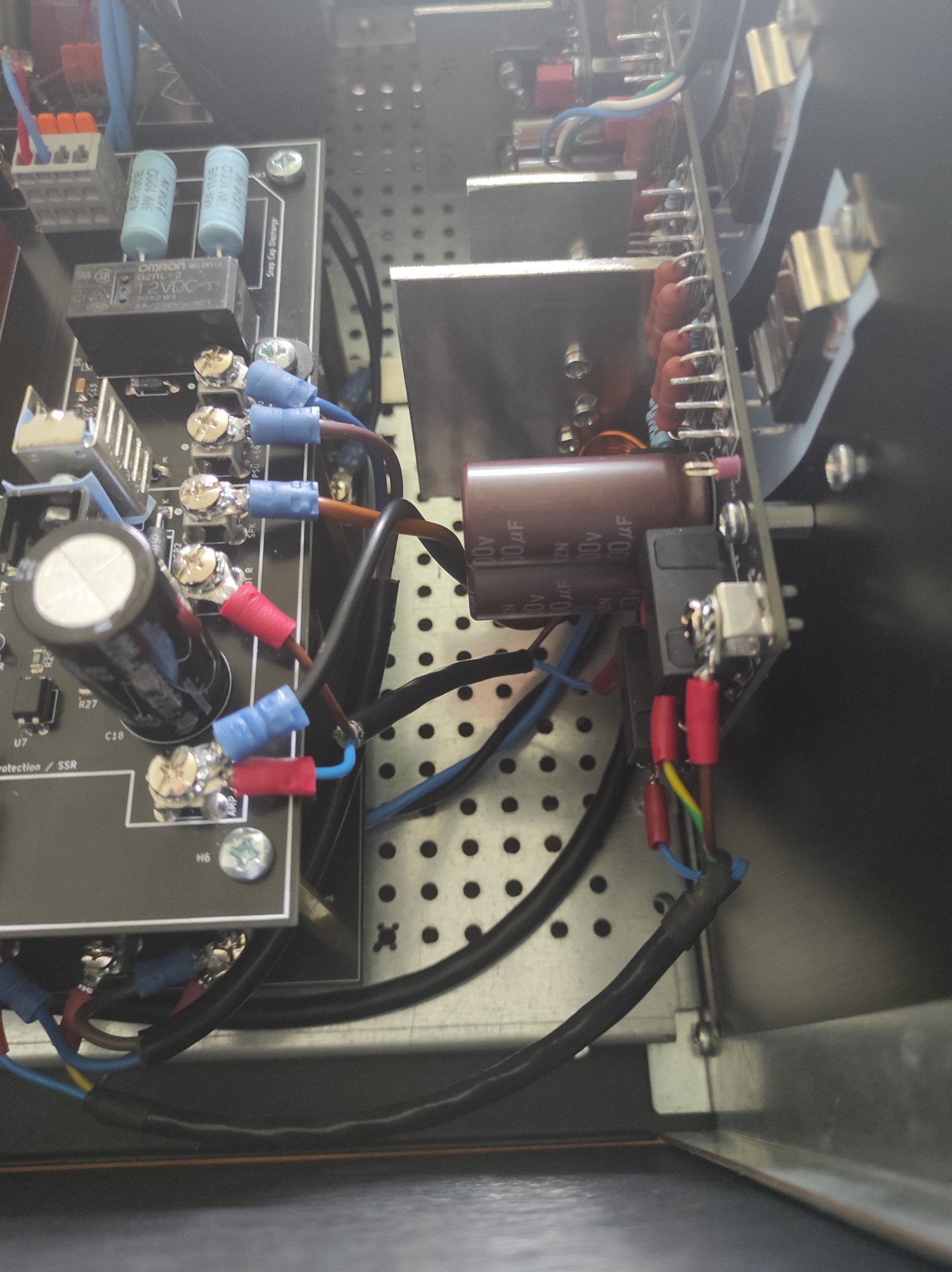

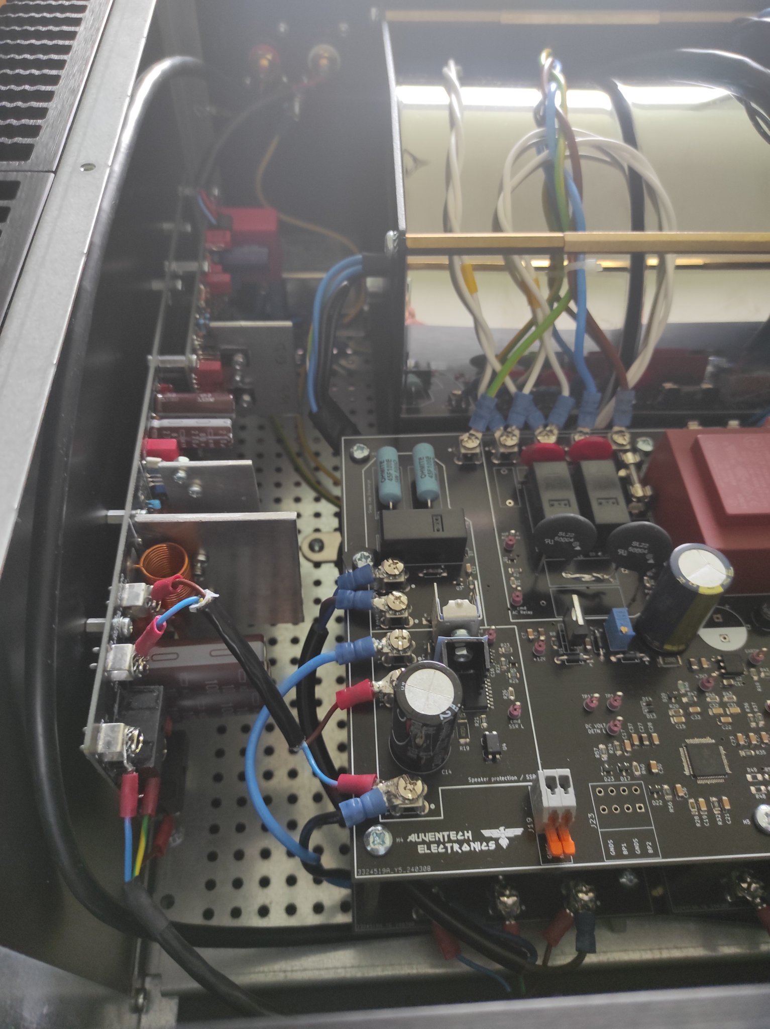

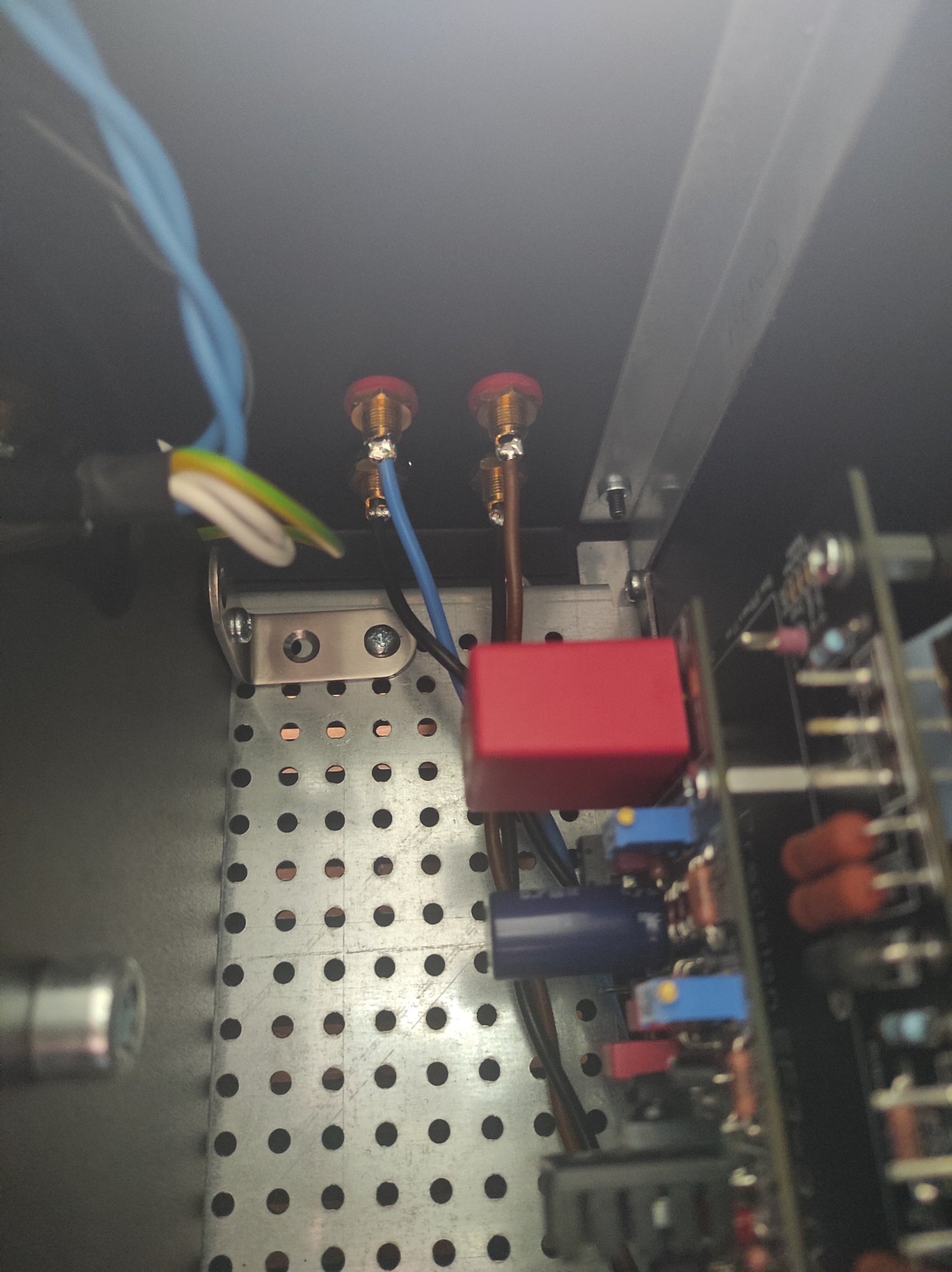

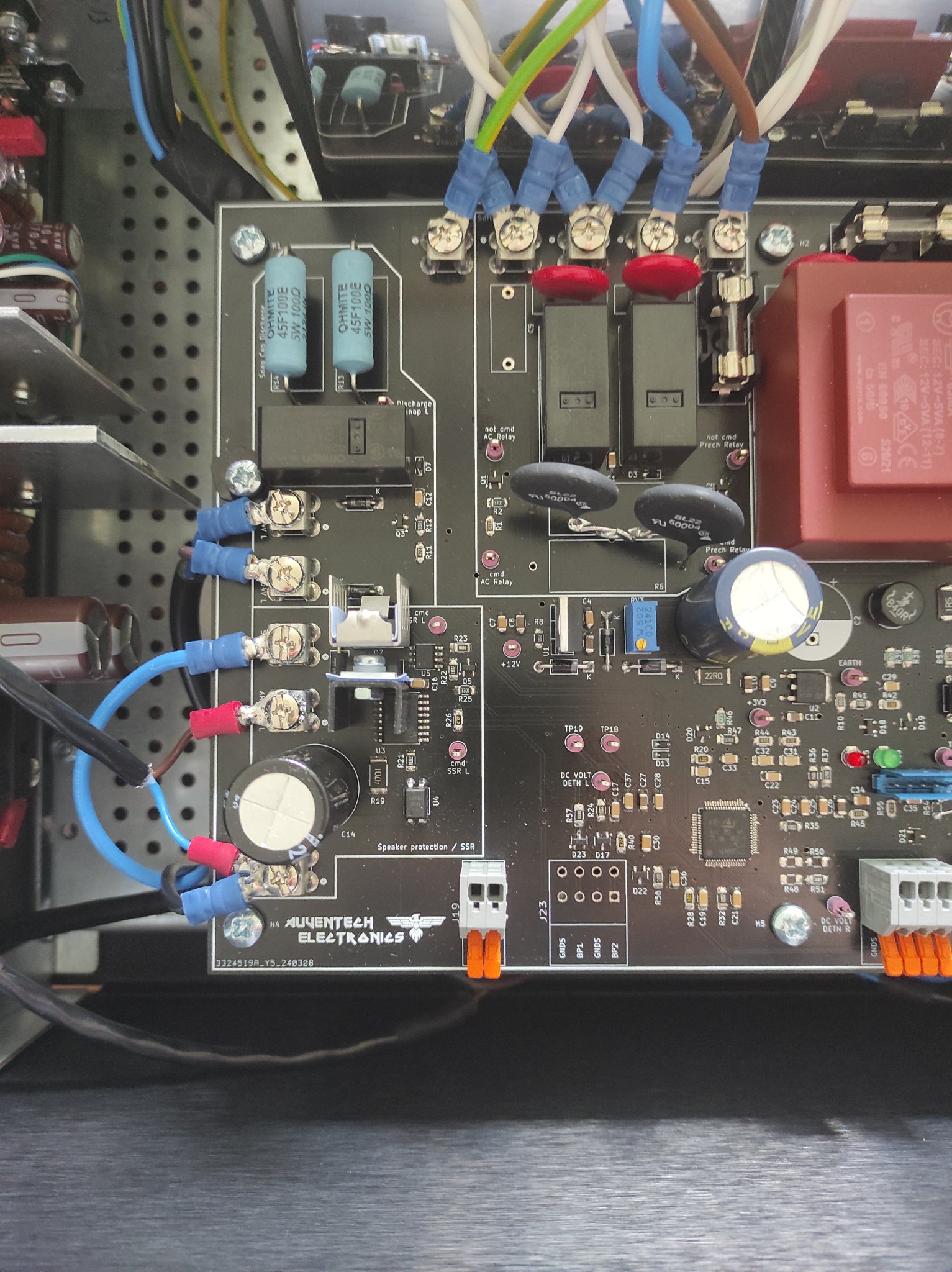

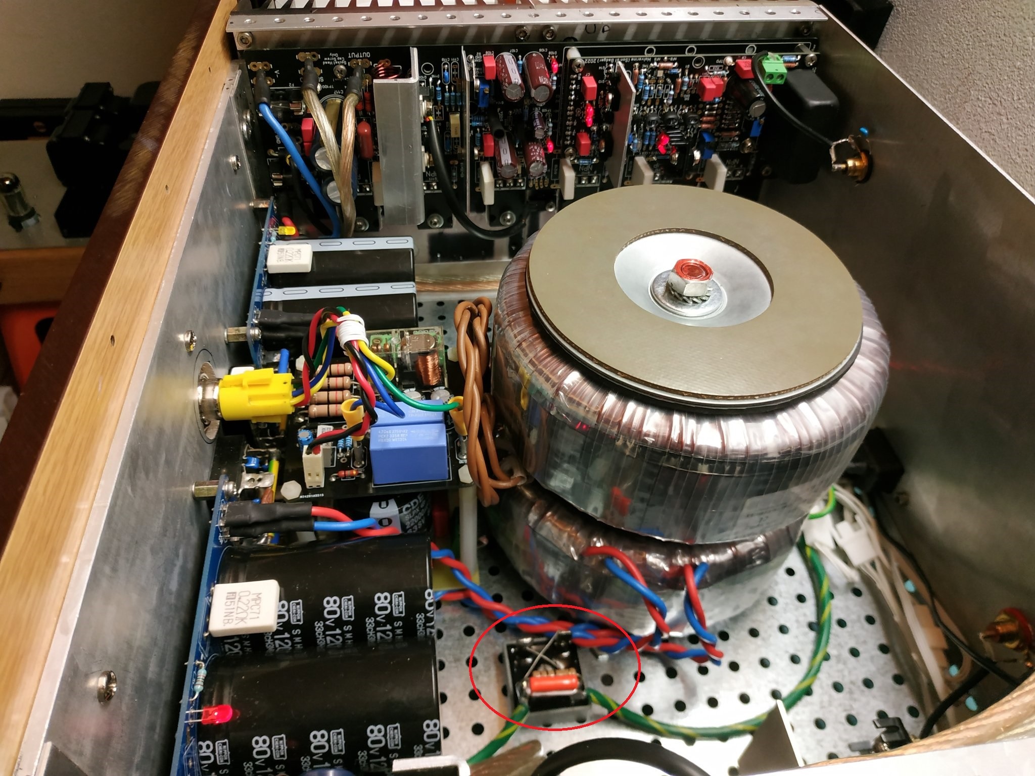

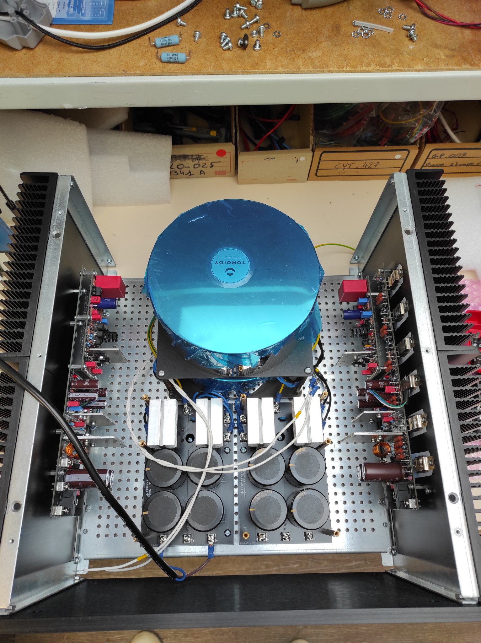

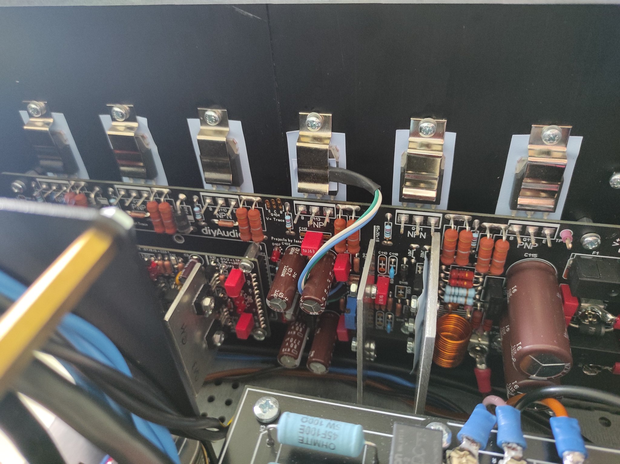

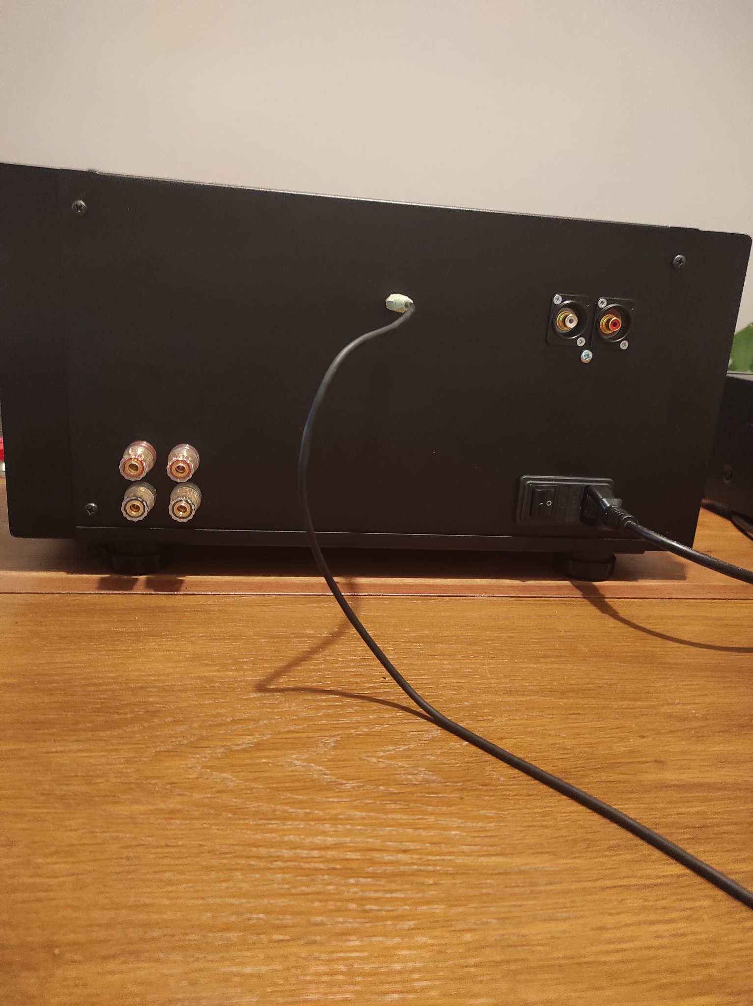

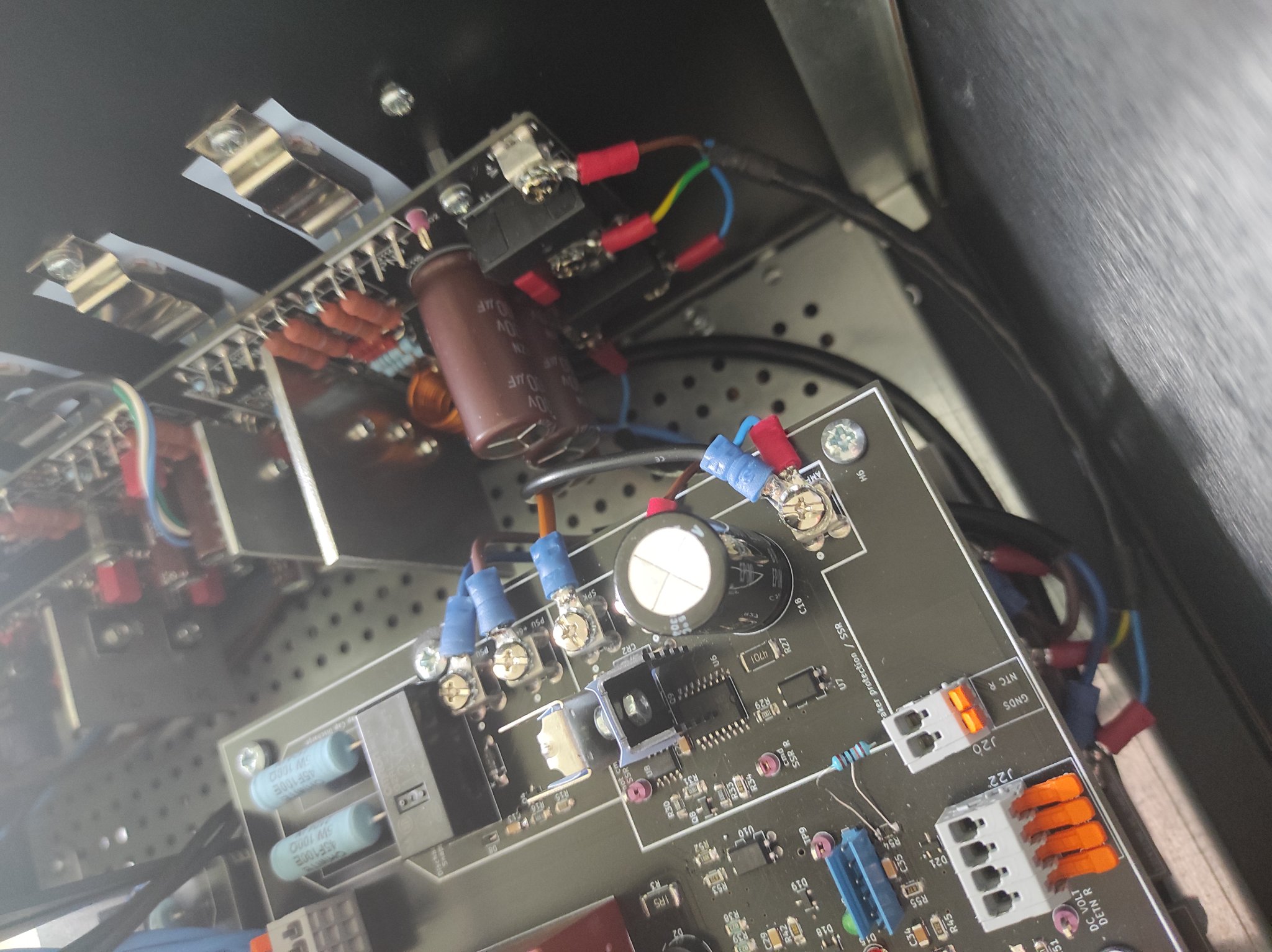

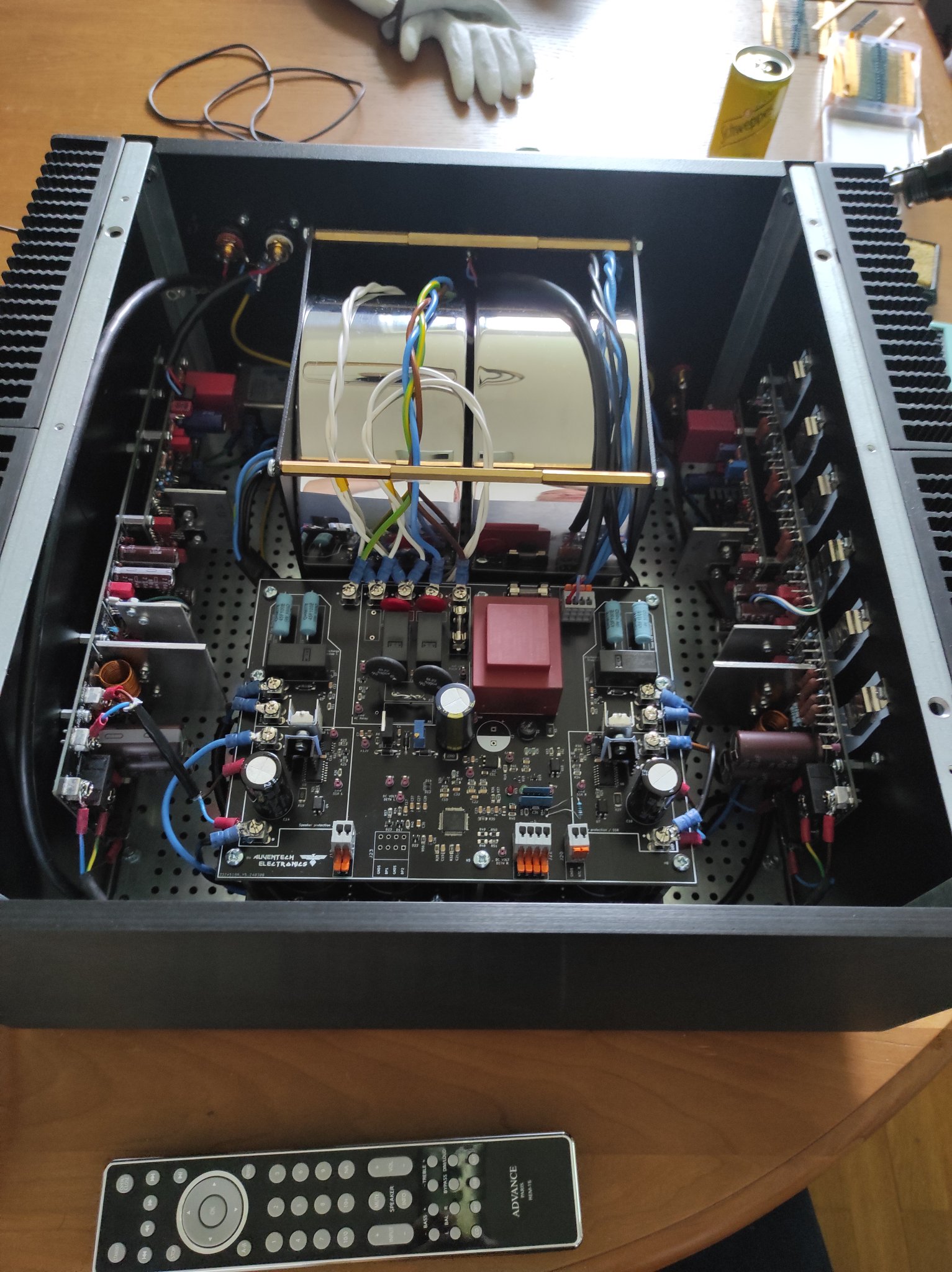

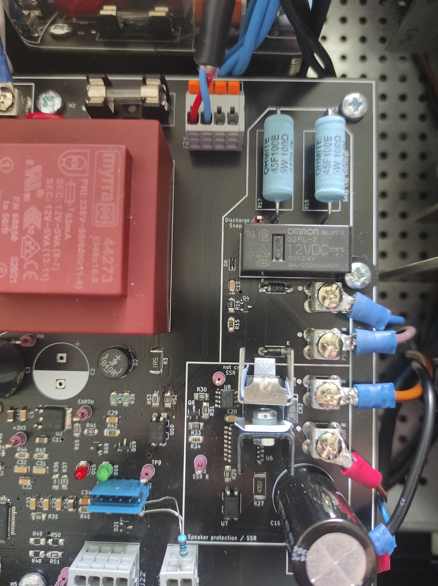

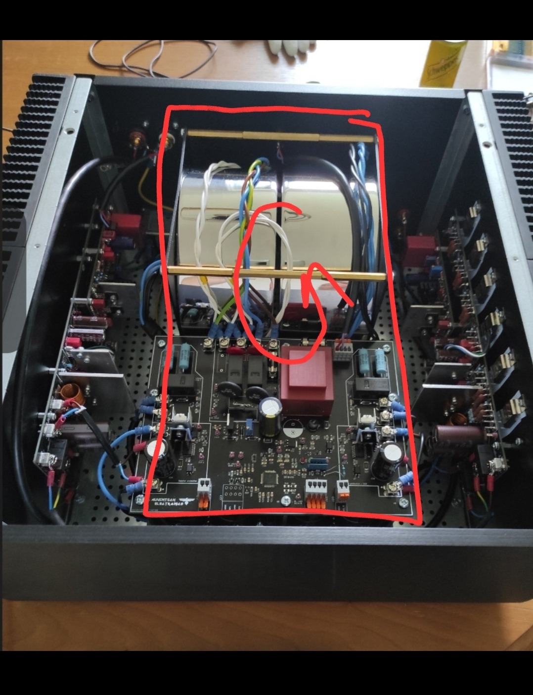

Hey guys, i just finished my build.
I made my own custom PSU in dual mono with 2x500VA 45Vrms toroidy transformer so about 62VDC after diode bridge.
Upper board include AC precharge, DC voltage detection, speaker SSR relay, capactor discharge, trigger input, speaker current sensor. I use an stm32G474 and all protections are manage with peripherals interconnection and not through SW routine.
I have button inputs but finally not use it, also heatsink temperature measurement which where not mounted on the pictures.
I planned to have a 14segments displays controlled by an i2c bus.
Then i wanted a vintage look. I bought VU meters and tried to use current sensors to calculate instantaneous power but at low level, current is too small for my sensors.
At the moment there is nothing on the front pannel.

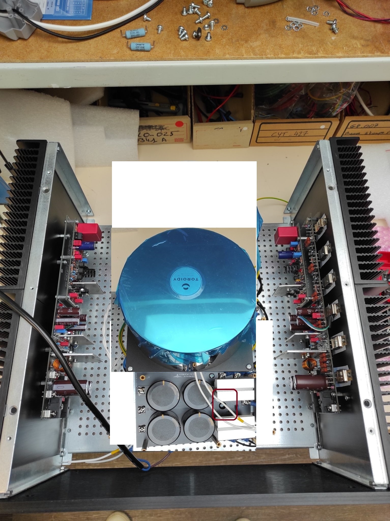

i tried different transformer position. i first staked them on top of each other but each transformer transfered noise to both channel. additionaly when i had a channel with low noise the other one had maximal noise.
With final setup left transformer only affect left channel and same for right channel.
here are pictures of the amp:
IMG_20240609_173220.jpgIMG_20240515_180734.jpgIMG_20240609_172413.jpgIMG_20240609_172609.jpgIMG_20240609_172704.jpgIMG_20240609_172736.jpgIMG_20240609_172746.jpgIMG_20240609_172804.jpgIMG_20240609_172814.jpgIMG_20240609_172849.jpgIMG_20240609_173008.jpg
Hi @TeteDampoule
There is no doubt that you have put a massive effort into this Amplifier. It looks great.
If I may make a few suggestions to try and work out where the noise is coming from.
1. Try connecting the amplifier power rails to and external Lab power supply and see if the noise remains.
2. If you have no noise this is a good thing and I would then suggest moving all your existing power supply out and away from the chassis especially the sensitive input stage.
If you can run it with the power supply external to the chassis and there's no noise this proves your power supply is not the issue.
3. If all that works I would suggest reinstalling everything in the chassis but this time around rotate it all 180°so the transformers are at the output end of the amplifier.
Good luck.
Reactions: danieljw
Hi @stuartmp,
Thank you for these advices.
Maybe i have not been clear. At the moment and in the actual setup i was able to reduce noise for each channel at a level that is hard to hear with "headphone trick" by rotating transformer. So the noise was clearly linked to the transformer and the distance with input stage. I am talking about 50Hz noise.
I did test with transformer outside the box and there was no noise.
I have been following this guide that suggest that input stage is next to transformer:
https://www.diyaudio.com/community/attachments/dual-mono-pdf.1035911/
I agree with you and for those who have not build the amp yet i would also recommend to try to put the input stage far from the transformer.
Finally with no source connected to the amplifier, it is perfectly silent. With my preamp connected i get a small "white noise" that i can only hear when i put my hears very close to the tweeter of the speaker. It is fixed and does not change with preamp level.
I am very satisfied with the result.

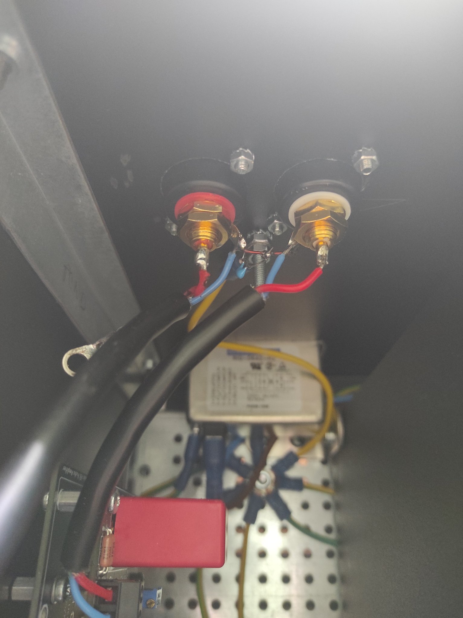

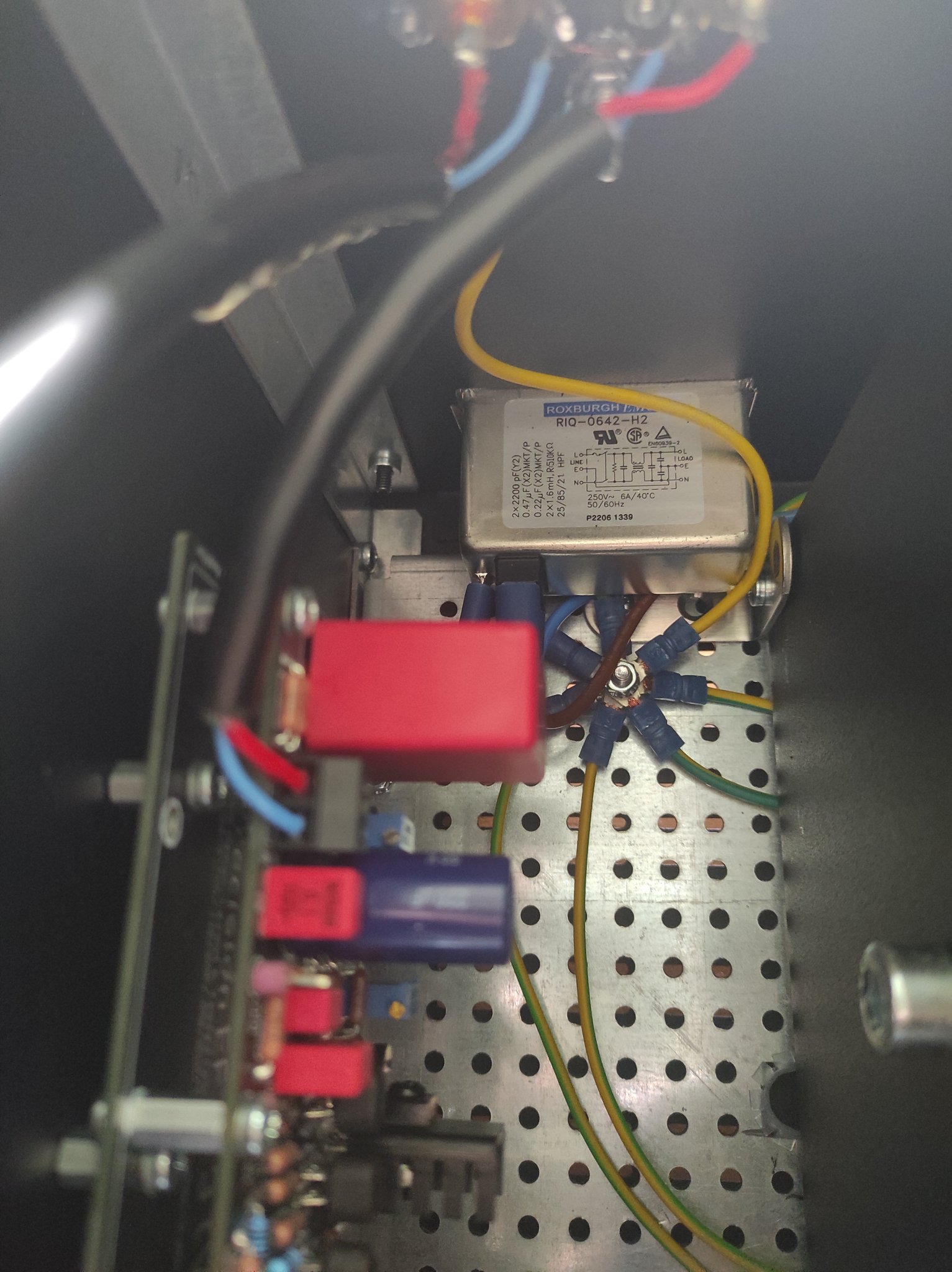

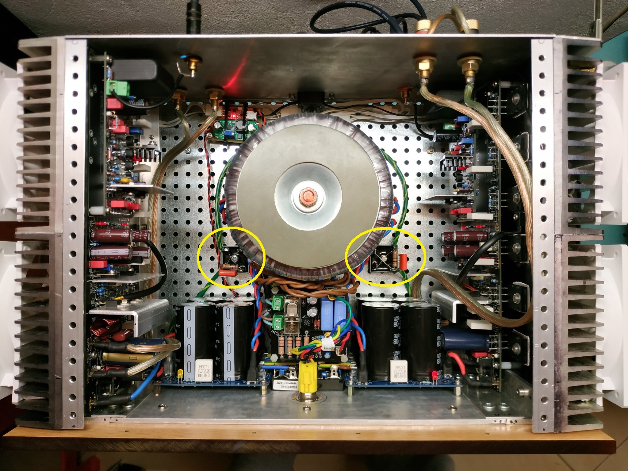

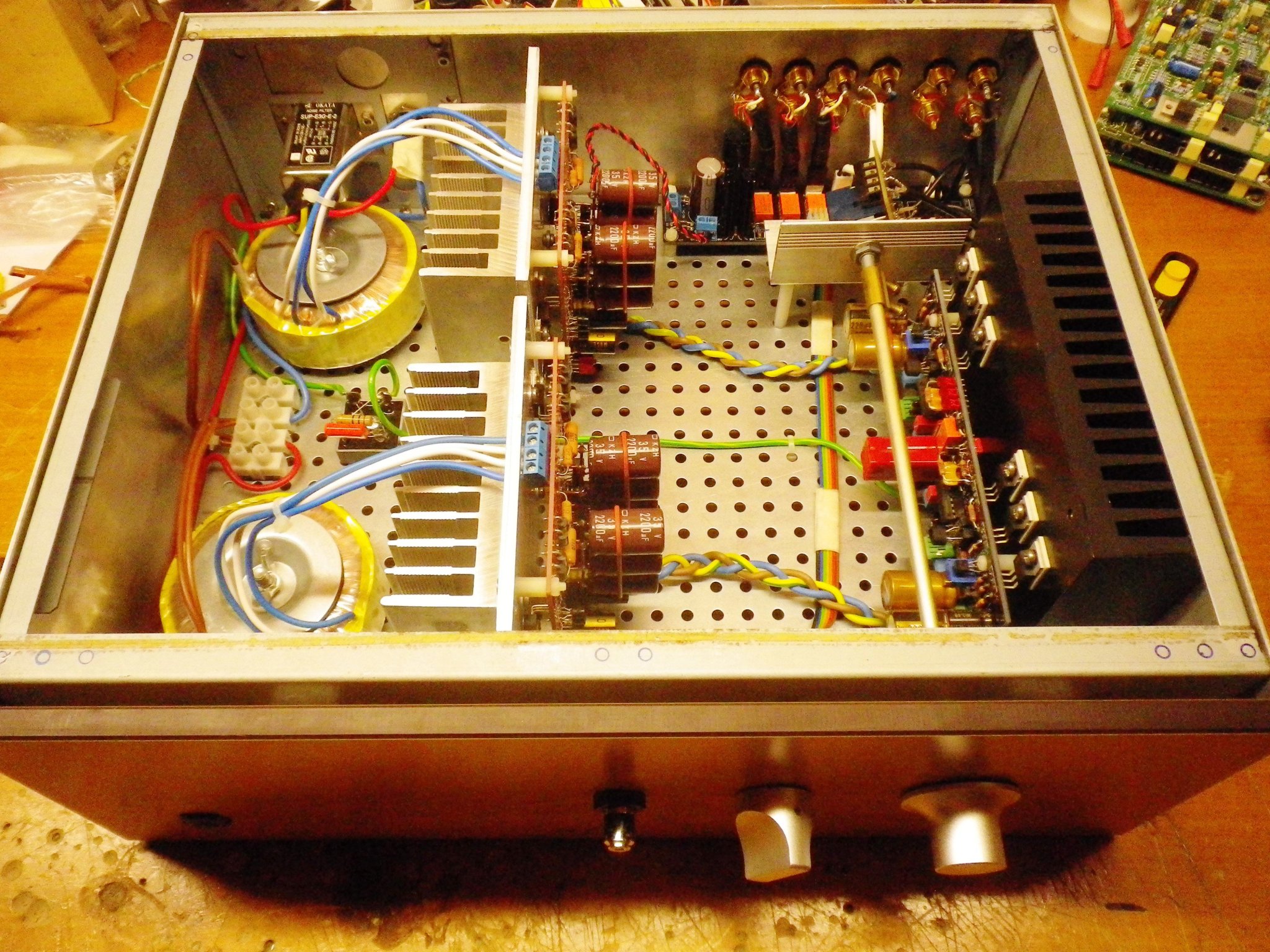

Hi.
do you have install any of this? inside your amp or preamp for each channel ?
my input RCA are about 6-7 cm distance from trafos..
No hiss no noise at all.
Fantastic, so sorry for the misunderstanding I'm glad that you are happy with the results. I hope that you now have time for plenty of listening pleasure.
Reactions: danieljw
I get your point but the board where not designed to be stacked due to ground lifter integration and control board on top.
The only possiblity with my boards is 180° rotation but as i said i am curently satisfied with this layout.
Thank you for sharing your solution that will for sure help other builders.

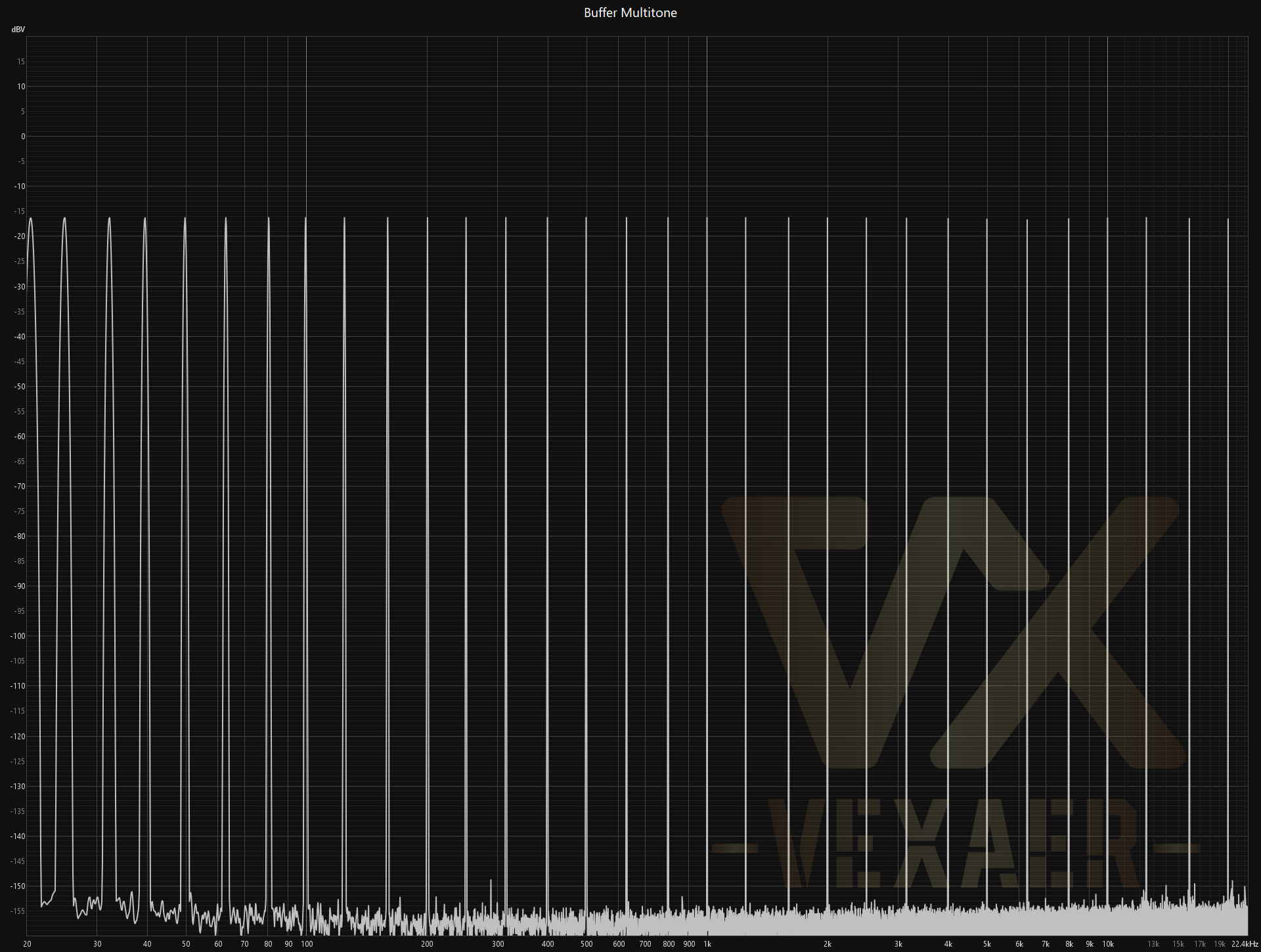

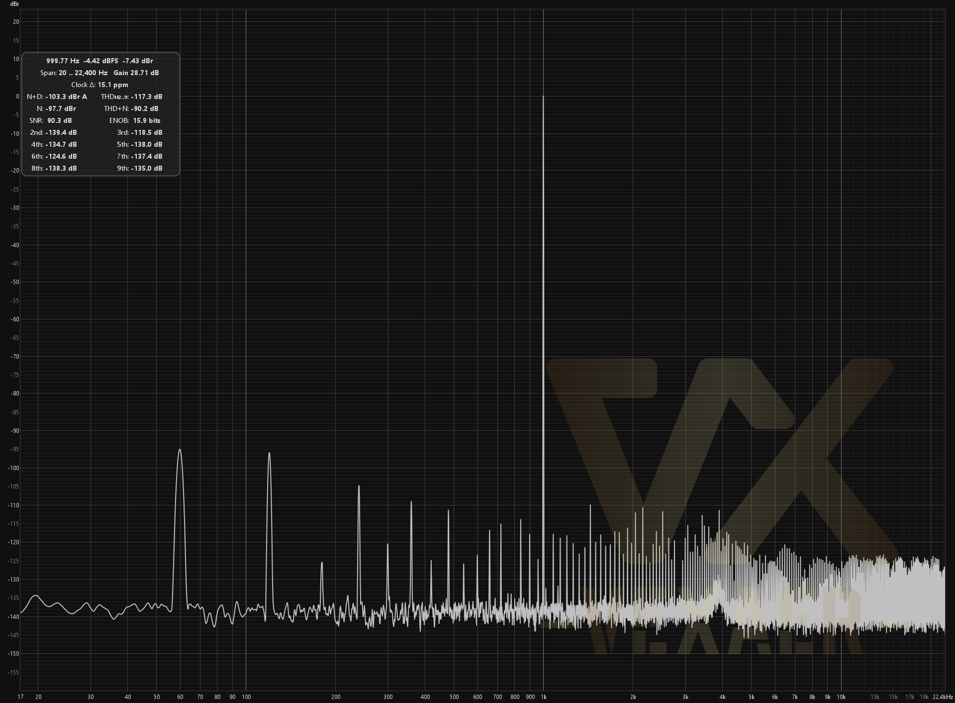

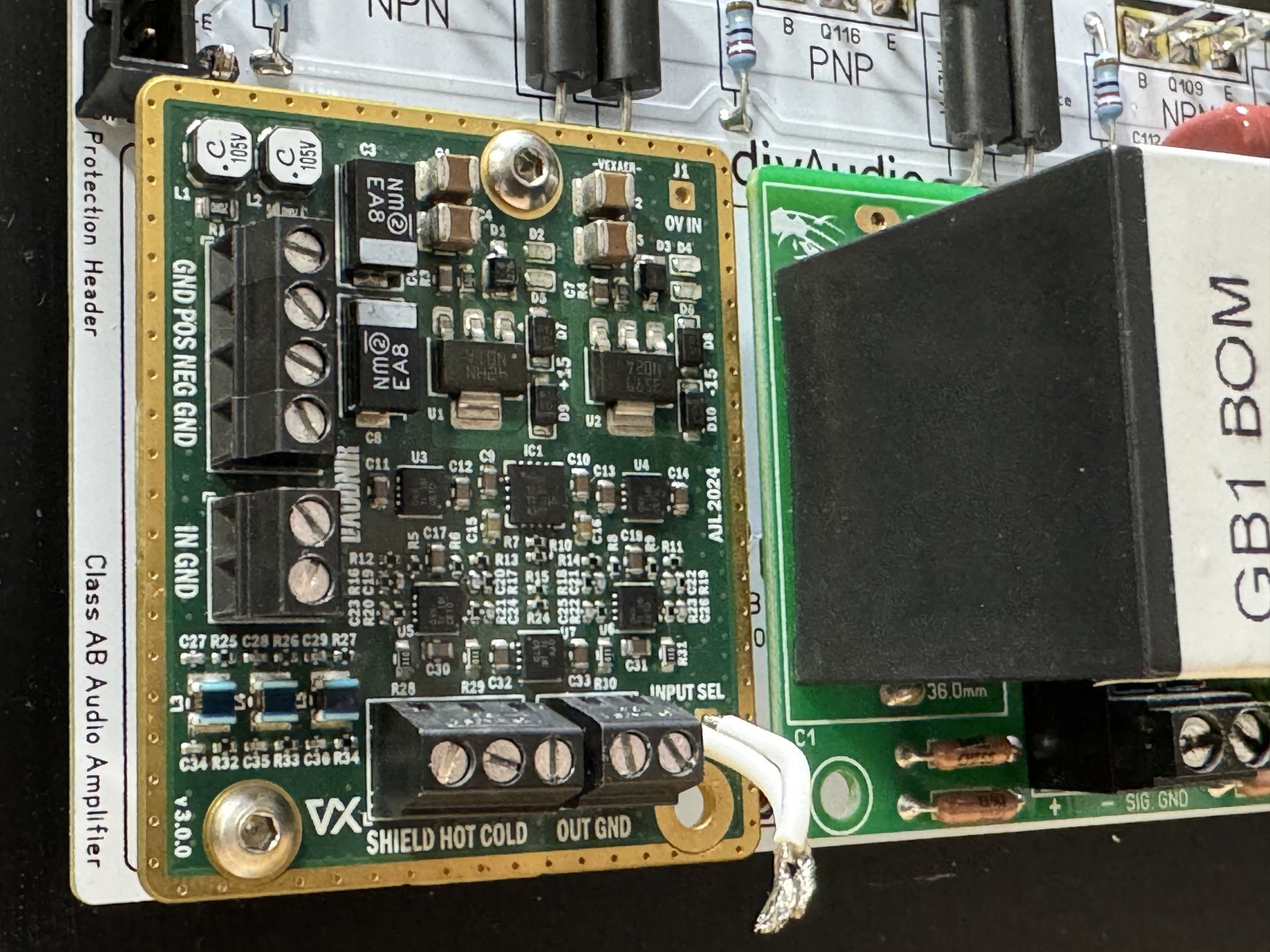

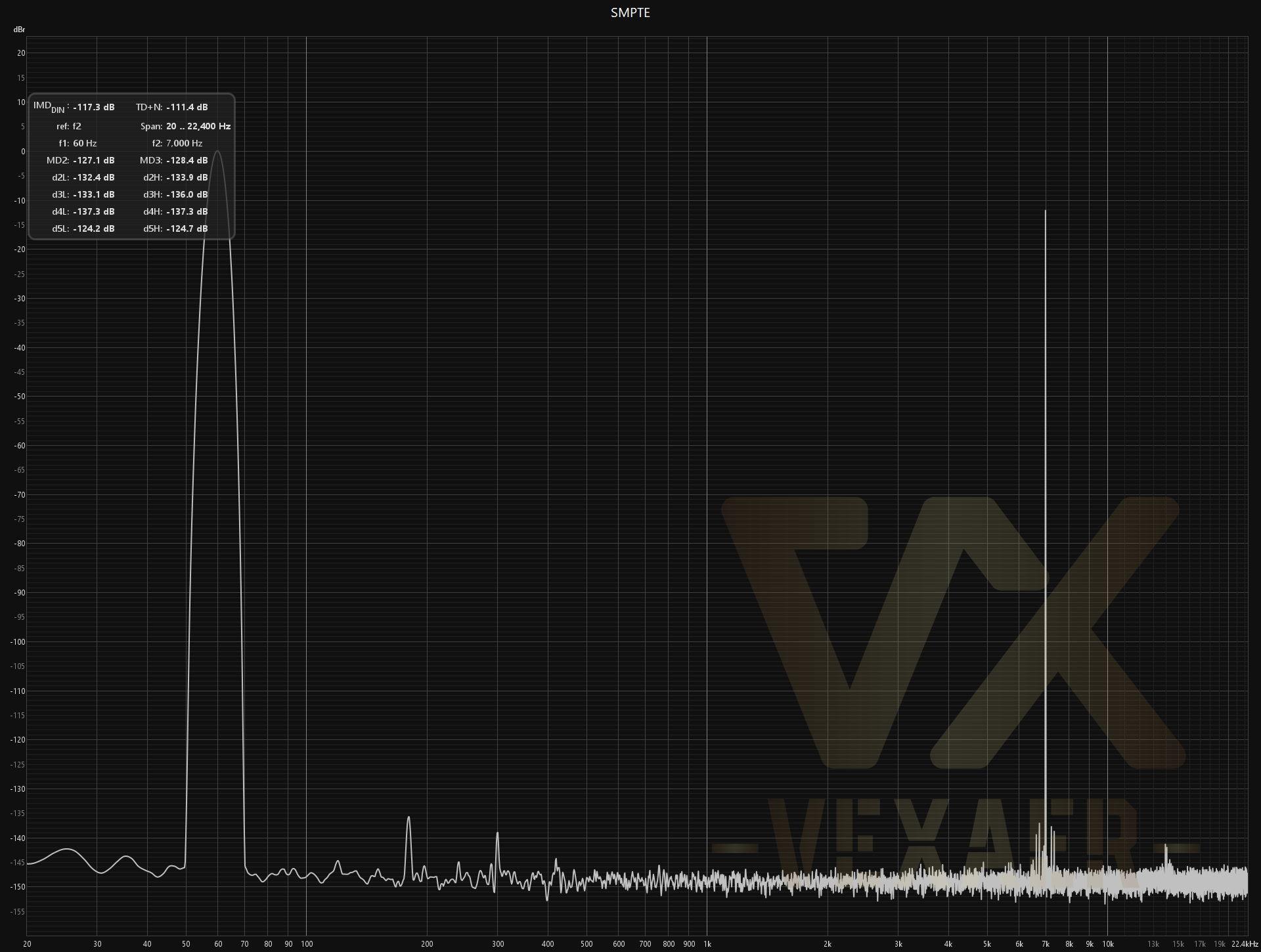

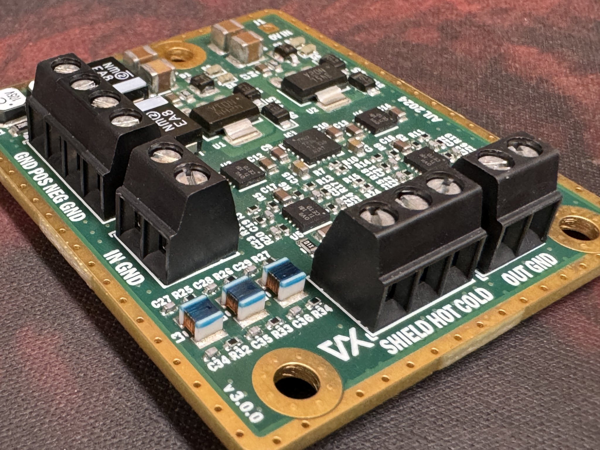

After a couple revisions the Input Buffer is now finished and ready to go.
Switchable between unbalanced and balanced input. Balanced input has built in attenuation of 6dB to gain match with the Wolverine IPS and Unbalanced connections.
On Board Regulators, with filtering so both linear or SMPS can be used. Input volage should be between +-20VDC and +-24VDC.
On EF3-4 it will bolt right up beside the IPS, EF3-3 can be mounted remotely.
Very low idle noise on both Balanced and Unbalanced inputs <1uV 20-22.4k

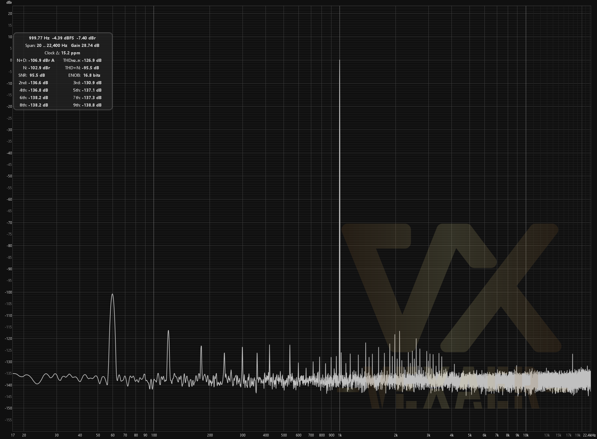

The issue I have found in a lot of testing is that unless the Source is isolated, and not mains powered there is a lot of loop noise. This is a measurement of the Wolverine connected to a D90 III DAC. This is a typical noise floor I see under these conditions.

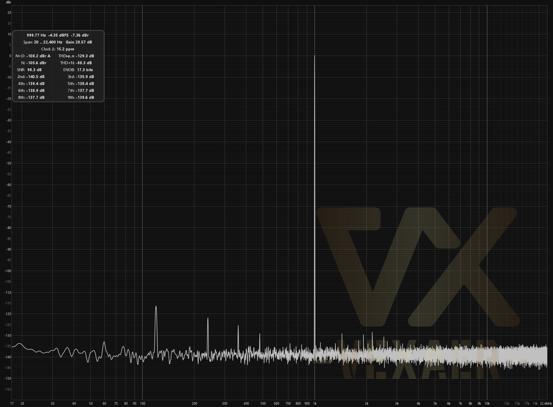

And now the same DAC connected with a Balanced Connection to the Buffer, then the Wolverine.

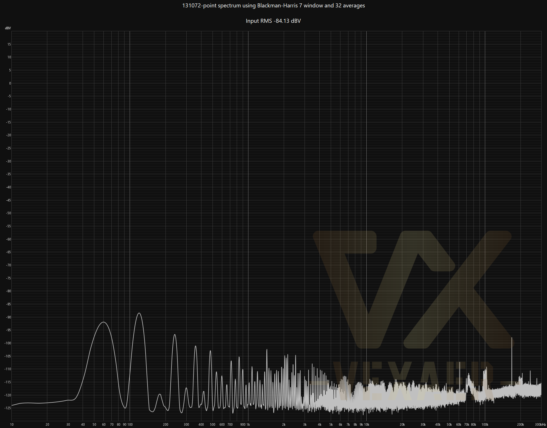

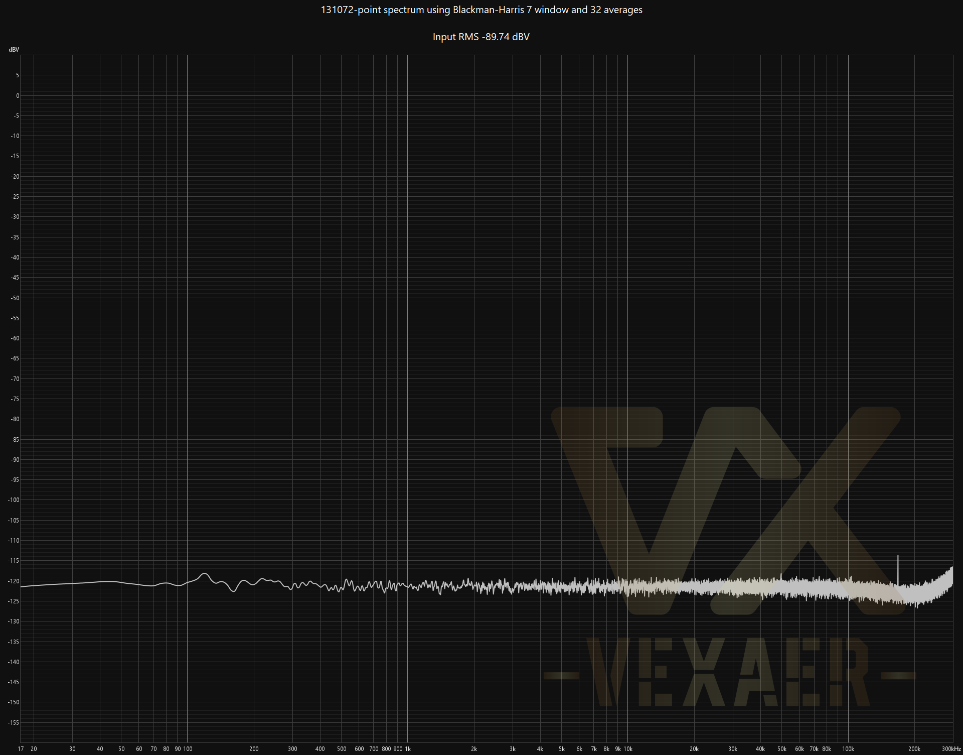

Here are some 1 Watt SNR measurements for comparison. Wolverine, Buffer Unbalanced, Buffer Balanced.
Wolverine Only
Buffer Unbalanced
Buffer Balanced

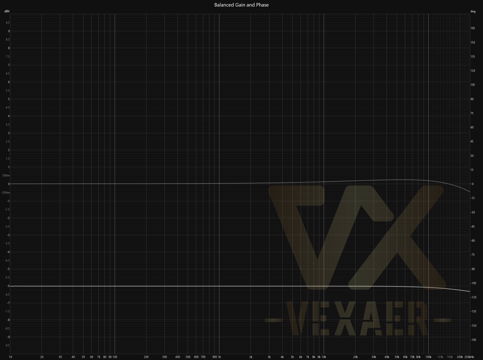

And here are some measurements of just the Buffer in isolation.

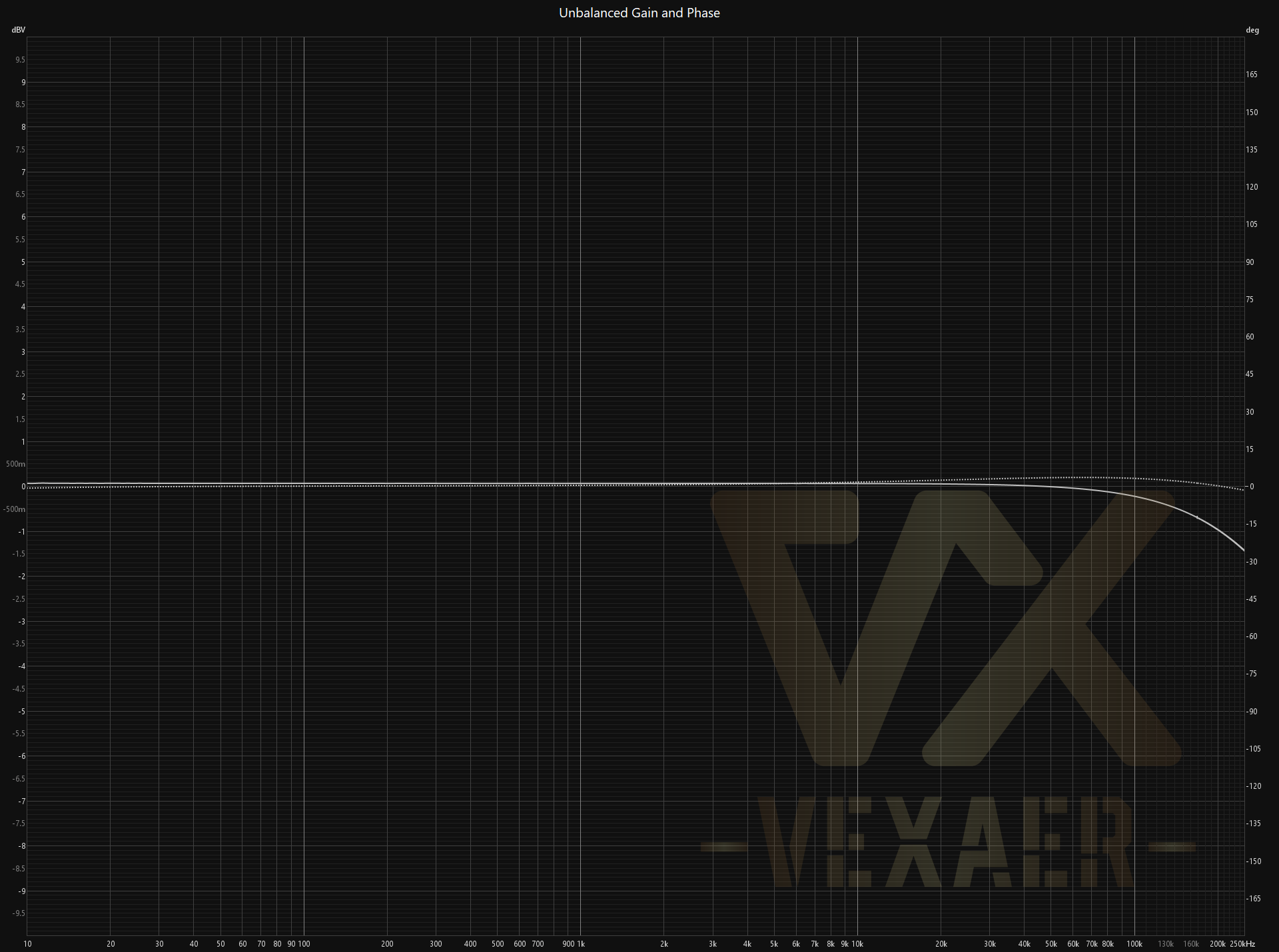

Gain and Phase Balanced
Gain and Phase UnBalanced

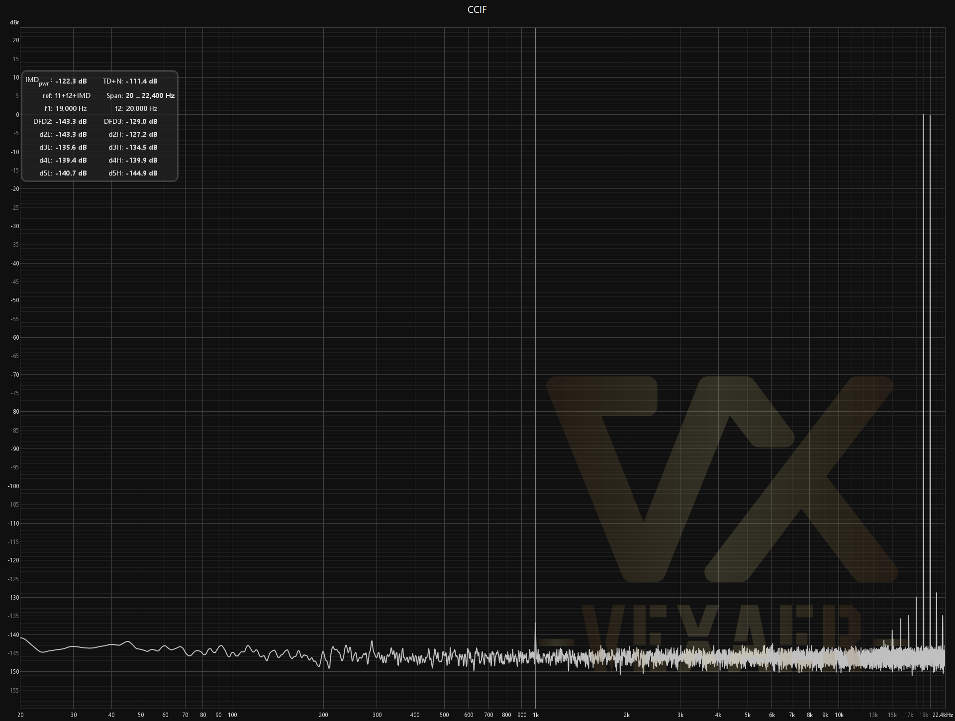

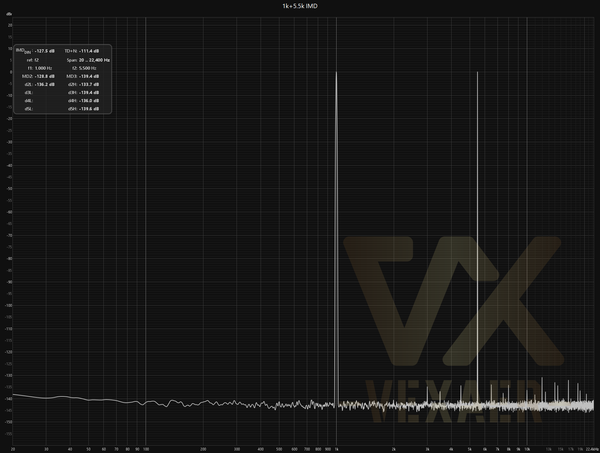

IMD Tests
I will start a dedicated Preorder Thread for those interested.
