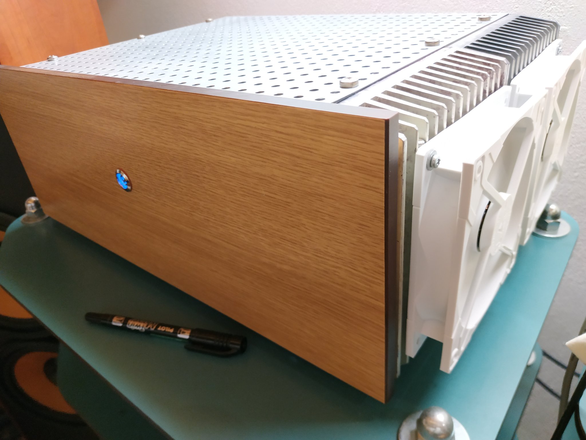

I agree with yours comments. We described the same problem with different words... That's why i put external Pwm fan on heatsinks. Now i run the amplifier at 2x59V on limits (speakers 4Ω 300W) with thermal safety ...not above temp 45 C on heatsinks 27.5cm x 16cm x5 cm with temp room also 30C...with this way keeps the bias also rock steady at 40-45mv.(not transferred extra heat inside the box and minimize the bias).I noticed your comment about the temperature issues. It seems like the heatsinks you're using are undersized to startwith. If you had larger or more adequate heatsinks, you likely wouldn't experience those higher temperatures than you expected. This also means you could mount your transistors in either orientation (up or down) without worrying about unbalanced temperature

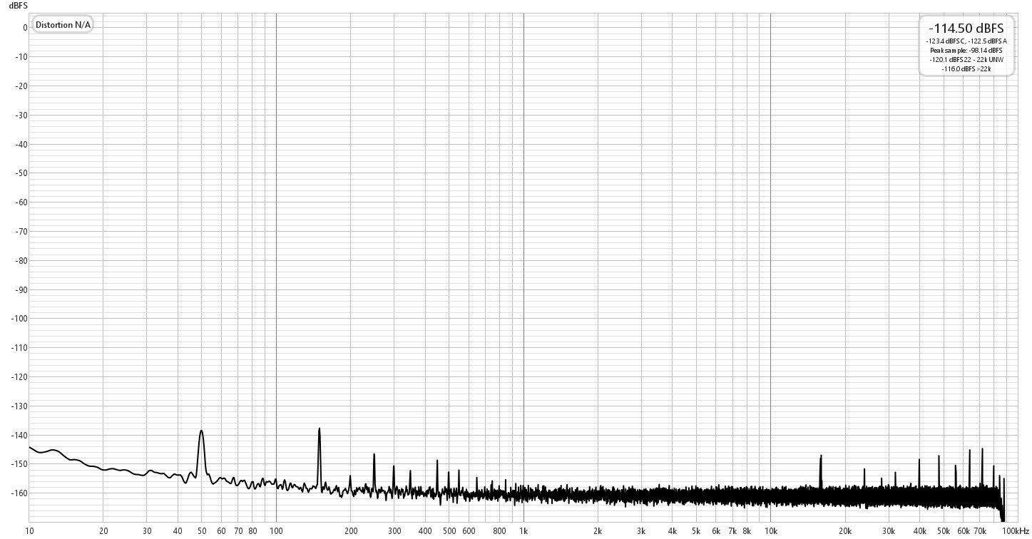

Noise floor - wolverine - 1 channel - in complete chassis. 96khz sampling

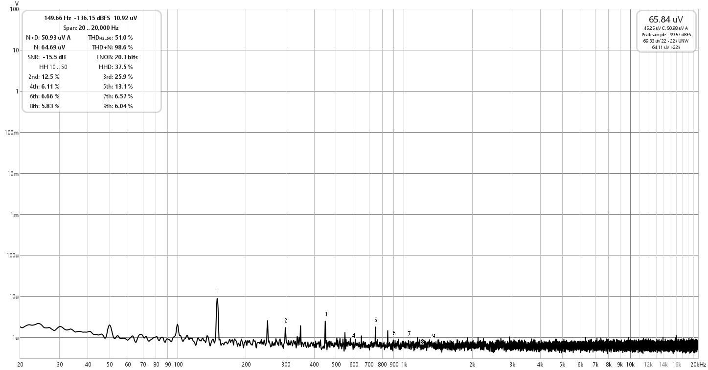

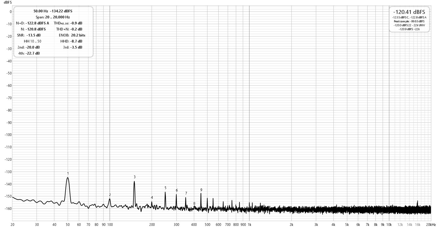

Same again with 192khz sampling - I have yet to get my head around getting 384khz sampling to work on windows and REW. The 16khz is USB packet noise, I have proven this.

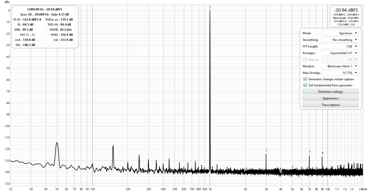

1khz, 5W into 8ohm. 96khz sampling. (96 is more stable, 192 often hiccups). Reminder - visible harmonics are from my DAC
I'm certain the 50 and 3rd noise is from the incoming AC line or the AC line rectifier and using shielding could have some improvement. Starting to look good for 95dB+ sens speakers.

@mainframe99 if you have calibrated your ADC voltages, do you mind changing the scale to V, or dBV so we can see the actual level please. Also are you using any other filtering or is that SMPS right to the Wolverine?
@fireanimal here, I think your cobra measurement still has it beat (was it in case or on bench only?). Still, a nice alternative in the new hypex.
Oh and no filtering, SMPS straight to Wolverine. Cant seem to figure out that 3rd/150.. might be our nasty mains really clipped tops.
Something maybe limiting to your Wolverine, though a single channel, may be the maximum continuous power that this model could provide: 100w...only.

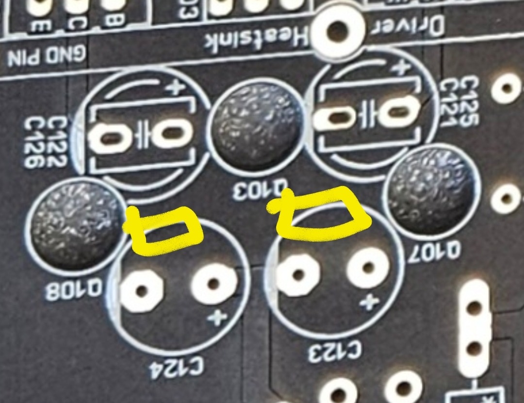

The SMD caps are located on the underside of the board as shown below.The SMD cap, underneath the electrolytic, or underside of board? So there are now 6 caps total here?
The idea is.
1. If you don't like SMD soldering then just install the 2 THT electrolytic capacitors and the two THT film caps, all top side.
2. If your happy to solder SMD then install the 4 THT electronic capacitors top side and the 2 SMD film capacitors on the underside.
Hope that helps.

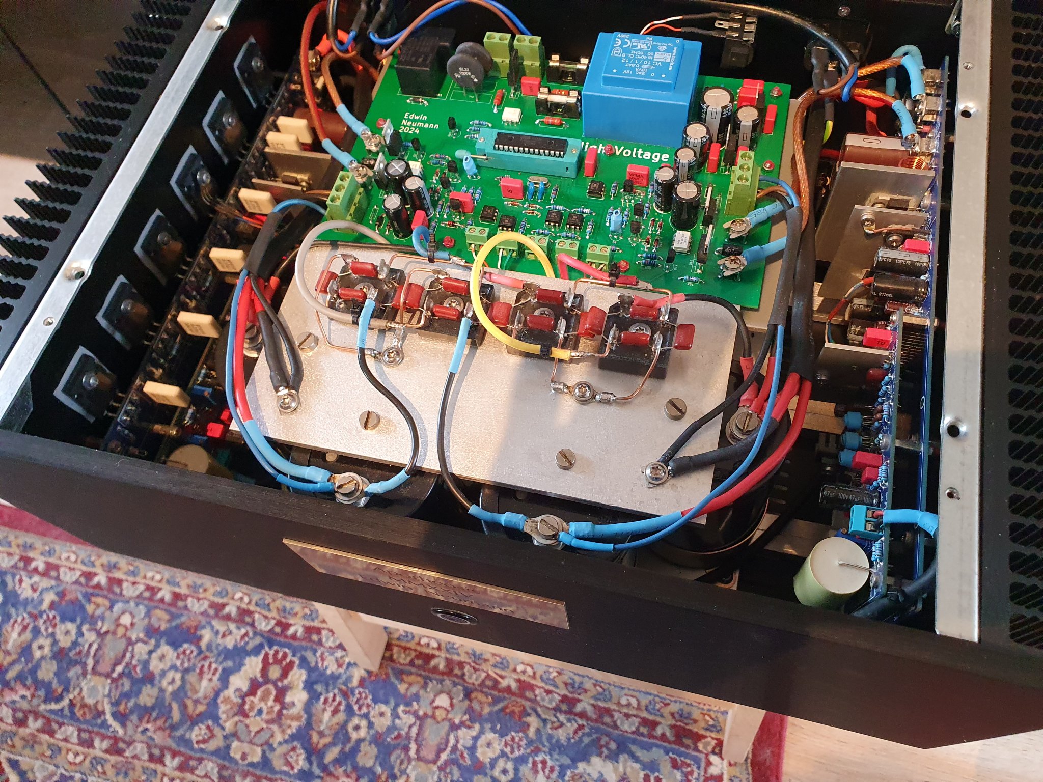

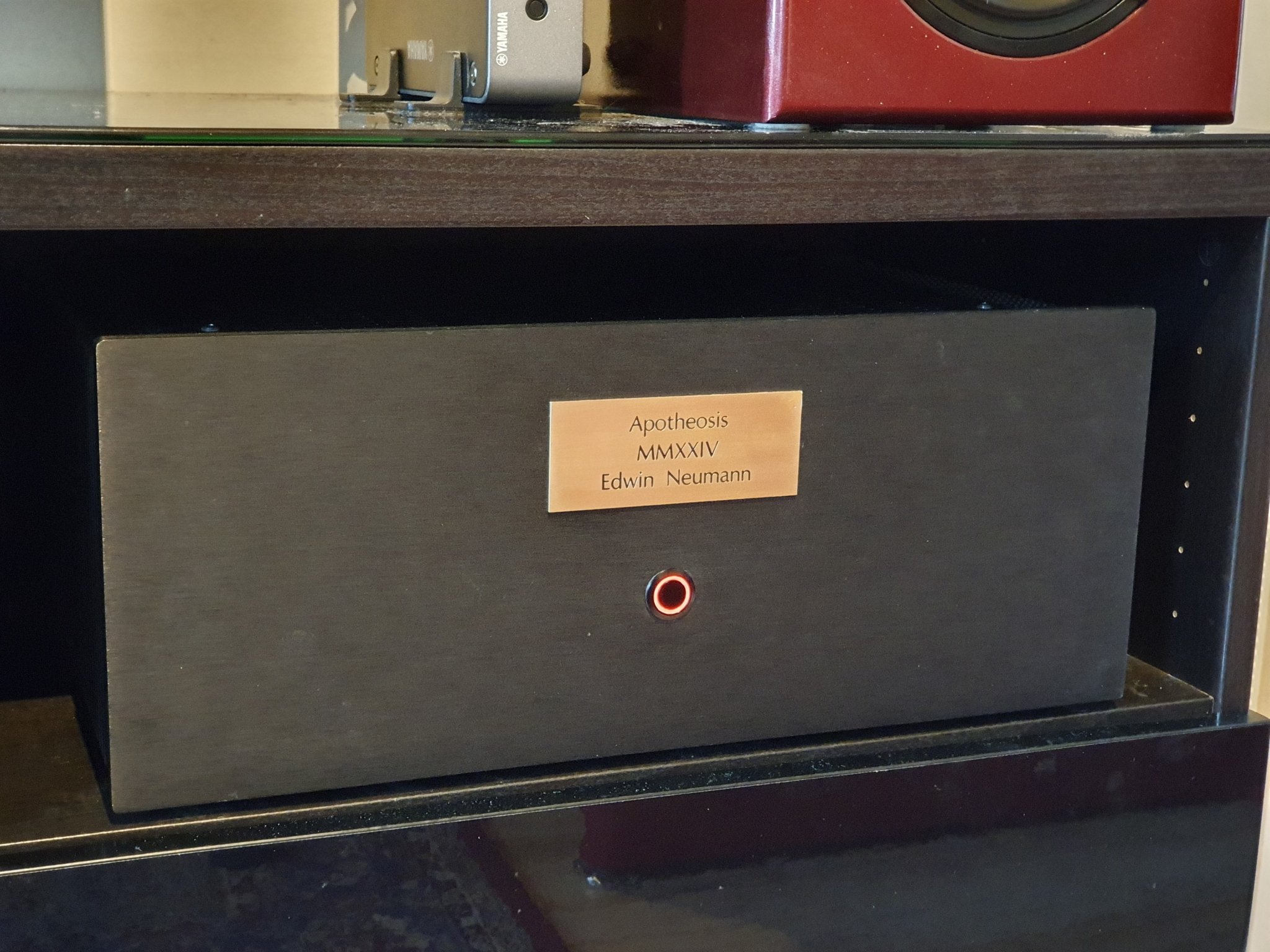

The microprocessor based upgrade of my amplifier as described in message #3622 is now done and build into the amplifier. I am very satisfied with the result. The fact that the amplifier is now well secured, switches on and off discreetly, and the luxury that this takes place automatically, contributes to the quality experience.
I also took the opportunity to give the amplifier it's own name, Wolverine translates in Dutch and German language to respectively Veelvraat and Vielfraß (eats lots), both have a negative connotation within their language area. This amplifier deserves a name that reflects her quality, so I now call her Apotheosis, meaning; elevated to divine level.
