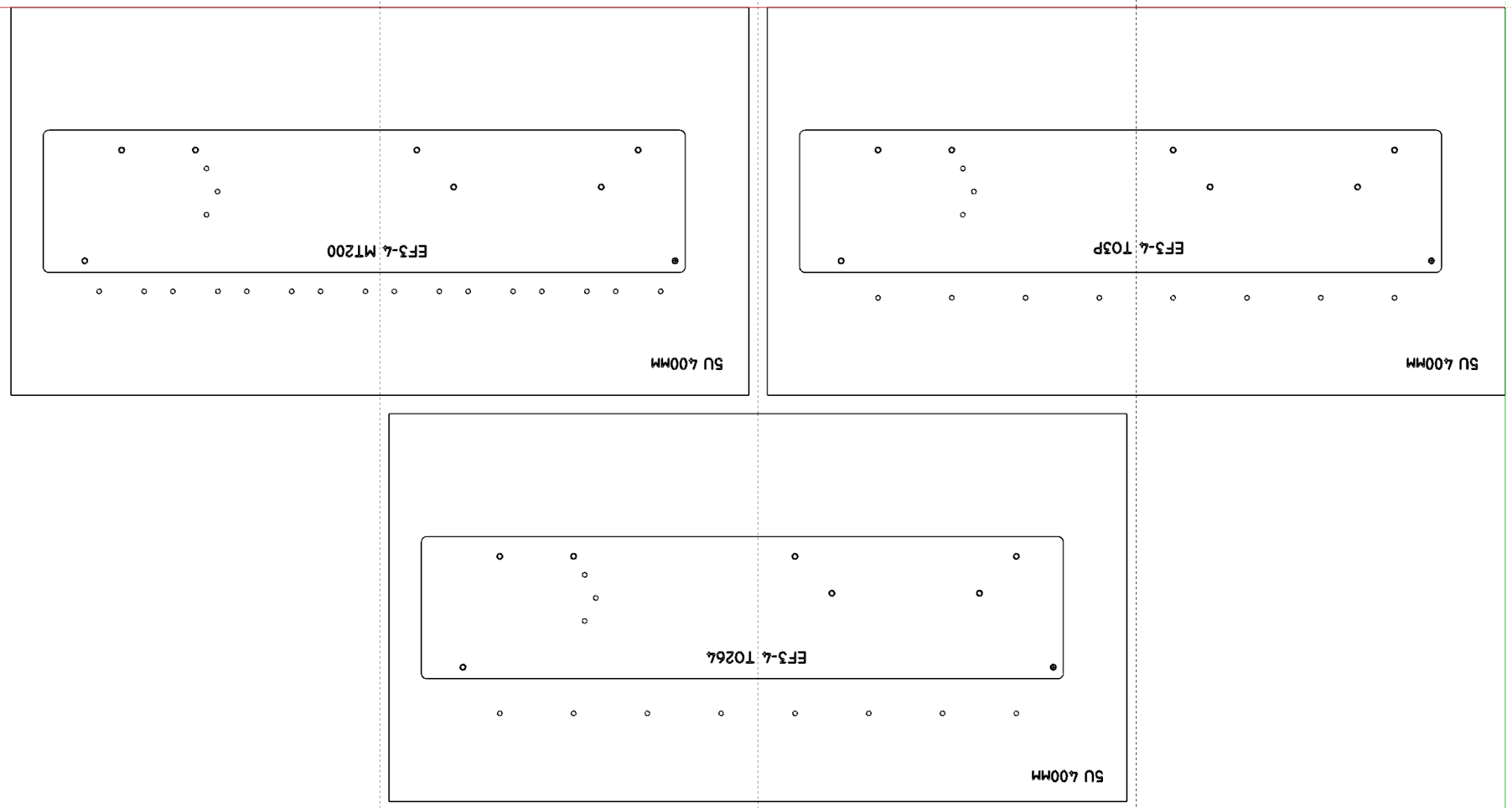

For the best cooling it should be upside down, don't you think so?

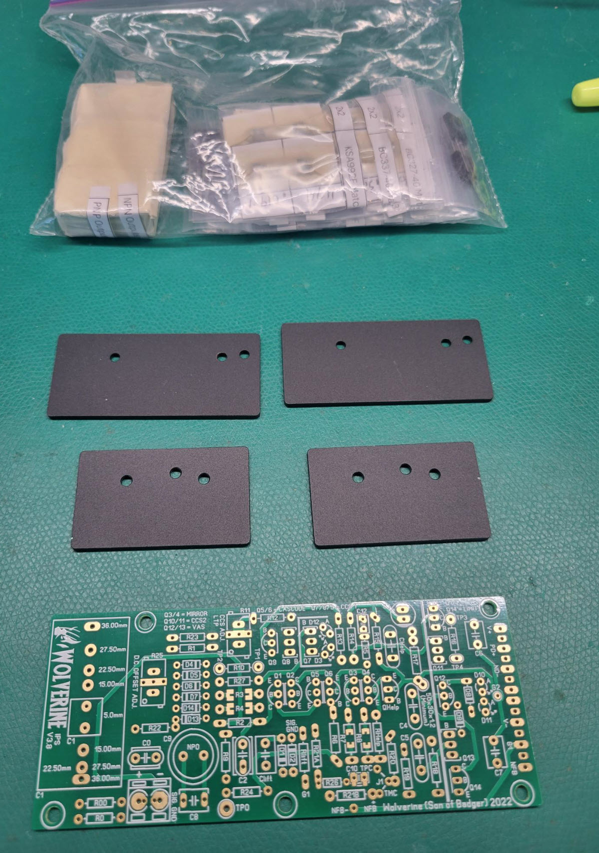

Just a quick update. The production of the 4th GB boards is complete.
They will soon be dispatched to @jjs, @fireanimal and myself.

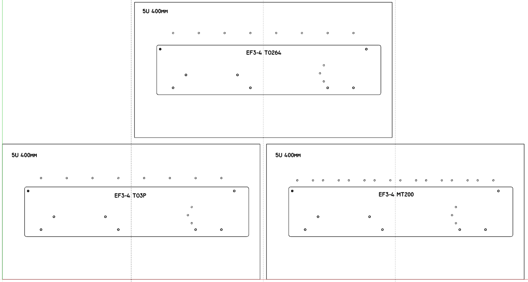

Which way is up?
But yeah, as it has already been pointed out we usually try to center everything on the heatsinks and not shift them up or down @mainframe99
Exactly!I think the heatsink itself is symmetrical i.e. you just flippy 180deg as you need. You could have both sides outputs up, down, or one up & one down
The only thing I should add to my admittedly flippant comment is...
With the newer chassis that come with the "full surround" rails/mounts, if folks want to alter "up or down" based on preference, they'll need to note the placement of the captured (don't know if that's the correct word) nuts on the rails. Those are used for attaching the back panel. It's only a few bolts to remove / change it if you get it "wrong", but best to do it right the first time.

Outputs down, it makes some difference. The best way with passive cooling is the fins up like on the attached photo.Kinda why I was asking, I think the heatsink itself is symmetrical i.e. you just flippy 180deg as you need. You could have both sides outputs up, down, or one up & one down

What I noticed in my construction case...is that how big the heatsink plays a role. There is a temperature difference which tends to appear as time goes by..... one thing is for sure that placing the transistors on the lower side of the heatsink is the best option for cooling....but in this way you will not have the two inputs or outputs facing the same side.Didnt notice much difference either way to be honest
I noticed your comment about the temperature issues. It seems like the heatsinks you're using are undersized to startwith. If you had larger or more adequate heatsinks, you likely wouldn't experience those higher temperatures than you expected. This also means you could mount your transistors in either orientation (up or down) without worrying about unbalanced temperature rises.
