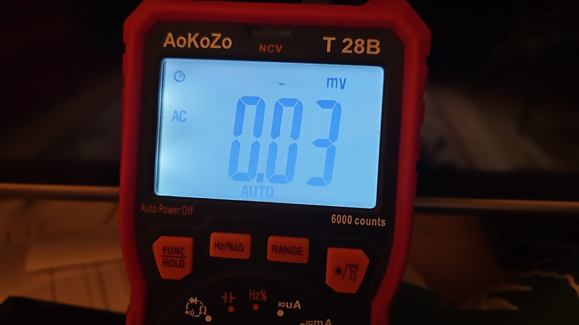

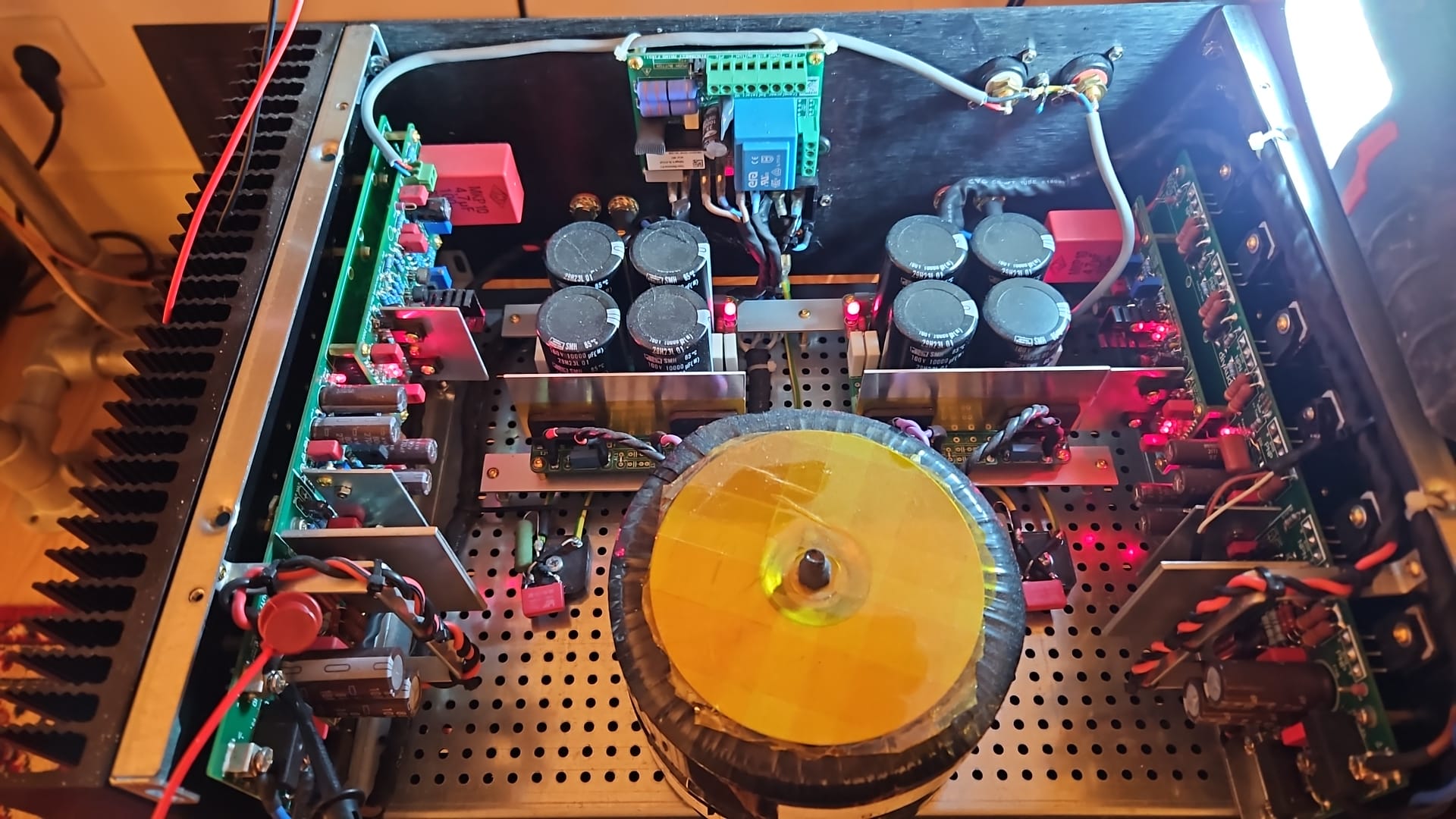

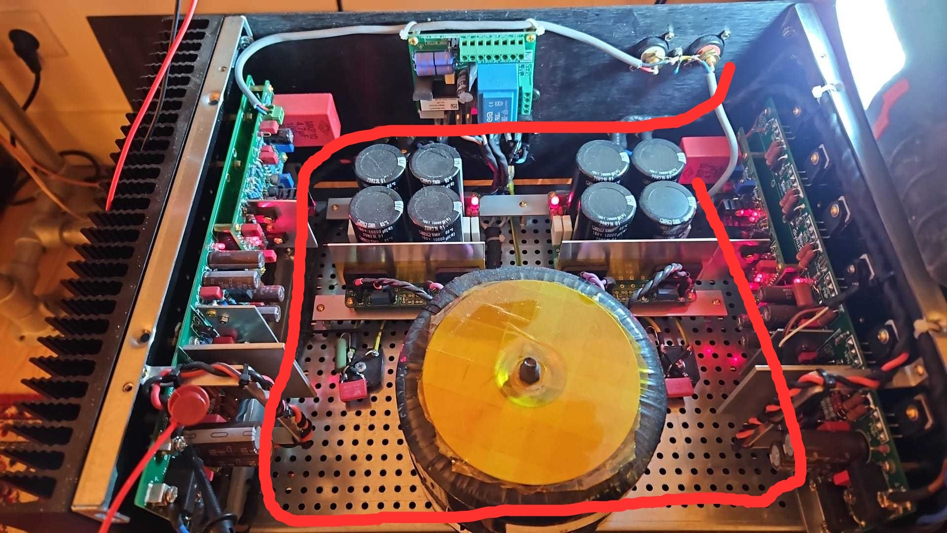

Offsets, bias and current source look reasonable I suppose besides the AC offset of the left channel which reads 12 mv.
What could be the reason of the relatively high AC offset only on the left channel? Could that be position / rotation angle of one of the transformers? Or the slow start circuitboard mounted on the rear panel above which the left channel input cable is running?
thx for any tips...
Hi Wkloppen,
Maybe try moving the signal input wire which is running past the soft start board on the back panel.
This is just a guess but maybe the small transformer is injecting some hum into the left channel via the signal input lead.
I had a similar problem once on a different amplifier with < 1 mV AC on the output with no signal and rotating the toroid about 45° fixed it.
I hope this helps.
- Dan
I hope this helps.
- Dan

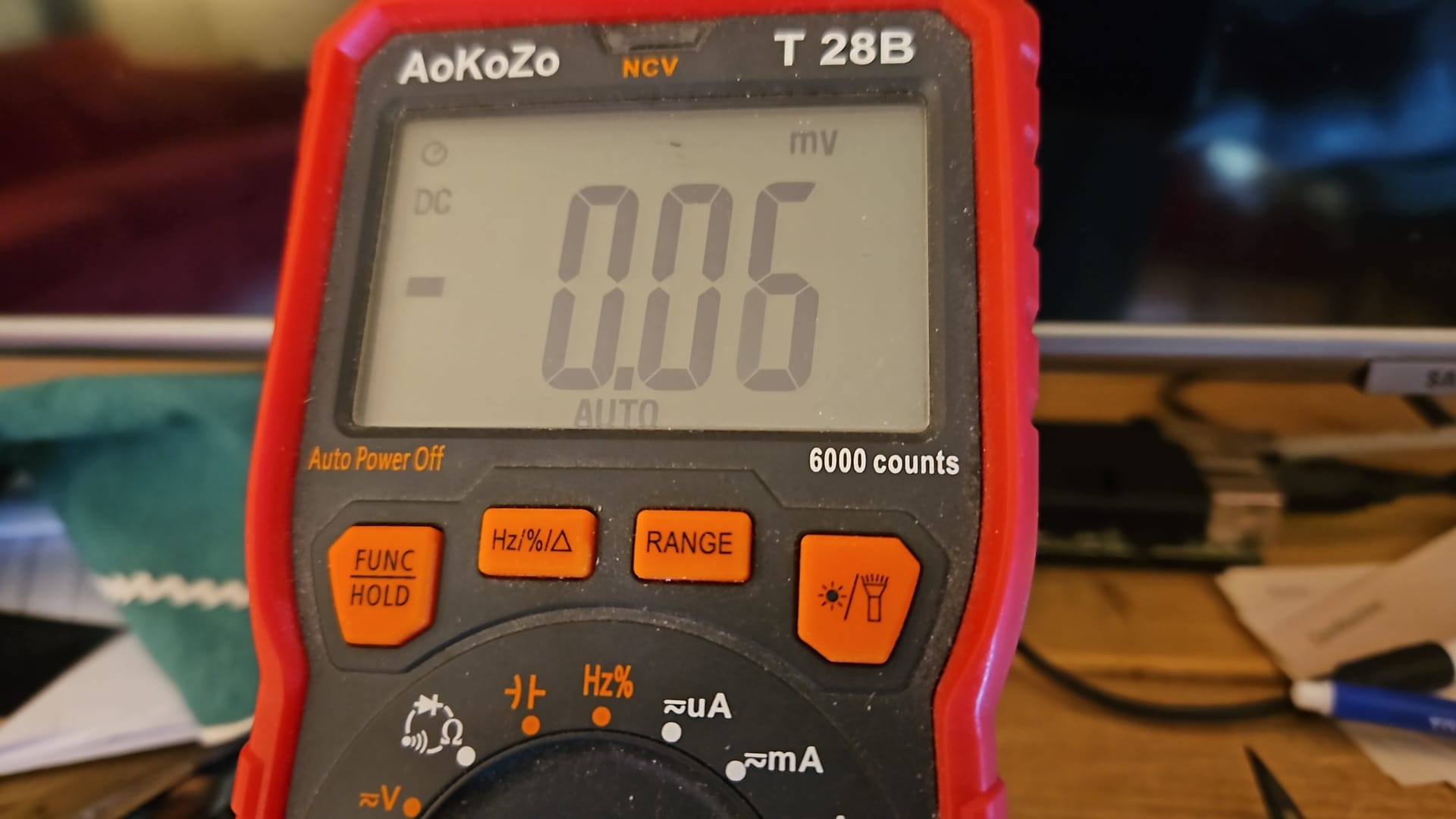

That's probably it. Disconnected the left channel input cable and shorted it with wire. Now it measures pretty much in the ballpark I guess with an AC offset of 0.03 mv and a dc offset fluctuating slowly between - 0.2 and + 0.2 mv. Need to reroute the left input cable🙂Maybe try moving the signal input wire which is running past the soft start board on the back panel.
AC
DC

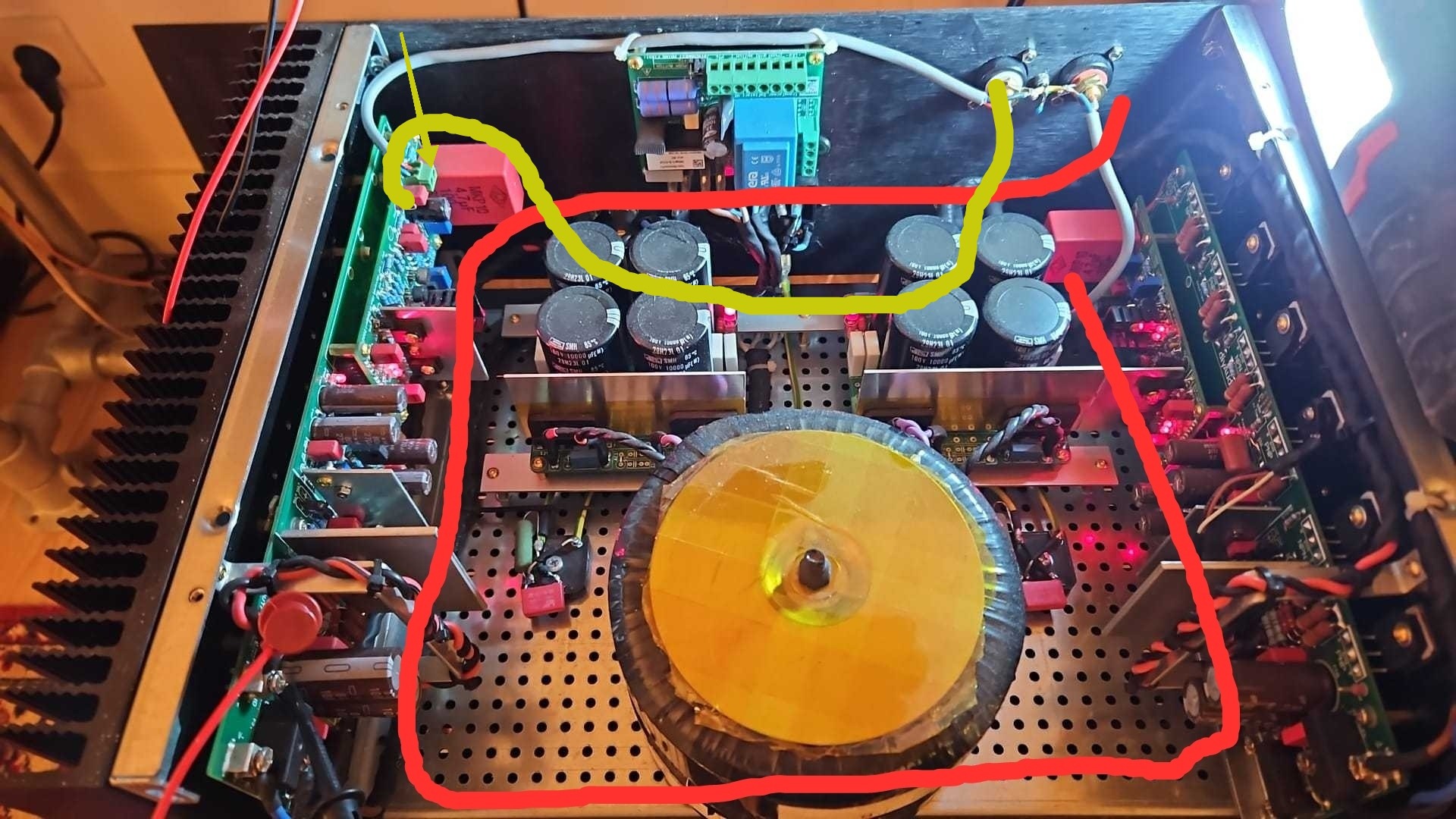

Maybe moving the soft start board is a better option. Will it fit on top of your toroidal transformer.Need to reroute the left input cable🙂
Nice tips.....on top of the transformer wouldn't fit I think. Unfortunatly the consequence of having 2 seperate transformers instead of one. I'm thinking of fabricating a bracket for the soft start placing it perpendicular on the backpanel while on the same time moveing it a bit inwards inbetween the 2 PSU's.down the top of the right side would put it next to the outputs.
I will first meansure the relation between distance and the measured offsets. Maybe a move of only 2 cm makes all the difference🙂
w.
Thats an option for sure but I might increase the noise by moving it closer to one of the channels. Could work though....Need to test it first and I'm a bit reluctant to disassemble a nice working amp🙂. Will mkae a test left channel input wire first to get a feel of the distance required.move the trafos a bit on the left or on the right
In this case I prefer iron pipe as braided copper does not help much against the magnetic field coming from the auxiliary transformer.
Remove the cable from the RCA socket and away from the soft start. Do some measurements and if there is no noise/ hum, move the RCA socket to the other side.
I would prefer this route for the input wires.
Rearrange both input wires and keep those close to the bottom of the enclosure.

I would do the same. I prefer keeping RCA sockets close to their respective boards, less noise problems.Remove the cable from the RCA socket and away from the soft start. Do some measurements and if there is no noise/ hum, move the RCA socket to the other side.
