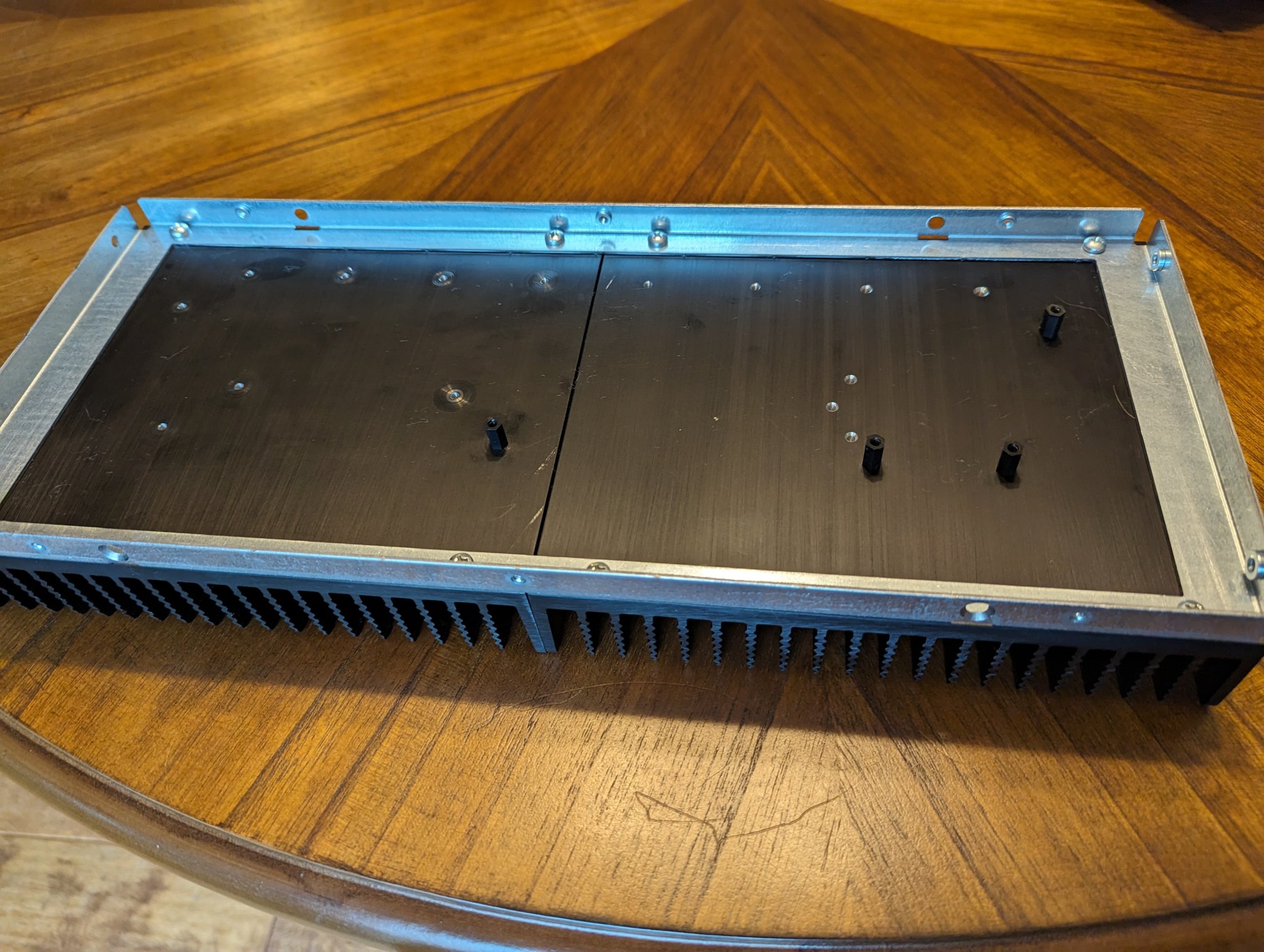

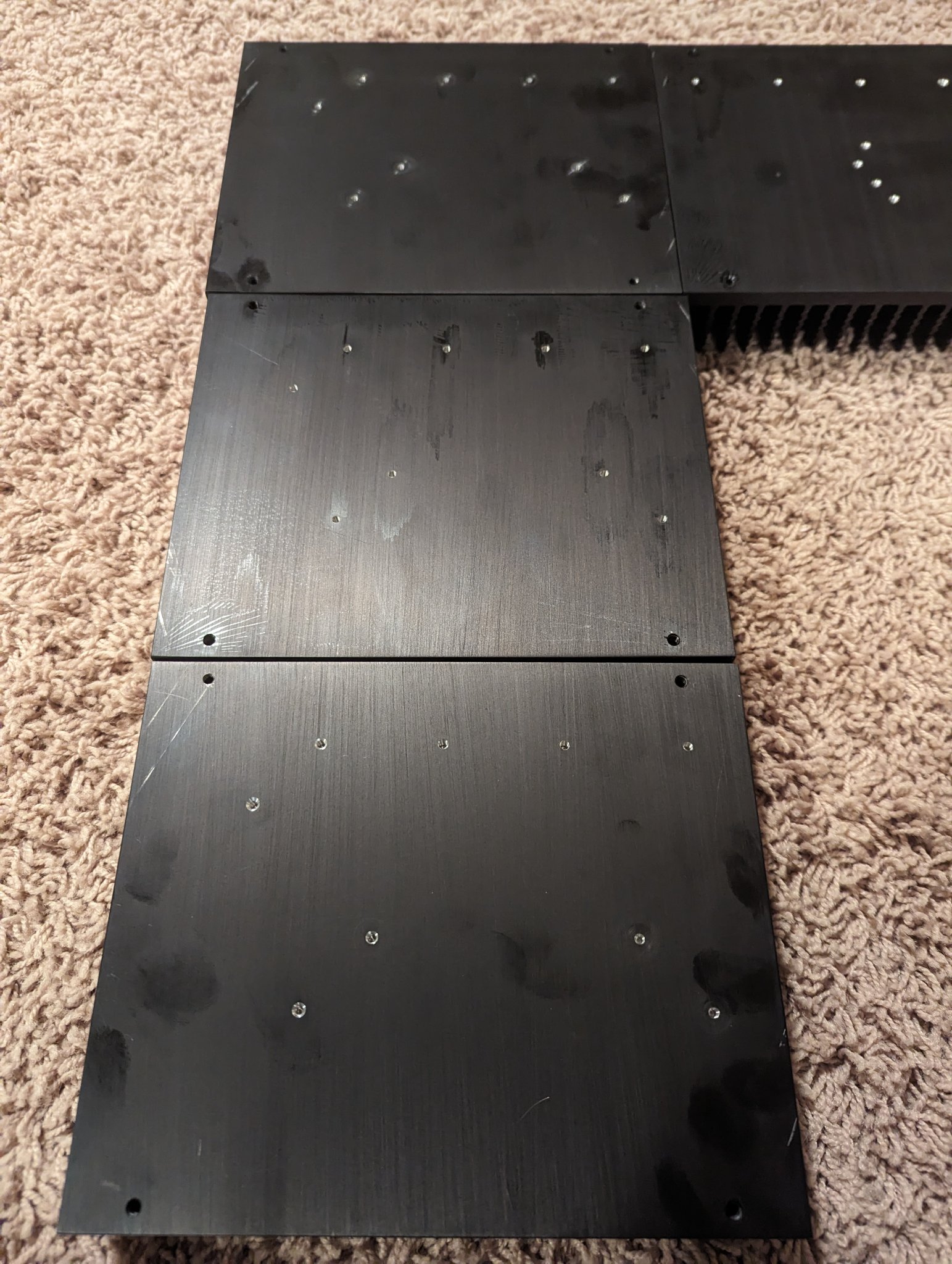

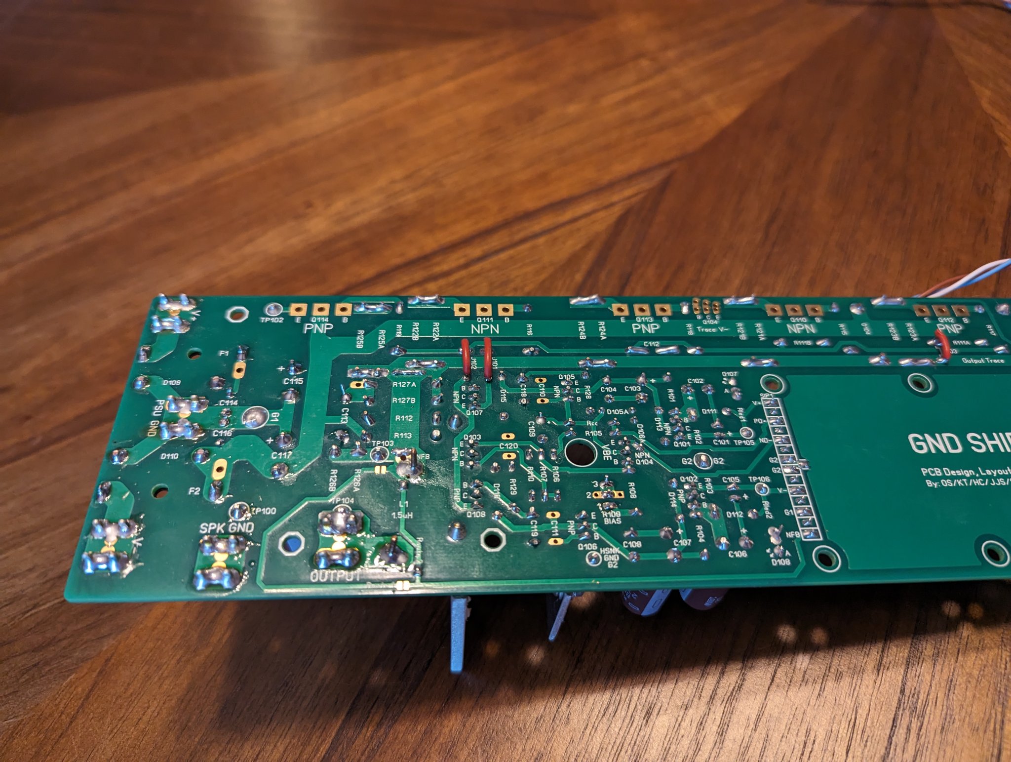

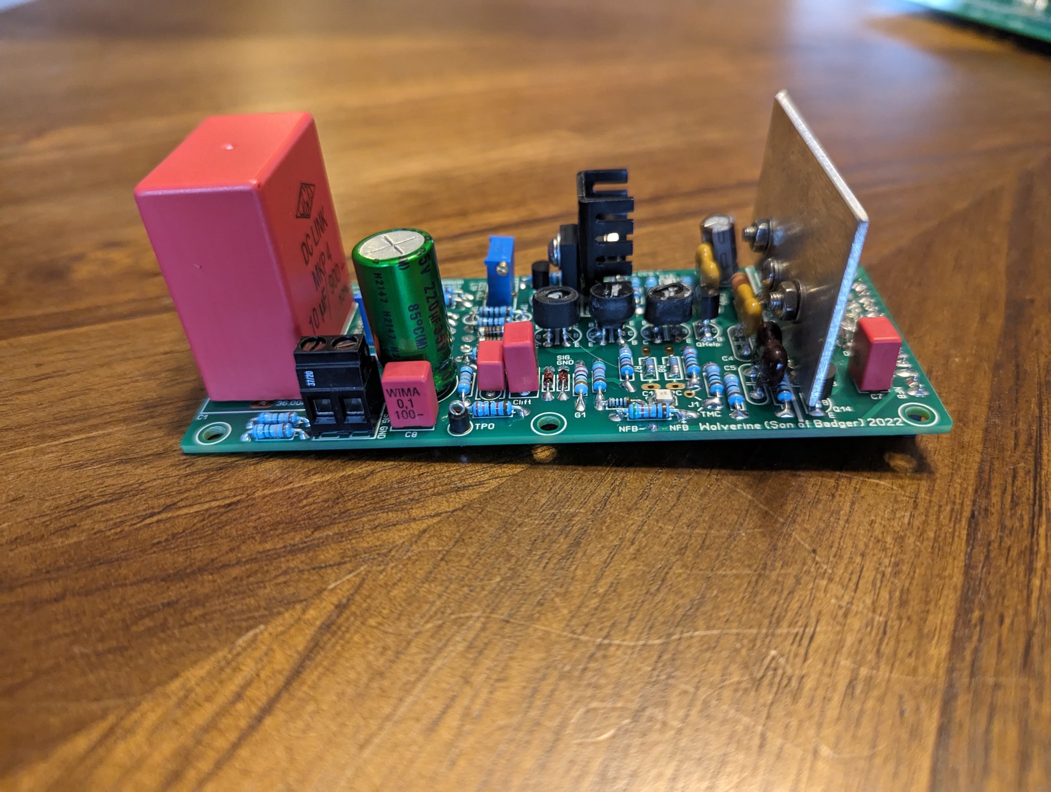

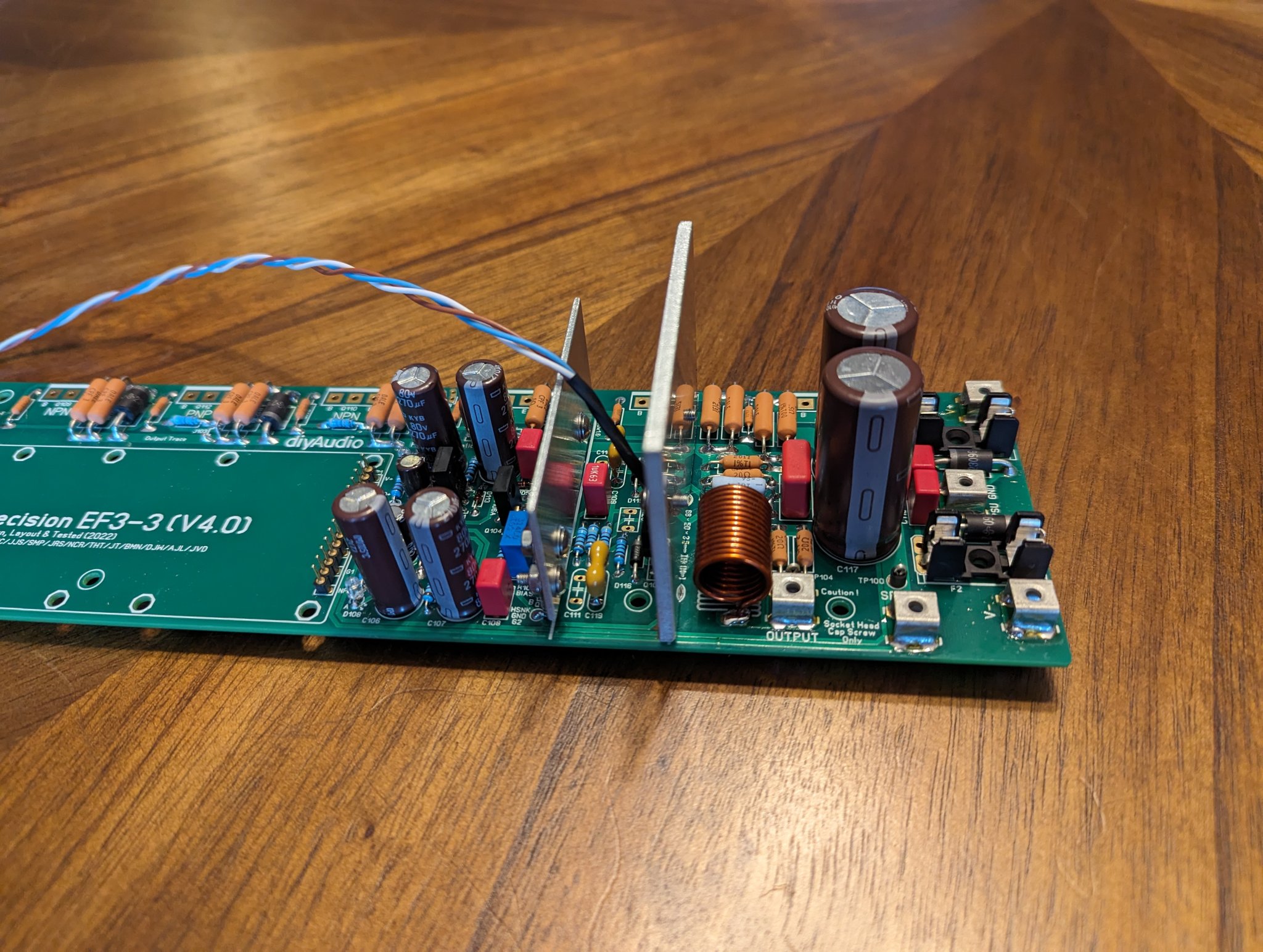

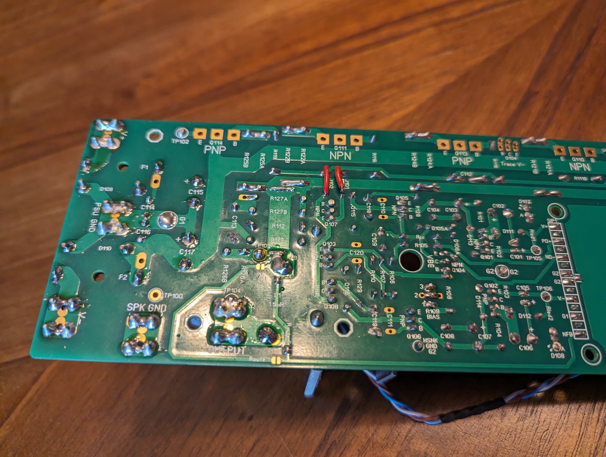

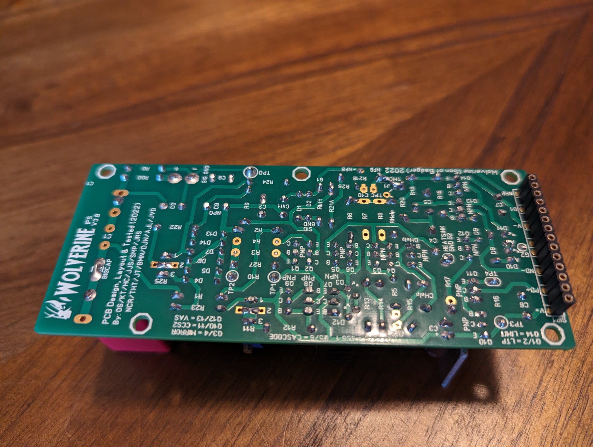

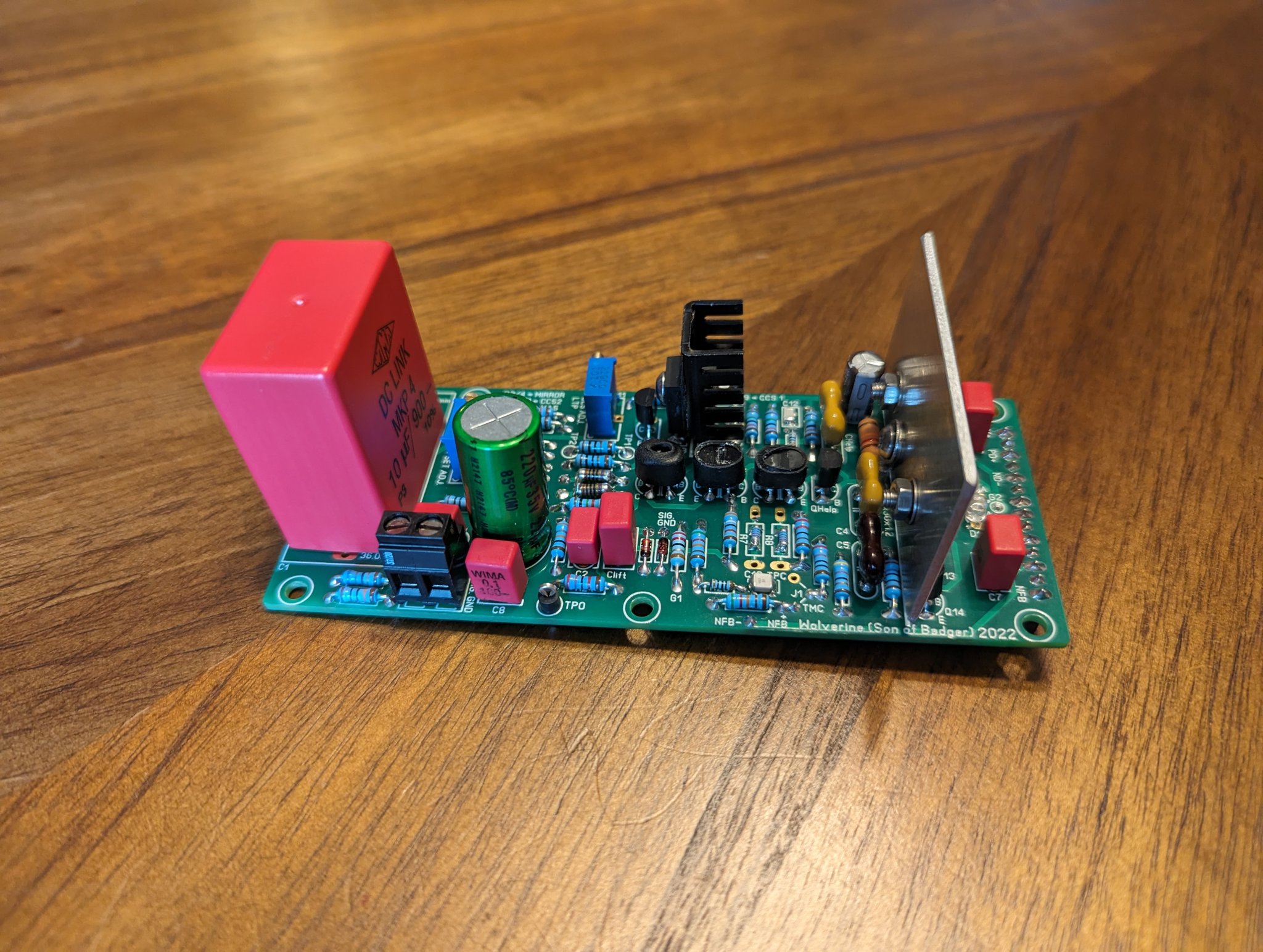

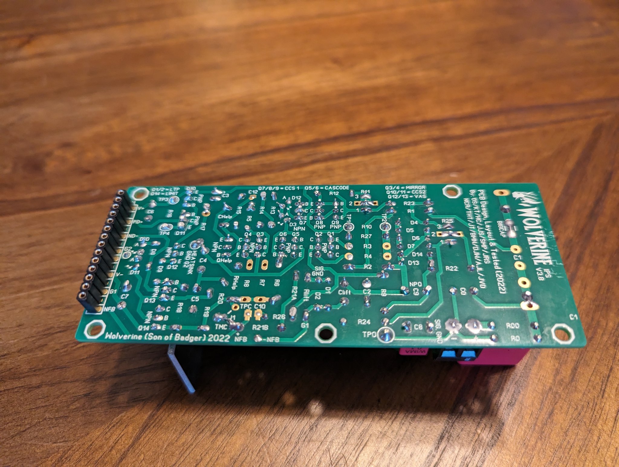

I’m in the process of building a EF3-3 v4.0. A huge shout out to Fireanimal for providing the components. I’m mostly done with the soldering and was gearing up to test one channel. Attached are a few photos, constructive feedback is welcomed and appreciated.
I’ve run into an issue with mounting the boards on the heat sinks. I would like to avoid spinning my wheels, so please forgive the dumb question. Are the EF3-3 and EF3-4 mounting holes the same? I’m assuming the EF3-4 has additional mounting holes. The hole patterns in Dropbox and in the build, guide only mentions EF3-4. I’ve tried searching the thread, but I can’t find the answer.
I purchased the Dissipante 4U from Modushop, with the Wolverine EF3-4 drilled hole substitution. The issue I am running into is twofold…Modushop sent me 4 heat sinks, 3 of which had the exact same hole pattern. I’ve reached out to them but have not heard back. Effectively I can only mount one channel at this point with what I have, without drilling and taping new holes.
The second issue occurs when I go to mount the precision EF3-3 board. I can only get 4 holes to line up (see photo with standoffs). I’m trying to figure out if I goofed, by assuming the hole pattern was the same or did Modushop send me heat sinks with the wrong drill pattern.

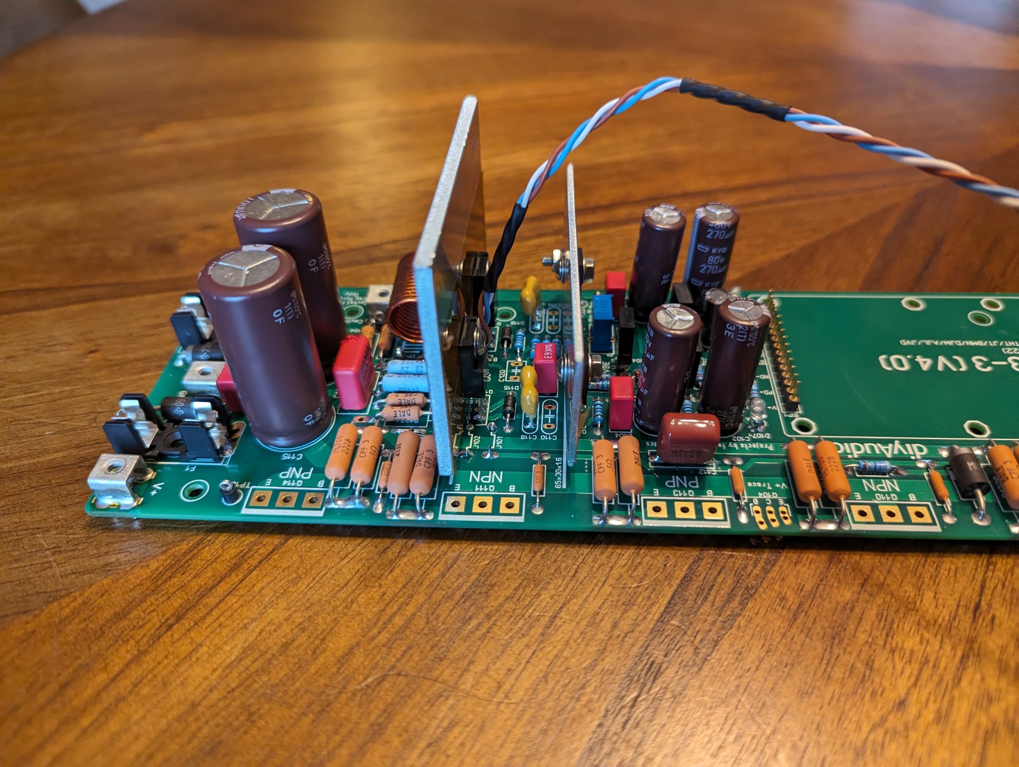

Keep in mind you have to remove J103 after the first test phase. Maybe it would be a better idea to mount this one on the top side so you can remove it more easily after this step.I’m in the process of building a EF3-3 v4.0. A huge shout out to Fireanimal for providing the components. I’m mostly done with the soldering and was gearing up to test one channel. Attached are a few photos, constructive feedback is welcomed and appreciated.

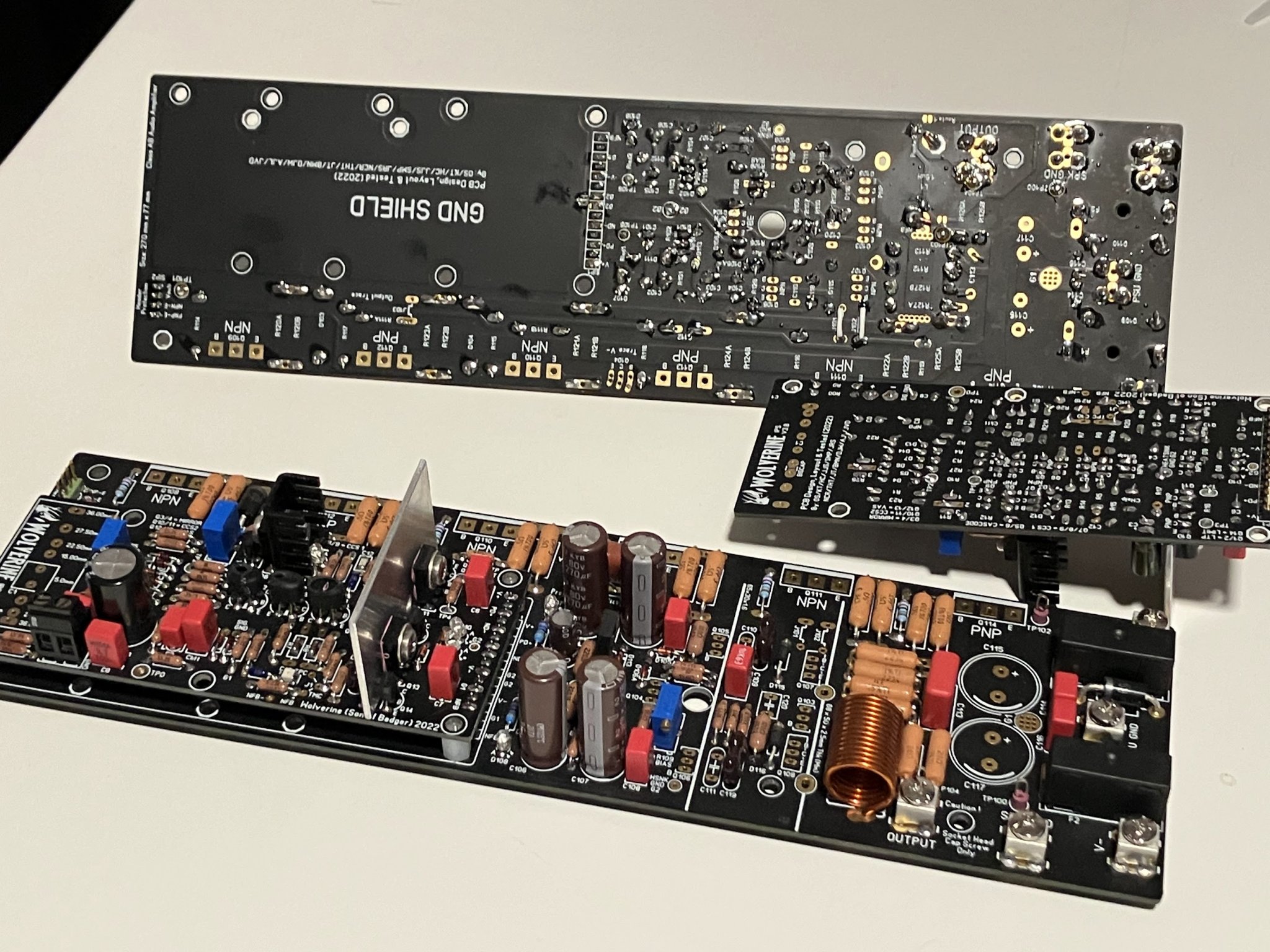

I unfortunately need to take a hiatus from build projects for a while due to life and work circumstances. Which is a bummer because this amp is amazing, and I'm in the home stretch.I would like to use this SMPS for this build

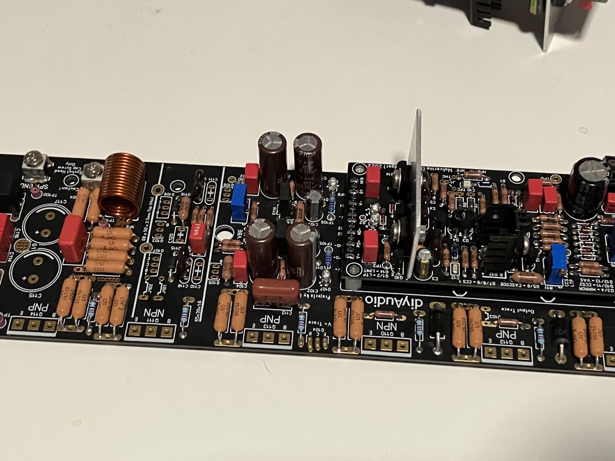

I have my EF3-3 and IPS boards stuffed (well 97% stuffed), and I have a high-quality SMPS (MicroAudio Cobra) @ +/-70VDC.
The vast majority of my semi's came matched from @fireanimal (grateful, again!), and I opted for all of the "higher-quality" caps and resistors from the BOM. The outputs are MJL4281AG & MJL4302AG.
Not that it matters much, but I also use Cardas Quad Eutectic solder for everything.
(Hadn't got around to cleaning the flux from the EF3 boards)

Hi Mike, please send me a PM about this. As you've said one of the heatsinks has been incorrectly drilled and there's no problem in sending you a replacement. I have sent you an email a couple of days ago but I guess you did not receive itI’m in the process of building a EF3-3 v4.0. A huge shout out to Fireanimal for providing the components. I’m mostly done with the soldering and was gearing up to test one channel. Attached are a few photos, constructive feedback is welcomed and appreciated.
