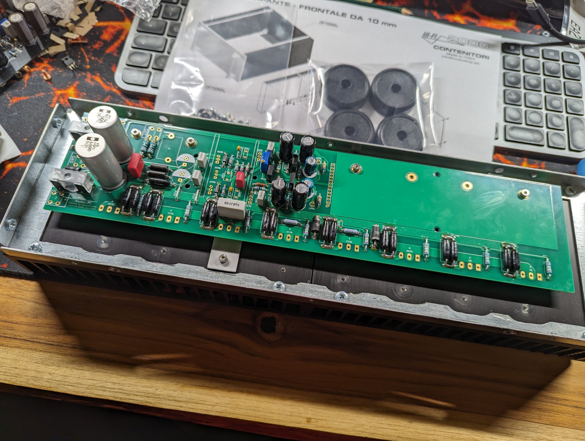

Testfitting of my (partly stuffed) own made boards - 3HE Modushop case needs some modification if you want to use ceramic insulators...
Truly DIY to pick up the challenge to self design the PCB. What software did you use? Did you make a mirrored set?

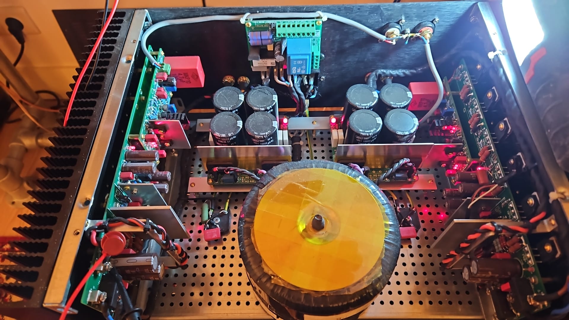

I found it was necessary to build a frame beneath my 1 kVA toroidal transformer in order to stabilize it. It was quite a squeeze to fit everything in my 300 deep 4HE cabinet. Will follow your build with interest.
They're designed with KiCAD. The version you can see in my last post is following 1:1 the groupbuy-board (plus the latest feedback path improvement). I've done a mirrored layout, too. But that was not in production yet.

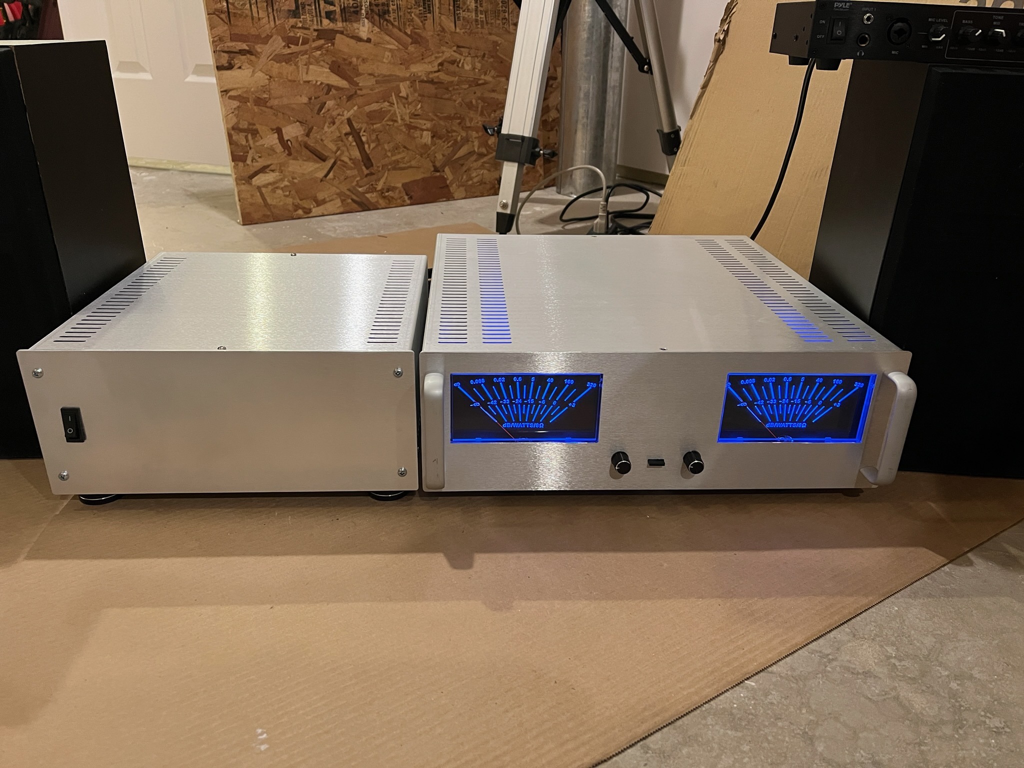

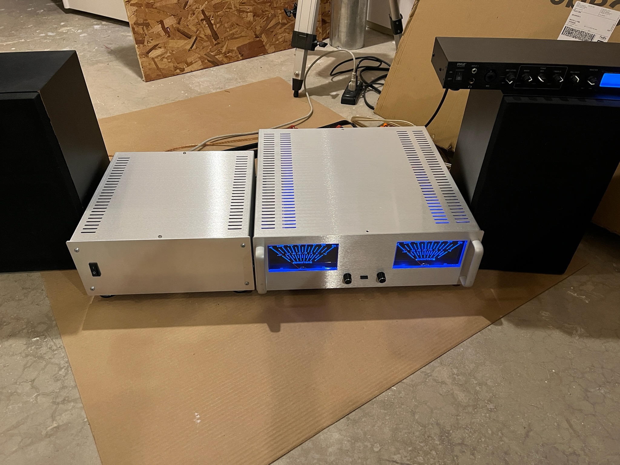

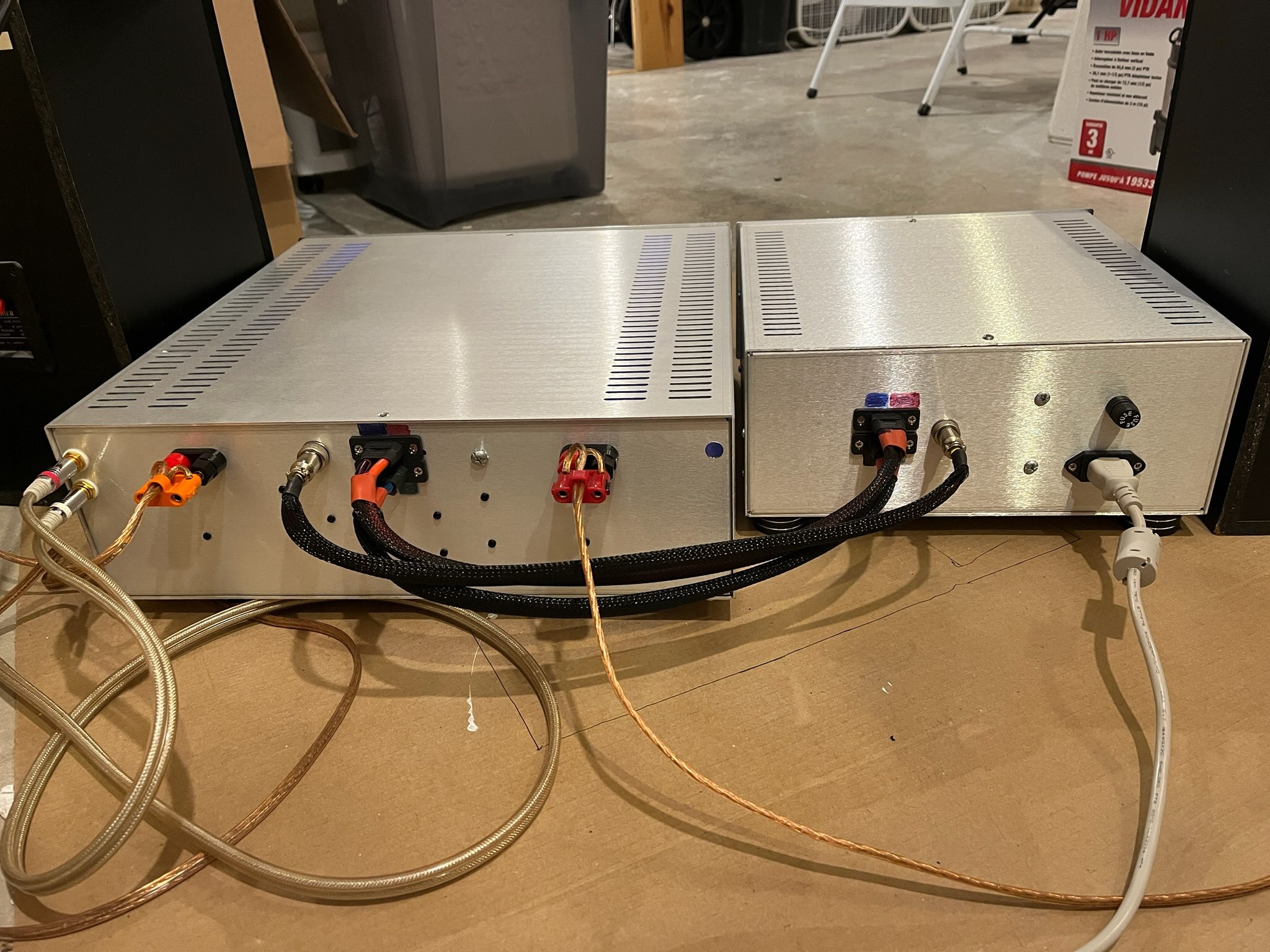

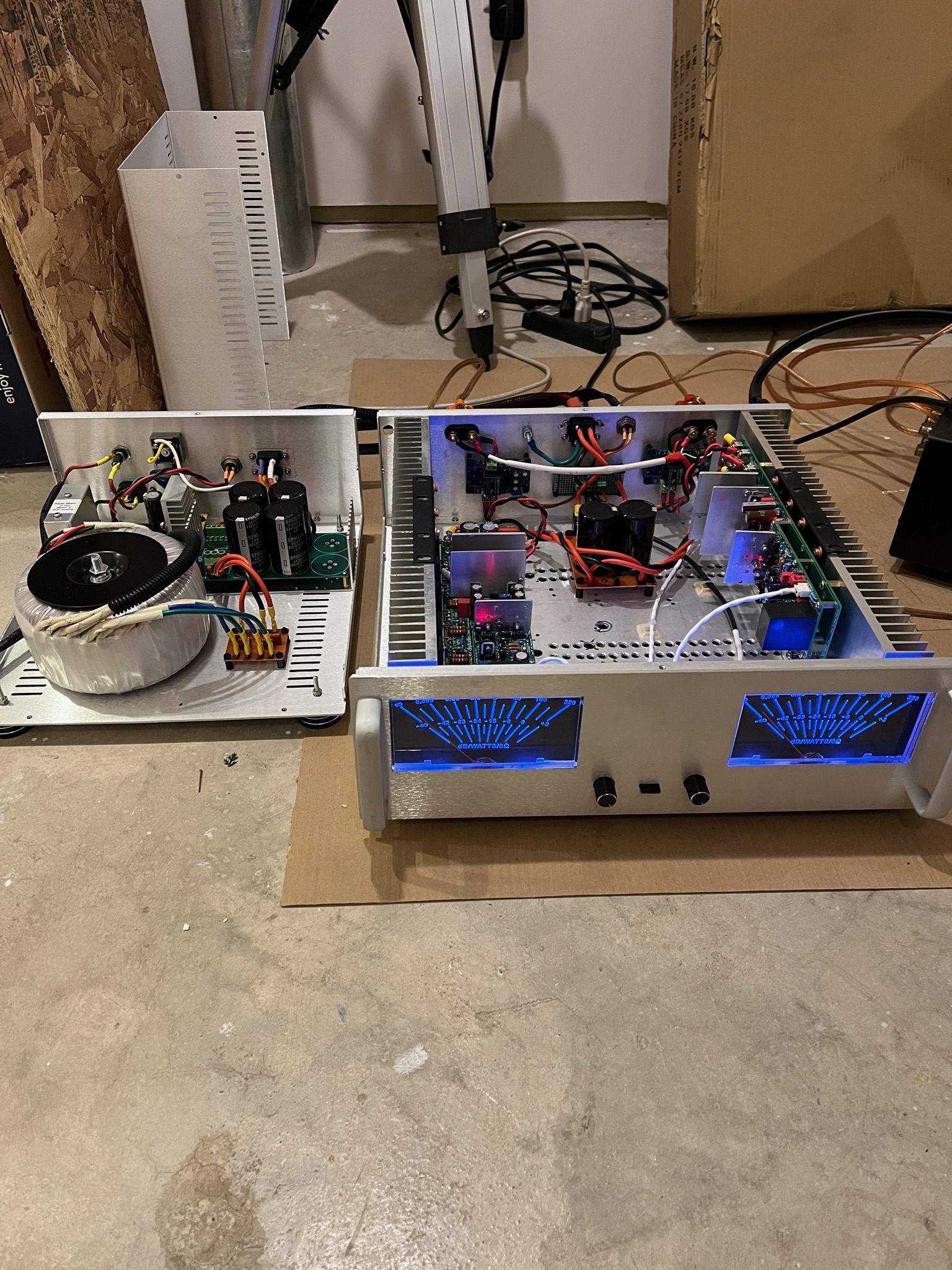

I'm finally finished!!🙂
First I have to say that this amp is absolutely fantastic. It really is!
I would like to say how important it is that if you decide to build this, you need a LARGE CASE and LARGE HEATSINKS!!!
This should be stressed at the very beginning of the build. It may give a little pause.
I did not pay much attention to this important fact and I purchased a small chassis and way to small heatsinks, I didn't know as I was going by normal home audio stereo's that I've repaired in the past.
I did get large heatsinks that completely filled the chassis and it left little room for the 800va toroid. Turns out the toroid was just to close to the amp boards and was picking up some hum.
I decided to get a separate chassis for the PS which did solve the hum problem. Sure wish I purchased the large chassis from the DIY store!
The Toroid is an AnTek 800VA 40-0-40 with a 12v and 18v output option. Specs are 10Amp x 2. Also from AnTek, they sell a soft start module and a full wave bridge with a 90kuf filter bank with a built in bleeder circuit. Not bad.
I removed two of the 15kuf caps and installed them in the amplifier chassis.
The wire used from the PS to the amp is about 12 inches long and is 10awg.
Inside the amp is 12awg to the boards
I used Elliott Sound Products Better Volume Control using 100k pots with a 10k resistor. I did this just for some control on the input.
The VU meters are driven from the speaker outputs to a circuit I built that was used in a Yamaha CA-610 II. It does not require power other than the speaker output. I did modify the high power portion of the board so the VU switch can read more than 50watts. It now measures about 180 watts. The low end is still set for about 2 watts.
The outputs are ONSEMI MJL1302A MJL3281A from NEWARK Electronics.
I did spend much time designing the layout so it can be easily disassembled for service.
I hope this can help someone that is thinking about building this project. BUY THE 5U CHASSIS WITH THE HEATSINKS!!! Save yourself lots of time...

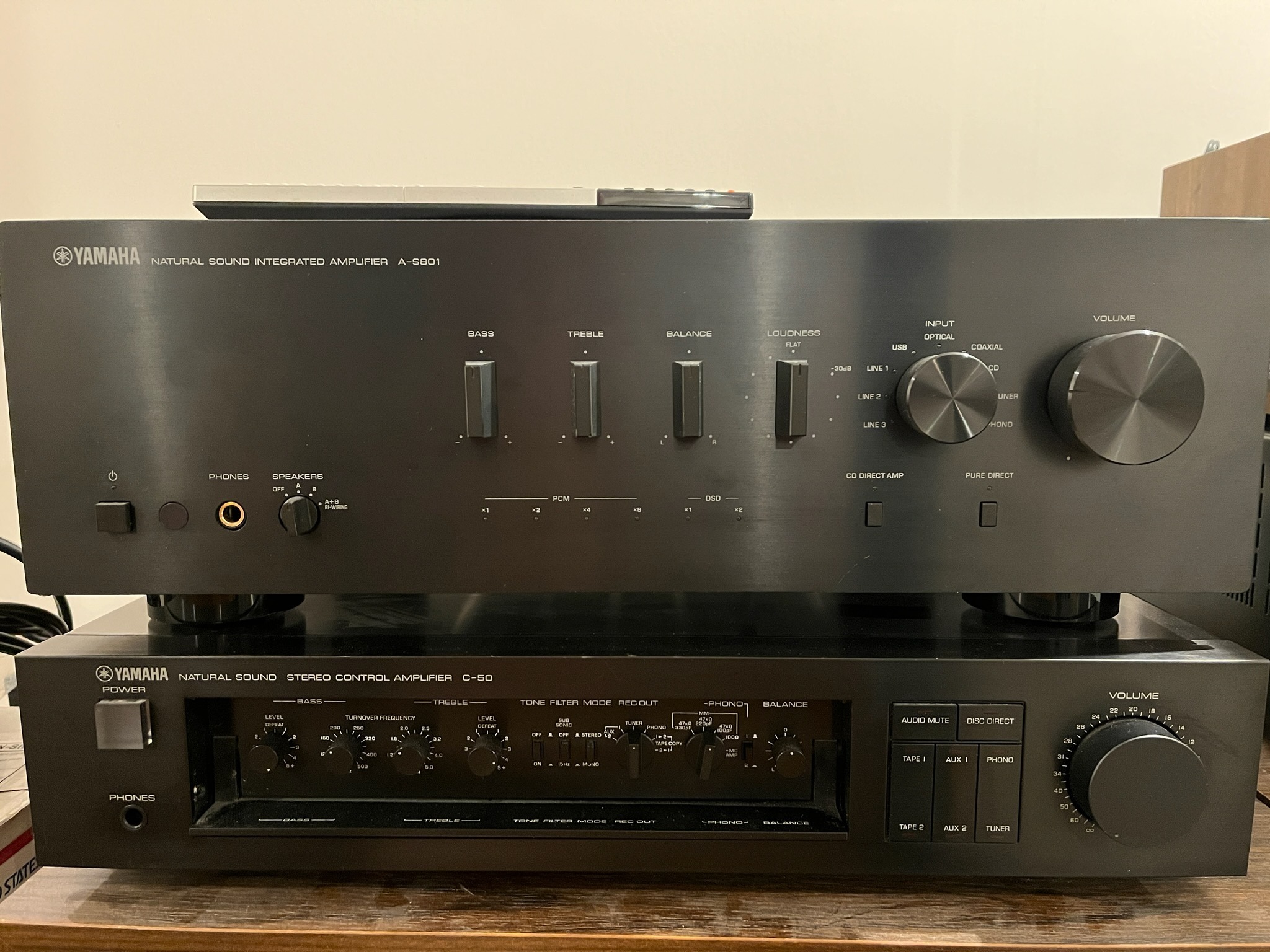

This amp does sound better than my Kenwood Basic M2. And better than this Yamaha A-S801. That's saying a lot as I really like the Kenwood.

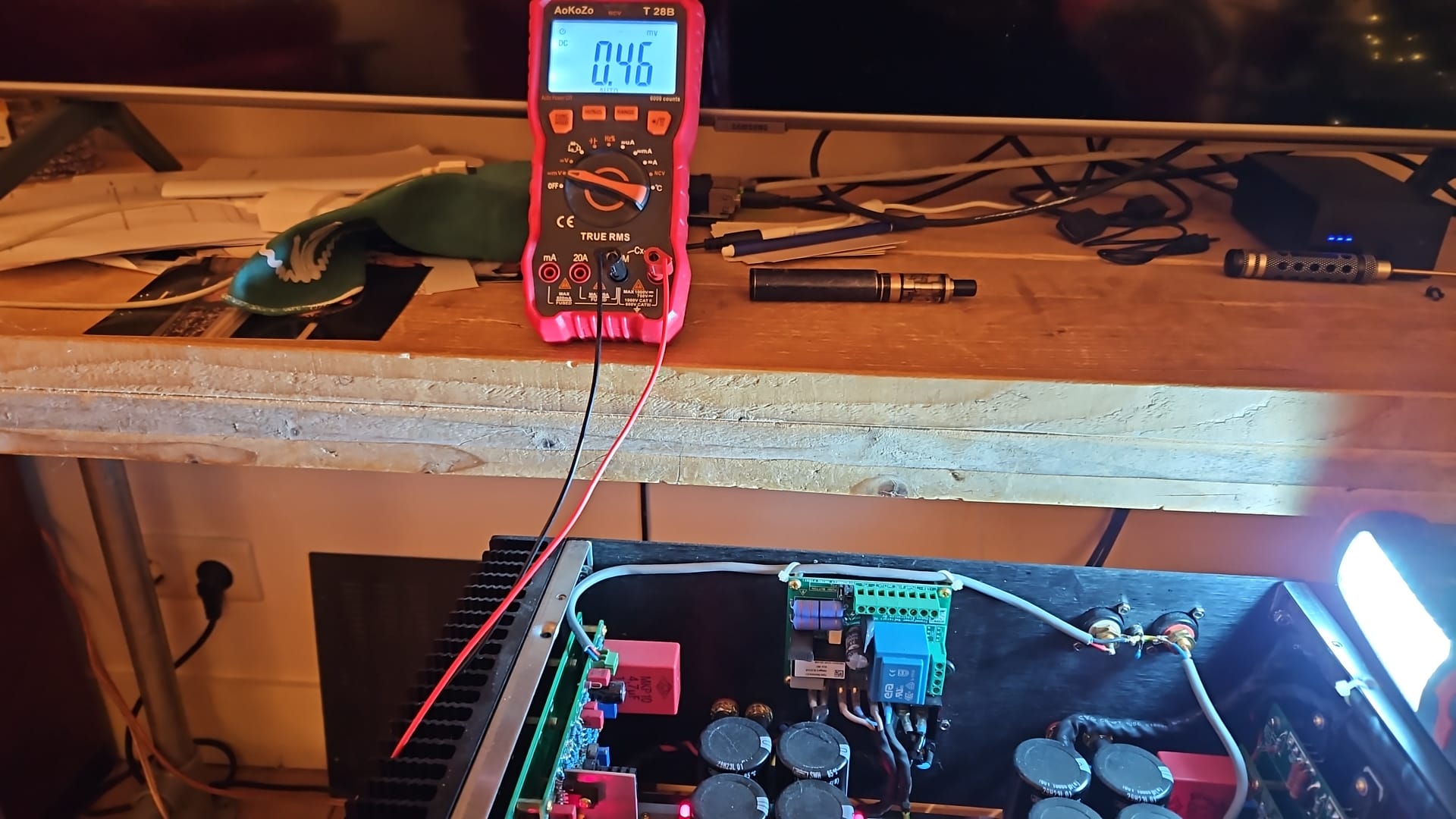

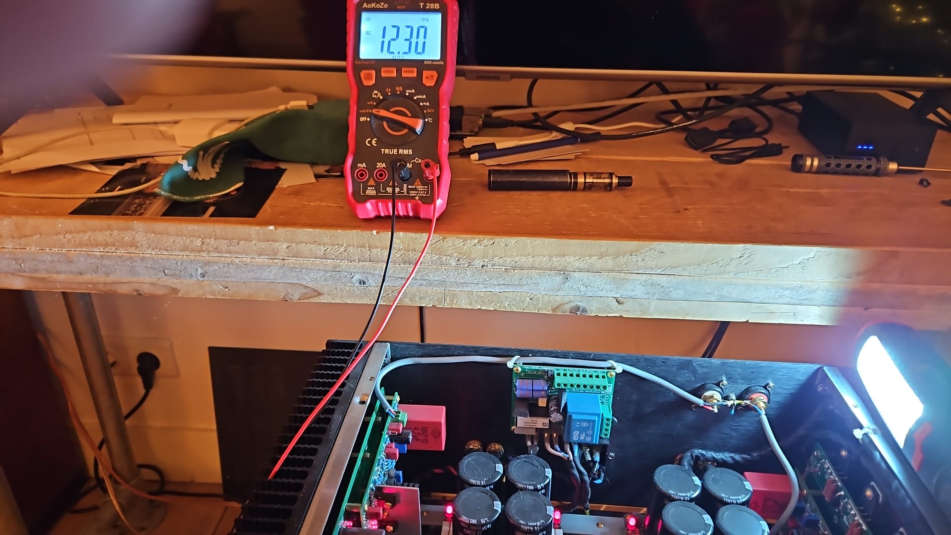

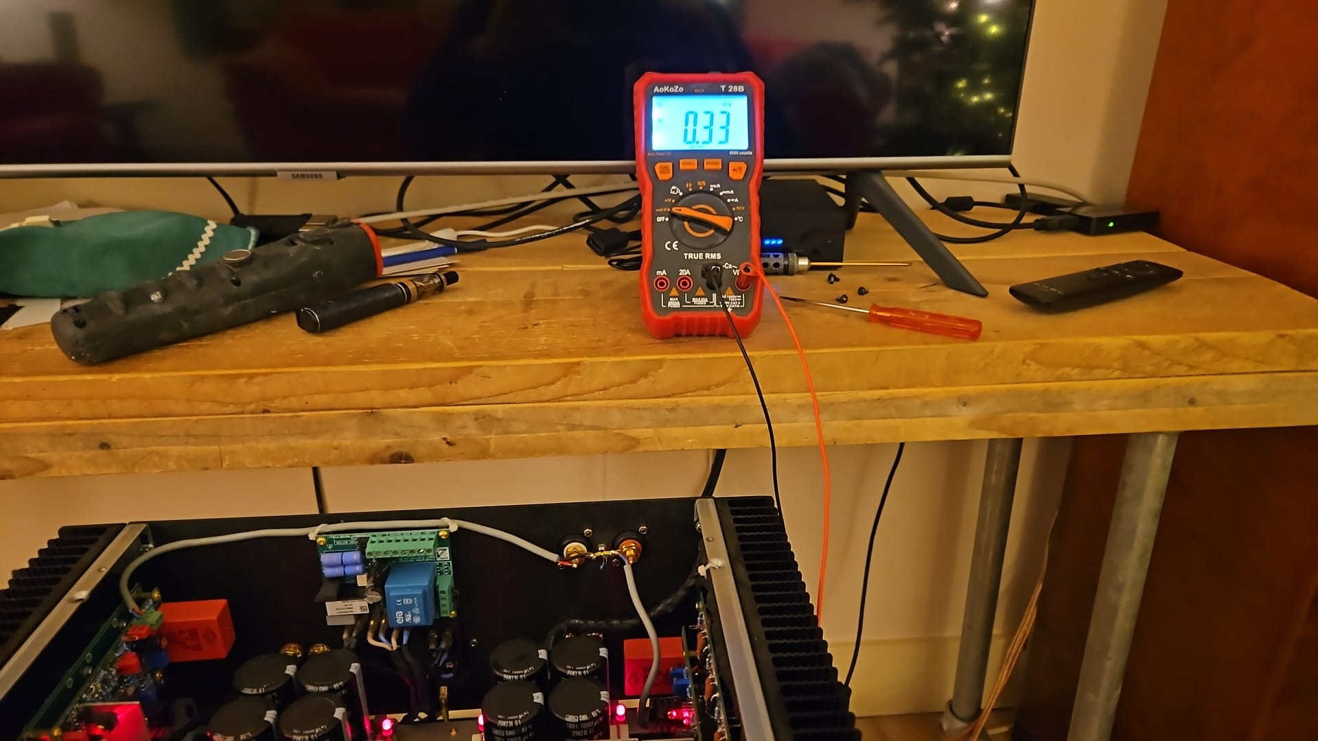

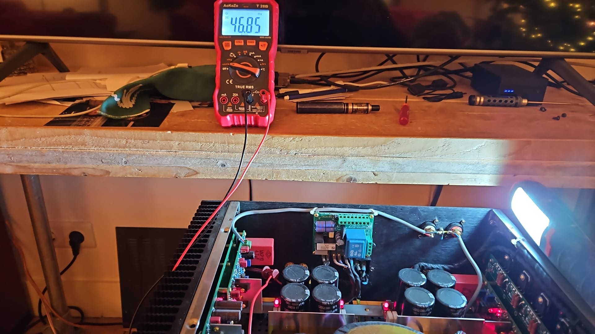

Hello Gents,
Bin a while as I've moved to a new house. Buyer of the old house hasn't come through with payments so a bit of lawsuit going on here...😒.....
After running the beast for a couple of months...I thought I'd give her a component inspection and do some measurements. No obvious failures besides some dust🙂
Offsets, bias and current source look reasonable I suppose besides the AC offset of the left channel which reads 12 mv. I did not shortcut the input on either measurement by the way...
bias right channel
ac offset right channel
dc offset right channel
constant current
ac off set left channel
dc off set left channel
bias left channel

One thing I noticed when setting the bias is... if I continue to monitor the bias and put the lid on the chassis, the 44mv bias starts to drop. It goes down to about 30mv or so...
So what I've done is adjust the bias to about 50mv with the lid off and watch it with the lid on. I'll keep doing this until it settles at about 44mv with the lid on.
I think this is the correct way to set it.

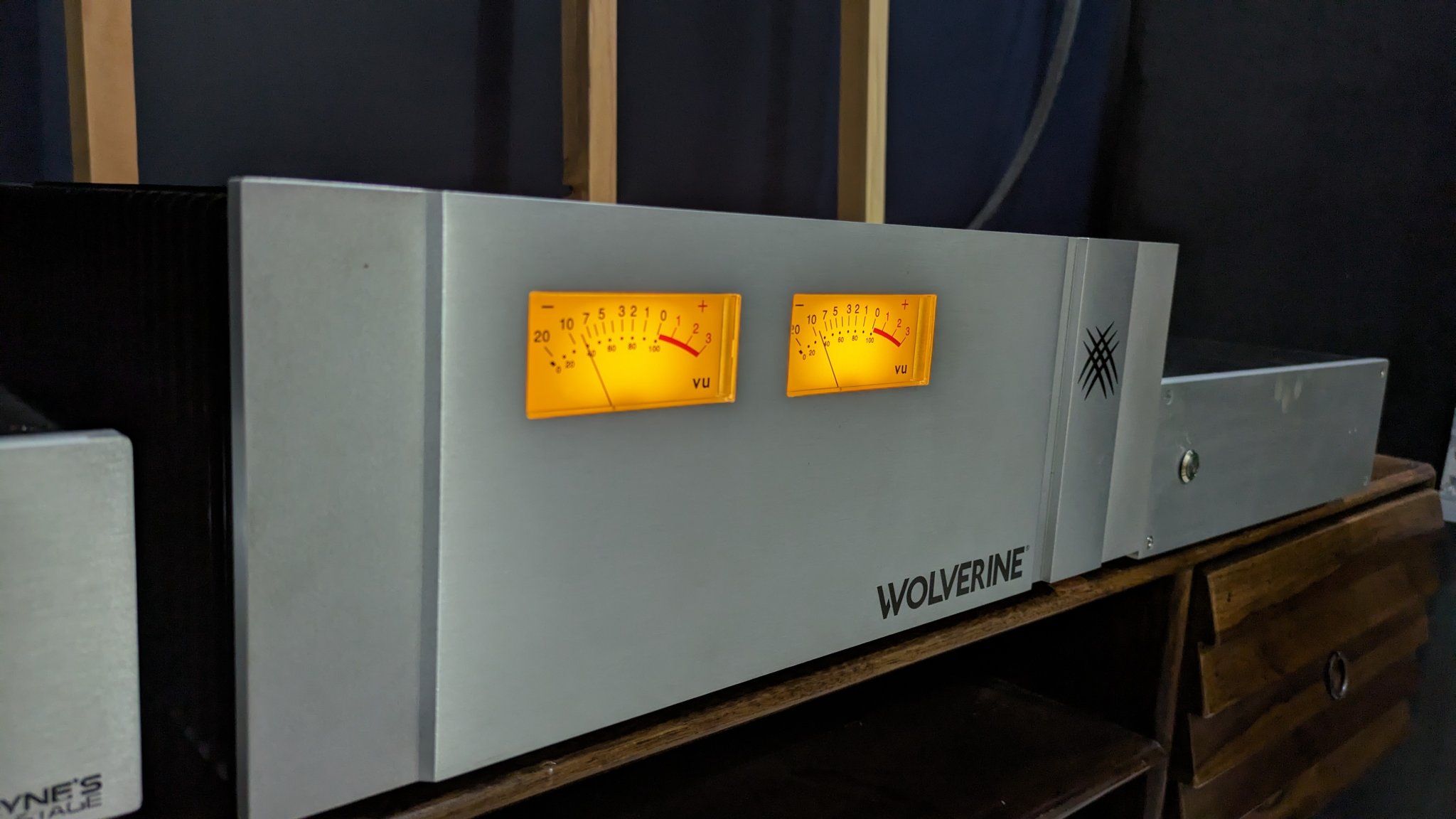

Completed the amplifier. It's such a wonderful sounding unit. Maybe after the breakin it's just going to improve.
- DIY Class A/B Amp The "Wolverine" build thread
