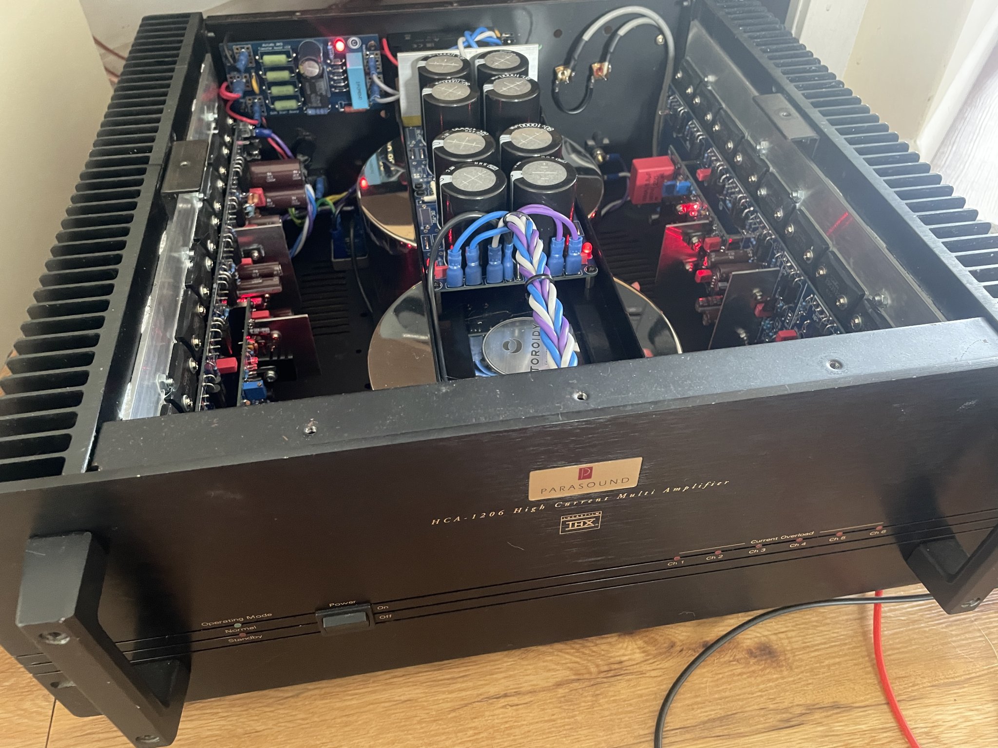

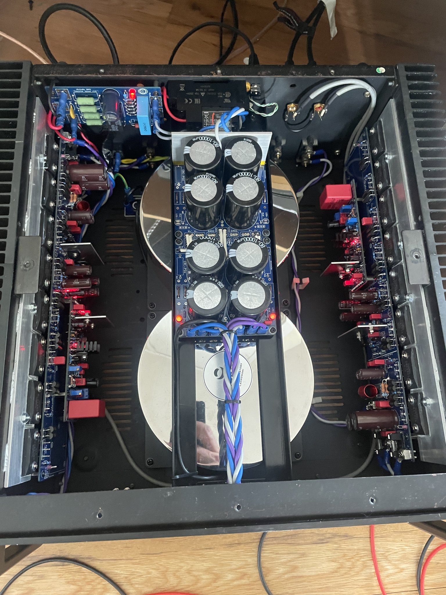

Been listening for over a month now, happy to report my amp all working 100% and I see no reason to ever replace it. I love it. Happiest I've been with my system for a long time. Speaker protection from @felix1024 has arrived so that's this holidays project.
