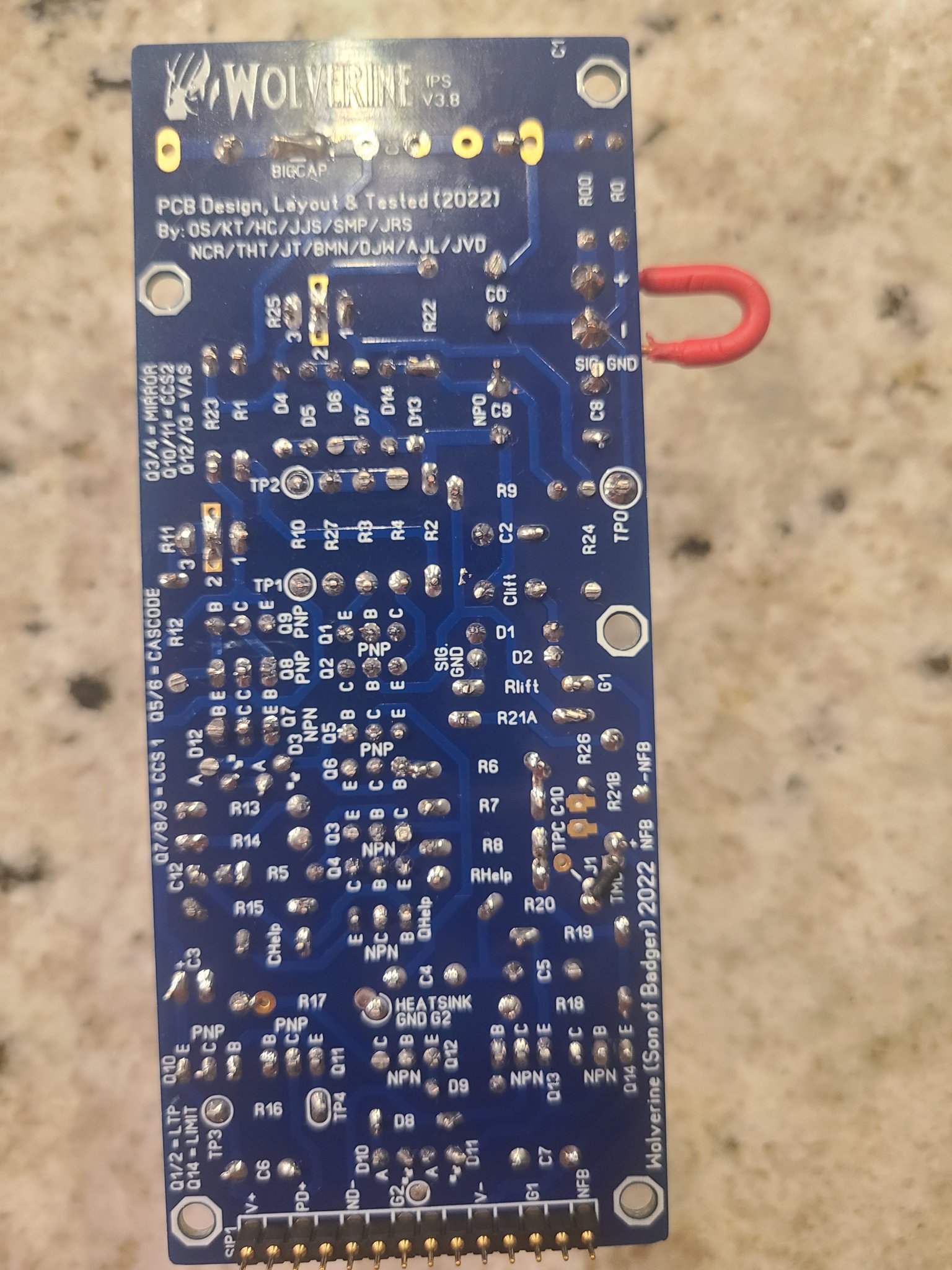

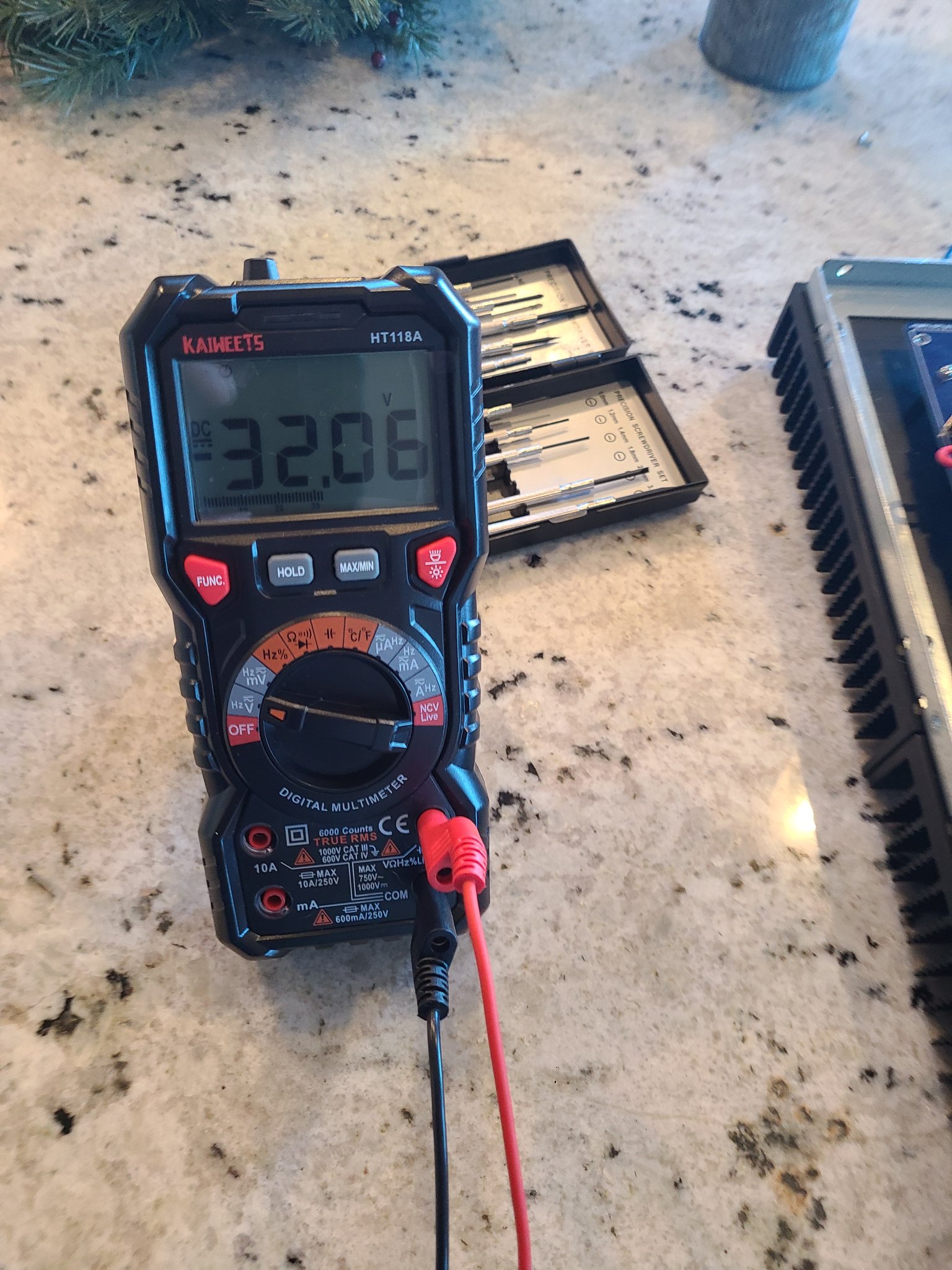

Nm i read the instructions wrong on this.I figured out the negative voltage, and luckily I hadn't returned one of the power supplies yet. One of my boards measured great. The other everything is OK except for I'm only getting 4 lights and measuring from TP104 to speaker ground I'm getting - 32.36v which is less than than 0.080 stated, but is it OK to be that much less? What should I look for if that's not ok? I knocked c123 and c124 around a little when trying to install transistors, could that be it?
Trying to adjust the dc offset. R25 measurements move when i measure it on pins 1 and 2. When measuring on TP104 and tp100 I get no movement at all, stays at - 32v. D10 and D11 don't light up either, but are fed enough power to light up.

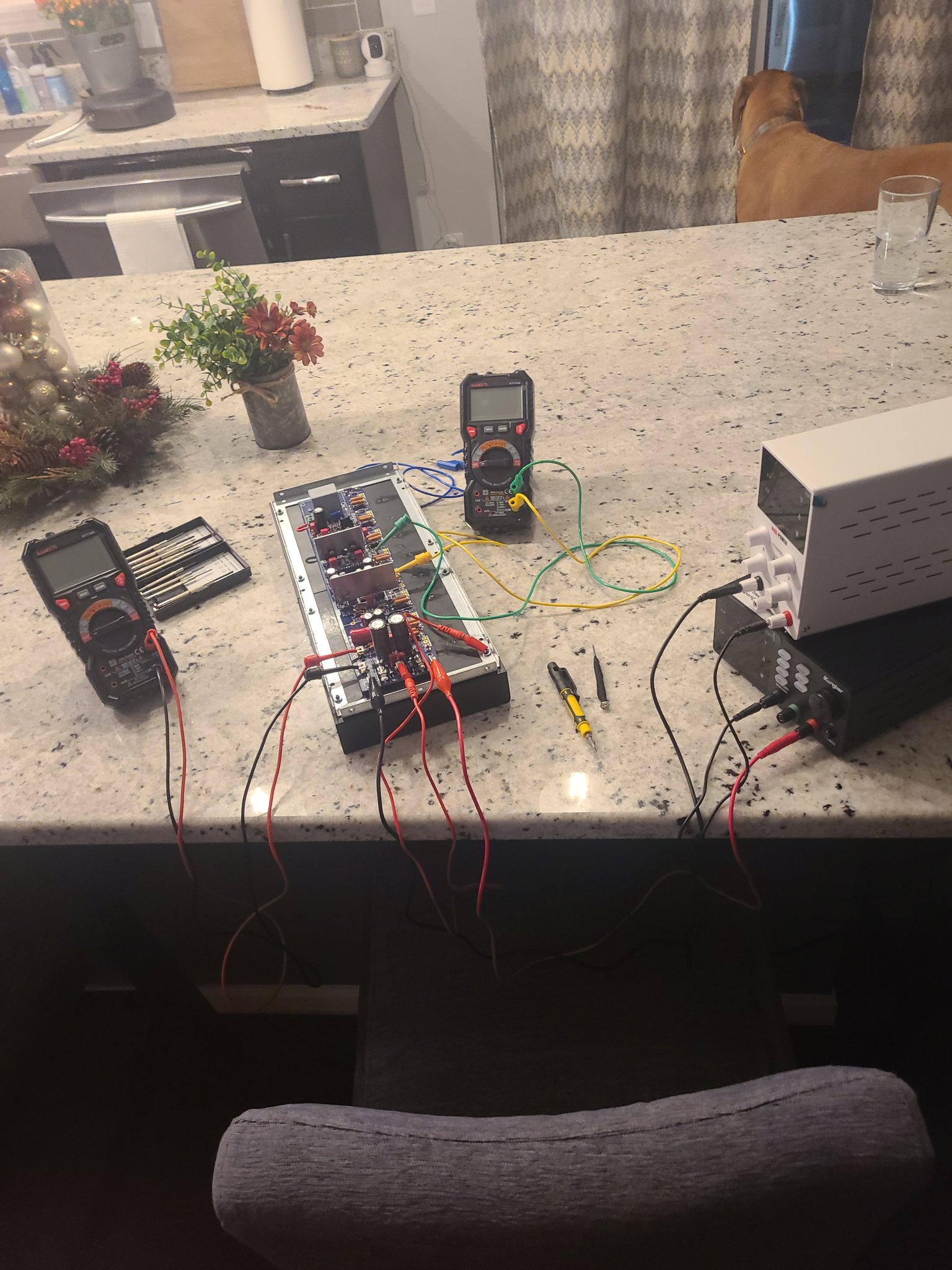

Please show some photos of your setup with DMMS on the rails confirming the voltage.

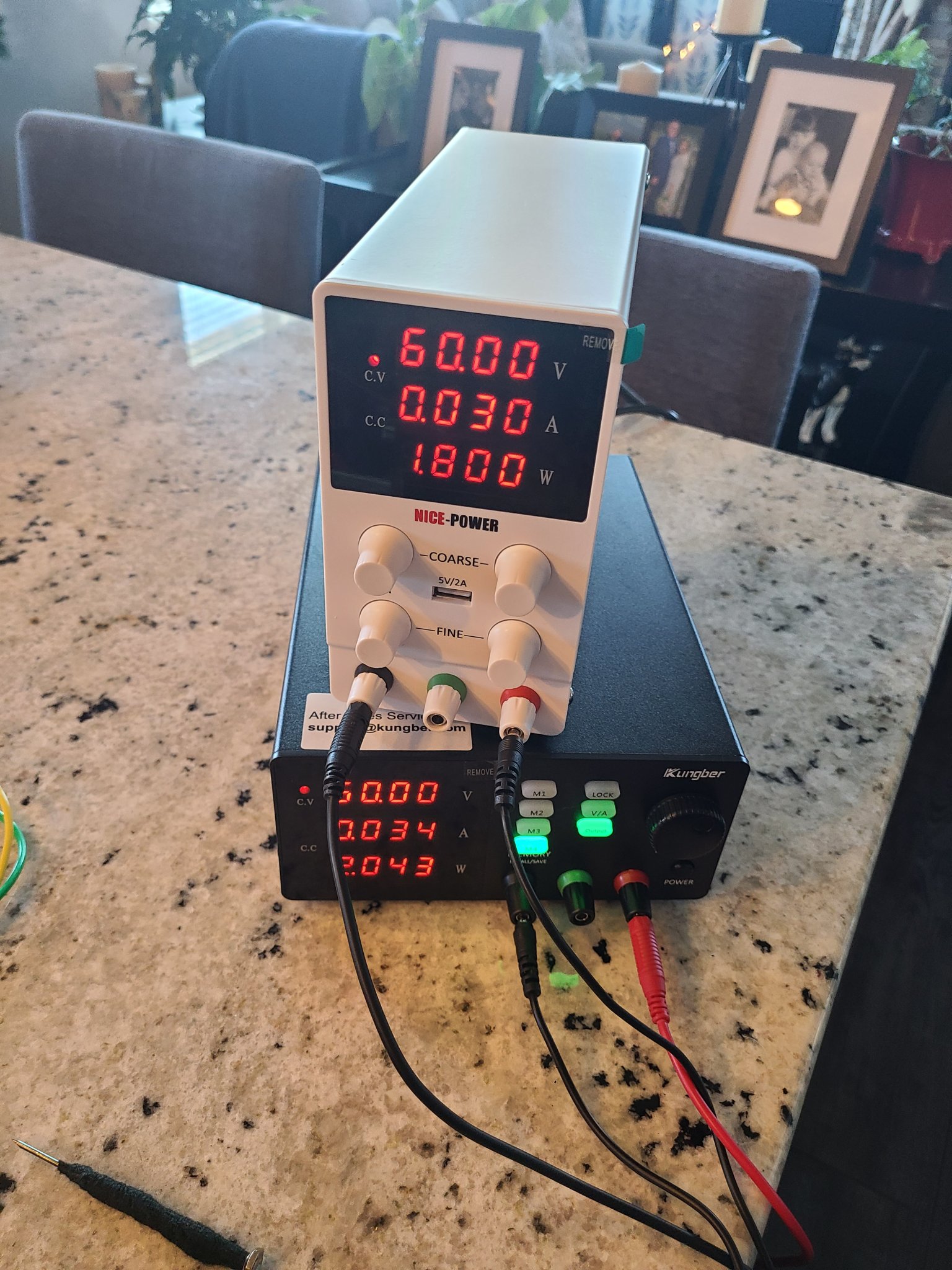

Just to be clear...It is possible to use separate power supplies to produce positive and negative voltages by tying the positive output of one power supply to the negative output of the other, this becomes your "0" volts, provided the negative power supply has no internal connection between its negative output and its chassis/equipment ground terminal.First off you need two of these power supplies to provide a +\-30-40V for testing. I tested with +\-40Vdc and worked fine (not these specific PSUs though)
You are only getting single voltage with one PSU unit, not dual voltages.

Please confirm this is how you have the wolverine wired to your power supplies and they are indeed floating supplies.

I see something connected to your heatsink. That's not necessary at this stage. Please disconnect that.
This youtube video may help
If that's 32v on the output of the Amplifier then you have a real problem. I can see some left over solder around that input board. You may want to check that the boards are cleaned properly. Did you double check that all your components are definitely orientated correctly. The fact that D10, D11 aren't lit its also a sign something is wrong. It maybe because you have no negative rail supply or maybe an issue with Q14 or Q12 maybe Q13 is it insulated properly.

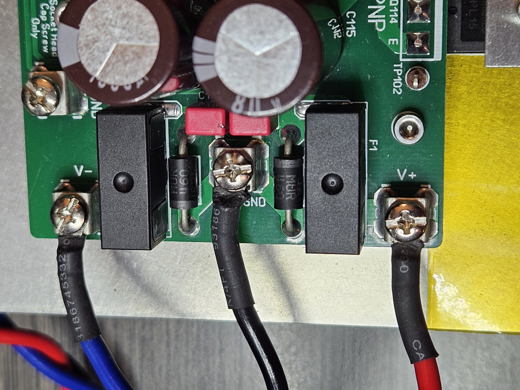

I'm seeing 3 black wires and 1 red on the powers supplies and 1 black and 3 reds connected to the board. We need a picture that shows wires all way from powers supplies to the board. Pretty sure you have something hooked up wrong.
That's why I made the videoPretty sure you have something hooked up wrong.
GND on PCB needs to go to 0 volts on PSU. From your image, if I interpret your wiring correctly it looks like you've got it connected the chassis (heatsink) only ....? That is, I mean it should be connected to the link you have between + and - on the PSU's, which becomes the 0V (as 90scaraudio explained in post 3304) ...

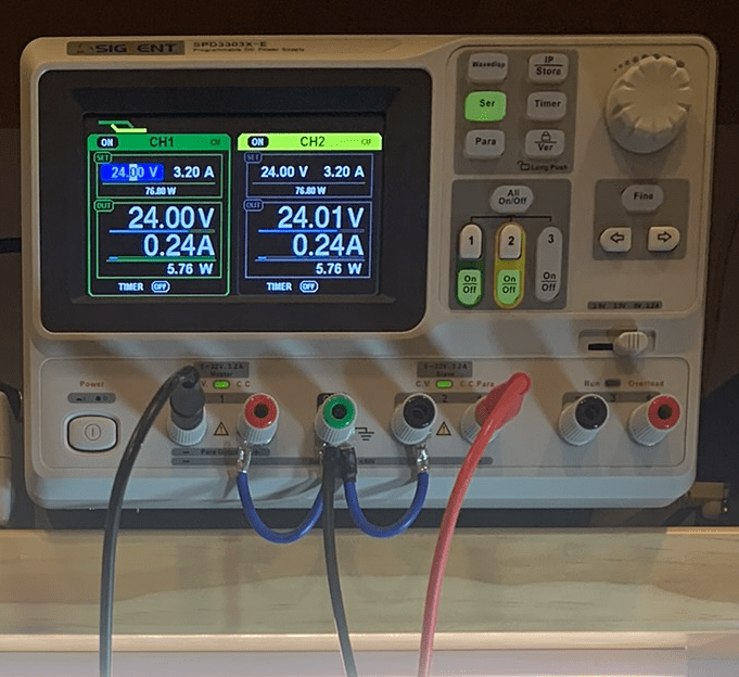

@MilkyChance
I don’t know if the above pic helps you or anybody else. And btw, this Siglent power supply unit is excellent for +/- 32V or less.
Hope you get your unit all configured and fired up!
Best,
Anand.
