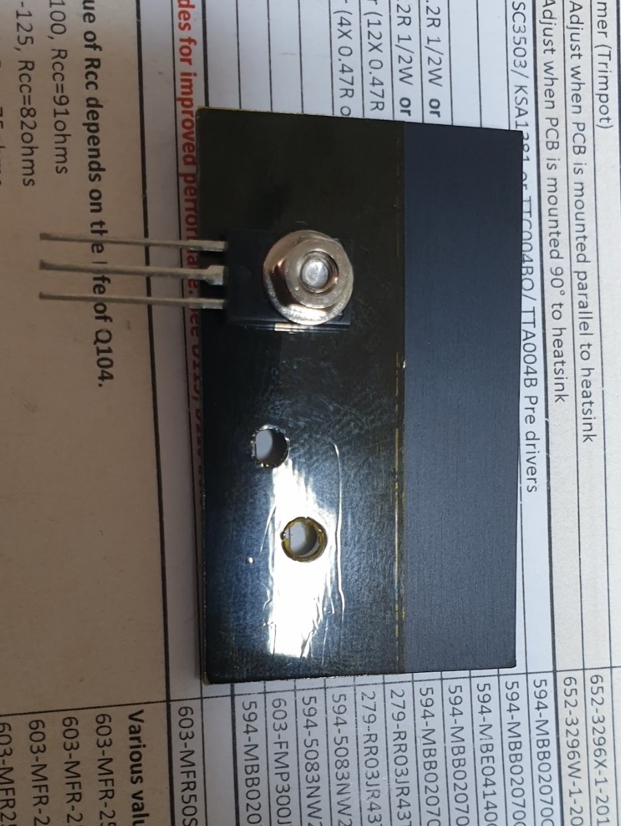

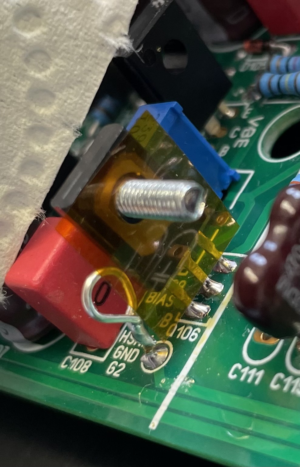

Both my kapton and mica insulator has some clearance in the hole. The advantage for mica would be that it’s thicker and gives more distance to the heatsink.
I might do as suggested and make a new smaller hole in kapton.

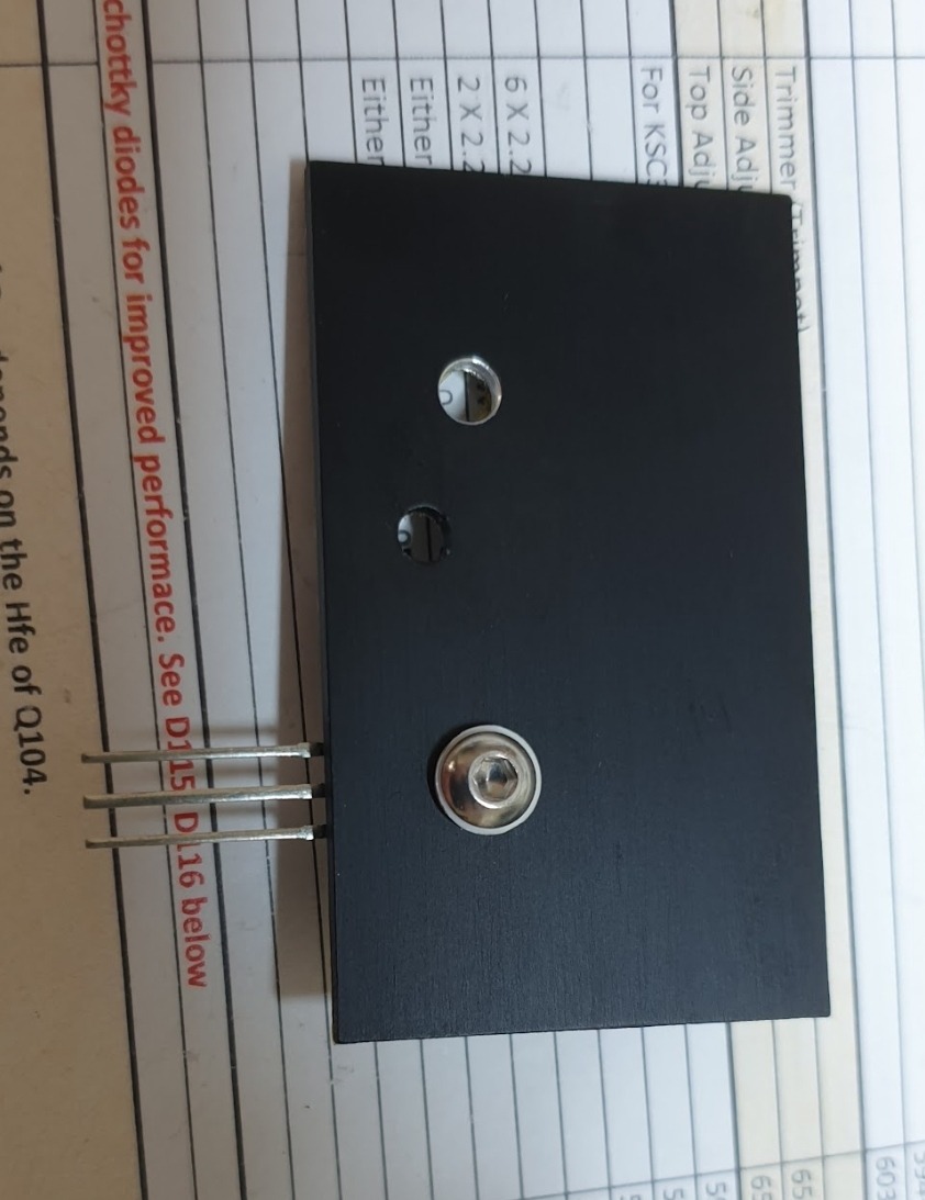

Please refer my photo here or in my build album.
build album

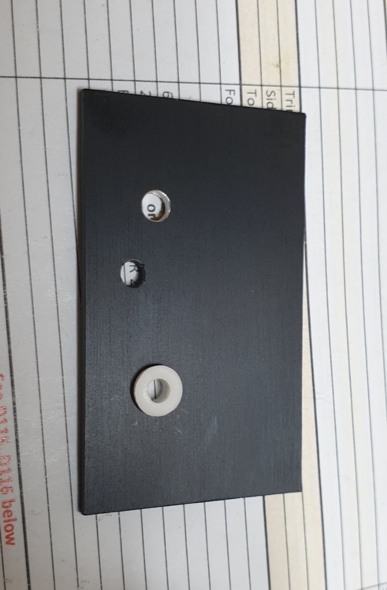

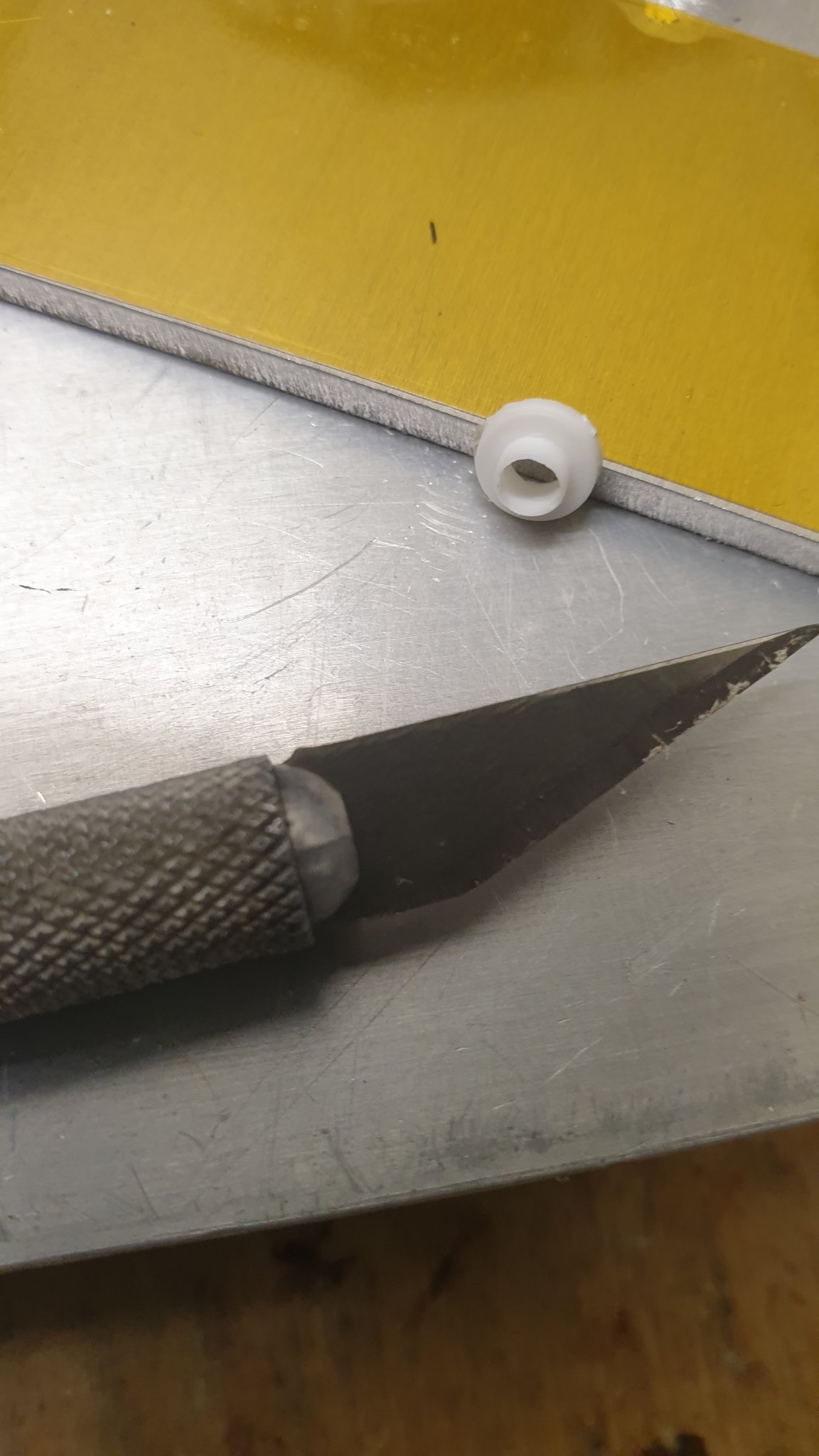

Drill a neat hole for the insulated shoulder washer then insert the washer and trim any excess that sticks though the other side.

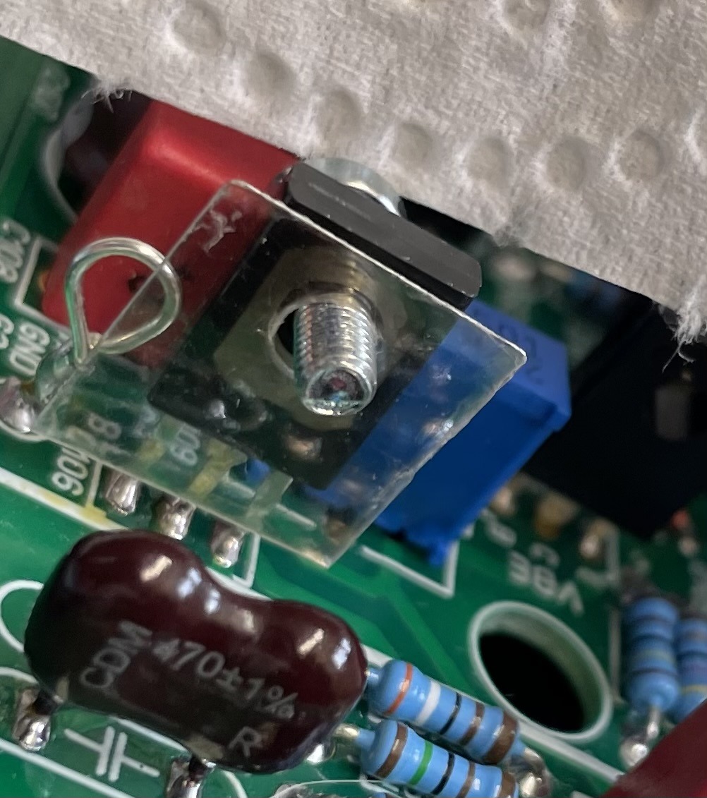

Ok, installed the plastic washer, powered up, everything looks fine.
Went through the steps in the build guide.

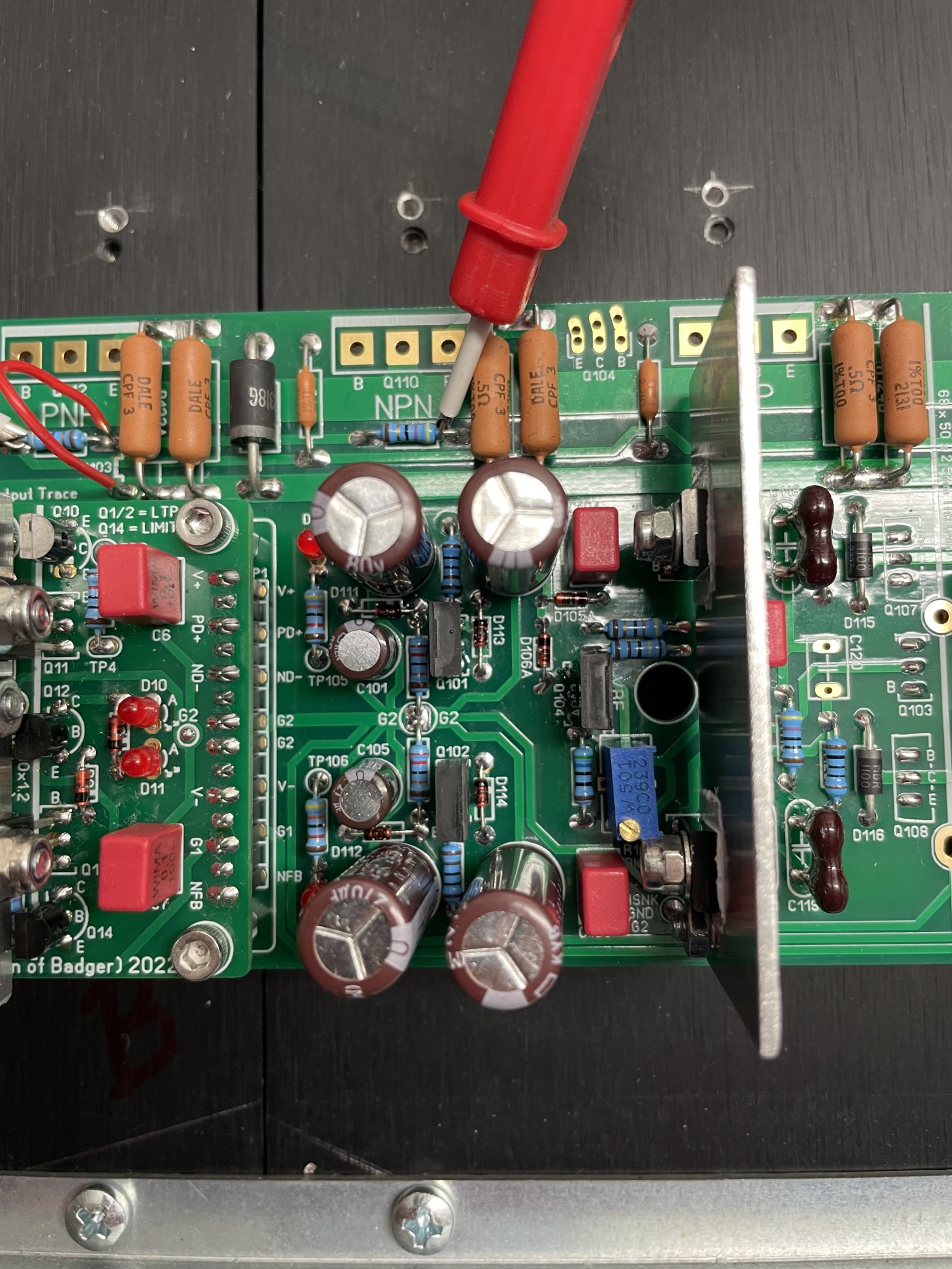

My measurment differs from pointed out in 17.1.G "Measure the voltage between TP-105/TP106 and rail connection".
My build is with C004B transistor for Q101 and A004B for Q102. I'm reading 1,4V in TP105 and 0,64V in TP106.
Not about 1,5V as stated in build guide.
Everything else seems fine. I'm able to adjust ccs, offset and bias.

Meauring my build... Toshibas for Q101/102 had around 1.4-1.5V at both TP105/106 as well.
Rail voltages 64VDC
The measurement would not be affected that much by temperature and not at all by bias unless your current limiting the supply.
Please place a DMM in series with each rail and measure the current draw on each rail. Are you sure the Q102 is correctly orientated?
I measured rail amps and got 29-32mA in positive and 32-35mA in negative.
The tip regarding diodes being affected by the short on Q106 made me do some measuring on D112/D114.
They have no forward voltage !! Resistance measurment shows 2 and 13 ohm!
On the other side D111/D113 appears functional, shows 0,55-0,6V.
So next step is to replace D112/D114. Fingers crossed nothing else is blown...
