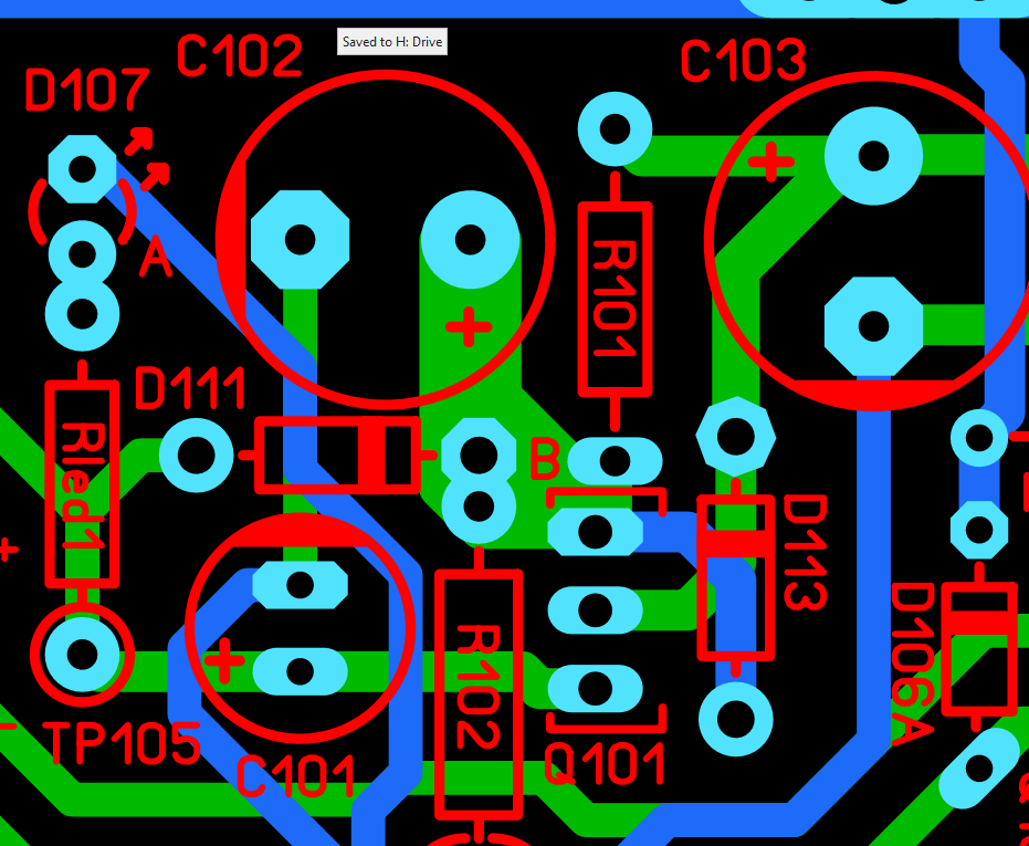

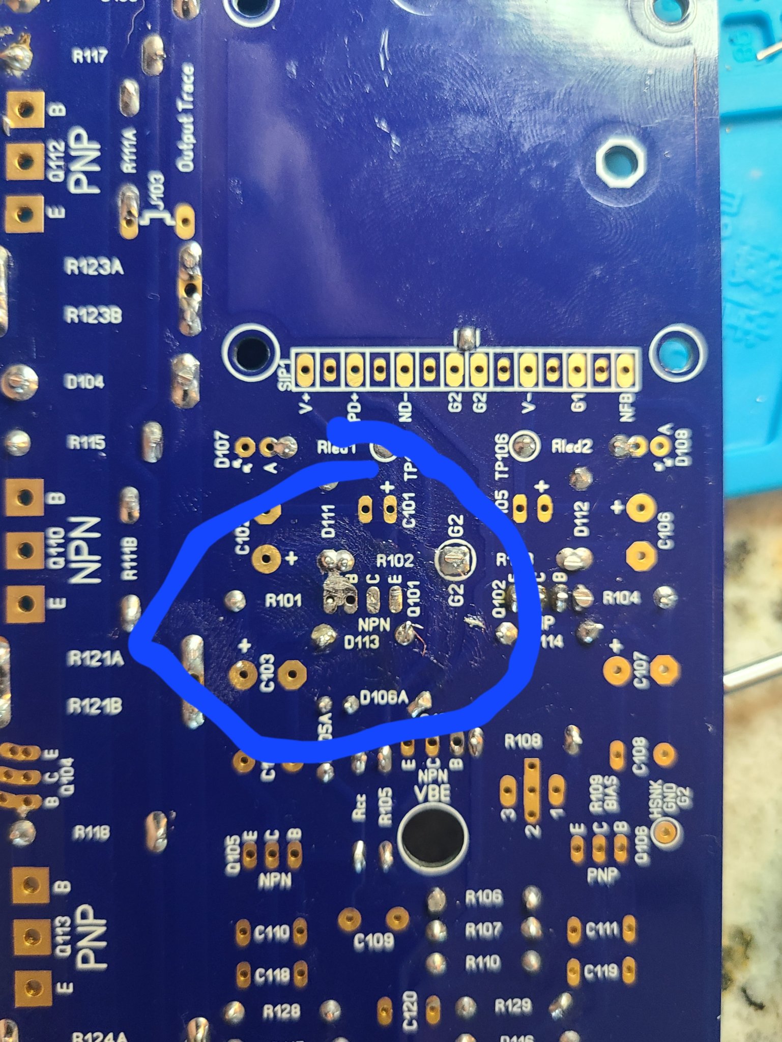

Can this bridge be fixed?
Wick braid can be tricky to use. You might apply a bit more solder to the bridge and then retry the wick. You have to turn the iron temperature up a good bit and then press hard with the iron. If the solder mask is gone you may have to use "mechanical means" such as an xacto knife to push the errant solder away. Another thing that might work is to add some solder flux to the area before you use the wick. Some solder wicks have flux pre applied.

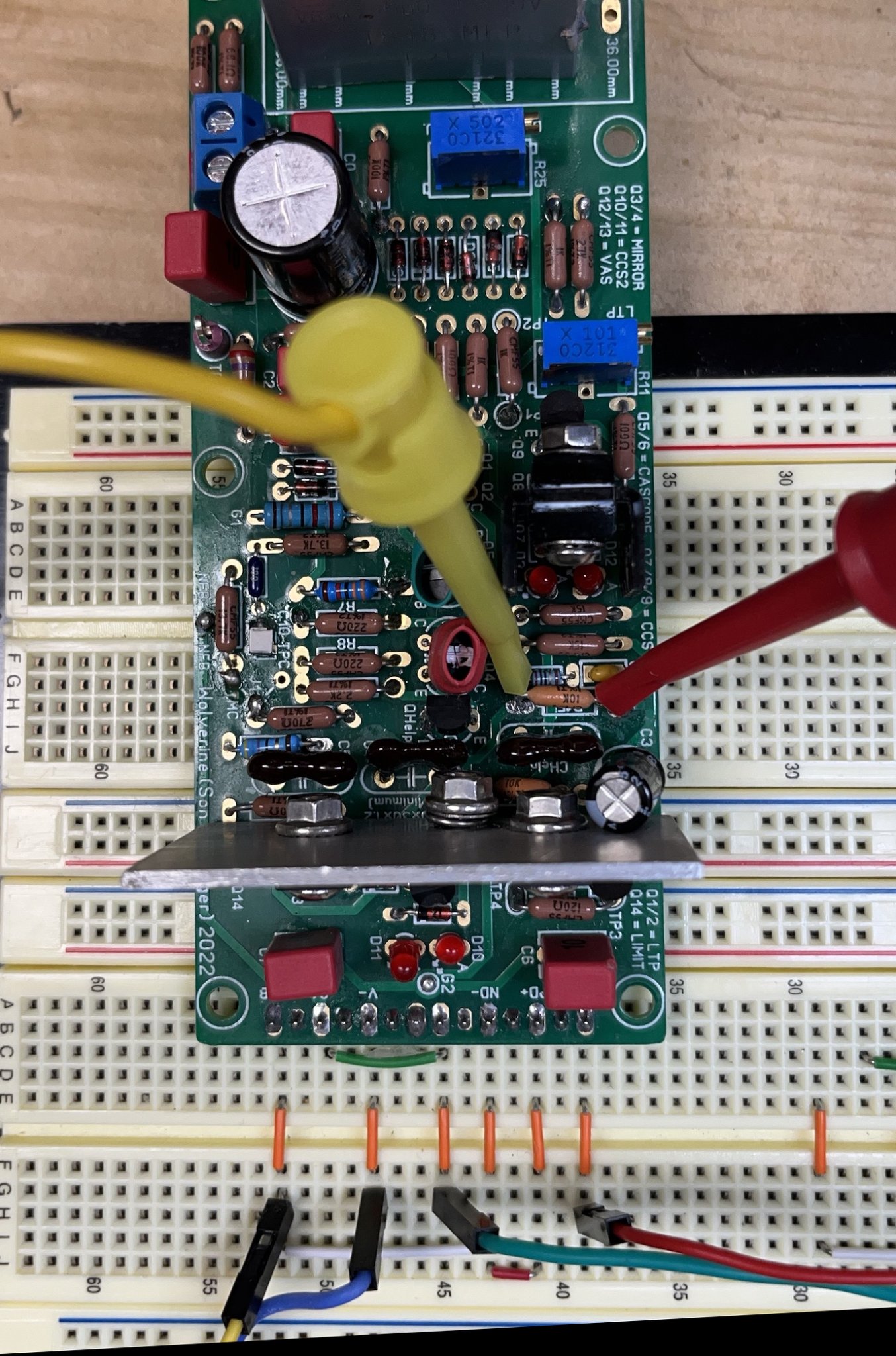

Thanks so much for the advice! I figured I would do a little more measuring before trying to swap resistors. Strangely, as I was probing R17 with my VMM leads, the LEDs D10 and D11 came on for the first time. Don not understand this at all.
In any event, the voltage drop across R17 is 16.5V. I measured it 9.9K so by Ohm's law, it must be passing 1.6 mA, which seems low.
With +30V/0/-30V, the NFB/PD+/ND- is 29.8V.
Measuring each output separately (jumpers removed),
NFB = 400 mV (not sensitive to adjusting R25)
PD+ = 29V
ND- = -65 mV (this moves around while I watch it)
So somehow, the V+ is leaking into PD+
Does this clarify anything?
Jon
As other mentioned, adding more solder might help keeping the iron at high temperature and a soldersucker. Also solderwick, although I do not find it suited for all applications. Sometimes adding some liquid flux to the braid helps if absorb the solder better.
If any of these don't work, I normally cut the excess of with a sharp knife/scraping tool before the solderpads is to beaten up by heat and ect from other tryouts...
EDIT: I see now that @stuartmp has posten that the pads are connected🙂
Hi Jon, In your photo you are actually measuring across R15 and with 30v Rails 1.6mA is correct.
It looks like you are running 57v rails so I have made you a schematic for testing "Wolverine IPS Only 30v Rail testing - with 57v full voltage rail components"
I also added this file to the Dropbox folder along with a 64V version "Wolverine IPS Only 30v Rail testing - with 64v full voltage rail components"
See attached
You 100% do not want to separate those connections. They need to be in place otherwise the circuit is not complete and you will have no negative feedback.
Please reconnect them as shown in the IPS isolation testing section and test and varify the voltages shown on the attached schematic.
Please come back with a marked up copy of the schematic showing the voltages you are measuring and there values.
