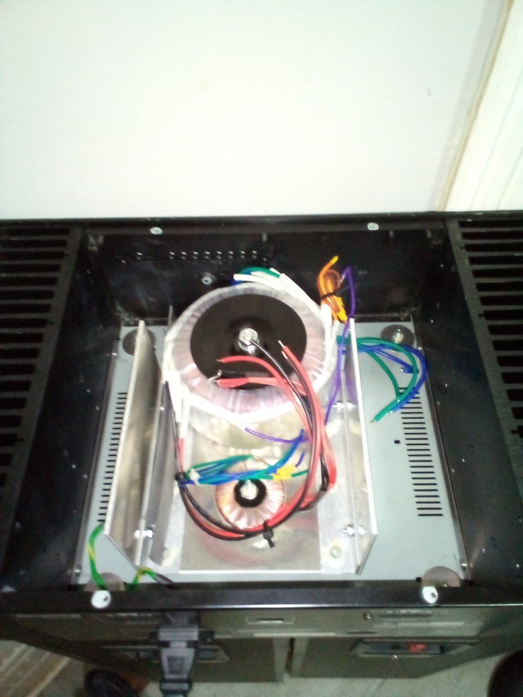

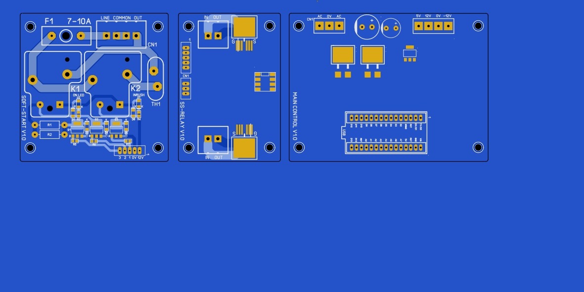

I have the trafo's on one 1/8" aluminum sub-chassis (below). It will have my PS , Arduino , protection/soft start.
just 4 holes/bolts on the bottom cover and I can pull the whole module right out.
Don't make fun of my 500VA power supply - I'll be loud !
Just waiting for more boards - I might just fire it up without the protection.

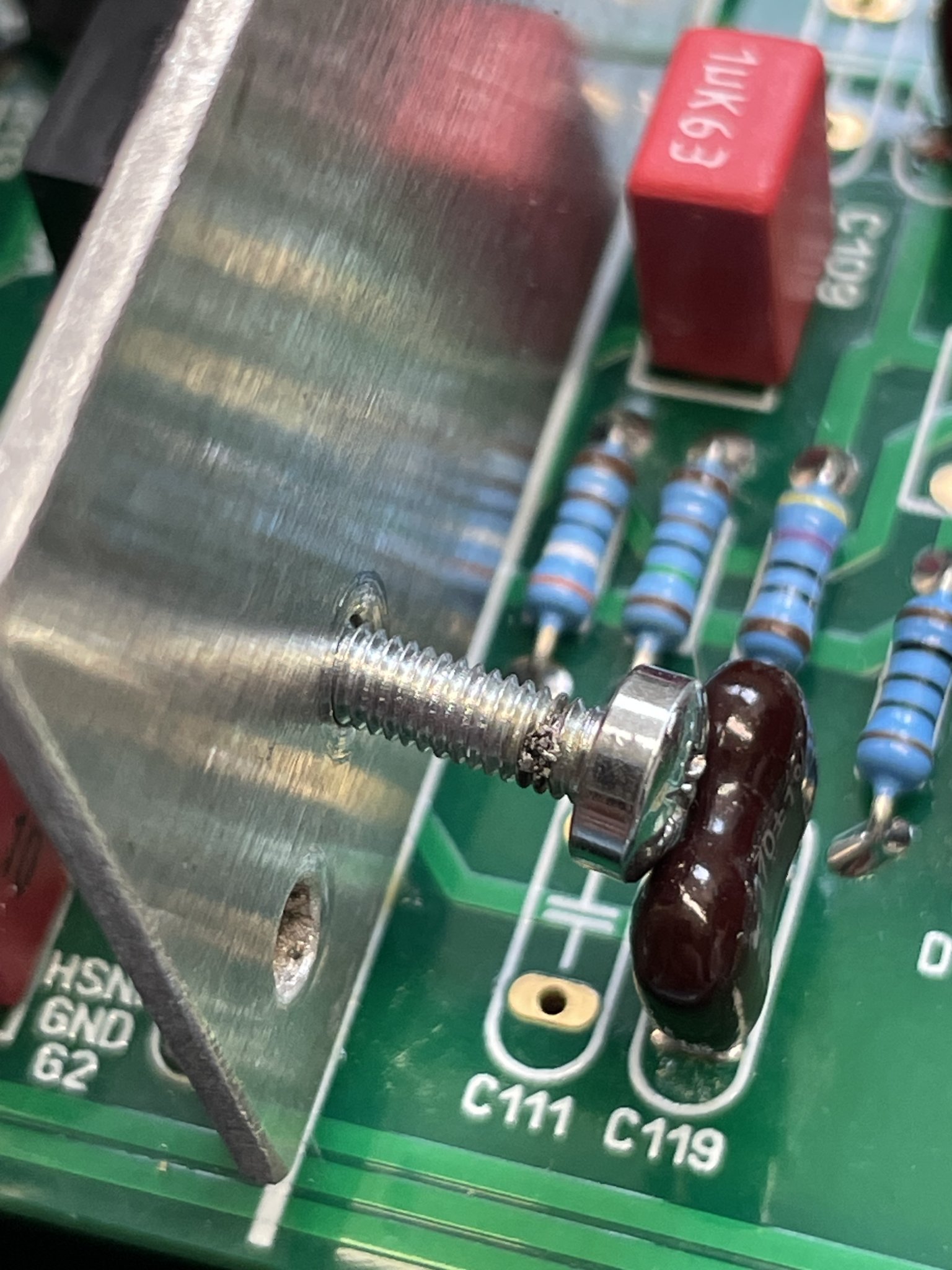

I’m powering up and the 500mA fuse in negative rail blows after a couple of seconds. Double checked all trim resistors and tried both IPS. No output transistors installed.
Any suggestions where to have a look? See attached movie.
  • IMG_8771 - Trim.mp4
    8.8 MB
Check that all of the drivers/pre-drivers are oriented correctly along with the bias transistors. It would be easy to put one or more of them in backwards. Same goes for the cap multipliers - Q101,102. If you have a bench supply that will do current limiting, then lose the fuses and ramp up the rail slowly, watching the current draw. Without the output transistors, the circuit draws less than 40ma. Then you can check some of the circuit voltages against the schematic.
Make sure that J103 is installed and that you have the feedback path correctly jumpered on the bottom. There was at least one solder jumper missing or misplaced from the early build guides. One of the required path 1 jumpers is not identified clearly on the silkscreen. Also check the heatsinks and transistor leads to ensure there are no shorts to the heatsinks from mounting.
Your meters show that CCS1 is in the ballpark, as is the bias offset on the second meter.
Other than that, see the troubleshooting section of the build guide. In particular, use the procedures to bring the IPS and EF3 up separately. Given that neither IPS works, then start with the EF3. It would, of course, be possible to make the same transistor installation mistake on both of the IPSs.

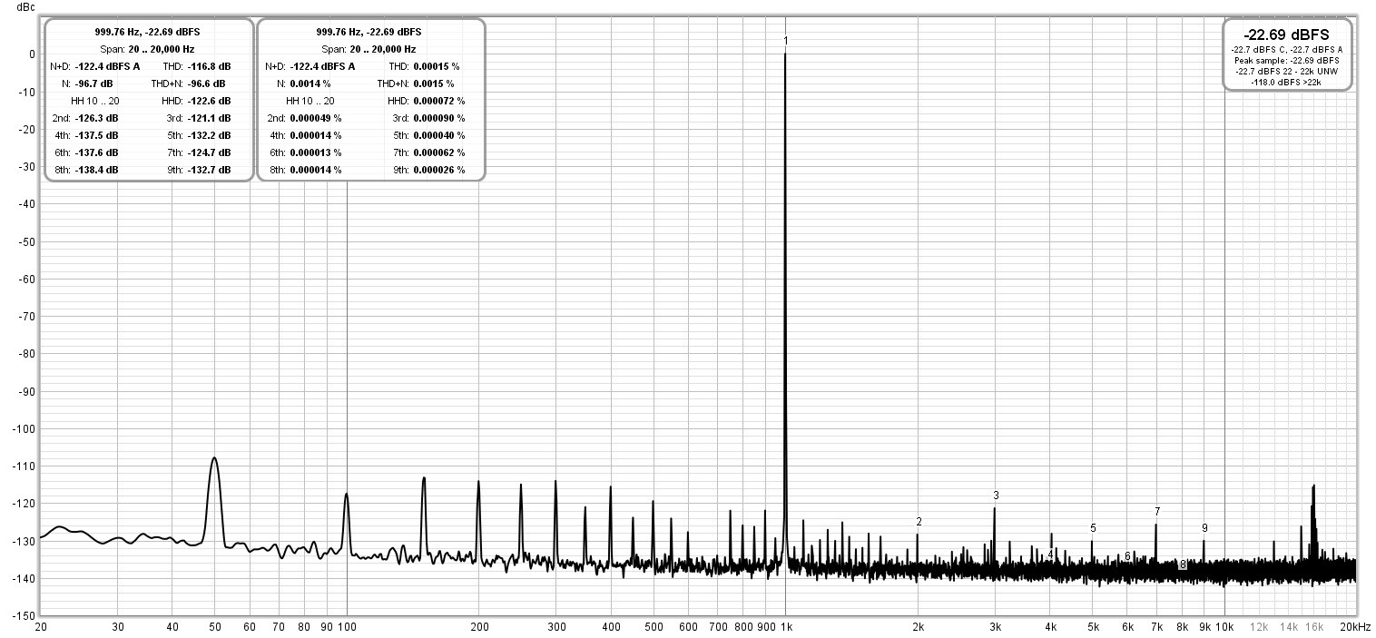

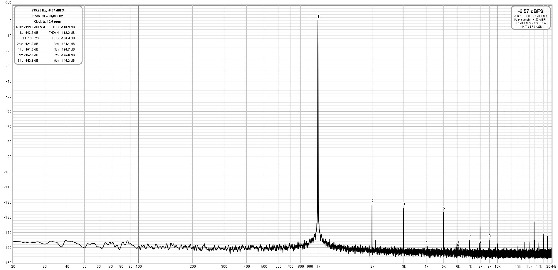

Thought I'd post up the measurements I took of my 4 pair build - not bad considering the only transistors I bothered to match were Q1/2 & 3/4.
Heres the loop back of my measurement rig - Laptop -> E30 (power is isolated from usb data) -> E1DA cosmos ADC -> laptop
So as you can see, not as good as @fireanimal or @danieljw 's rigs, but definitely enough for me to do a sanity check on my own amps.
Heres right channel 5W into 8R as installed final in chassis with lid on - the left channel looks distortion identical but there is slightly more 50hz mains noise due to the RCA input wiring running around the whole perimeter of the chassis.
Just crazy the distortion meets or exceeds that of the DAC. As usual, the real problem is noise. My thoughts on the sound of the amp have not changed, they can pry this from my cold dead hands. Love listening to it.
I can only hear the slightest hum with my ear almost literally touching the woofer (-power supply), and the tweeter is absolutely silent (-amp design)

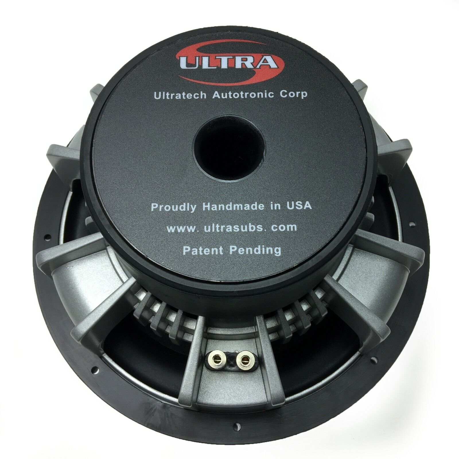

Speakers ? now - a 500W ULTRA 4R sub (below) in a 2.2cu ft box If I had more room ,
I'd buy 2 and build a pair of 3-ways (powered by wolverines). https://www.ebay.com/itm/133555744366 (6 left)
This speaker seem to be a perfect match for my EF3-3. Does not sound like a car audio sub - real snappy bass.
I also have some real powerful 8" dayton RS-225 2-ways , these will be my stereo speakers (along with the sub).
I was explaining this to someone on the forum recently that the wolverine (and other PPM designs) ,that the semi noise floor is the limiting factor
<1 PPM. So , the only way to beat the wolverine would be to source "quieter" parts. It really doesn't matter at these levels.
Nice performance , BTW.

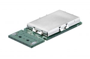

Edit - I'm going to start (full) shielding of the SMD versions of these amps. Halcro - here I come !! he he..

No, lowering the temperature is next step, shielding is only first step.

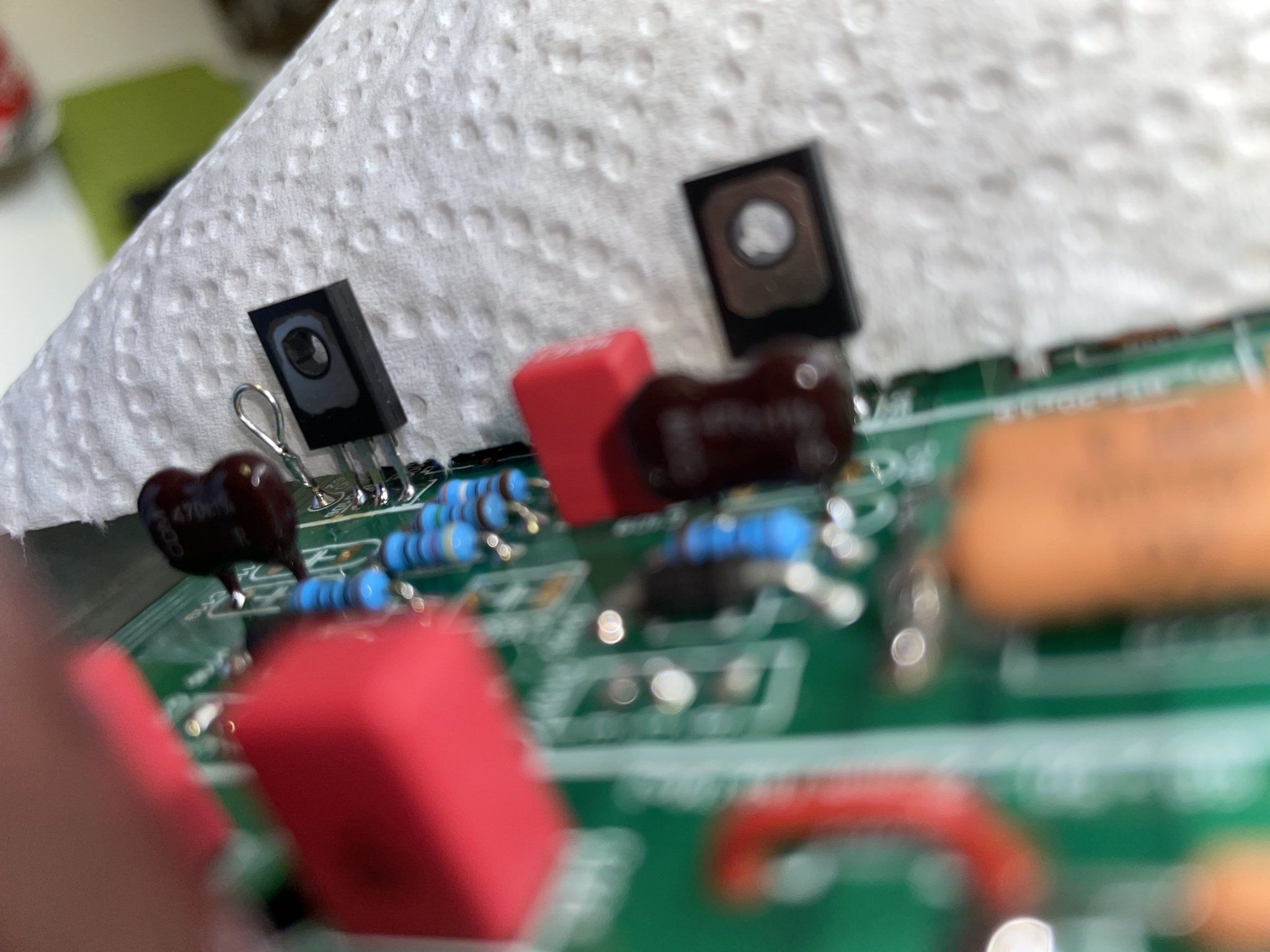

Consistency check was ok without voltage applied, but now there’s contact!
Easy to see on the screw, but not on the transistor.
Perhaps use a plastic screw on this one?
The heatsink is grounded. I don't see any insulator unless you removed it. The problem with insulators is there's always some clearance and the transistors holes has clearance to. Those two clearances accumulate and sometimes form a connection as things move around when you tighten up the screw. That's why I prefer kapton tape with a small holes pieced in it. Nothing moves and you won't have a short. In this situation I normally put a insulating washer in from the other side and trim it with a sharp hobby knife. That way the internal part of the hole is insulated.
